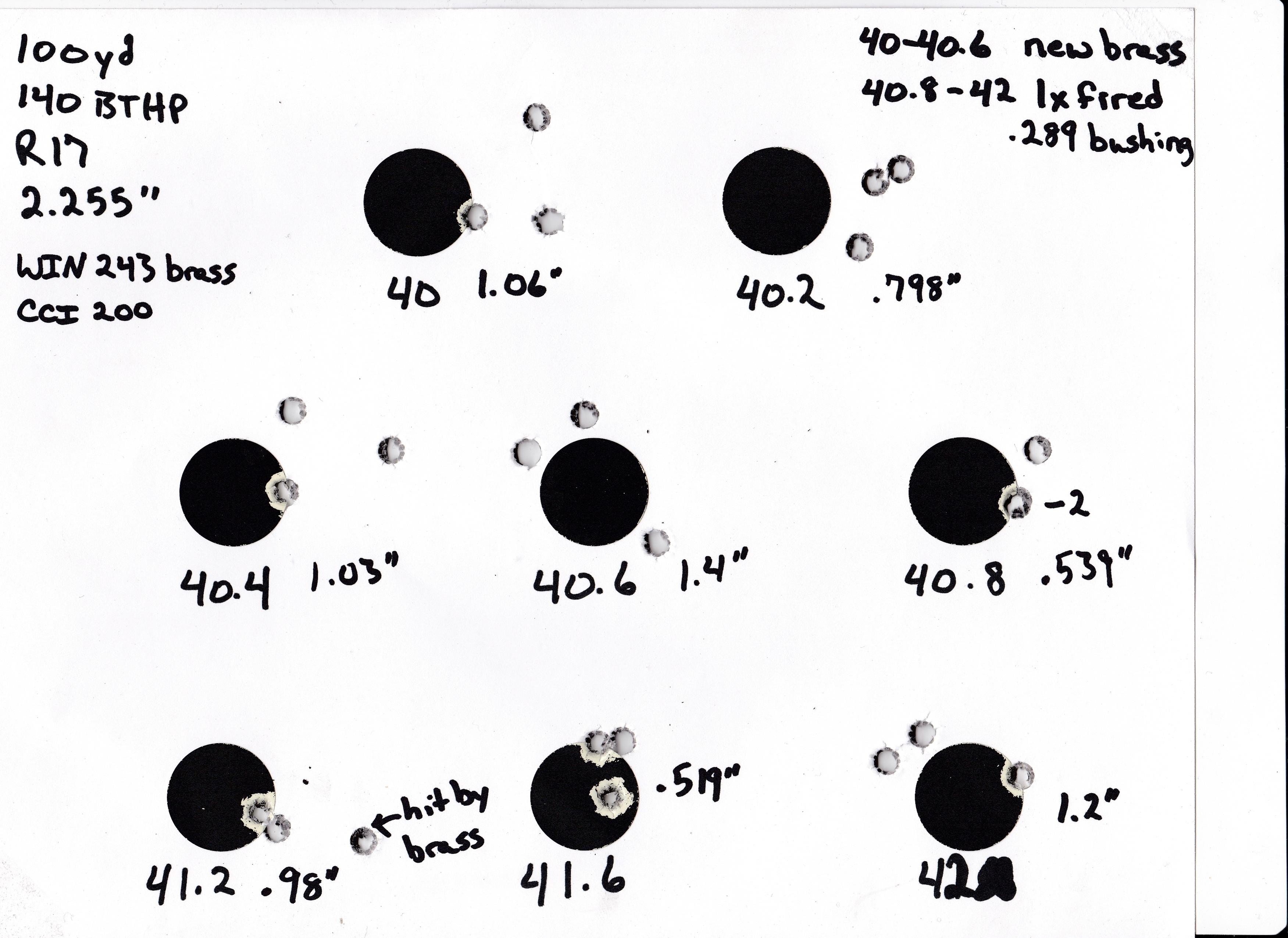

Did a little more work this past weekend with R17 and 140 Hornady BTHP's. The gun seems to like the combo, but it's finicky with the 243 brass until it's fireformed to the chamber. Picking up a good bit of case capacity and blowing the new brass out to fit really make it shine.
I found some decent accuracy early on with the new brass and 40.8gr but it wouldn't repeat on a subsequent range trip using the new 243 brass necked up, everything above that produced results from bad to horrid so I worked down the other way. I went from 40 back up to 40.6 in .2r increments and I think there is something to be had around 40.2, which would be fine for just blowing the cases out. MOA-ish will get me by there for just hitting steel at the range.
At the same time, I decided to work up from 40.8 to 42gr in some formed brass and see what there was to be had. I think I've got a pretty decent node there between 40.8 and 41.2gr, so I'm going to investigate this further. Note the "hit by brass" note on the 41.2 load, jackass beside me decided to stand up and shoot his Kriss. First round ejected the brass and smacked me right in the glasses as I was breaking the shot.......asshole.
Granted the results are nothing spectacular, but neither is the rifle. Just an untouched R700 action with an AAC barrel chopped to 20" and some good glass in a decent stock. It would reliably do .7 MOA with H4350 and 140's, but I guess they ran out of the lot of Unicorn farts they blessed the 4350 with. R17 was my next best choice with such a "short" barrel, but it's looking like I should have tried it sooner.

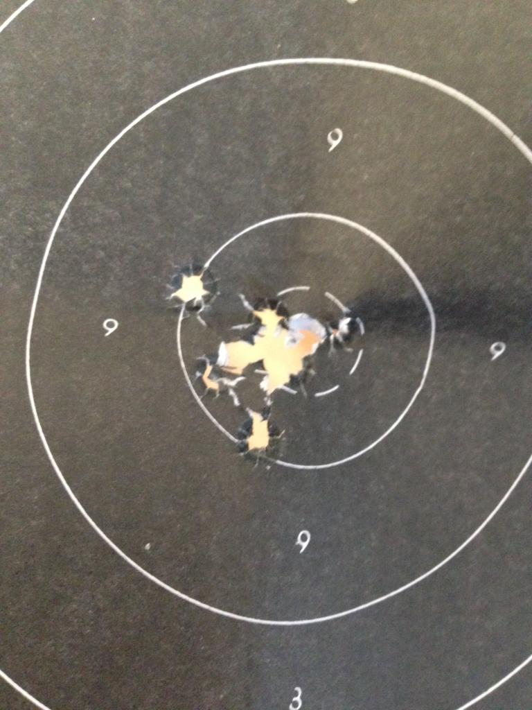

Let my 15 year old son zero my new PM11 on my 260 DTA. Load was 142 SMKs over 42.5gr RE-17, in Lapua brass with CCI bench rest primers.
8 shot confirmation group @ 100 metres was .620 of an inch, which included a shot he pulled. I walked away from the firing point as I was never going to replicate that. Trouble is he now no longer wants his .308 AW. He must have a DTA of his own!
