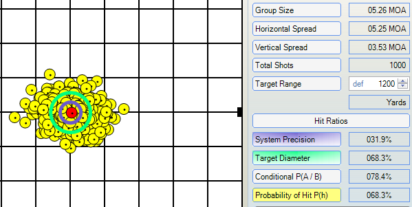

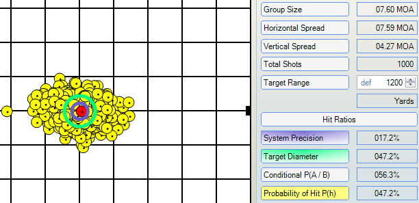

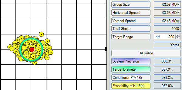

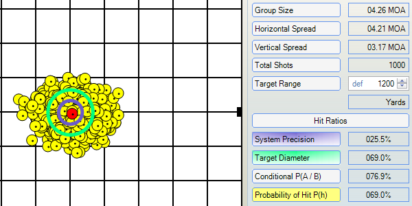

Long Range - Hit Probability Analysis
375 - 344 ULD - 3800 - 88% Hit
From a 338LM, 300gr Bergers and 300SMK at 2800fps and 2700fps, and 250gr Berger Hybrids at 2950fps and 2850fps...if you're so inclined.
Thanks
338 LAPUA - 300 OTM - 2700 - 32% Hit
338 LAPUA - 300 OTM - 2800 - 40% Hit
338 LAPUA - 300 SMK - 2700 - 31% Hit
338 LAPUA - 300 SMK - 2800 - 34% Hit
300 win mag-225 ELDM-2850
300 win mag-215 hybrid-2890

.5 MOA 6mm - 105 - 2950 - 47% Hit - 9.9Lbs. of RECOIL
.5 MOA 6.5mm - 147 - 2750 - 68% Hit - 13.58Lbs. of RECOIL
.5 MOA 7mm - 180 - 2550 - 69% Hit - 15.94 Lbs. of RECOIL
