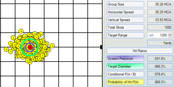

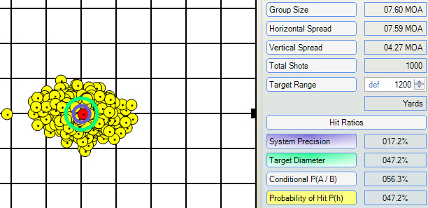

Long Range - Hit Probability Analysis
.5 MOA 6mm - 105 - 2950 - 47% Hit - 9.9Lbs. of RECOIL
.5 MOA 6.5mm - 147 - 2750 - 68% Hit - 13.58Lbs. of RECOIL
.5 MOA 7mm - 180 - 2550 - 69% Hit - 15.94 Lbs. of RECOIL
Yeah I don't think anyone will disagree a heavier bullet at long range has a higher probability. It's a balance that 7mm would be viable in a OK (where I live) comp that stretches out a ways. But a 6.5 might be the best compromise still in that scenario. I'm not recoil sensitive but since I started shooting positional stuff more recently I've started to understand why people do 6mm.

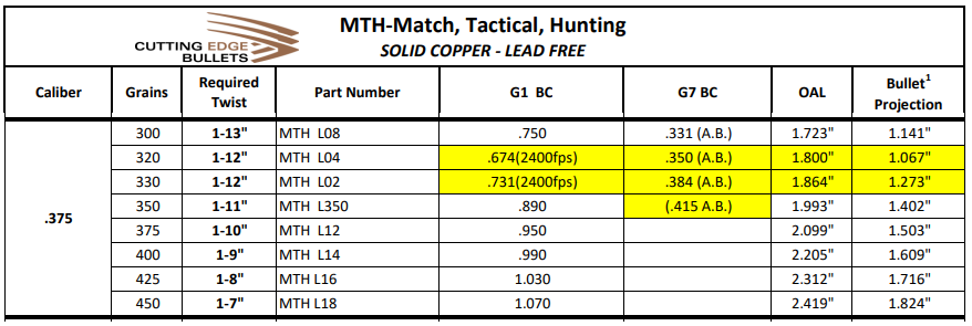

Have you run the numbers on 375 Lethal Magnum? Specs are 3500fps @ 350 grain and 3200 fps @ 400 grain (Cutting Edge, but not sure which the AB crew are running, probably something different than below)

So basically it looks like what would be a 7/300 shooting 180 ELD-M at 3300 gives you the best hit chance, but the most recoil.

Could you do 225 eldm's going 3005fps with an accuracy of .5 moa?

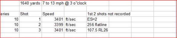

I just bumped into this thread and given the work and time everyone's put in here I'm a little reluctant to ask--but can't help myself: How about a 338 LMAI using Flatline 256s at 3400 with a .5 moa? These are coming out of a gain twist 1:9.5-1:8 32" barrel and the stated G7 is .434.
