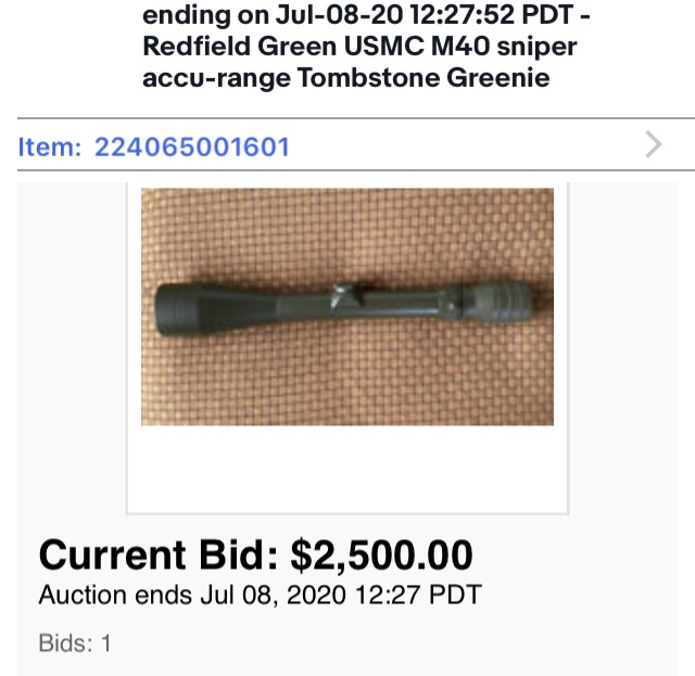

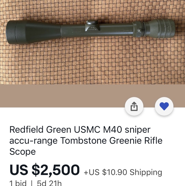

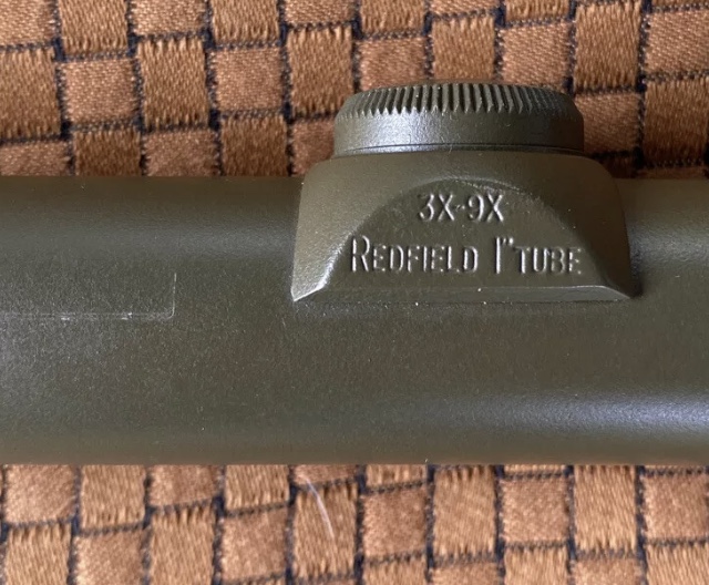

Recent eBay listing. Looks like it’s painted a matte O.D. green. Has one $2500 bid😬

USMCSGT0331: help us novice collectors understand the differences between the current eBay offering starting at $2500 and And the other offering starting at $8000. Thanks
I'll do what I can to help with knowledge on these scopes, over the years I've owned 10 original greenies. I currently have 8, I sold one and gave another to a good friend.
NOT REAL USMC SCOPE:
The scope at $2,500 is a correct scope in terms of features, but it's not a USMC scope. It's a Gen 1 Redfield Accu-Range (not their Accu-Trac) 3-9x40 scope with the flat turret caps and long magnification throw lever. It also has the correct 600 rangefinder (tombstone) and is close to the USMC serial number range.
Unfortunately, this scope was a shiny black anodized civilian model that was painted green. This would be the perfect scope to send out for green anodizing. This specific scope with it's features and color of green paint would still look great on a clone rifle, but it's only worth a few hundred bucks. It's just not an original USMC scope and it will never be one.

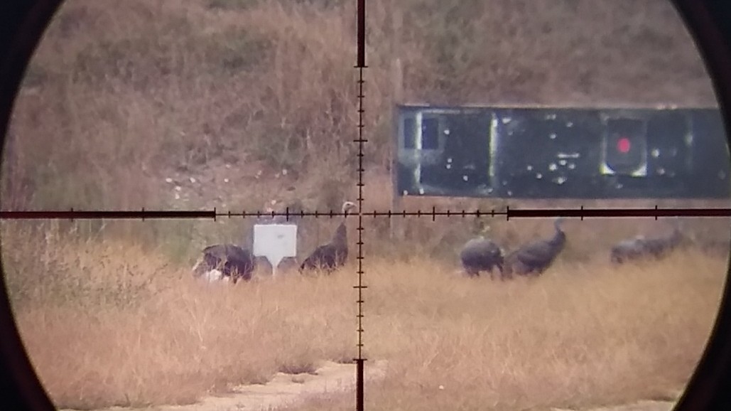

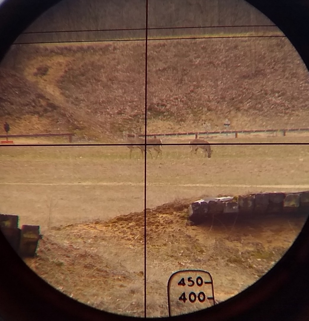

That is a great post. Using the SFP to your advantage by splitting the power is a great bit of knowledge that I don’t think many take advantage of. We do it quite often while shooting .22’s out to 400.
My old Redfield puts me smack dab in no mans land for holdovers. I have the rifle zeroed at 400Y and then hold under/over from there.
Thankfully all my targets stay still and don’t shoot back when I send one over the top 😁

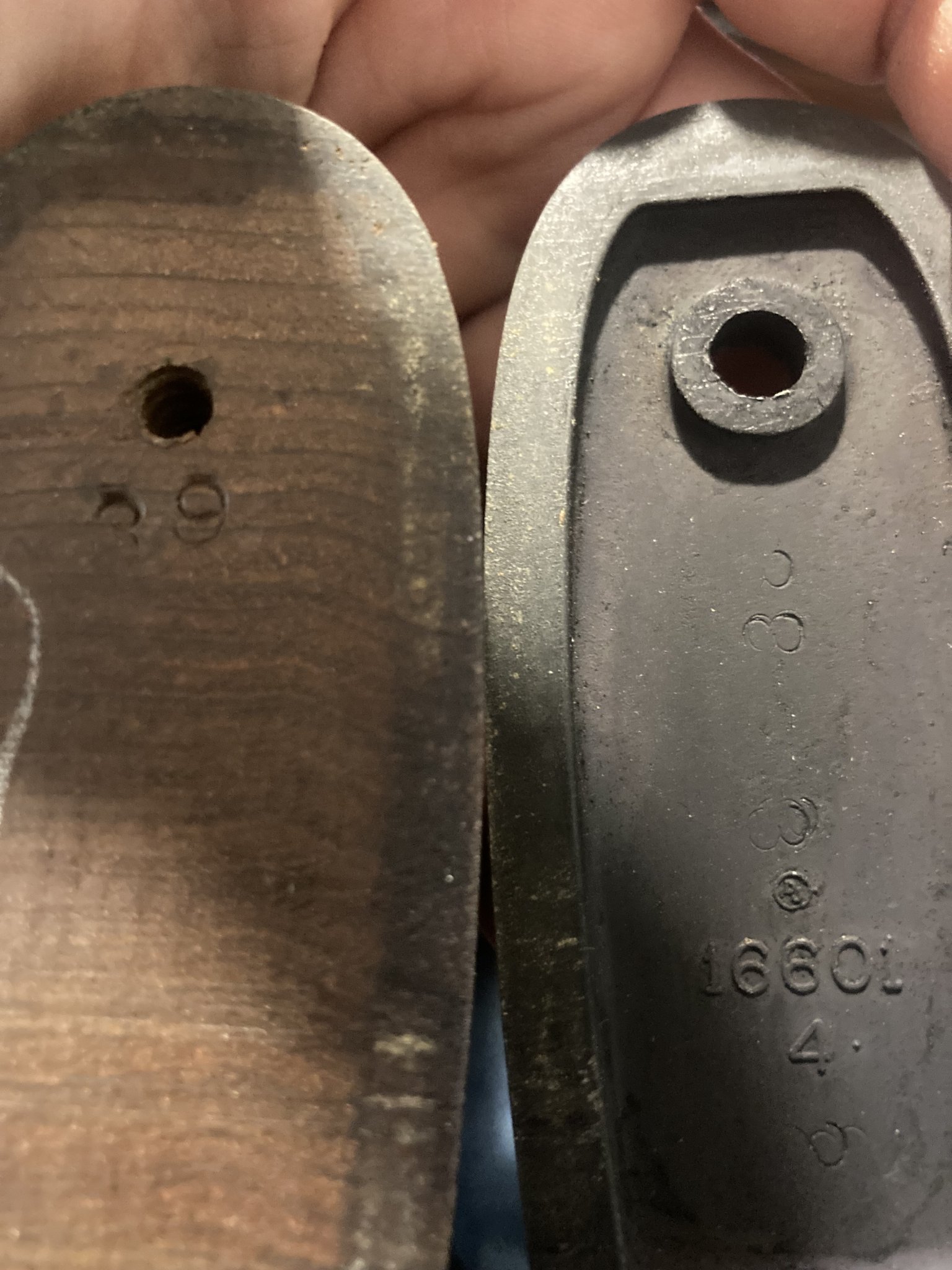

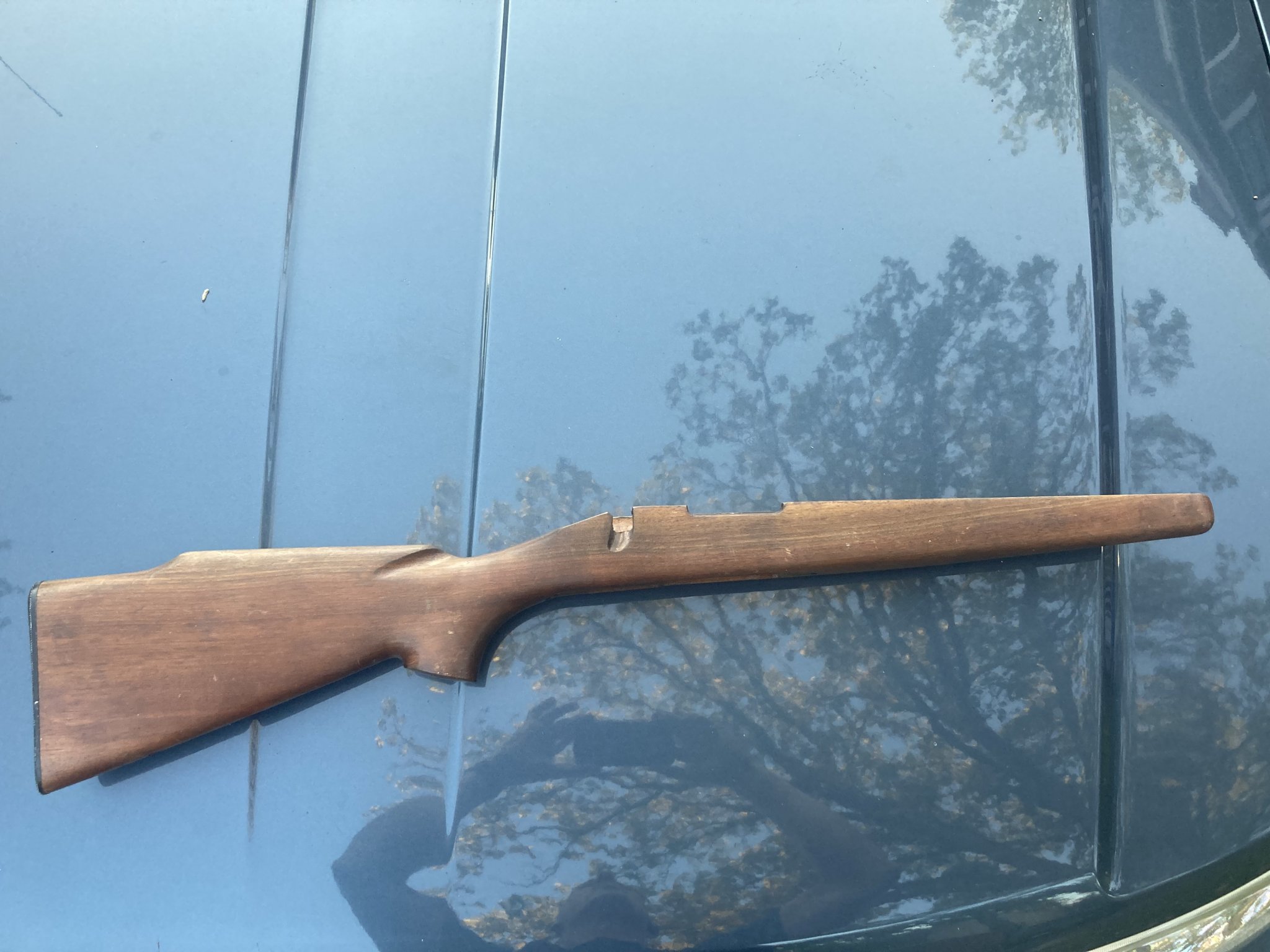

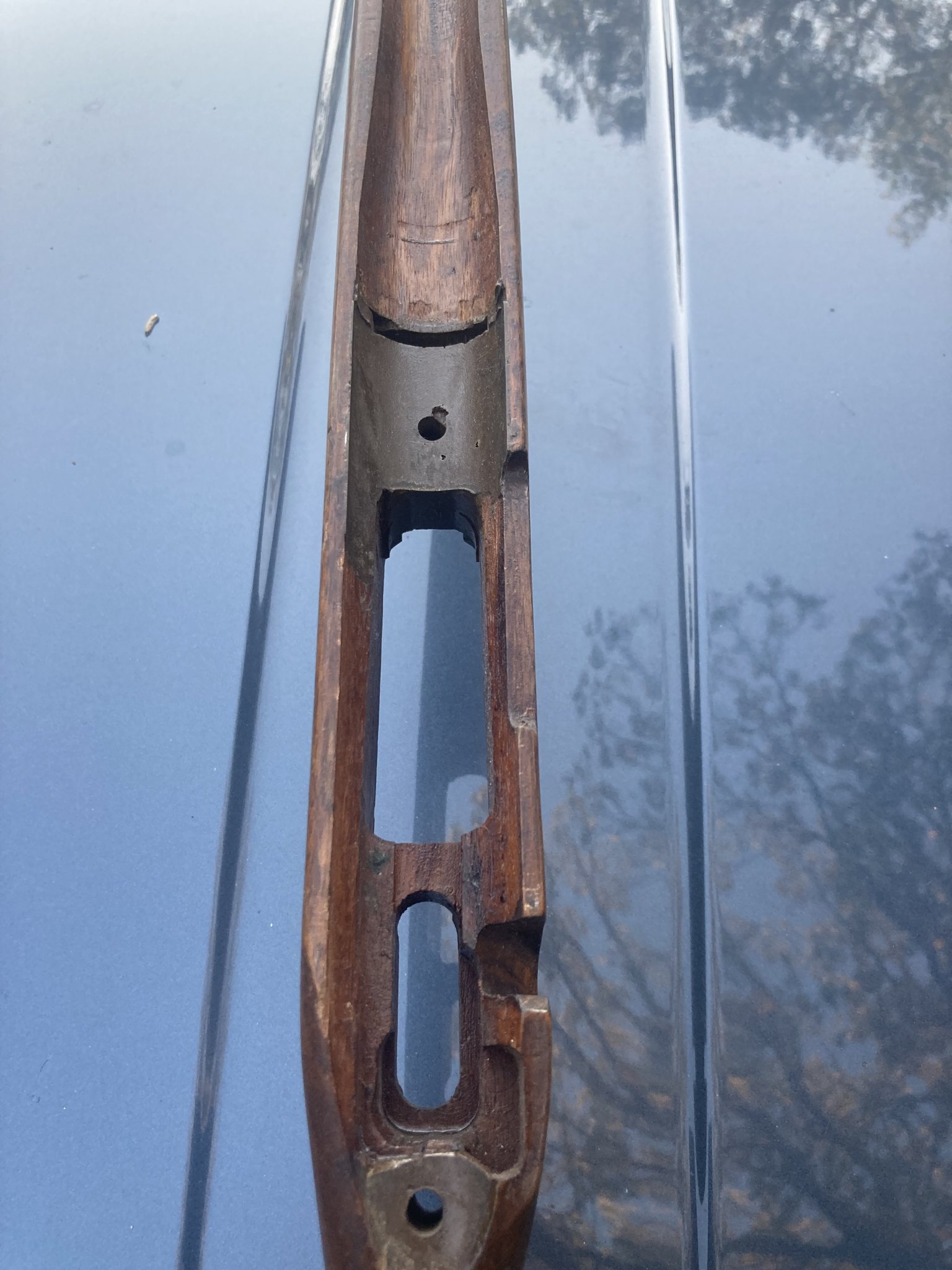

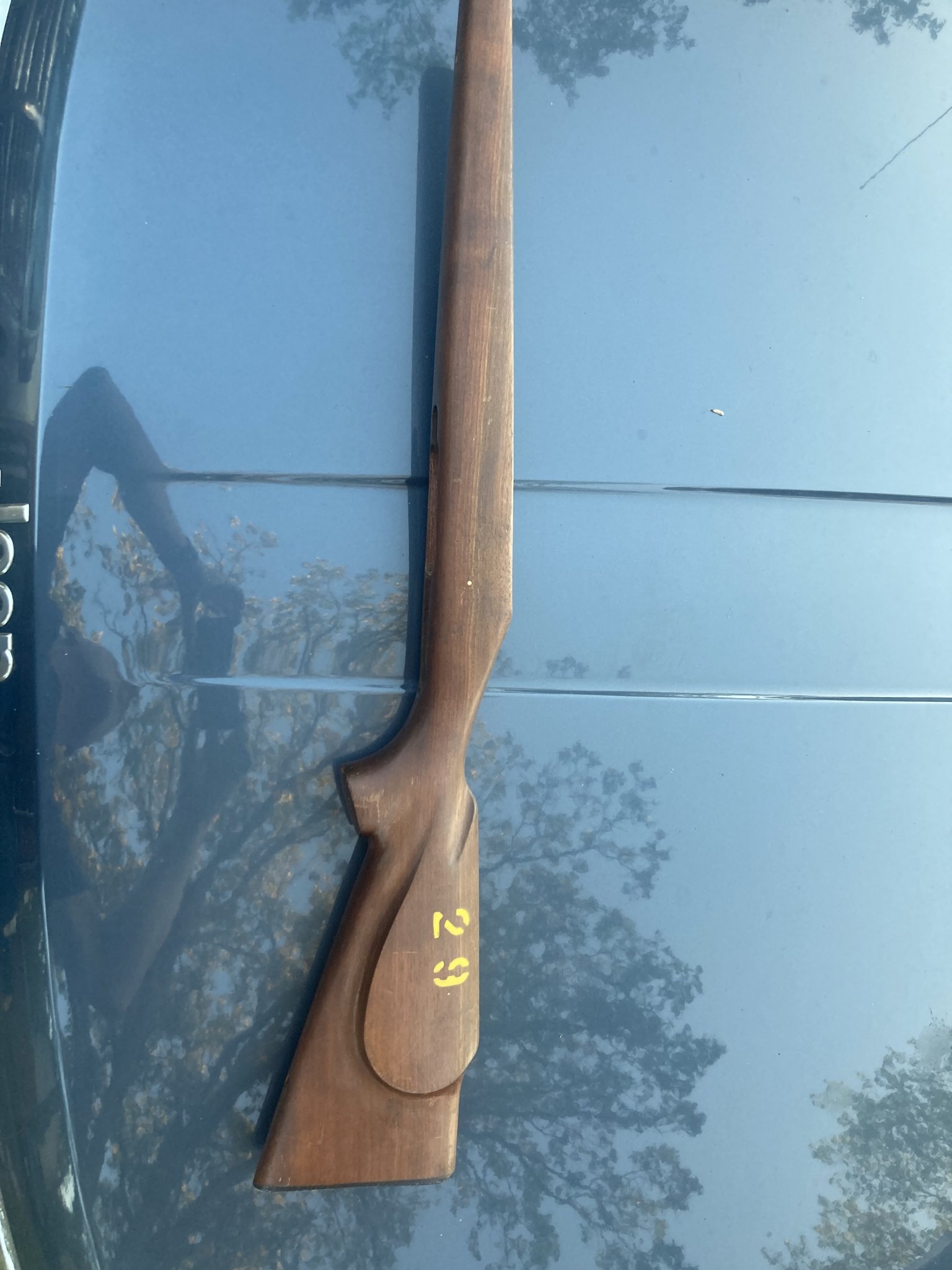

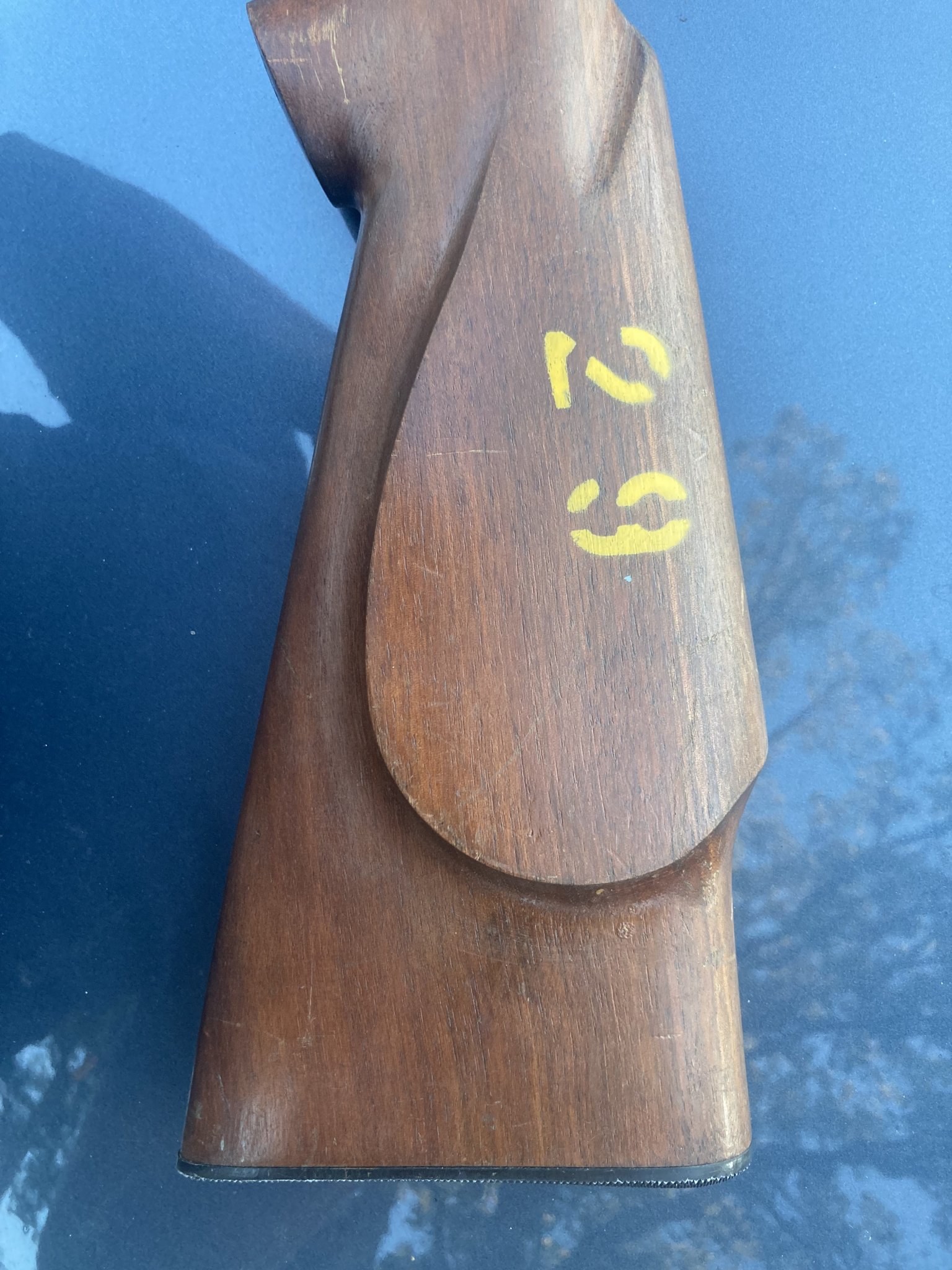

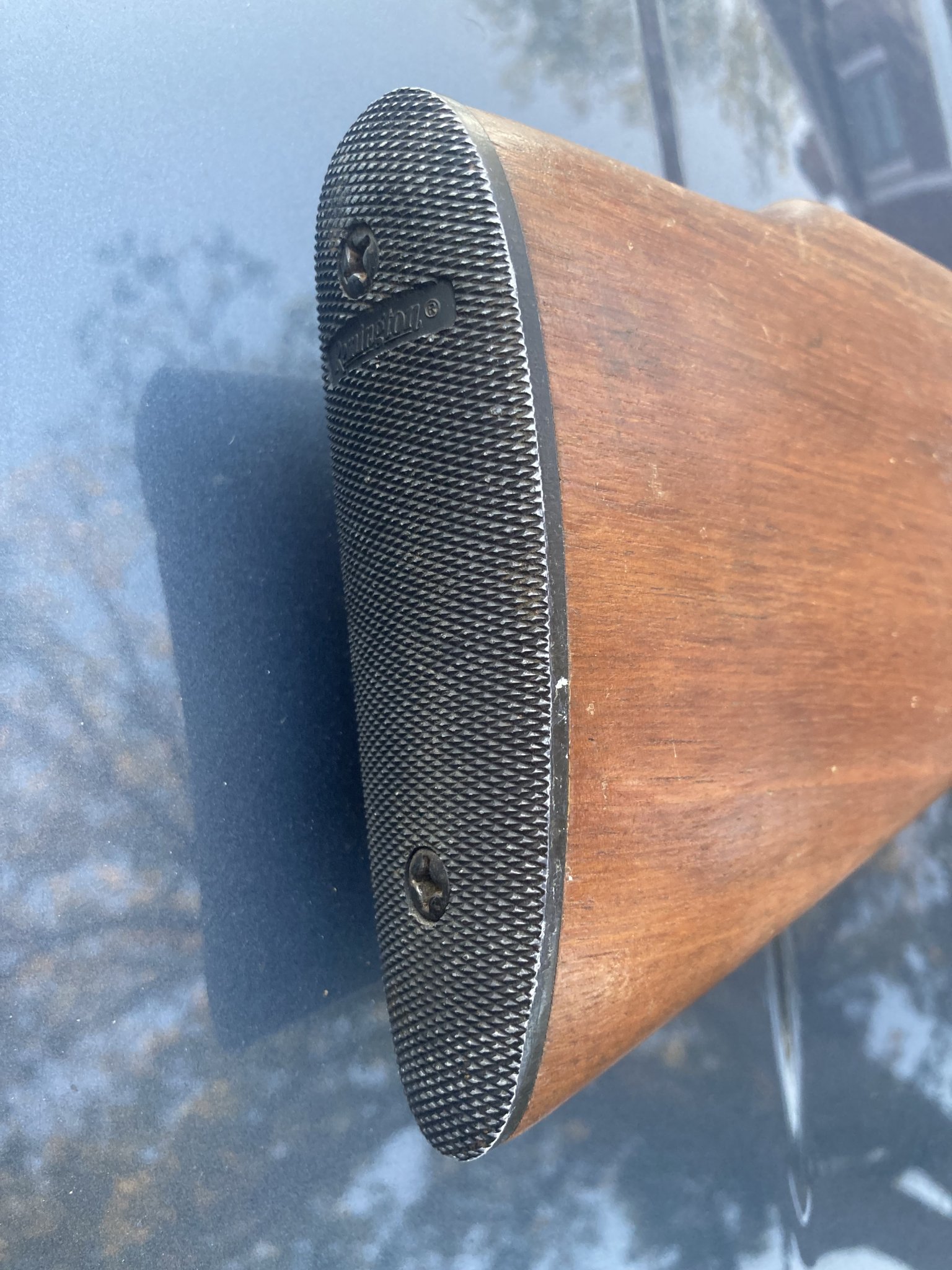

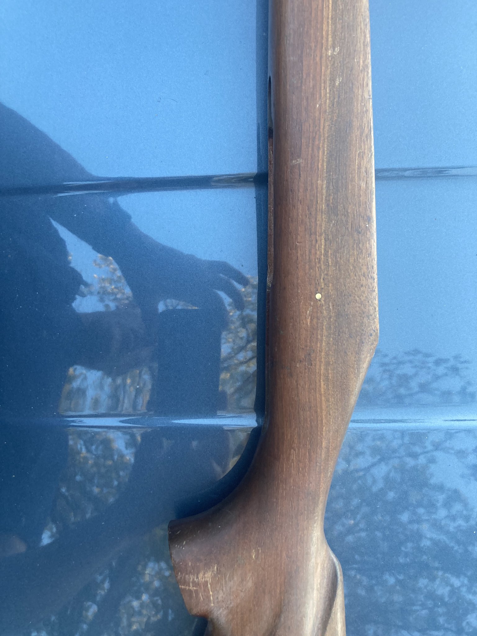

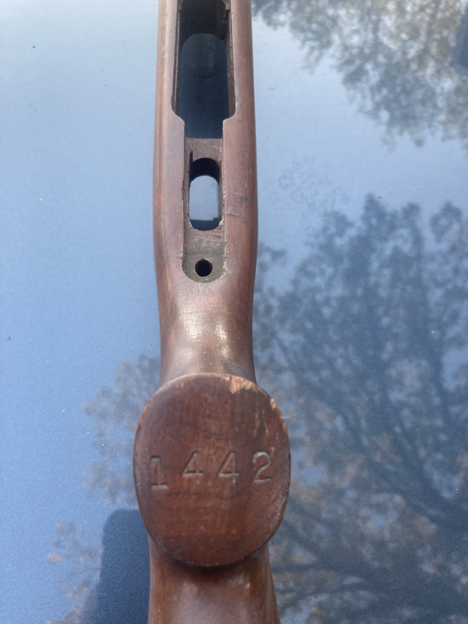

Looking for a Knowledgeable/informed info on this Stock;

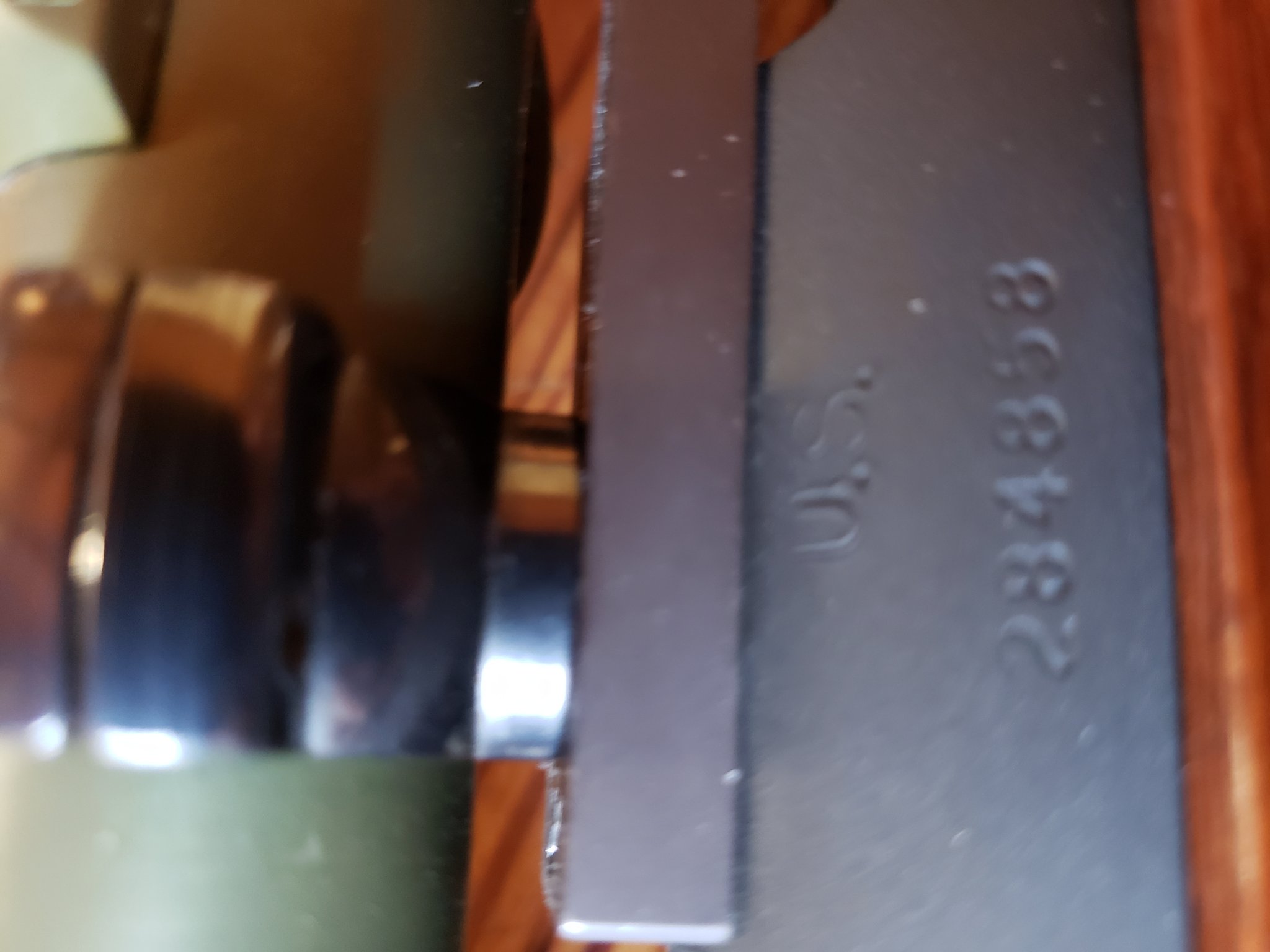

Nice stock, and I'll defer to others, but the serial # stamp on bottom of pistol grip looks like a military issued M40. (The USMC ordered the most M40s in 1966, but and US Air Force and US Navy also ordered about 120 rifles as well, circa 1966-69).

Looking for a Knowledgeable/informed on this Stock;
Looks like a legit stock made in 1966. Pull the buttplate off and post photos. There should be a production control number that matches on the stock and the buttplate, more than likely it will be a 2 digit number.

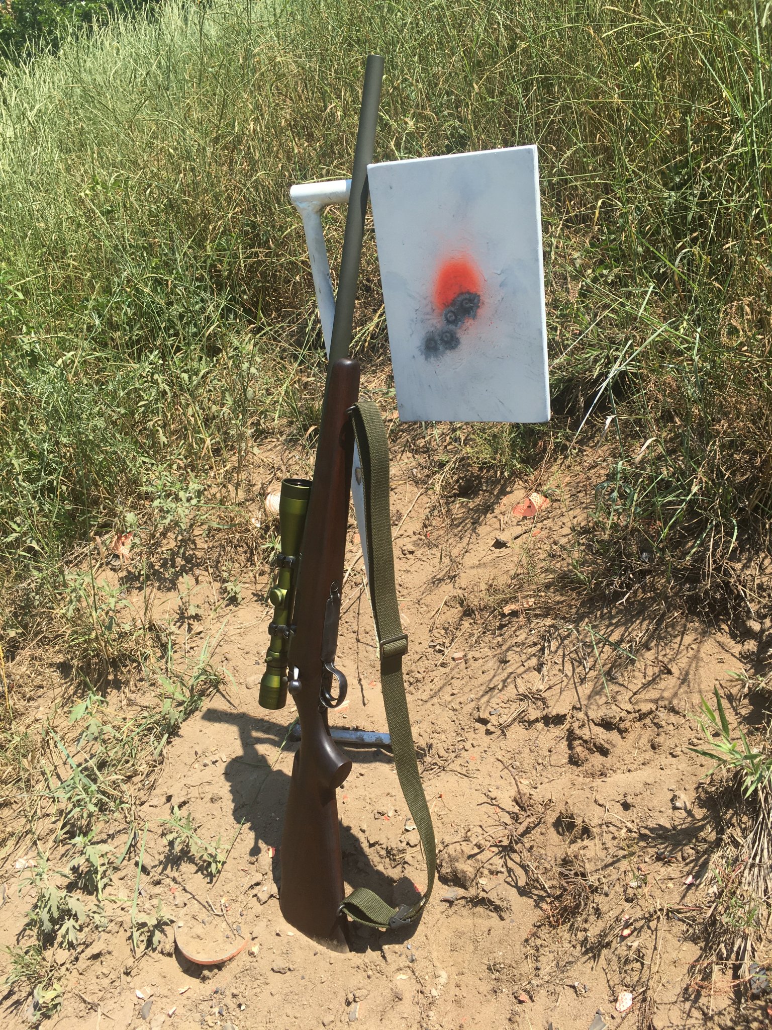

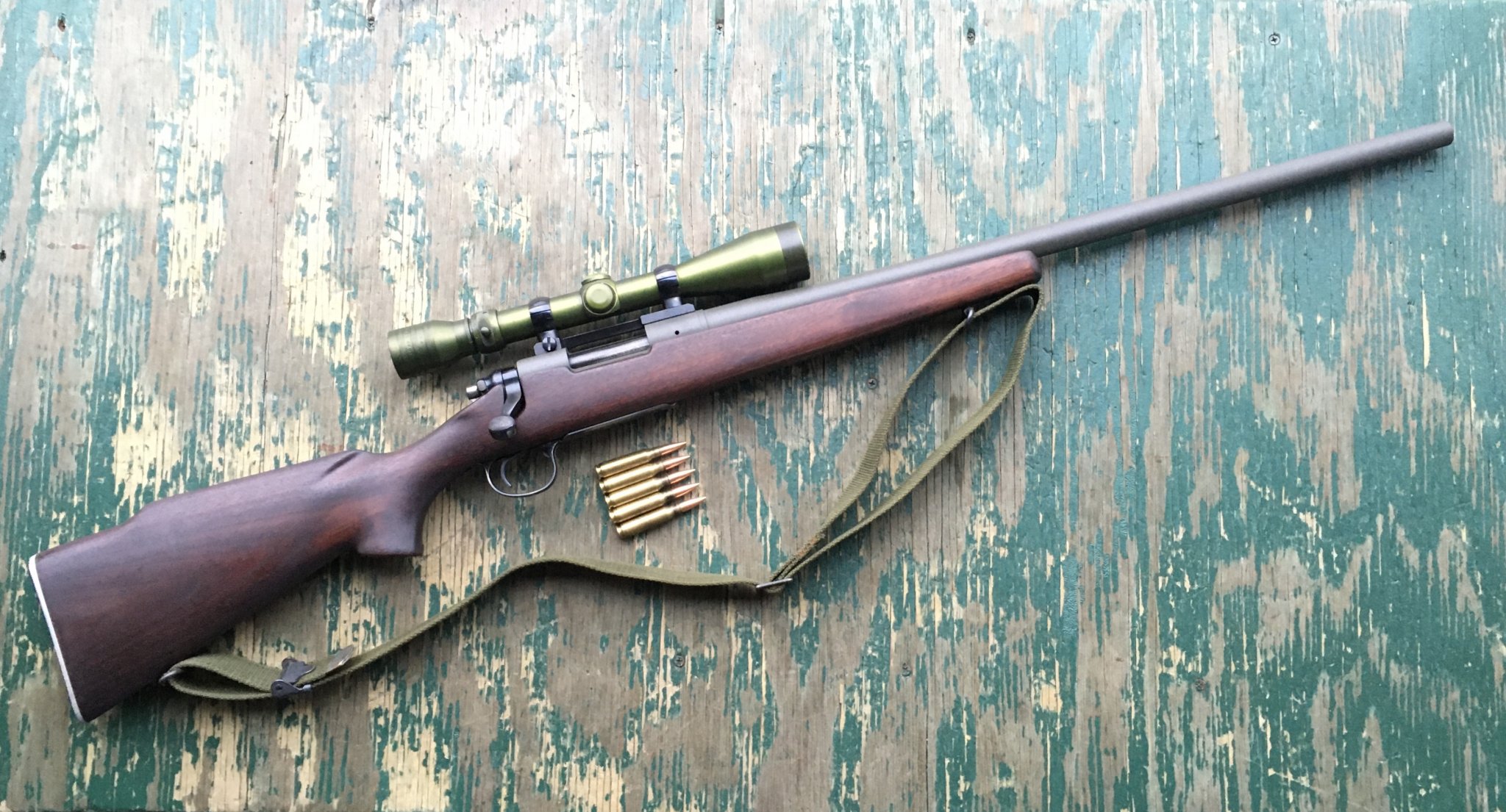

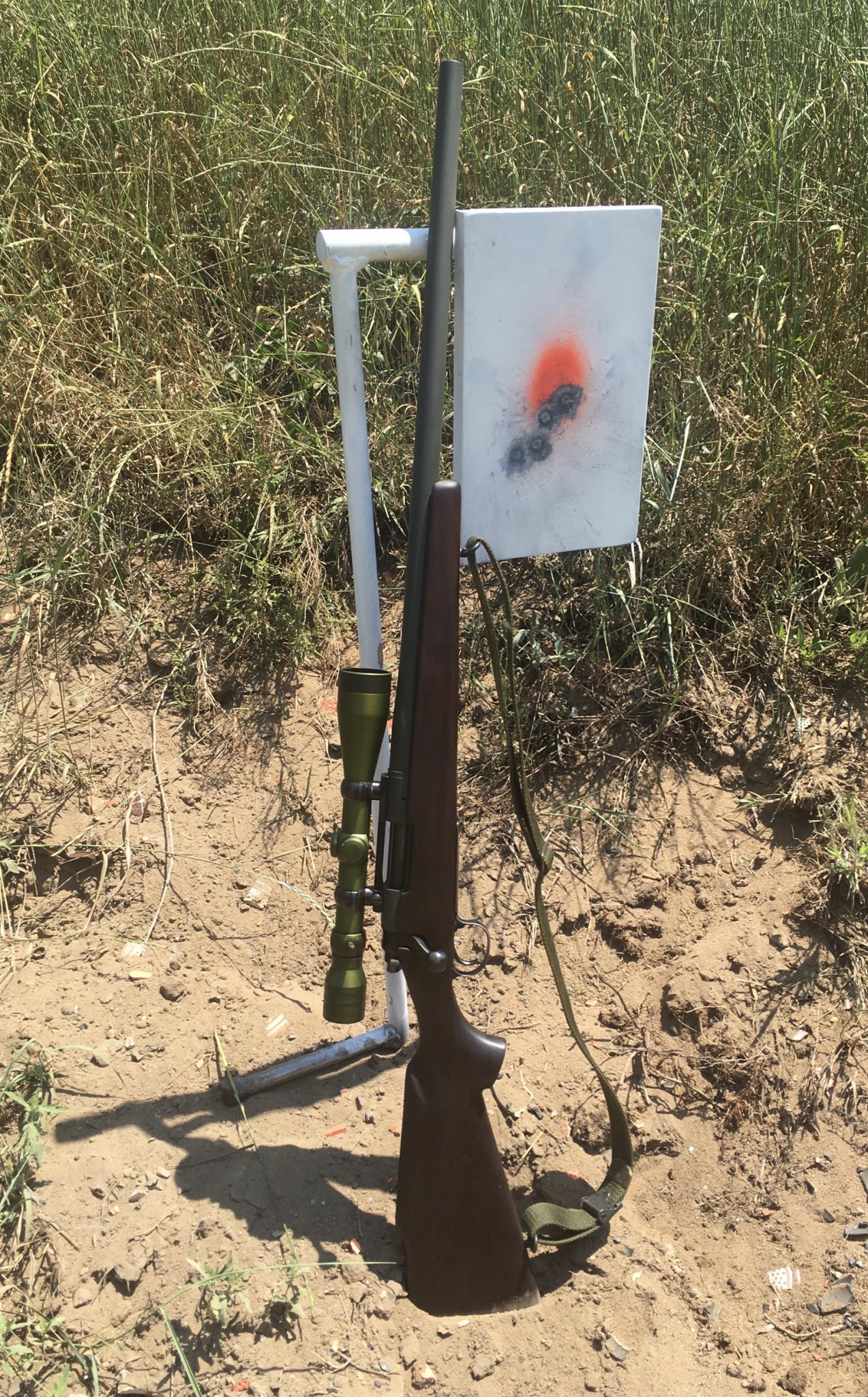

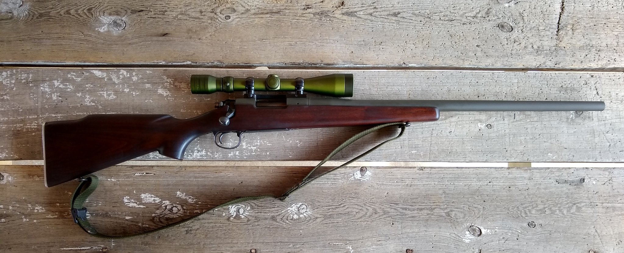

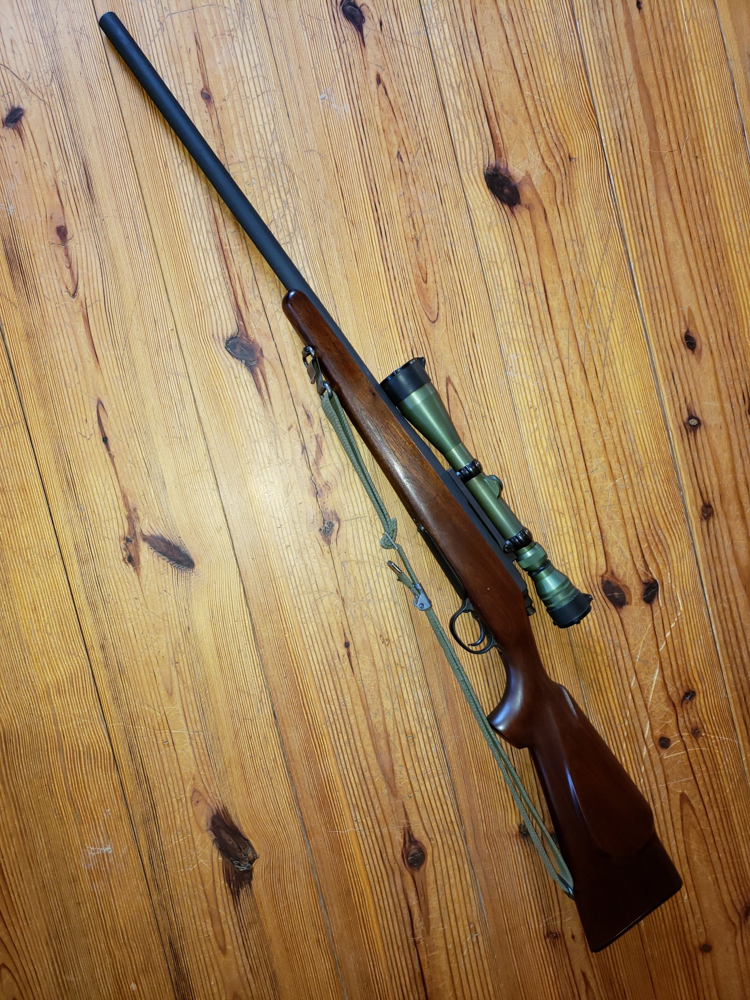

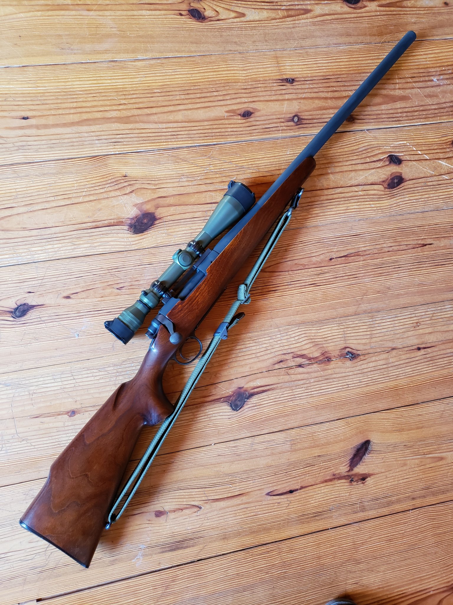

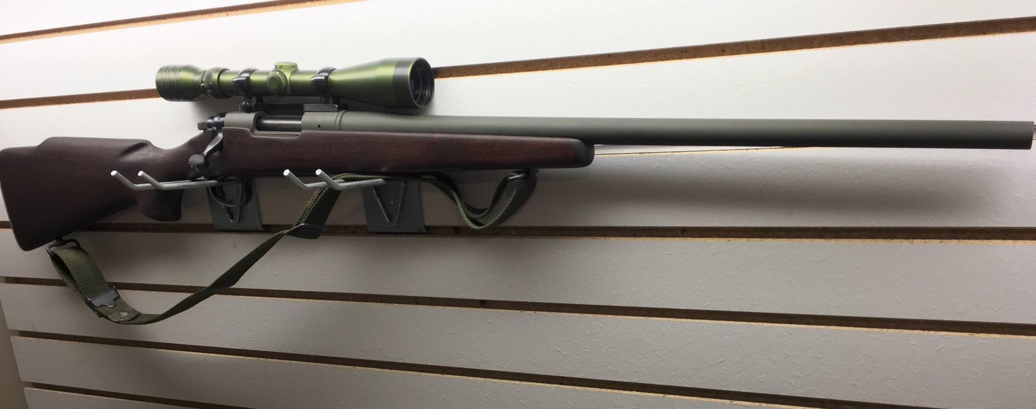

Scope looks great šŸ‘ Good job. I really like the whole rifle. I have a 6 digit receiver and most other parts gathered up for a build. Just need the right barrel now and a ā€œbuilderā€.
Looks like one of my scopes, if I'm not mistaken.
Anyway, I'm getting ready to close on a place in Chattanooga, so operations will resume soon. Divorce and NYC life had limited me. They would probably deem my scopes as "firearms". Anyway, I'm out of here in a few weeks, once I'm settled in, I'll get the tanks all setup, dust off my memory, and start things up again for you guys. It's been a long 4 years....
Customer in waiting…love to have a standard early Redfield strung with mil dots and anodized……
Another customer in waiting. I have my scope and am ready to ship it out to you. Dreams do come true. Lol

Honored that you think it looks like your fine work sir.
In the place of anodizing I stripped the original finish while assembed, finished the aluminum to look the part of ano., and mixed up a custom o.d. green candy coat at my brother's body shop.
Take a peek at the first page of this post and you can see the process.
