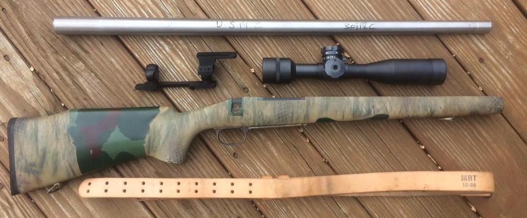

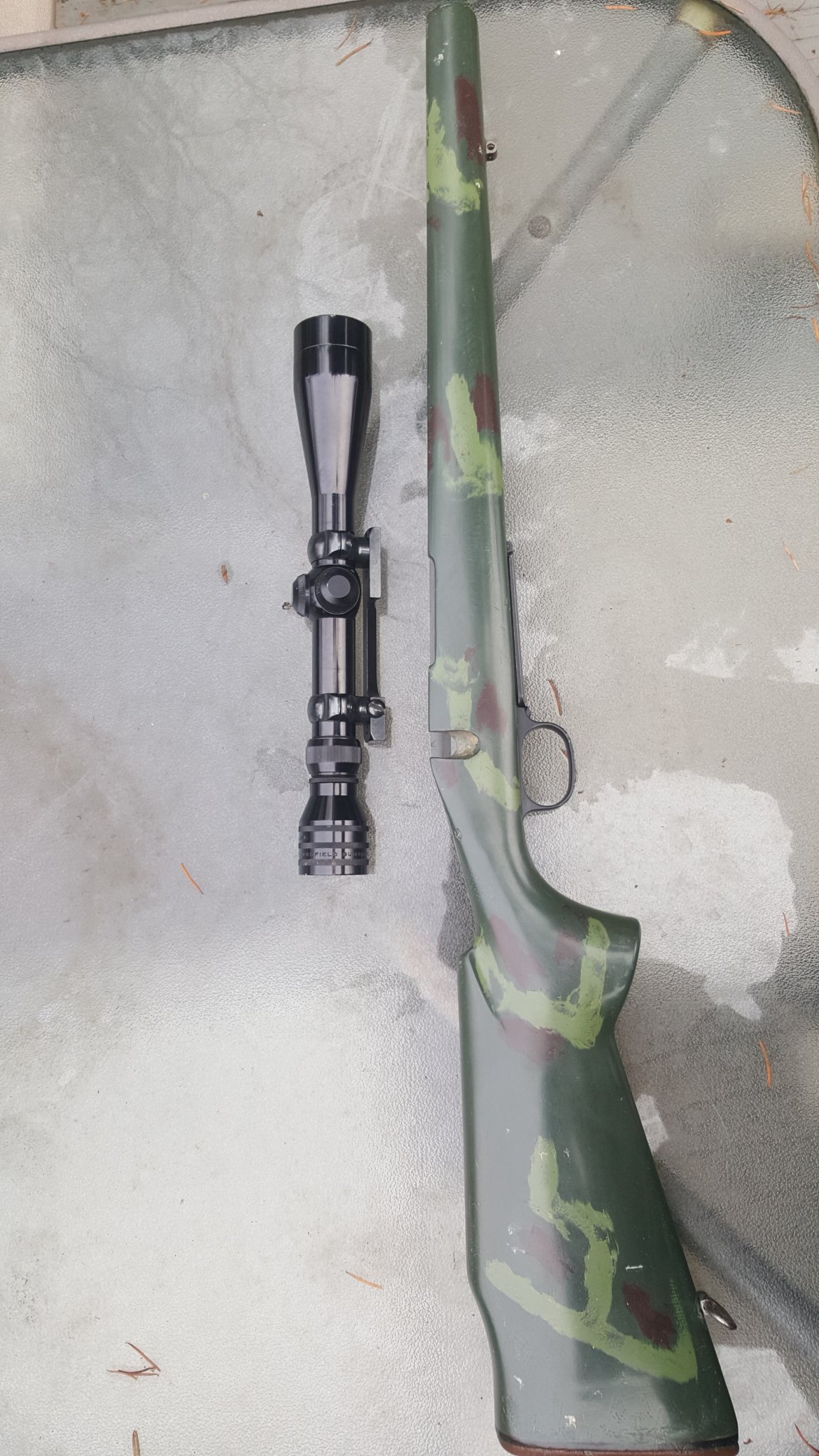

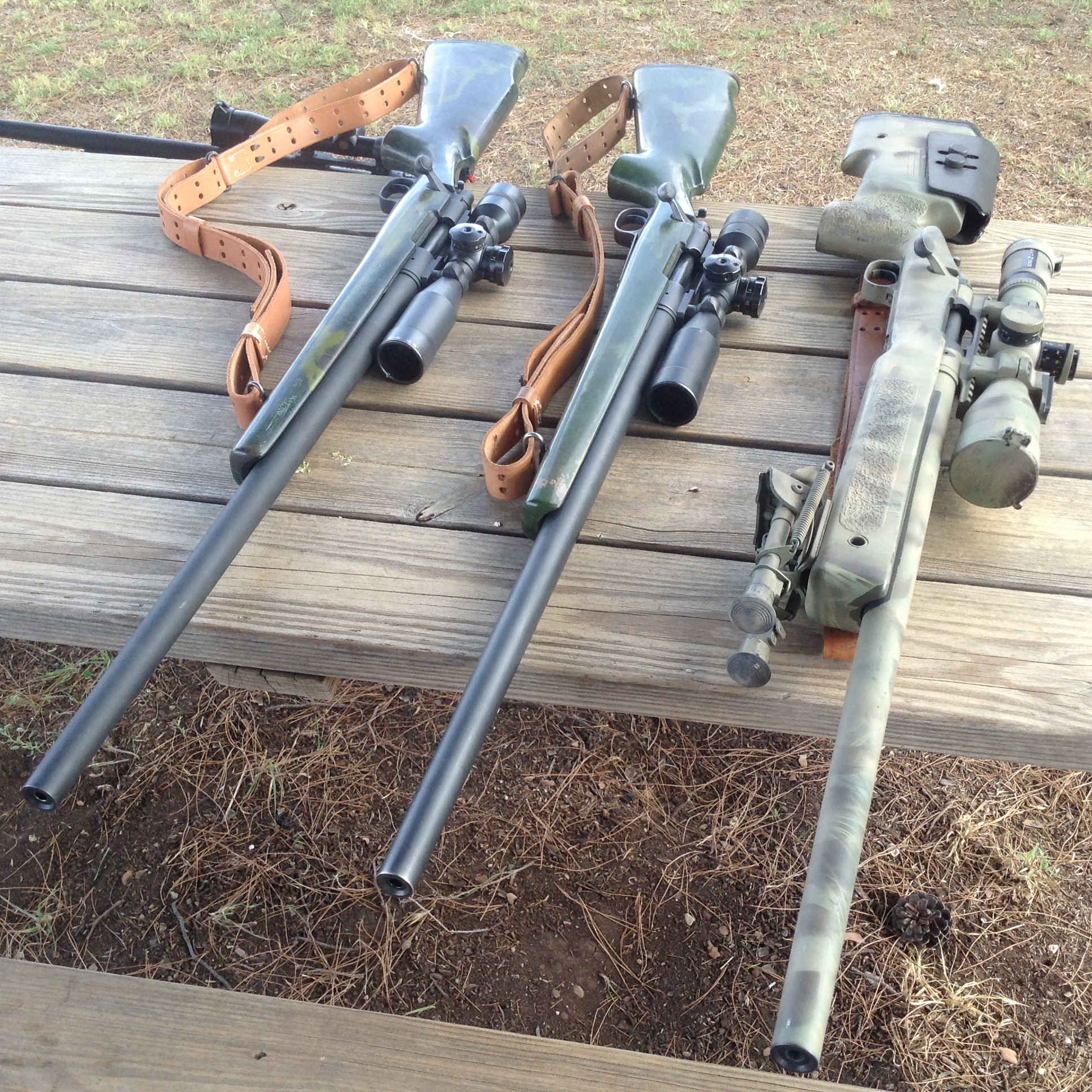

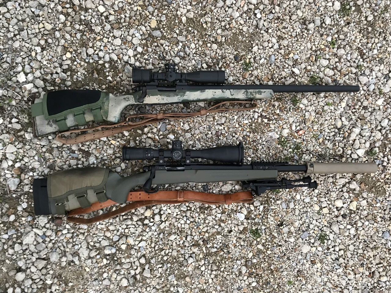

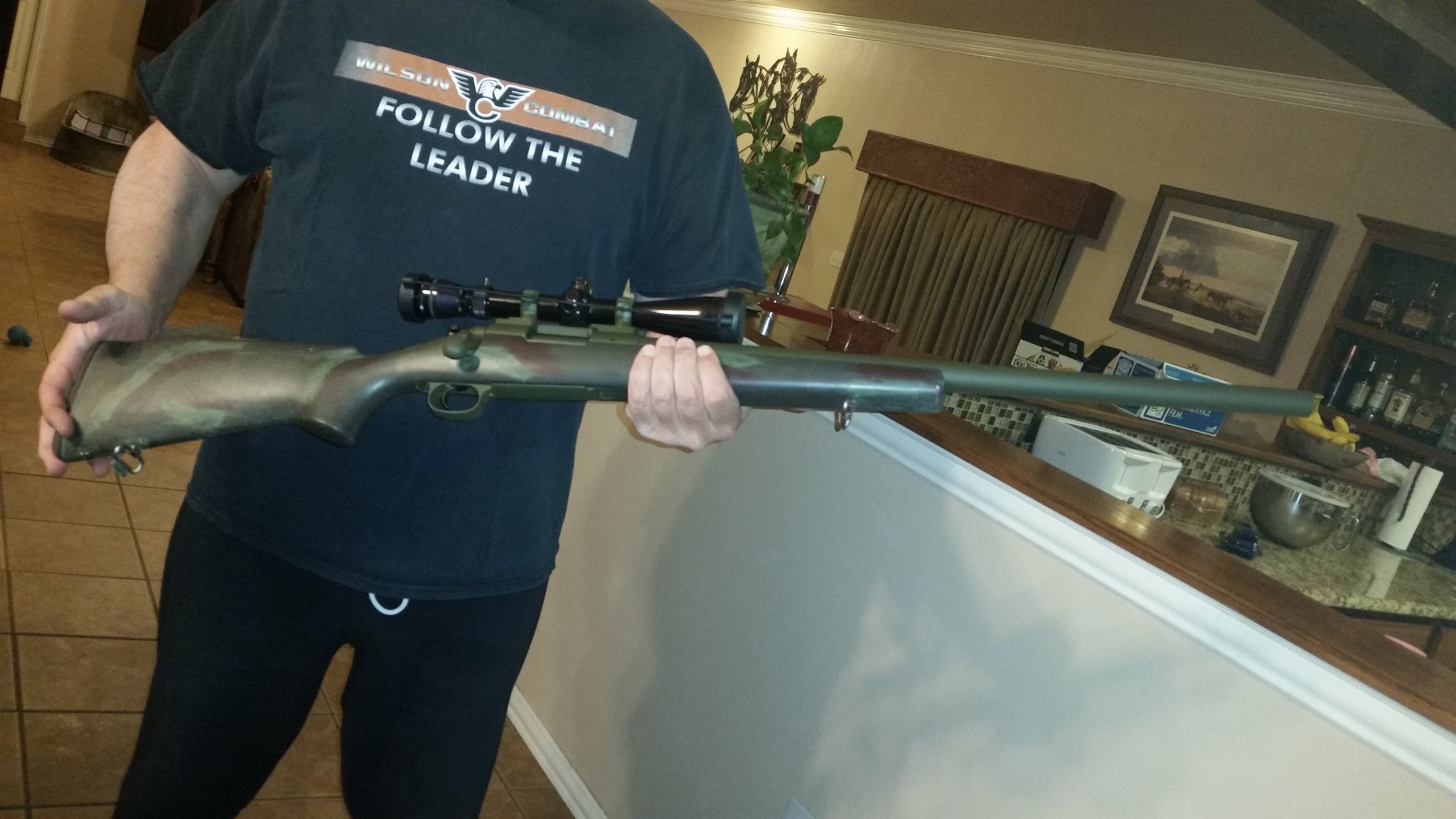

My latest build. Original plans were early model using the Accu-range Redfield and 2nd Gen mount/rings. Now I'm leaning towards a USO or Unertl and doing an early GWOT rifle as pictured.
Of note is the ground front swivel to facilitate bipod use.
Every time I see posts like these, I look close to see if one of my stocks is visible. Others have found theirs.

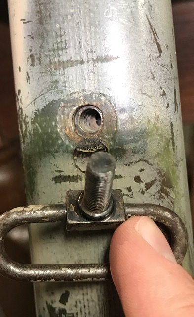

Bought a sling stud from a man that was making them threaded to match the McMillan threading in A1 stocks.
I ran a Harris for a short time than went back to standard sling swivel and bag for better shooting.
My case involves me shooting off a bench though so that may not be a fair assessment of the bipoded A1.
I intended to take my A1 to a Sig class next year. Ill be shooting on my belly and in that application I think the Harris will be great.

I plan on getting another standard swivel and tucking this one away. I don't plan on bipod use with this rifle. Ruck or modified M49 spotter tripod is about it.
Reactions: pmclaine
I just ordered a set of Wichitas this week. Super easy to deal with.
Unsure if you must order yours from McMillan to match threading or if McMillan uses oem thread.
I paid $70 for the pair - wood screw rear. machine screw with nut front for my needed application.

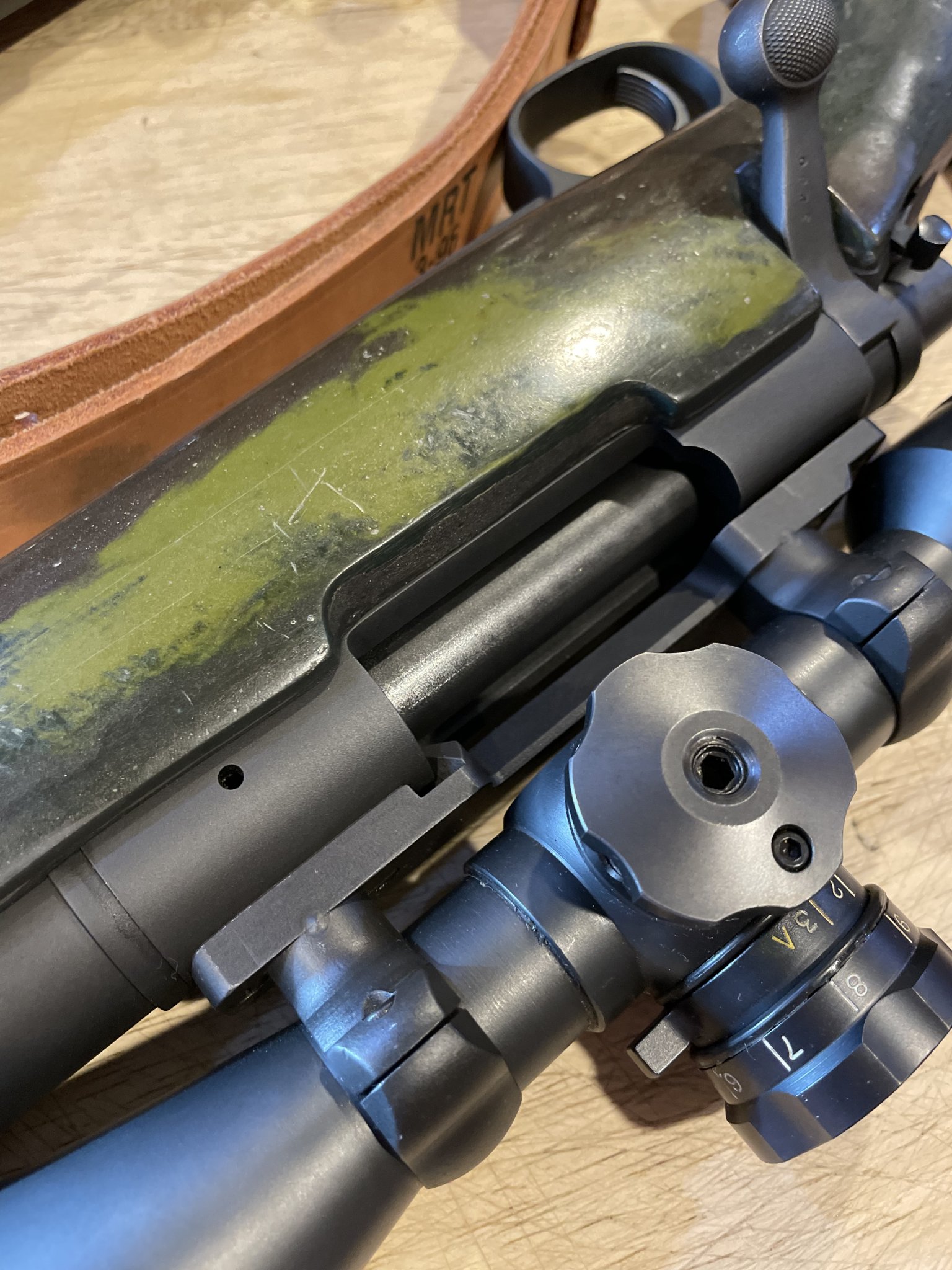

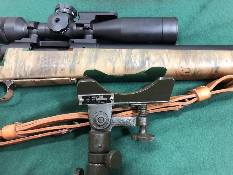

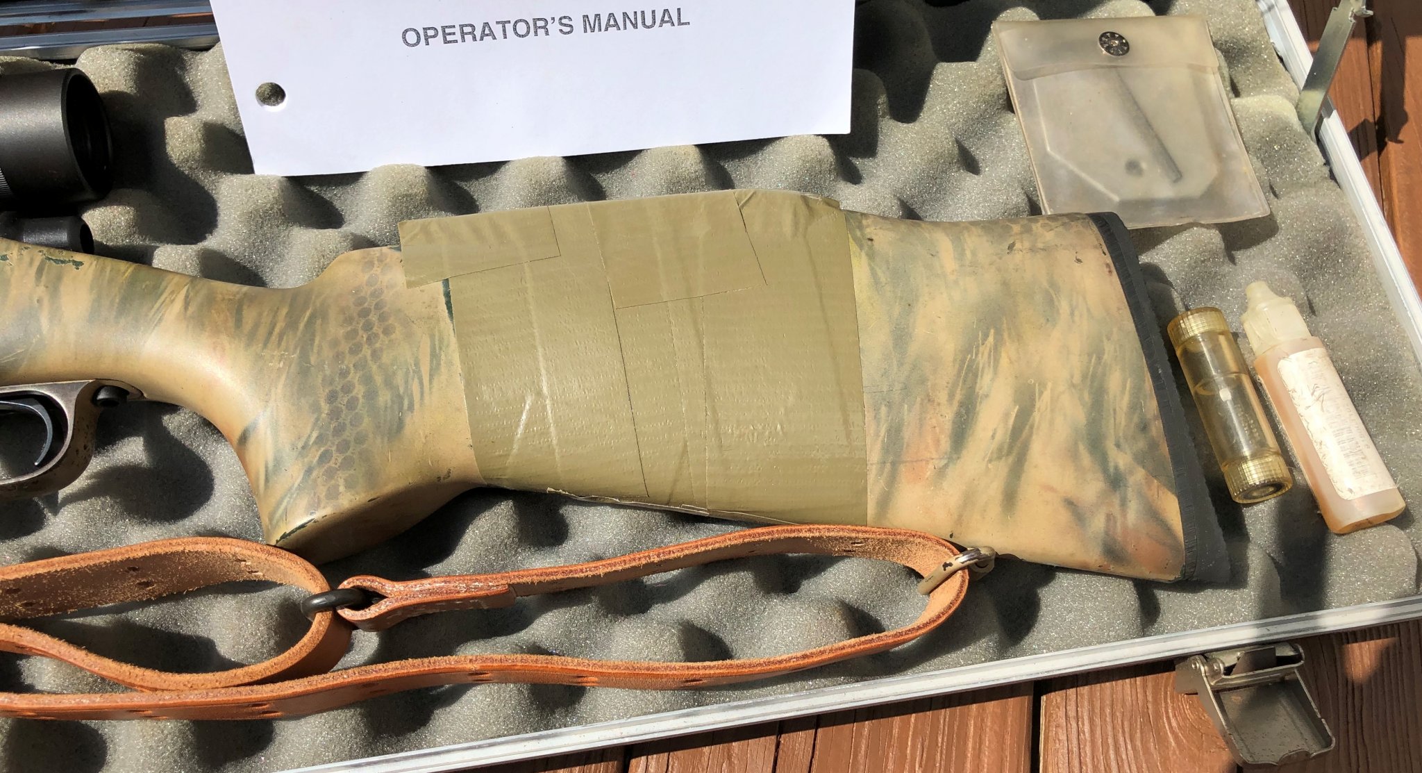

Well, I see a couple of the old M49 Observation spotting scopes in post #54, so I'll digress for just a moment, and post a couple of pics that are not of an M40A1 being used in service, but its a 'return' or M40A1 'take-off' stock that is a little unique in that it still has its camo from when it was painted by a Scout-Sniper while it was in service. I'm posting it mainly b/c it has one interesting 'bald spot' on the forend from its prior service life...
....a former scout sniper who inspected my return stock told me the unpainted or 'bald spot' under the forend, was due to the rifle being painted while it sat in the tripod used with the old M49 Observation/spotting scope. So I pulled out my vintage M15 tripod to compare, and sure enough, the pattern matches...
...just a random observation on my M40A1 return stock. Yes, it is only a replica and this thread is for M40A1 pics while in service, but I thought I'd share as the stock still has original paint/patina from its prior service life. I have not seen this before in the other pics on this thread. (FWIW, attached is the "restored" improvised cheek piece, using some military sleeping mat material, and OD duct tape).

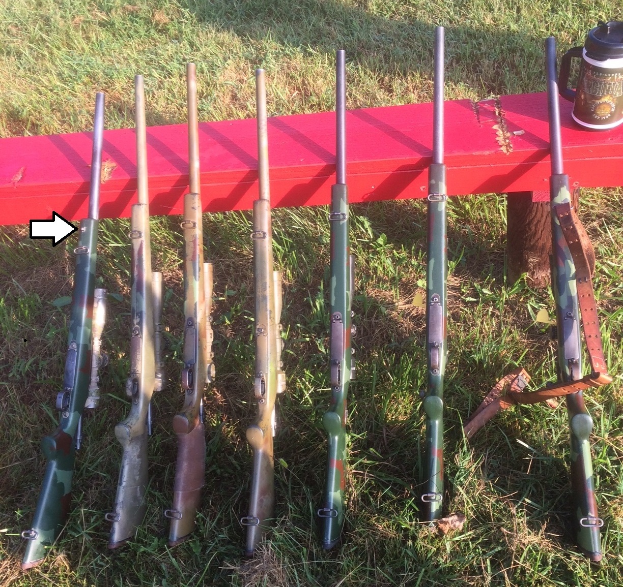

The M40A1 obviously didn't come with bipod studs.....but I have noted one of them did acquire a bipod stud at some point. (Here's a pic of 7 real USMC M40A1s kept at Quantico, circa 2016). I call that rifle on the left "Mr Bipod Stud." (2nd one from left I call "Mr Super Grade" due to bottom metal stamping, and the 5th one from the left I call "Mr Black" due to its black buttpad. Some of these rifles show small odd-ball variances)
....that said, I think a replacing the front swivel for a bipod stud is a more elegant solution. when possible.
Well the problem I have or (I think I have) is with my female Wichita threads.
I installed the SDwhirlwind bipod stud that has the same thread pitch as Wichita.
But when I go to tighten the bipod down its starts pulling out. I guess the threads are dilapidated?
You can fill the hole with bedding compound.
I'd just like to have the bipod to have the ease of not lugging bags around and ability to setup quickly.
More versatile.
My M40A1 clone was built with a bipod stud on it in front of the Wichita sling mount.
But after shooting it with the bipod and then off my ruck, I prefer to go old school. If I could I'd love to remove the bipod stud but I don't know how I would fill in the hole.
