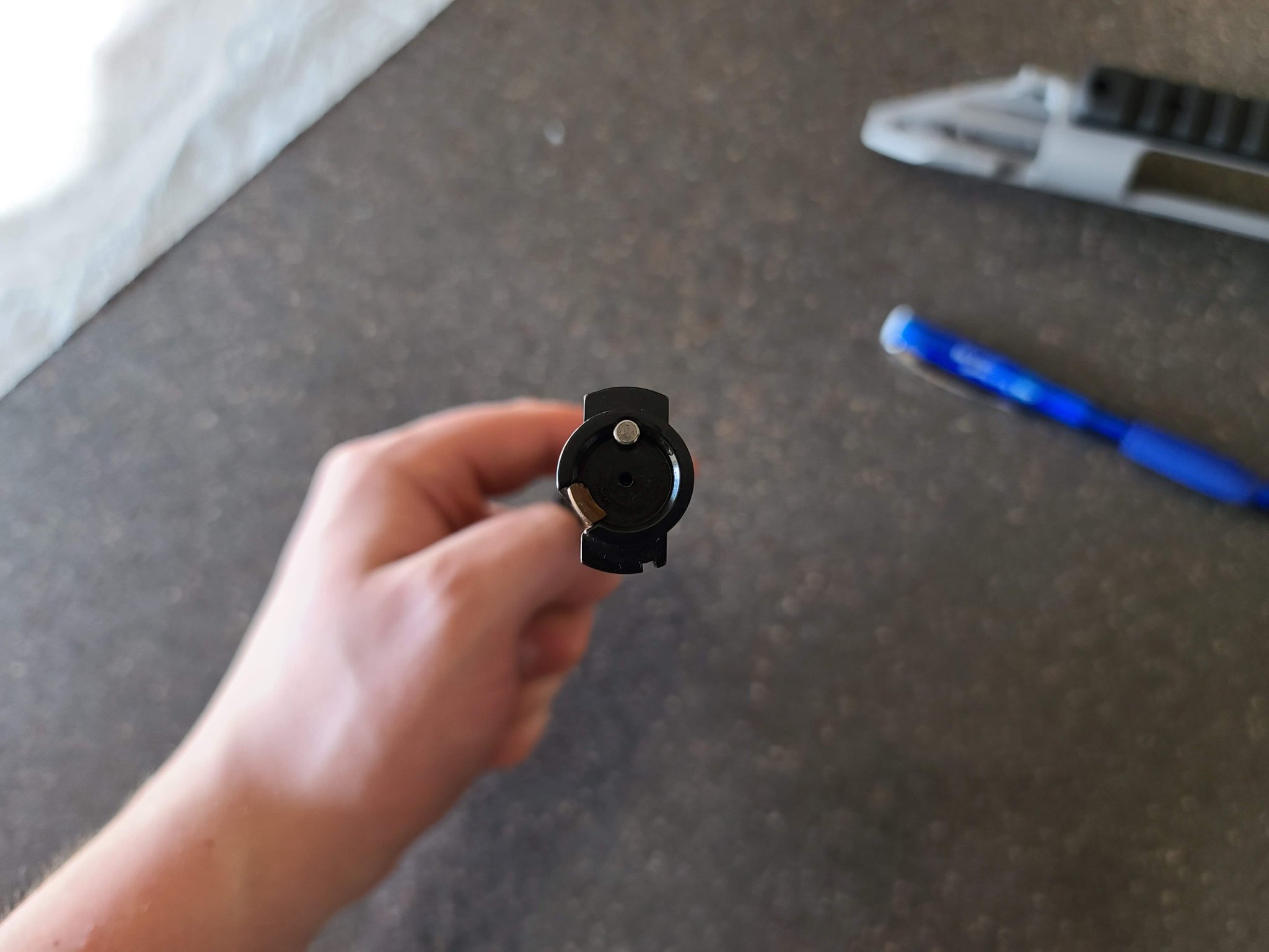

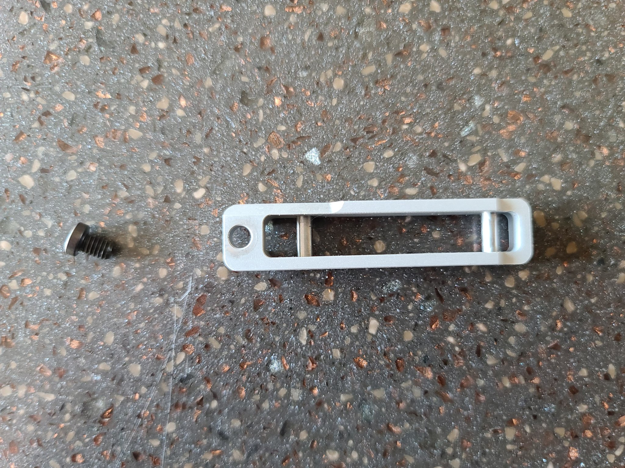

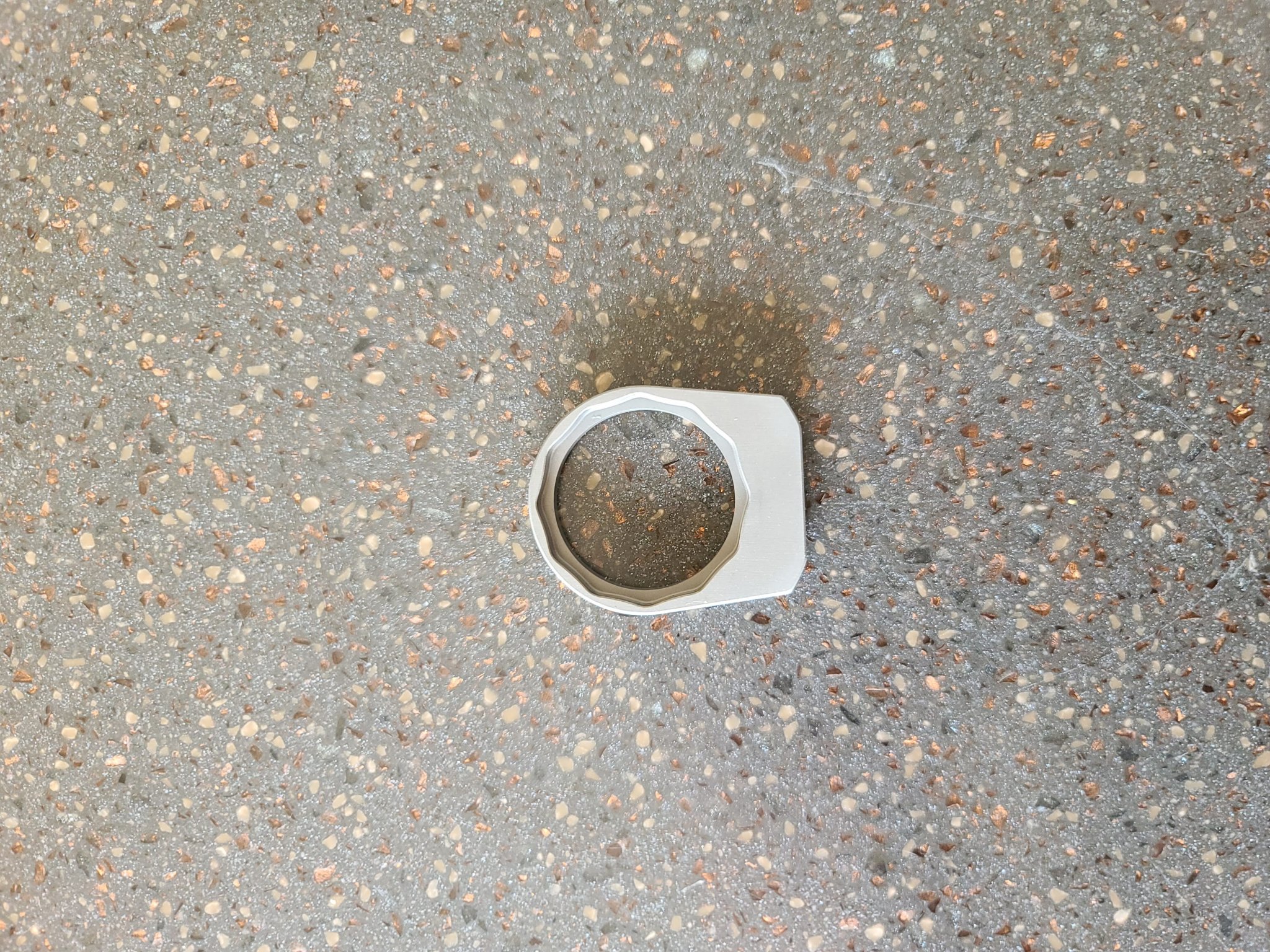

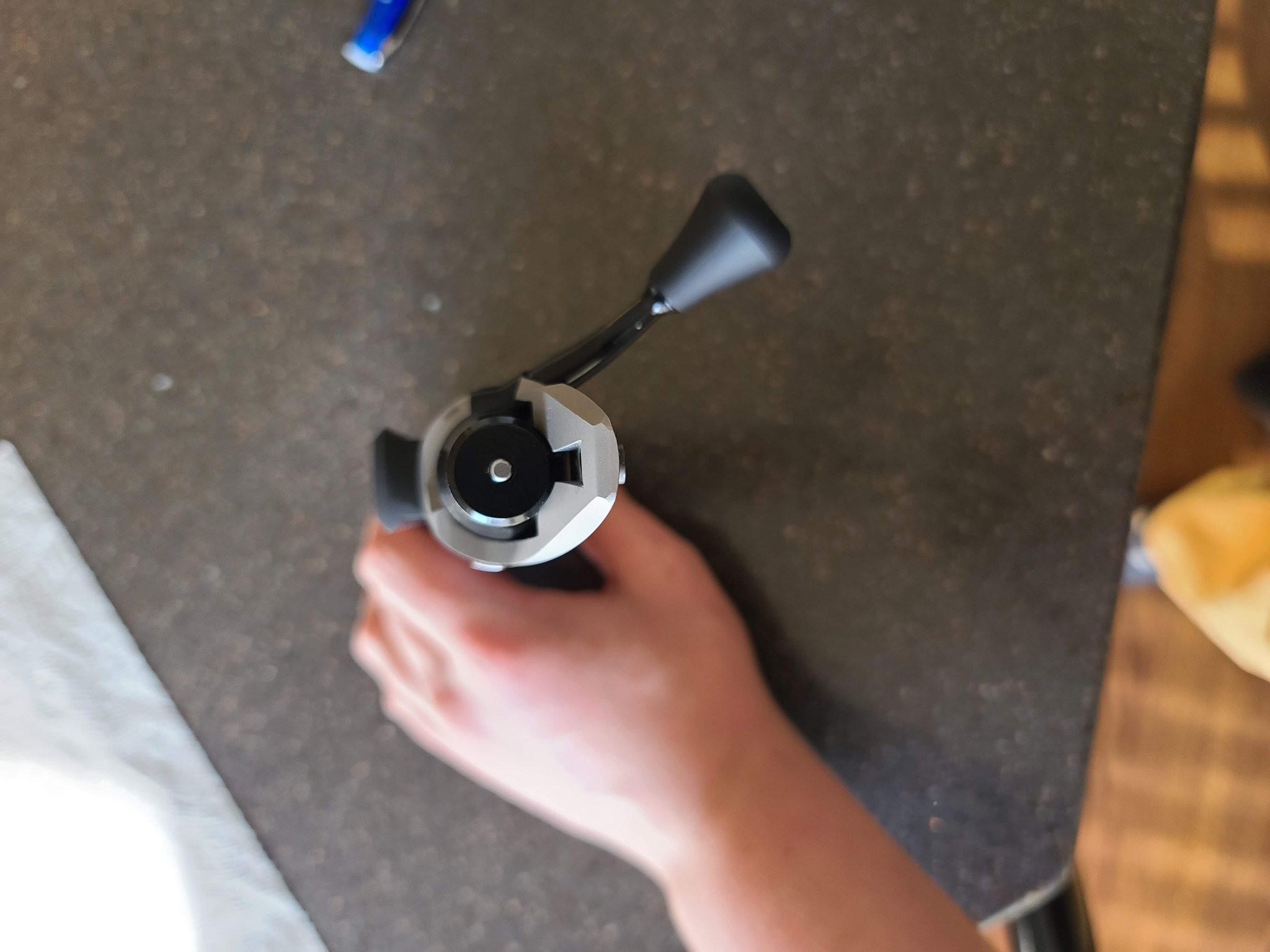

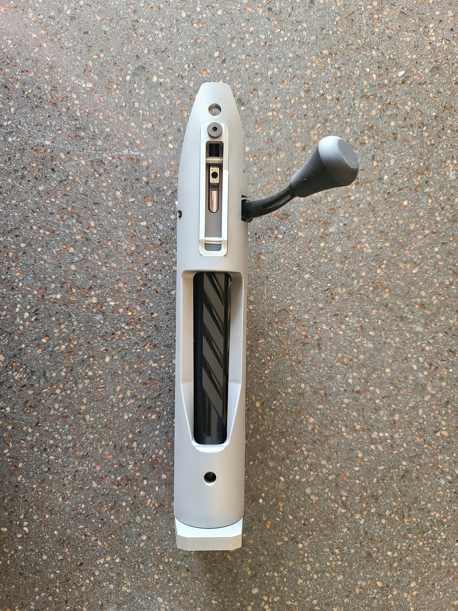

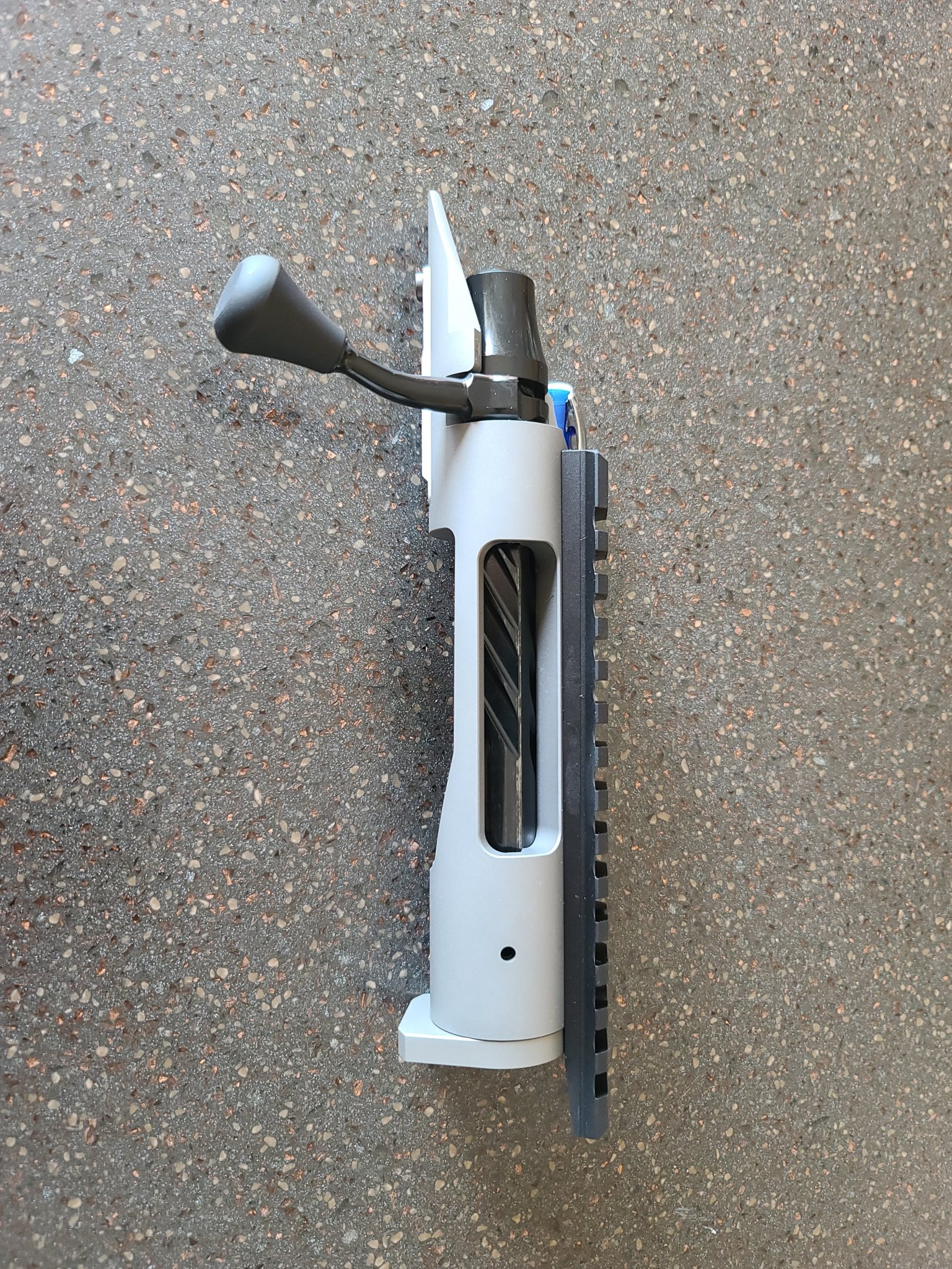

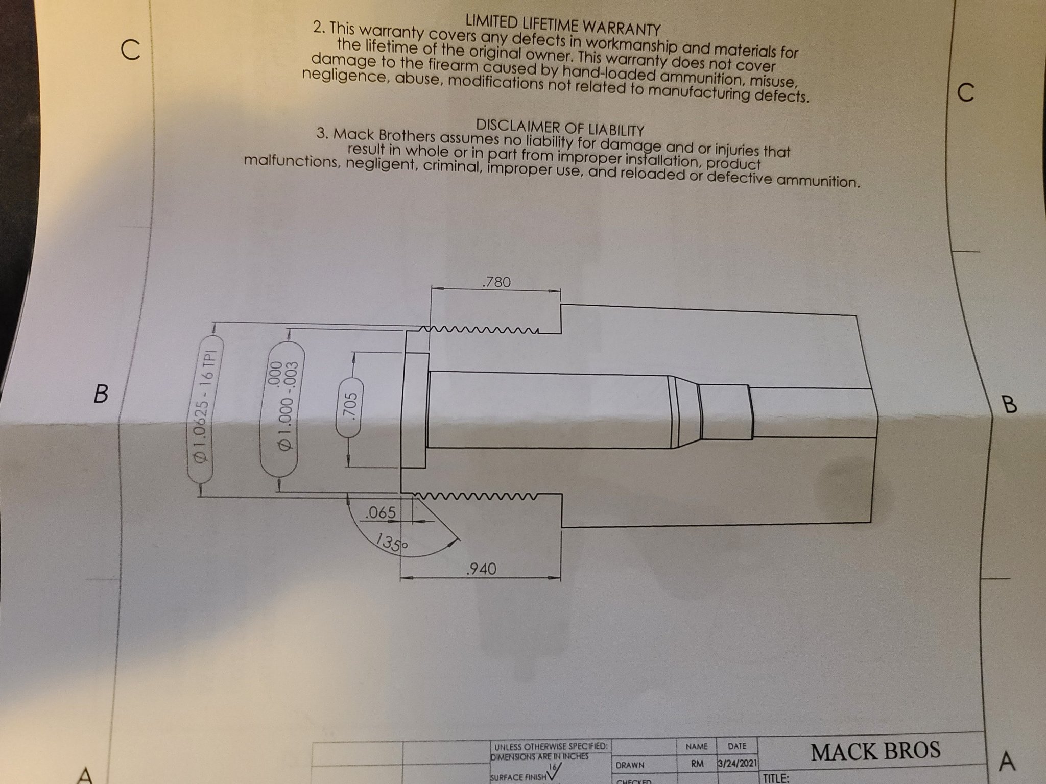

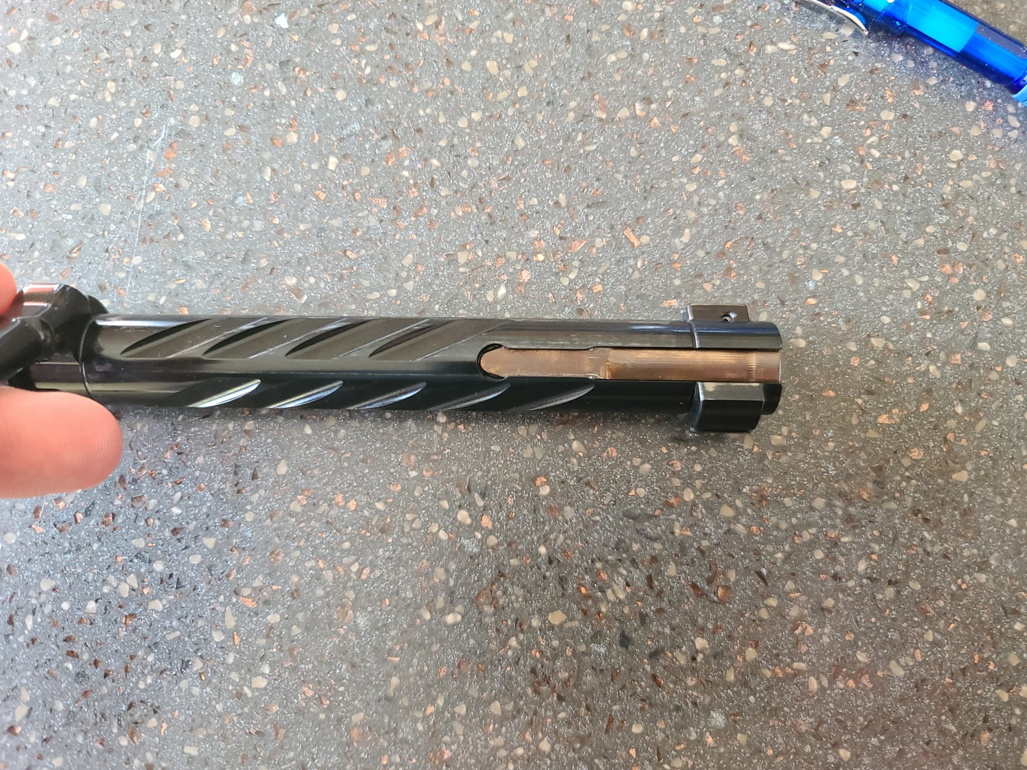

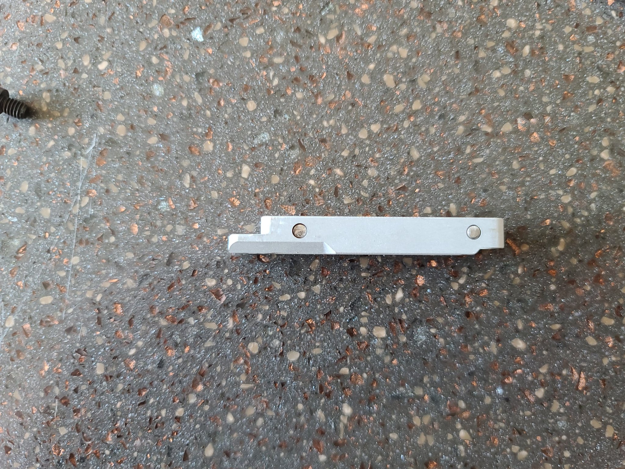

Here are some pictures, I just took some general ones, if you wants something more specific just let me know. I've also included a picture of the tenon spec that was sent with the action, I'm still fairly new to this so I won't comment on remage or prefit compatibility as I have zero idea on what the specs need to be for that compatibility.
Awesome job on the pics. You went far beyond what I expected: thanks.
Looks like the tenon length is different from the print shown for their Ti action... I'm no expert at this machinist stuff, so hopefully someone more knowledgeable about what standard Remington/Remage specs actually are can chime in..?
What's the bolt lift like? Do they offer negative hangers to eliminate cock on close?
I'll preface this by saying I'm a novice to the custom world so take my words with a grain on salt. It seems like a little more effort to open the bolt than something like a tikka, but this could be that my handling of most rifles include the stock but I don't have one yet for the Evo. Overall pretty smooth, which seems to be from the coating on the bolt, which unfortunately seems to come off fairly easily.
Through my limited knowledge I believe it is cock on open? Maybe I am misunderstanding.
For both these questions, hopefully someone more knowledgeable can step in to expand on my answer...
Every action feels heavy to lift open outside of a stock unfortunately. Tikkas have heavy felt lift due to their 70° action and short bolt handle.
Most actions are cock on open, but if your trigger is out of time with the cocking piece, it will make the action over cock upon closing the bolt. Hangers can adjust trigger position in relation the the cocking piece to eliminate most or all of this.
That makes more sense, thanks for the mini lesson. There was nothing in the documentation that I received with it that would seem to suggest alternate hangers, but back in this thread someone seems to have talked to them and they said they would offer different hangers. Something to reach out to them about I suppose. Sorry I couldn't be of more help.
Great pics!!! I like the recoil lug to receiver interface, first time I’ve seen/noticed that.
