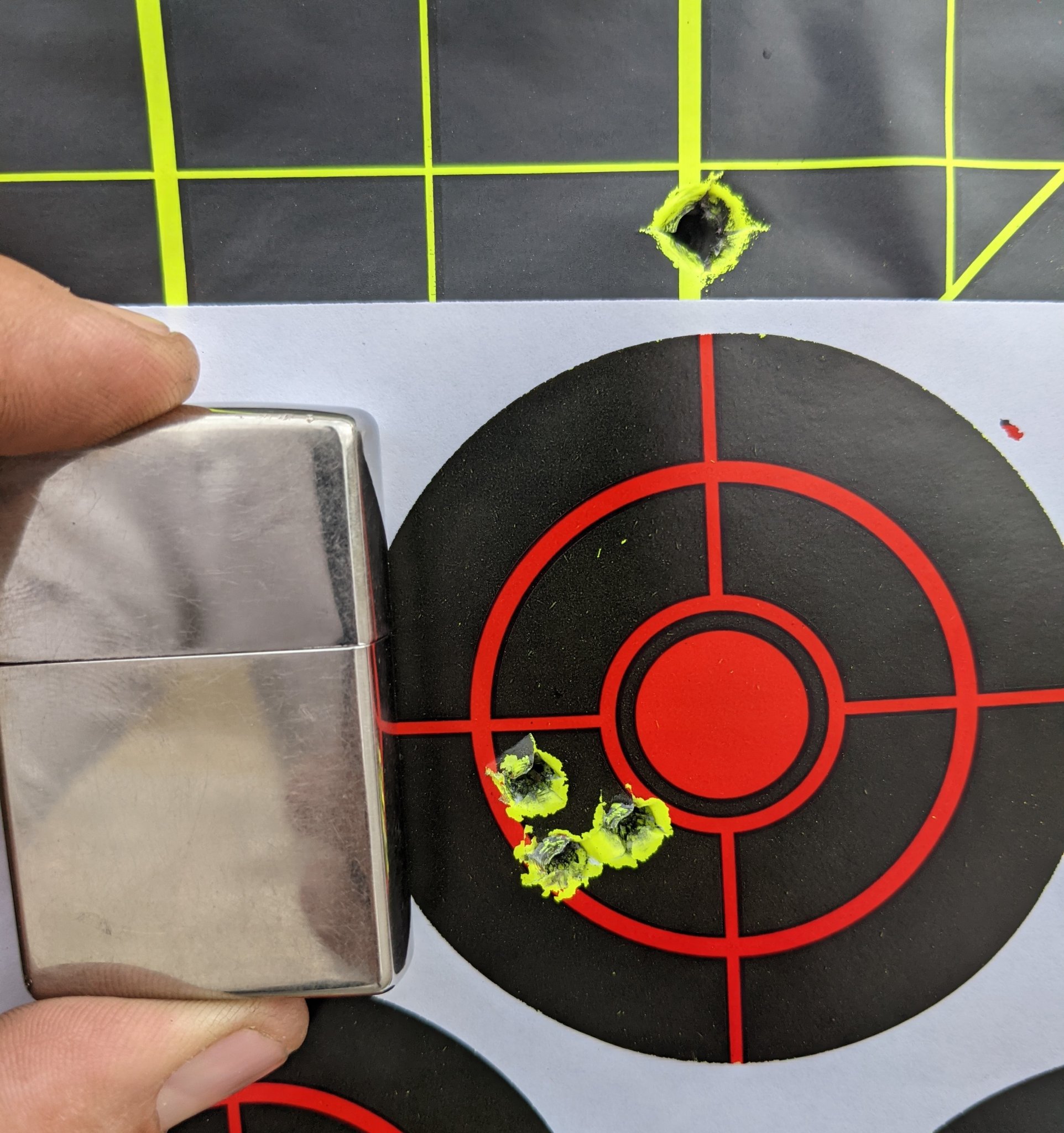

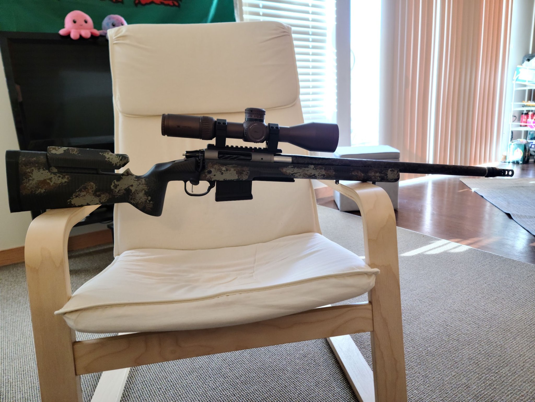

Finally got my manners stock in, put the rifle together and tested the first 5 shots with the smith who put it together. Performed awesome, just a little heavier than I thought it would come out to. I suppose that means time to build another and move the razor over and put a lighter optic on this rifle. I did want to note after the first few shots the base that came with it loosened up a bit. May be worth using some blue Loctite and re-torque them before you go out and use it.View attachment 7737556
What are your initial impressions? How's the bolt lift? Excessive? Is cock on close present? Trigger times up pretty well? Curiou6if you can compare it to other budget actions like the origin, tenacity, or atlas?
@bbhank finally got the EVO I got from ya built! 6mm Dasher Criterion barrel. Shoots like a dream at 100yds, can't wait to do some load development and take it farther out. Using Alpha brass, Barnes 105s, and H4350.

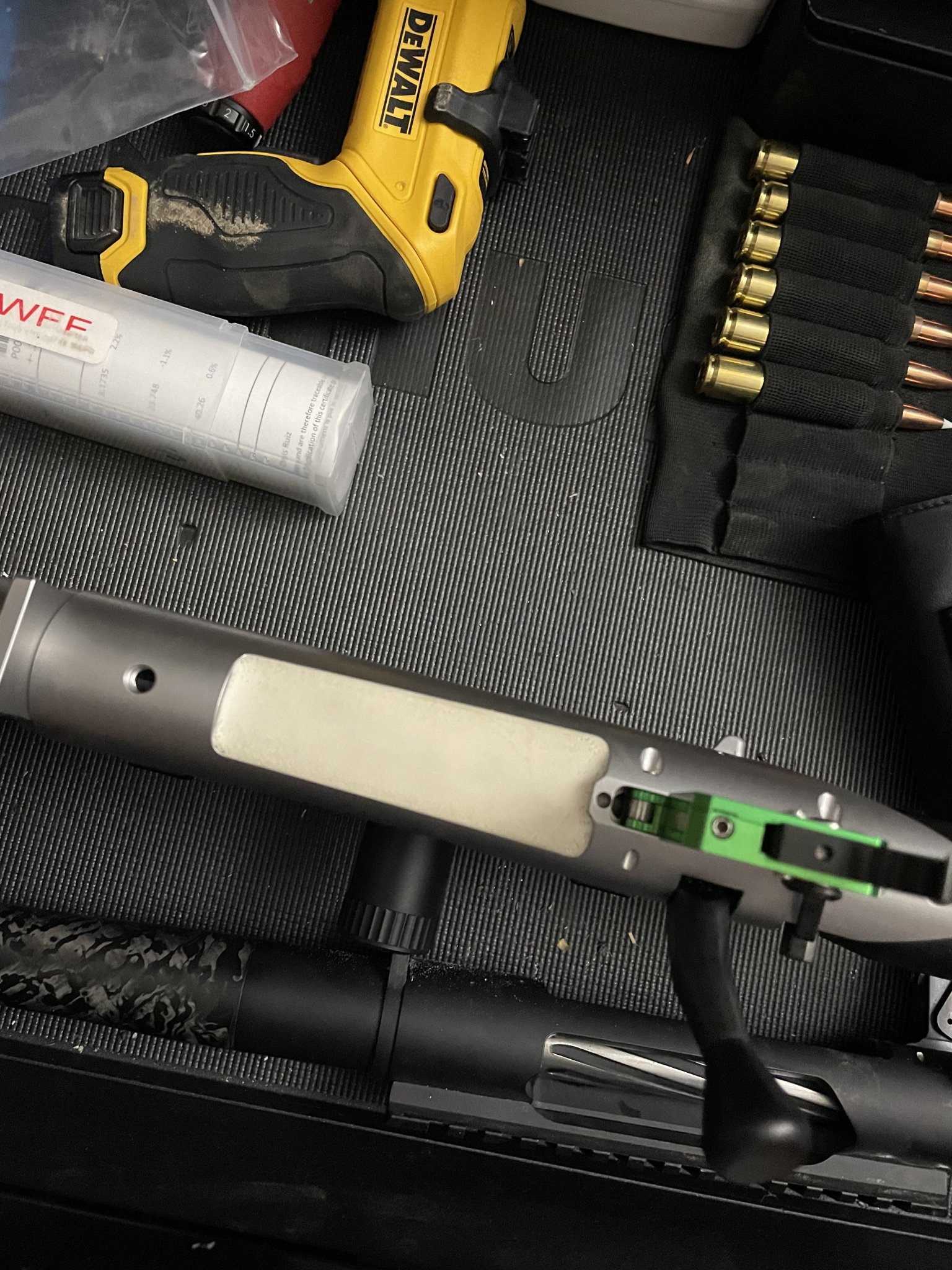

Guys, the action has a trigger hanger, is this a problem in a chassis? I have used impact/kelbly actions and its usually necessary to make a relief cut for the hanger.
It’s going to depend on the chassis and how the trigger inlet was machined. The hanger itself is not the issue, it’s the screw that attaches it to the action that you may need to modify the chassis for. The Gen 2 mini chassis that manners use solve this problem if not going to a full chassis. It’s an easy modification even if you had to do it with a dremel.
Reactions: 4O6shootist
Not mine, but a buddy had his Evo in one of my manners with MCS-DBM mini chassis, and the chassis would need to be relieved for the trigger hanger assembly. He ended up ordering the new LRH stock that I believe had the TS Customs bedding block, which accommodates the trigger hanger.
I put mine in a 1st gen XLR Envy, and I did have to use a dremel to make room for the hanger. Actually had to remove a lot more material than I expected. Plenty of material left on the chassis, just wish I found someone with a mini mill or something to make it a lil prettier. If it was a more expensive chassis, I'd have taken it to someone to get done right
If you opt for a Gen2 Manners mini chassis you are good to go. The first Gen mini chassis would need to be modified. I am only referencing the Manners mini chassis here.
I've got my 24" bartlein #4 carbon 6mm barrel, Hawkins hunter dbm, and I placed my order yesterday for a Mesa Precision altitude stock. Is there a particular action inlet that will match the Evo ejection port, say a kelbly atlas, or tl3?
I experienced the same with my First Gen XLR Envy. I made the relief cut with an end mill in my drill press running the spindle at a high speed. It worked out good for me, YMMV. I’ll need to make the same cut in a Begara HMR stock I’m using for another build. I have three Mack Brothers Evo actions now.

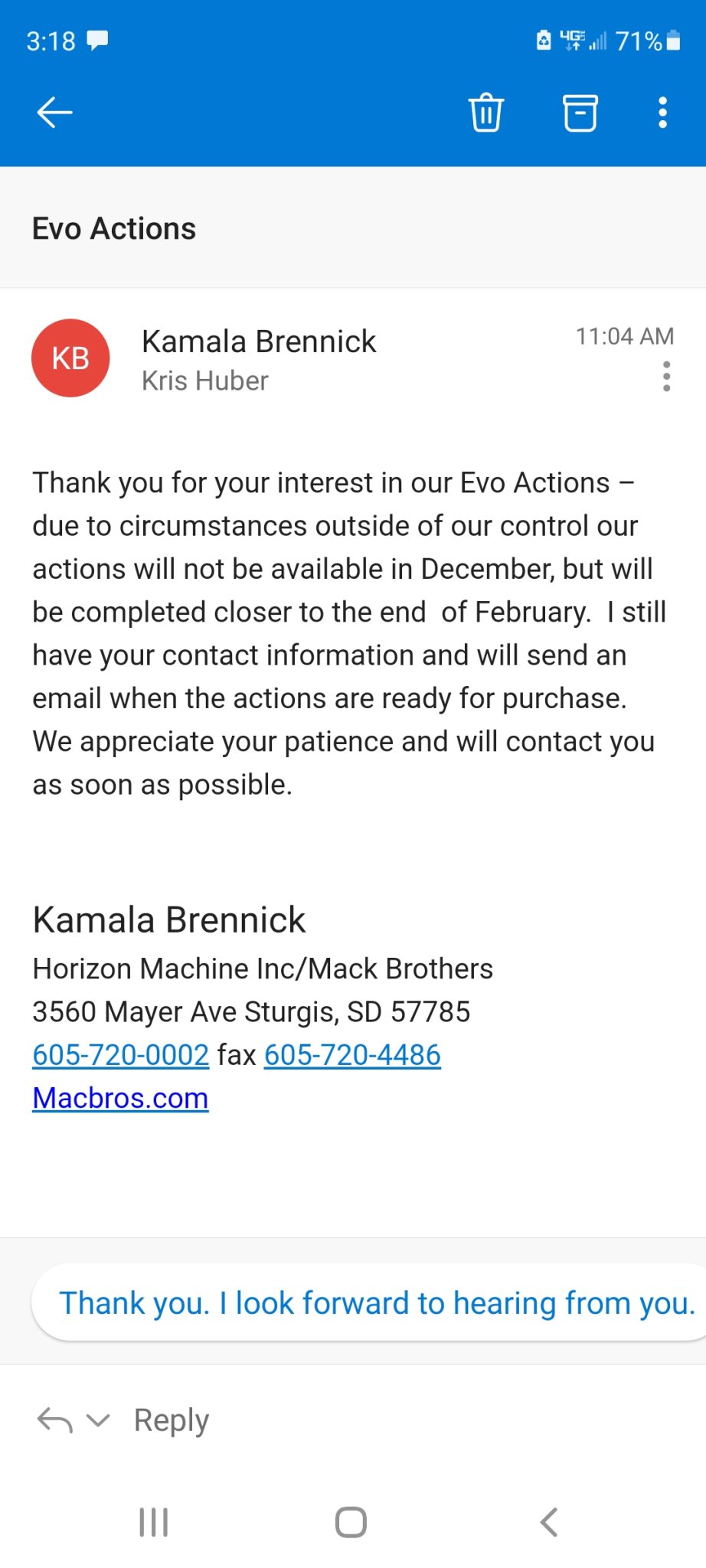

I sure many of you have probably received this email, but Mac bros sent me this product update today. I've been on the waiting list since August I believe. Bit of a bummer. Demand for the Nosler rifles and supressors must be higher than they planned.
Looks like the end of February now
Yep, I've actually been waiting since April. I guess I'm in no hurry though
