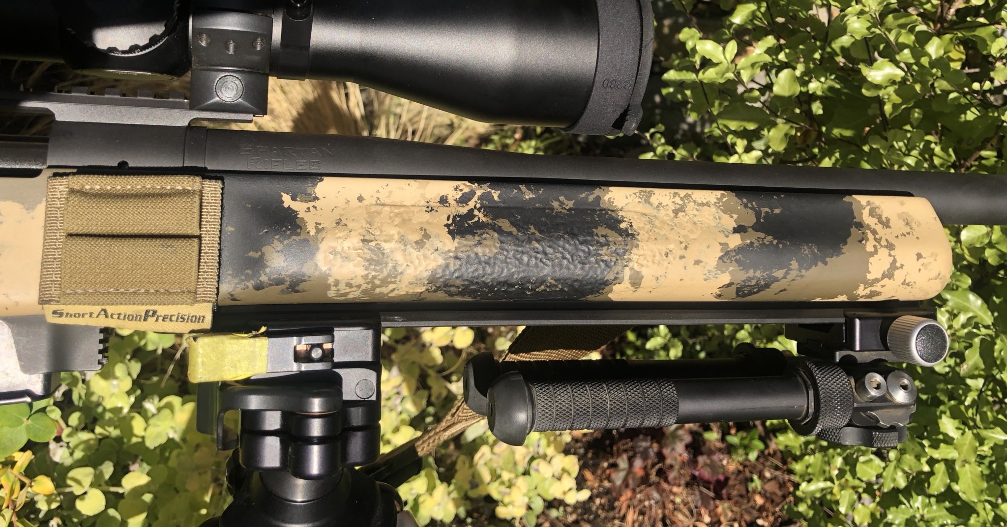

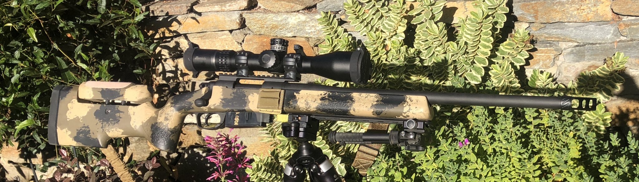

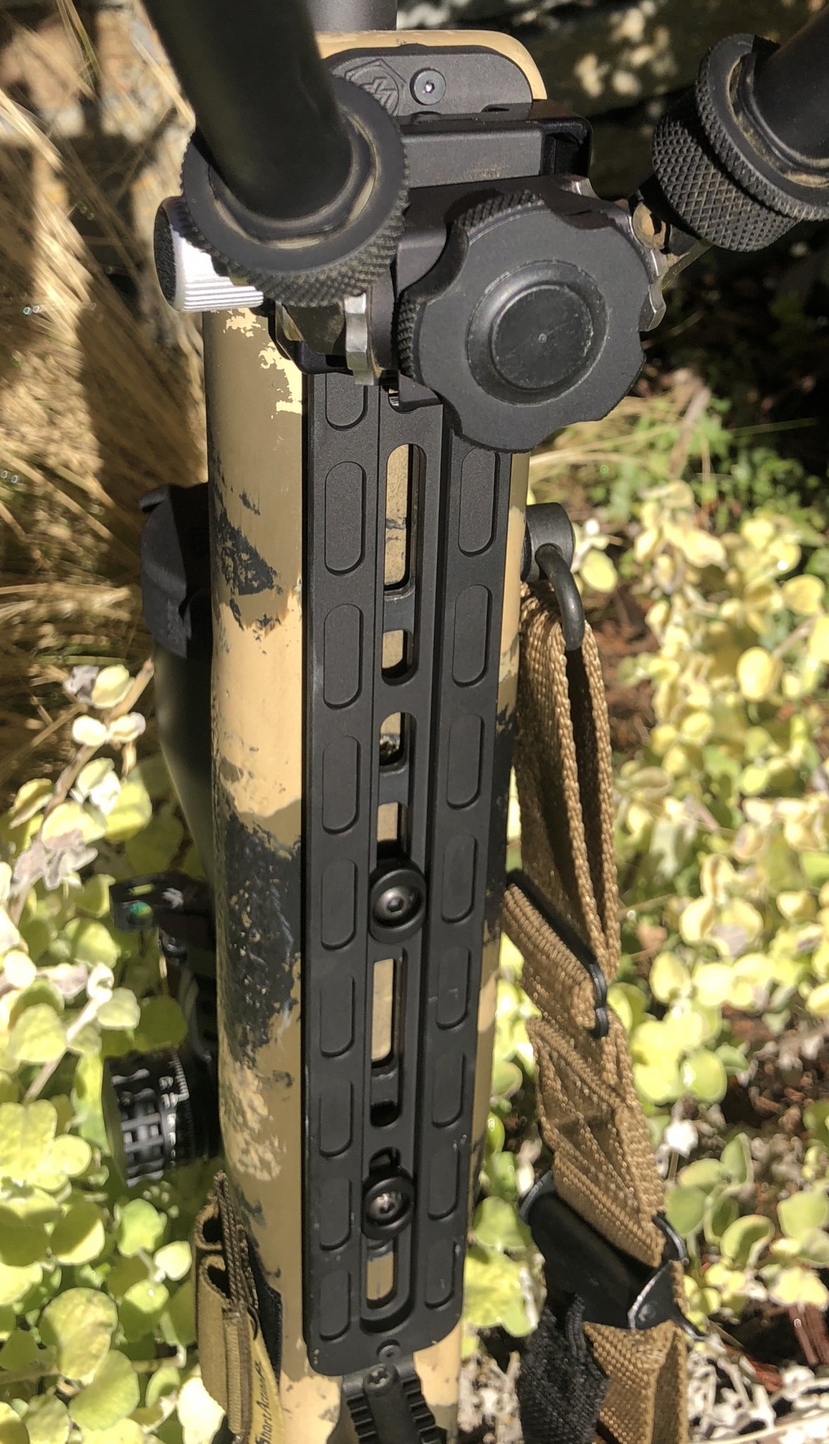

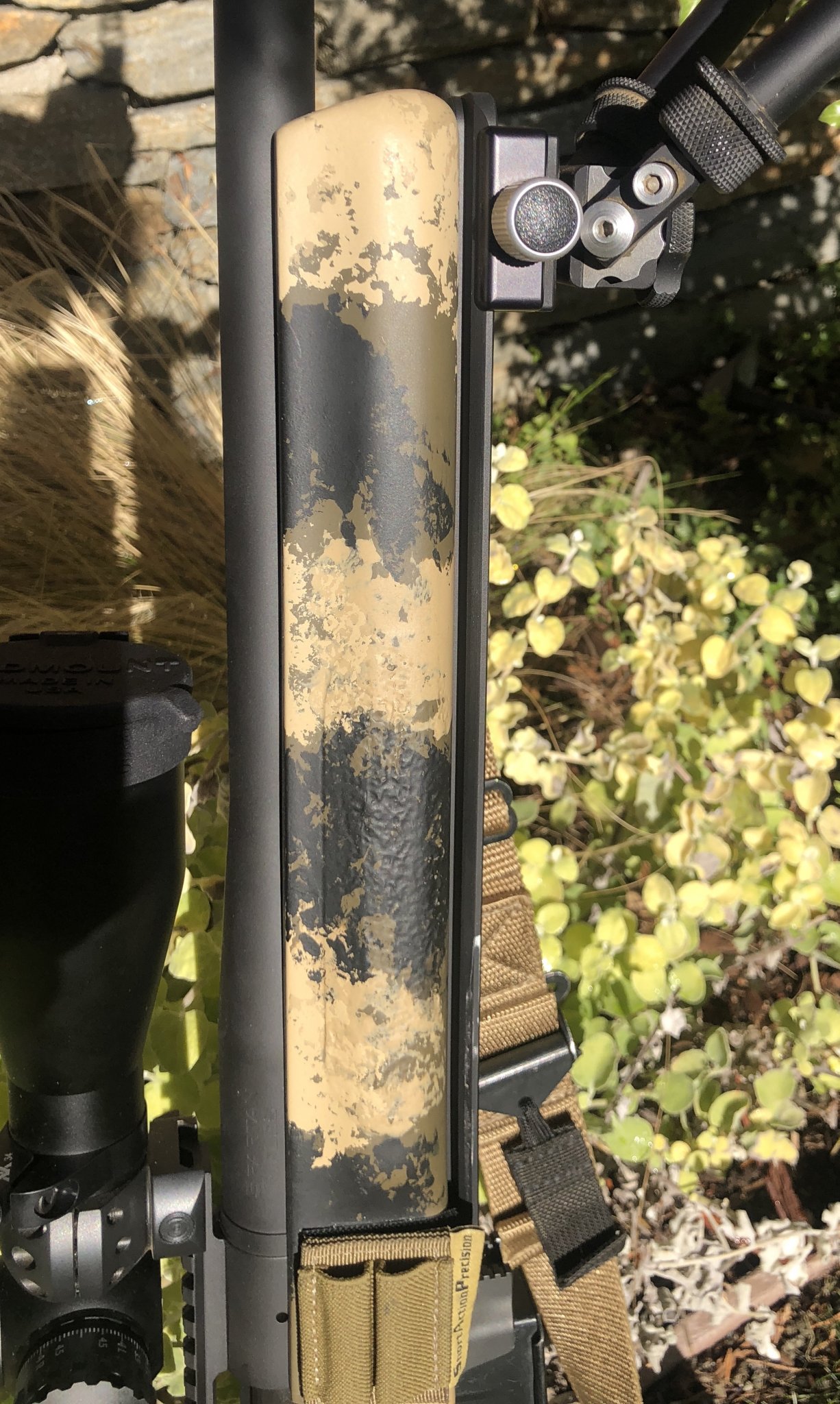

Maybe my T-4A is different? I have the Henderson Precision https://www.hendersonprecision.com/shop 12" 1.5 Dove Tail mounted with to the integrated RSR M-lock and using a Badger Enhanced bottom metal. I could have slid the 12" rail to touch the Badger, but I wanted to be able to remove the bottome metal if needed so I stopped just at the bottom metal and didn't cover the action screws

Images below: Bipod is only folded back, because thats how it fits in my bag the easiest -

It is actually my pig hunting gun (thats why the bolt handle is kept small) but double as an extra match or loaner gun if needed..
