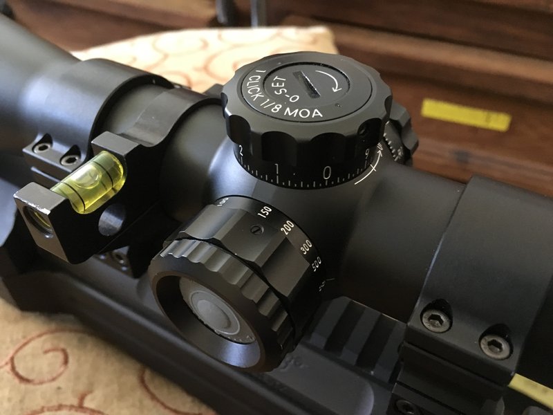

Quick question about the Zero Stop feature on the tactical dials. I read on the March website (or one of its distributor's websites) that the zero hold function is only designed to work in some portion of the elevation range. It suggested a 20 MOA rail. Can anyone explain this?
Zero stop is very simple and reliable . First , zero rifle at chosen distance .
Turn centre spindle in elevation turret with coin or flat blade screwdriver
clockwise til it stops and your zero stop is set . Couldn’t be any easier .
You do not want your scope operating at the extreme of its travel. An elevated rail keeps the scope closer to the optical centre for a greater number of ranges. So if you are shooting a slow bullet at long range regularly, a rail that is more than 20 degrees is a worthy investment. But the trade off is that you might not get a 100 metre zero!
