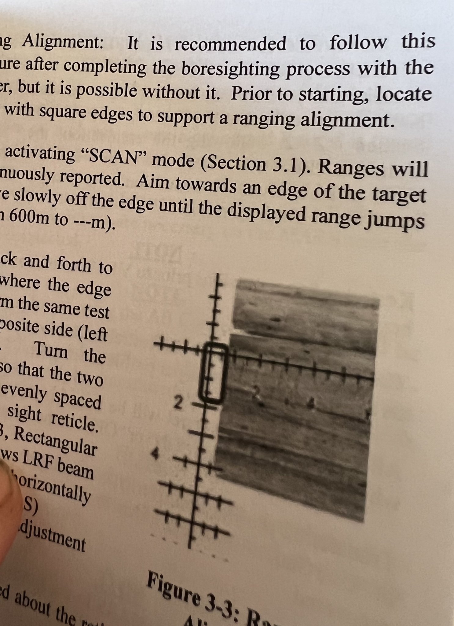

*Disregard the last remark, as the beam does seem to be around 1mil. I must have been shaking or something on the first test. I will test some more and let you all know. Interestingly enough, the unit seems unable to pull wind in from a kestrel. That might be good, as most ballistic calculators reference wind via DOF, which works OK until you have an RF hooked and change your target direction.

I did receive confirmation from Envision that the beam is, in fact, elliptical and taller than it is wide. Wind cannot be pulled from a Kestrel, and wind input is based on DOF. So a 5MPH wind is always "from the right, regardless of where the rifle is pointed.

Of note, a shift of "boresight retention" of .5Mil is in spec and called out in the manual.

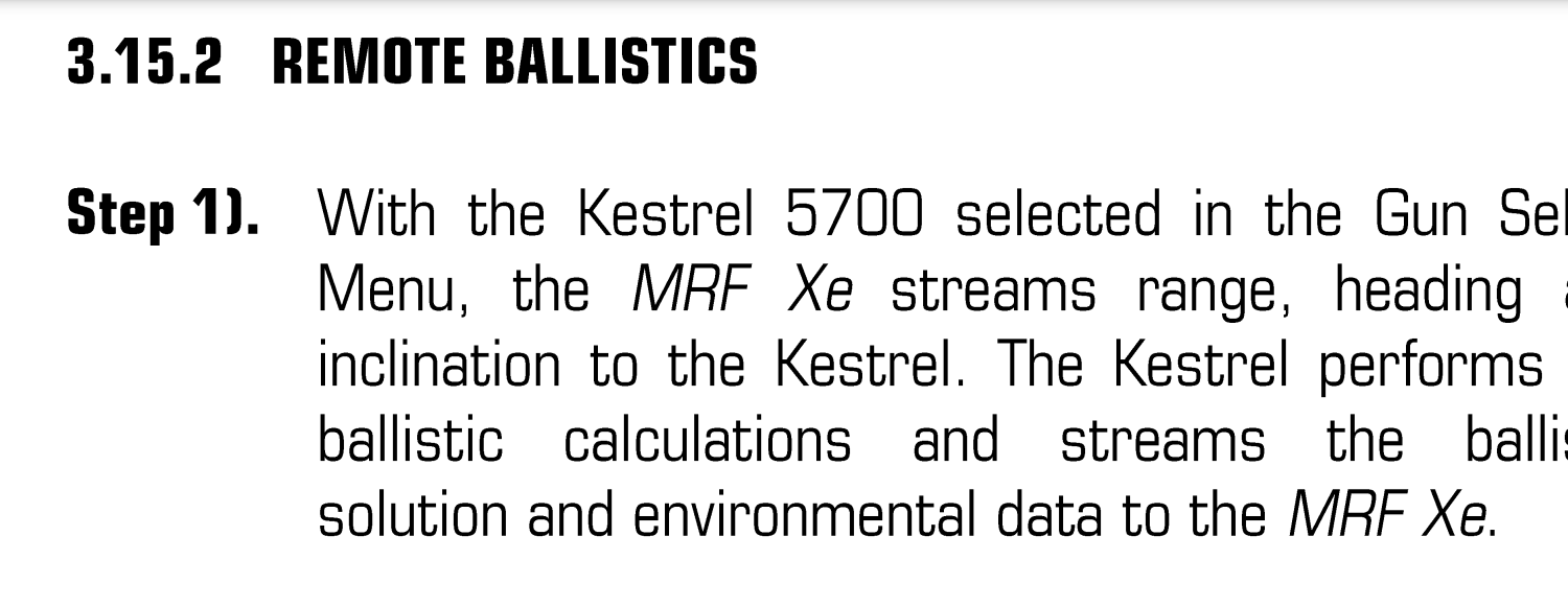

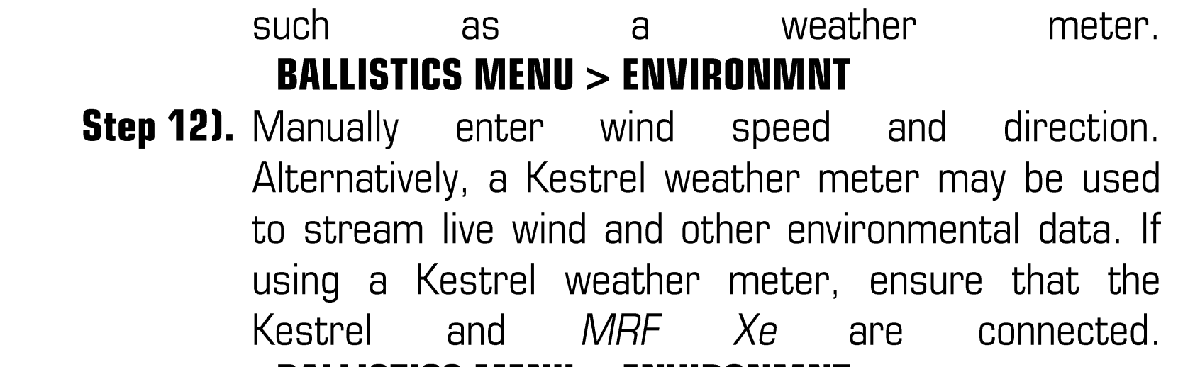

Another option for match shooters would be to send the range data to a kestrel.
Shawn,
As I've never used a Wilcox MRF, reading the manual, wind streaming is supported and "stream ballistics" directly from a Kestrel, too. Are you saying that the manual is wrong?
