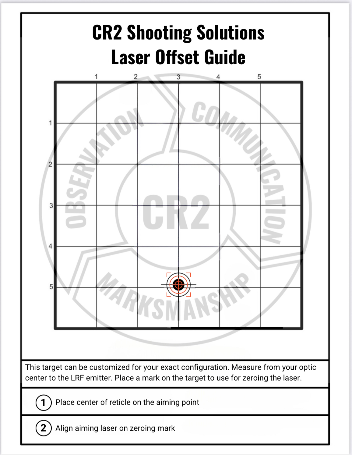

Here’s a target you can use for the HOB technique. It’s what we recommend. That way you don’t have to worry about a divergence at distance past you converging point. That being said, if you converge at a distance close to you maximum engagement distances. Than it’s not a problem.

View attachment 8671290Here’s a target you can use for the HOB technique. It’s what we recommend. That way you don’t have to worry about a divergence at distance past you converging point. That being said, if you converge at a distance close to you maximum engagement distances. Than it’s not a problem.
