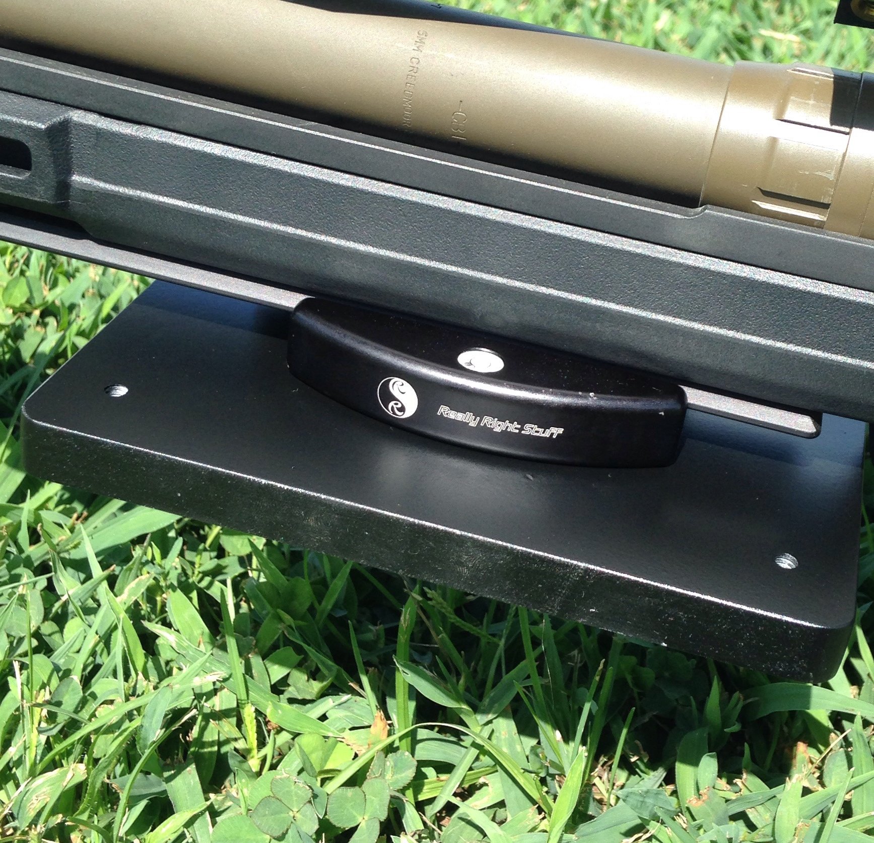

Pretty slick setup. We took a bit of an opposite approach with our Gravity Blocks (short and stackable instead of long and thin). I guess there’s more than one way to skin a cat!
Those are interesting... I couldn’t imagine ever wanting to stack them as it would be so bulky and odd looking. I like the fact they are 1lb each. Got any more pictures of them installed on peoples rifles?
I’ve got a couple more photos on the Instagram page. Haven’t been out shooting much these past few months due to miserable weather conditions, but the local PRS season is kicking off in just a few weeks, so I ought to get my act together!
As far as the bulkiness goes, they’re not too bad. With the extended forend design of the PRC-700 chassis there is still plenty of room for a Gamechanger and/or shooting off a barricade, even with the weight attached.

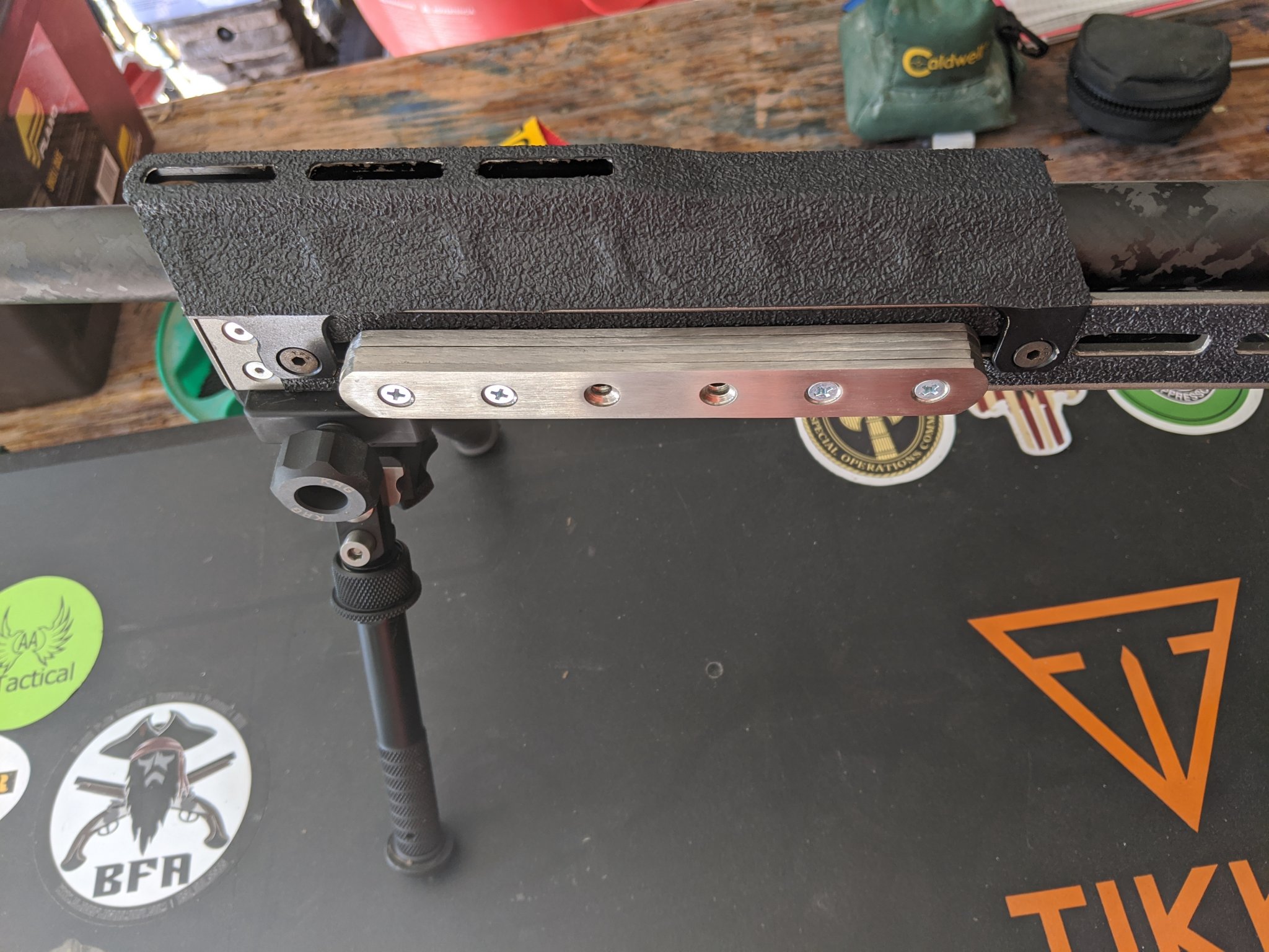

What you think? I will see how this holds up. You can't really torque down mloks nuts too much. May go to a flat bolt if there are issues.

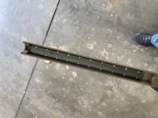

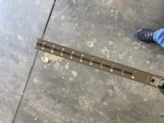

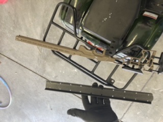

So I took a 12 inchx .5 x 1.5 brass bar that was close to the same dimensions as the internal weight set, and I took a grinder to it, drilled and tapped new holes in it and it works great. My set up is SUPER rigid and weighs close to 29lbs now, but the front end is SUPER rigid.
You can kind of see the brass poking through this one whole... which I like for my set up lol

This is what I did: Used #10-32 x 3/4" screws with a 1.25" wide piece of bar stock that is 3/8" thick. If I did it again I would use a WIDER than 1.25" piece and cut it down, because the 1.25 is just BARELY enough and I had to be extremely careful and precise. I'd also highly recommend using a tiny drill bit to drill pilot holes while the bar stock is clamped into the chassis to ensure proper alignment.
How much total weight did it add? The bar stock I used was 1/2 thick and I had to cut slots for all the mlok spots.
Is yours steel? Mine was brass.
Can you share a link to the bar stock you got? mine was also 1.5 wide so I had to shave the sides.
2.1 lbs according to an online calculator. I bought from a seller on ebay right at the beginning of COVID. Could have saved more $$$ just by getting one at Home Depot

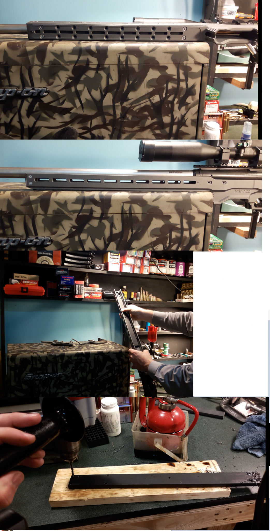

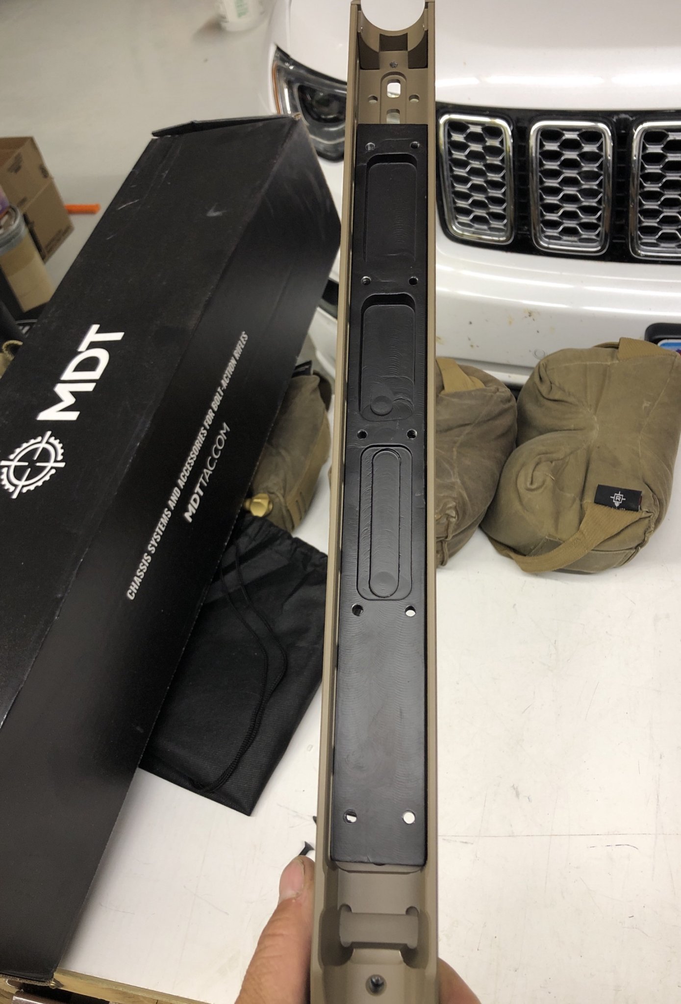

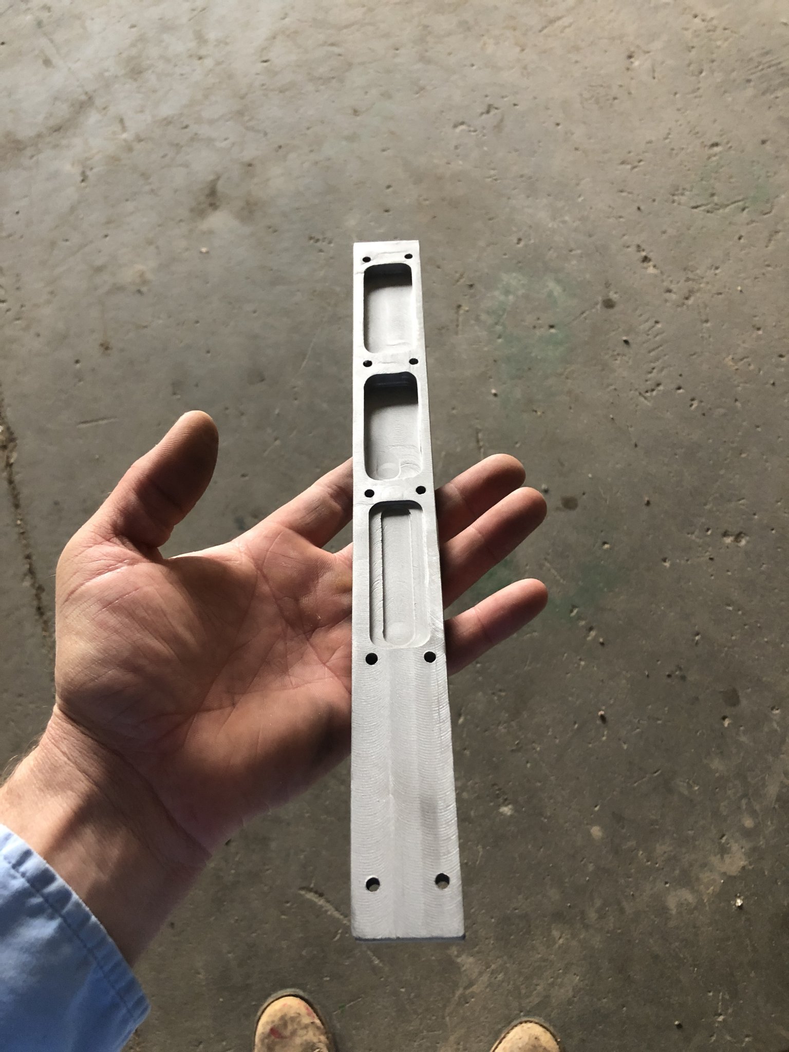

I did something similar to @Garett73 and made my own interior weight. Interior weights were out of stock and I didn’t like the twist and bounce associated with the acc chassis so I milled out a piece of bar stock to go almost the full length. Ended up putting a couple pockets up front to help it balance out. Stiffened the chassis up quite a bit in the process. Ended up 2# 4oz before the pockets. With pockets I’m around 1# 10oz

@A.Huggy Do you still have the file? Was it done in Solidworks or ACAD? I have both. I want to make mine full length for my V22 build and it is easier on me if I put it in Solidworks to do all the math and play around with the thickness to get the weight I want. I could start from scratch but why work harder than needed?
I do most of my CAD work in PTC Creo, but I can see if I have the appropriate licenses to export to a solidworks friendly format.
Awesome!
Did you use an angle grinder to do the height transition? I was just planning on a plasma torch, if I screw up and cut too much I'll MIG weld it up and grind it down for cosmetics.
