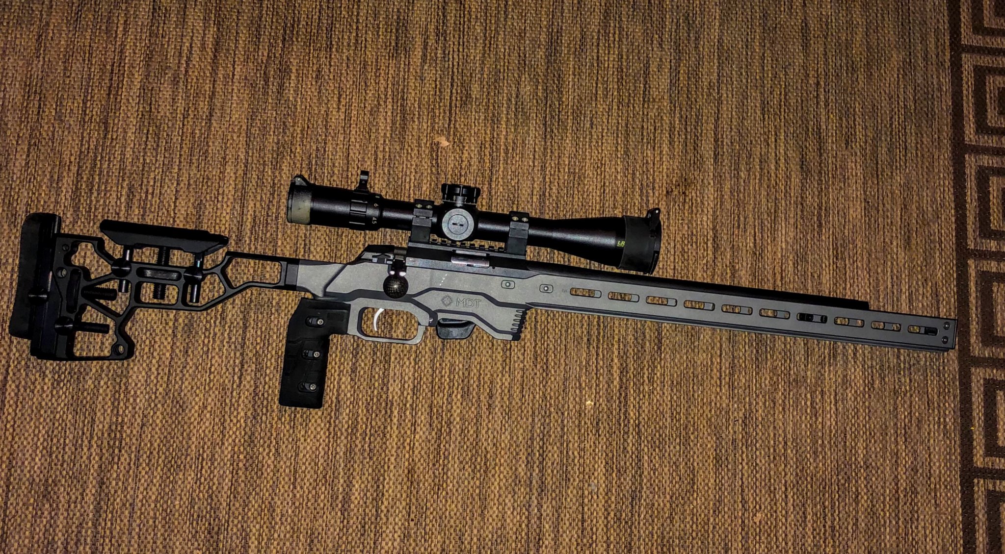

I heard the updated MDT ACC T3 will support the T3X and T1X without any modifications? Anything to be aware of? Considering switching my two KRG Bravo setup, to just a single MDT ACC setup and swap out the action depending on matches.
Yes, the new production ACC Tikka T3's are directly compatible with the Tikka T1x! All you need to do is to remove the magazine latch (1 minute, a pin punch and a small hammer will get it done) and you're ready to roll.
Josh, when you say "the new production ACC Tikka T3's are directly compatible with the Tikka T1x!" does that imply that the initial versions are not compatible?
You are correct. The initial revisions did not have the cuts in there to accommodate the T1x magazine well, however, we implemented that relatively early on, meaning that there are very few out there that would not work without modification. If you have an early one and would like to modify it to fit the T1x, then it is not too hard to do and our Customer Service Team can help you out with that ;)

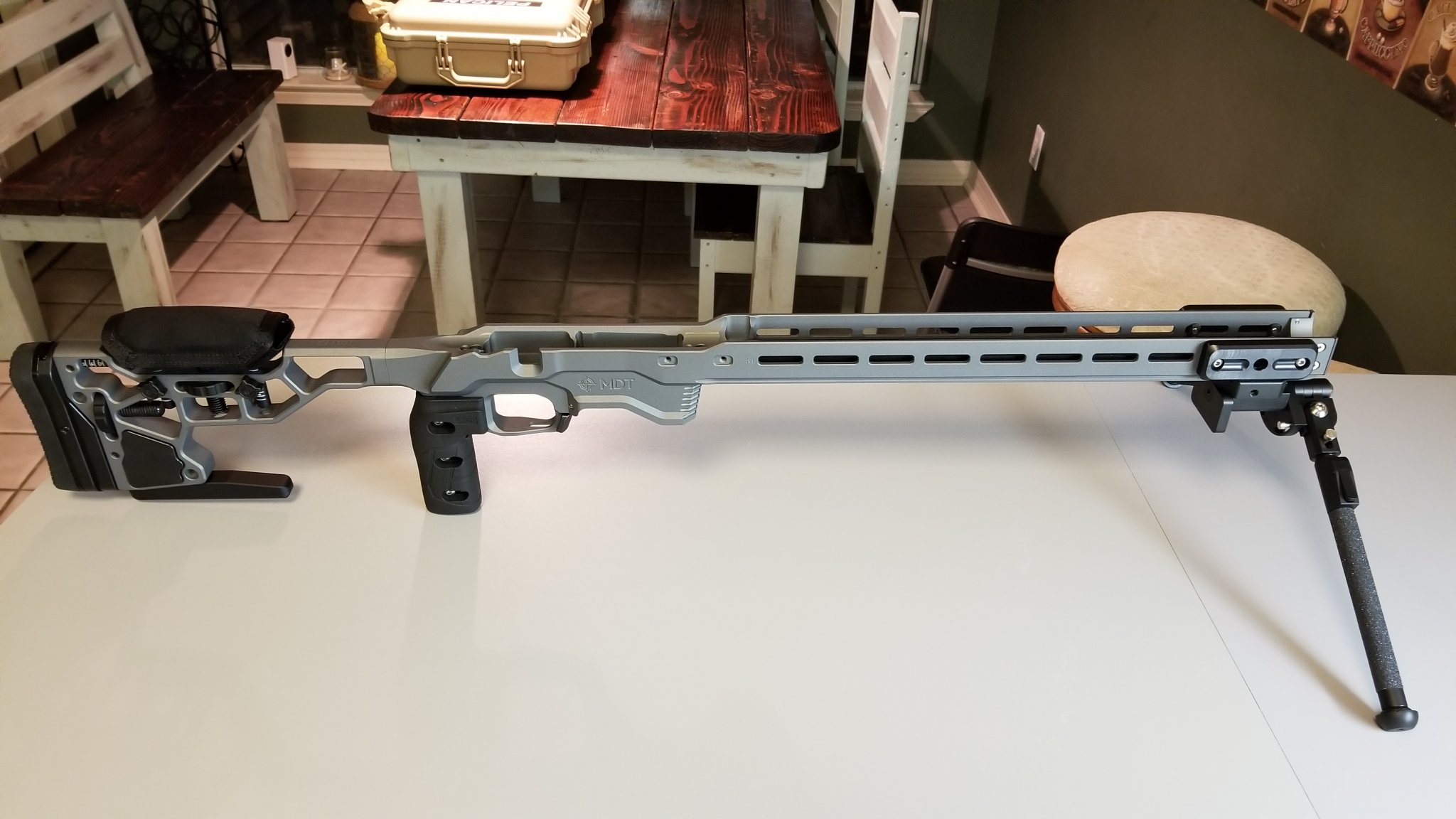

I love the factory kryptek on my ACC. Got in on that Preorder package!!! Will be ordering number 2 in a month, along with some other mdt goodies for my next build.

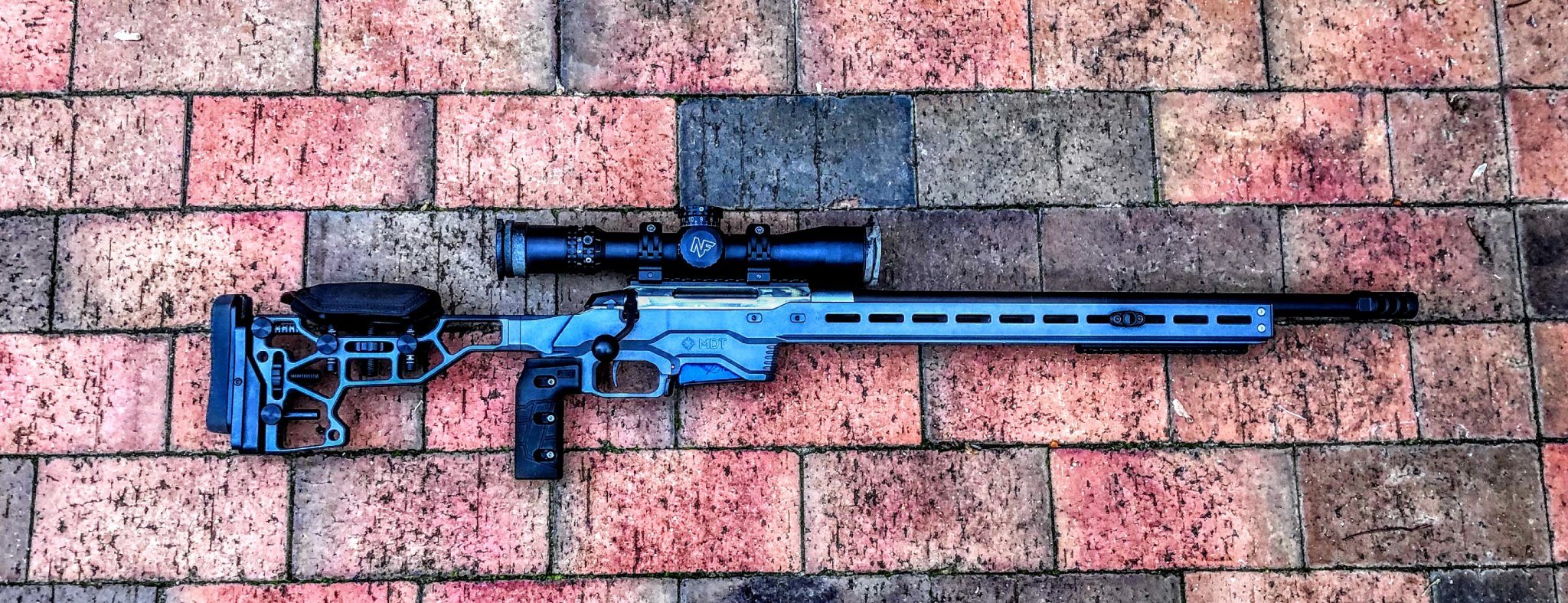

I now have two ACC's. One that has all the weights added and another that has none of the weights - totally different setups both of which shine in their respective use cases.
Had a minor hiccup with the rail spec on one chassis but MDT took care of it fast.
The adjustability is phenomenal. I never thought I'd move away from carbon stocks, and they still rule for certain applications, but I've sold one Manners and will be putting another up for sale since getting the ACC 's, they are that good.
Love it ! 2nd rifle , the one without weights, does it have soft cheek cover on top of the cheek rest? Is that by wiebad or armageddon ?Thanks.

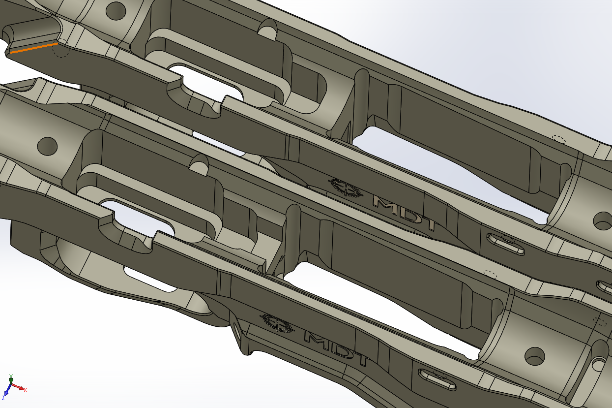

Josh, would you mind elaborating on this? I removed my magazine latch but it appears that my T1x won't drop into the ACC. I've sent a message via the Customer Service portal on the website and am waiting on a response. It looks as though attaining fitment would require some serious tools, not the kind of thing the average customer can sort themselves? Cheers
Edit to add: Actually, taking a good look at it now it appears that the problem lies with the large screw which mounts the T1x mag system to the action. I recon my gunsmith could cut a groove for it without too much trouble.
Hey Buddy, I am always happy to elaborate where I can!
You're correct, the material removal to clear the rear screw that holds the T1x magwell to the bottom of that action would require more than a file, a dremel and some patience. Below is a comparison of the models (in SW) of the chassis that you have (top) and the newest revision (bottom):
As you can see, there is a cut that runs into the trigger pocket area and allows the T1x magazine well to fit better. There are also some cuts on the rear face of the mag well to allow better removal and insertion of the T1x magazine, but those can be done with a file, a dremel and some patience :)
Josh
Thanks Josh, fortunately my gunsmith lives 15min from my house and is a good friend, took the chassis around and he sorted the inletting in 15min, T1X drops in nicely ?
