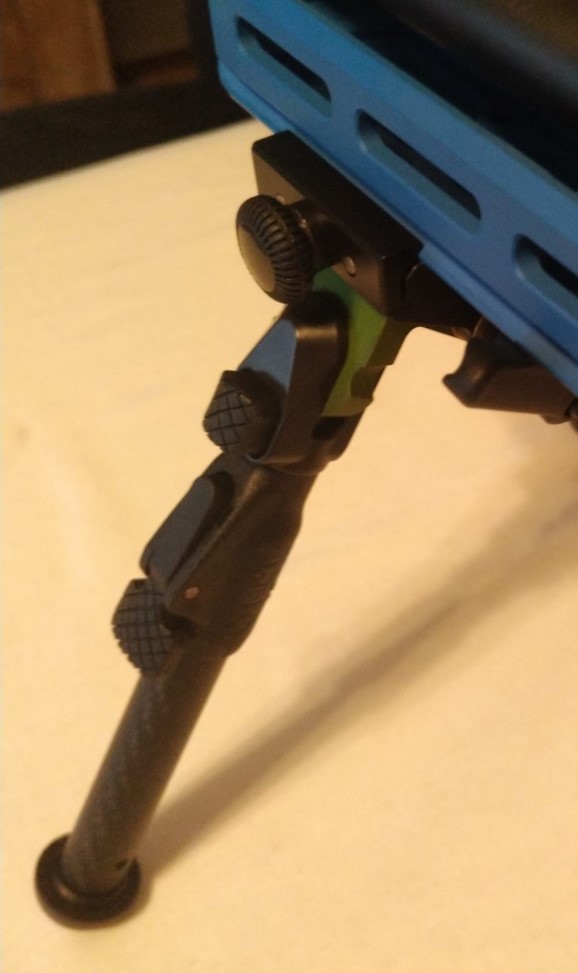

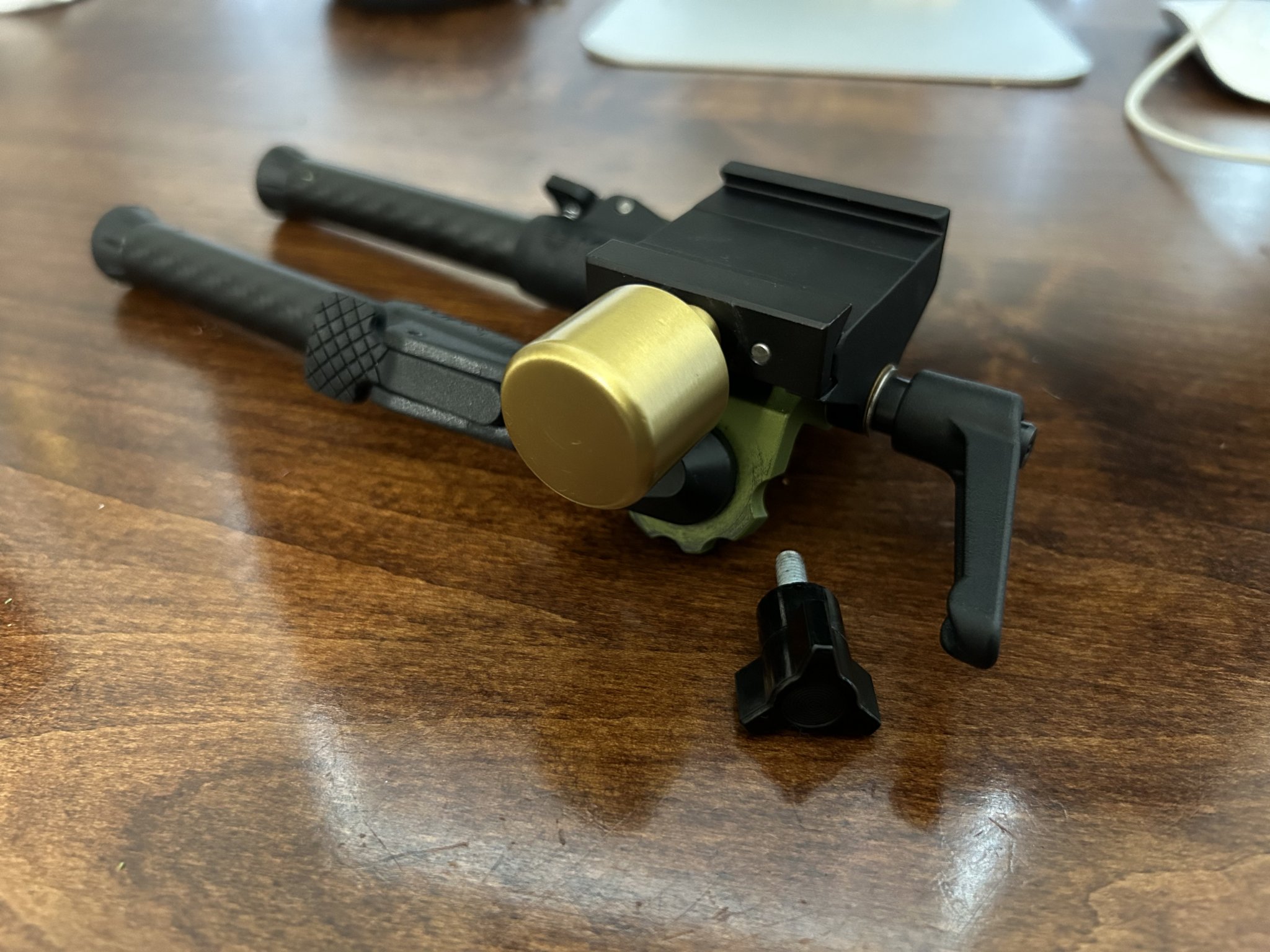

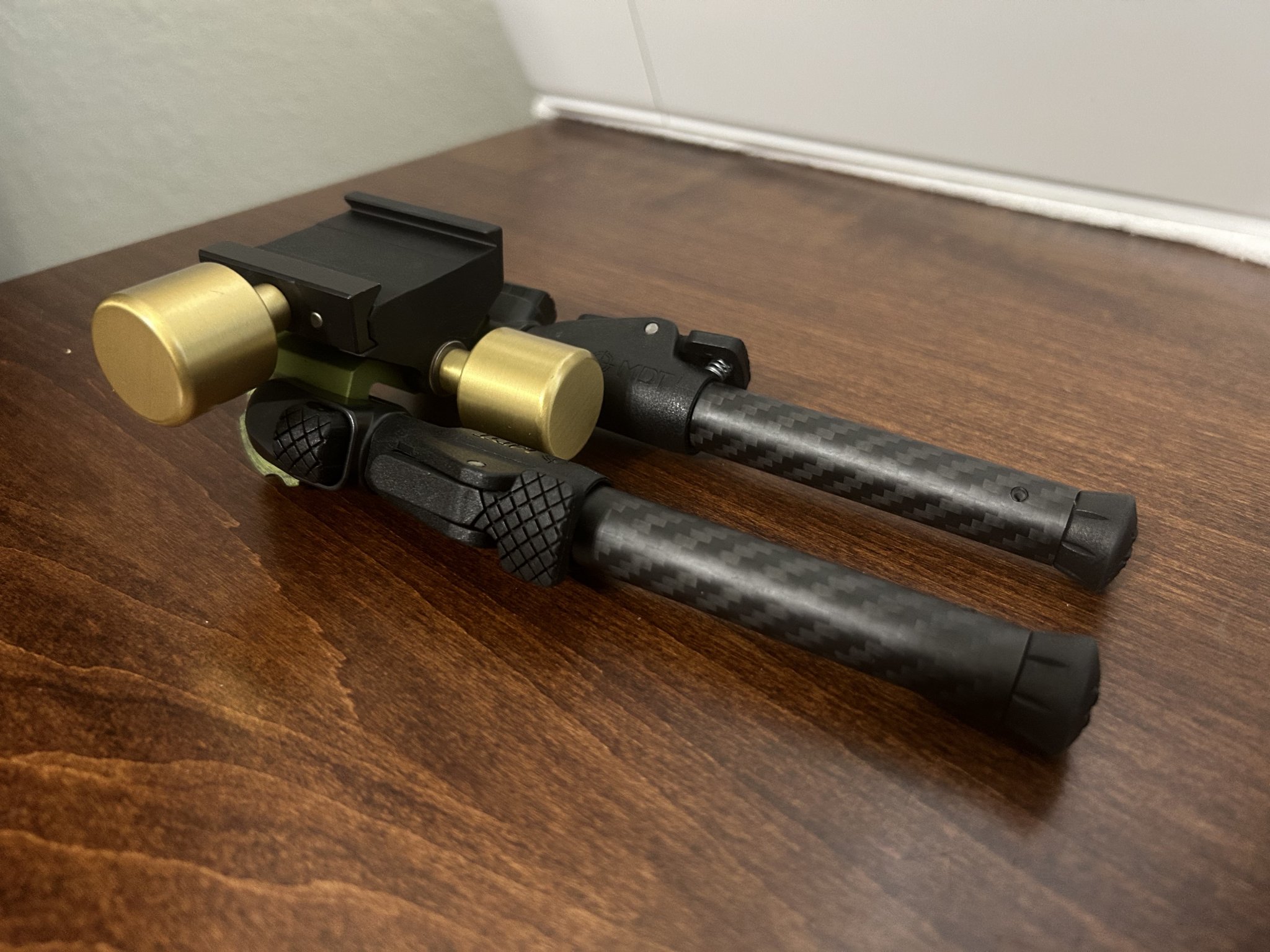

Thank you again for the idea @atomic41 followed your idea tweaked it a little. With my Dewalt hand impact and a carefully calibrated eyecrometer i got it done. 👍
I'll get her taken apart and clean up the burrs and touch up the paint. The round knob is great! Makes it much easier to reach up and adjust while behind the rifle. Also not that much larger than stock. For me the extra little length just makes it easier to get a hold of but not so large that Im worried about it snagging like a lever.

Nice! I agree on those points, it works well. I see you drilled all the way through and drove a bolt through it, interesting idea.

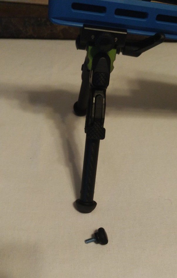

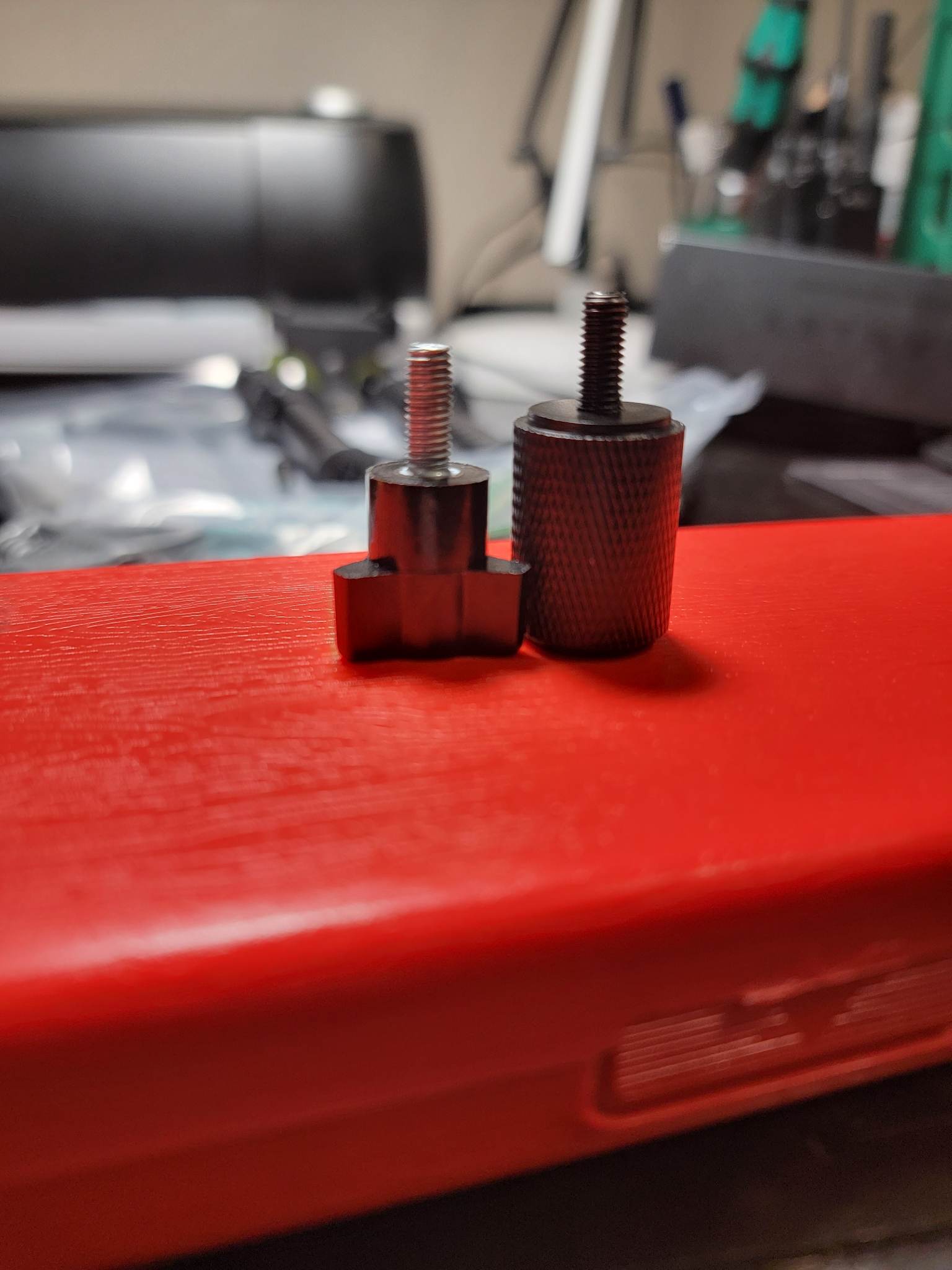

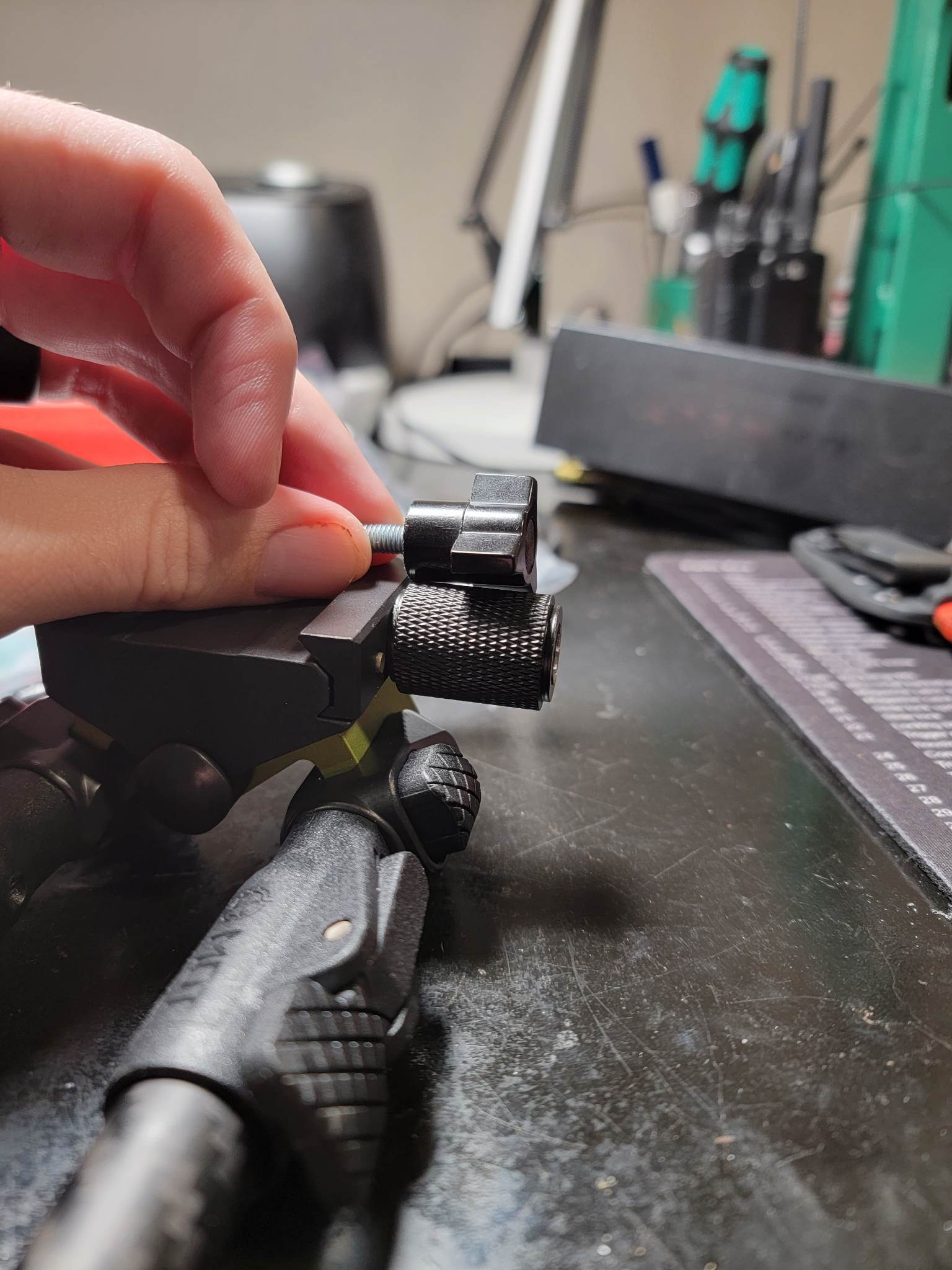

Here is my potential solution based off what you guys did. I am not a fan of the current knob.
Yeah when I drilled out the original threads I goofed and did something wrong. Didn't get the thread engagement like I wanted and the all thread wobbled a bit. So I drilled clean through then bored into the end where the original threads were at. In the end it left me with a very secure bolt engagement and the concenteicity was much better. Happy with the $5 project.

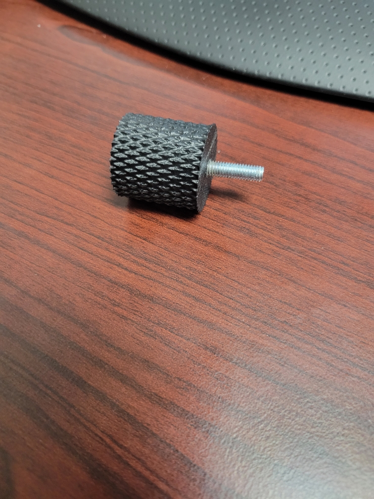

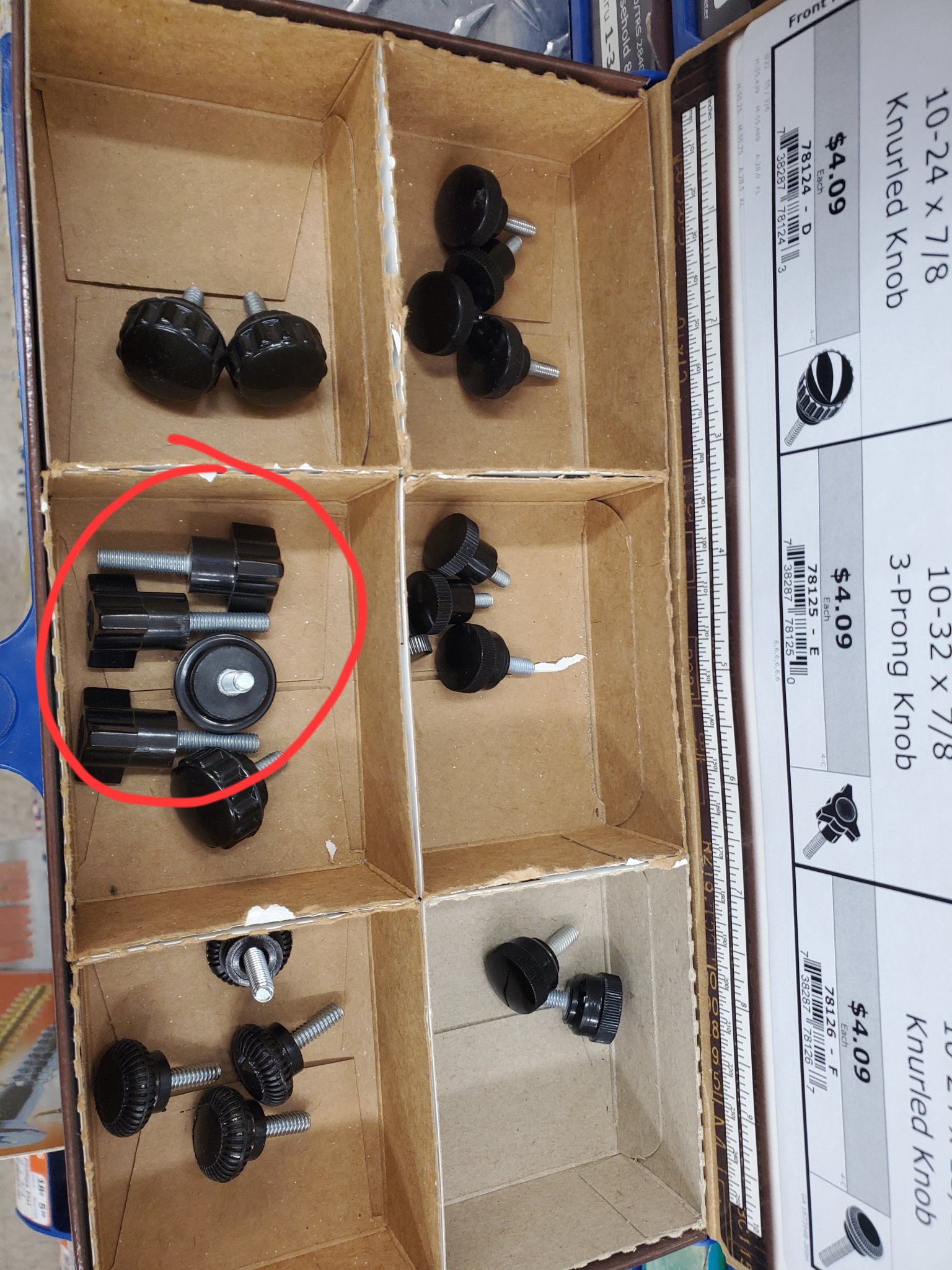

Changed my knob out. Was looking for something narrower but this works and no modification required.

I did the same thing, used a 1 1/2 in bolt, I actually did two as I had bought one for a pic rail as well. That version uses two bolts so it won't work. If anyone has an arca type that wants to upgrade their knob I have an extra like Flyfishers posted above.

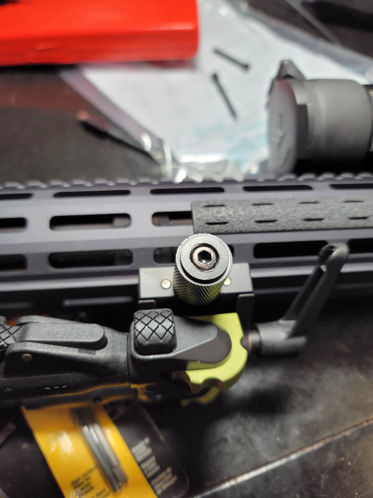

So, when I stumbled onto this thread, I thought "what are all of these guys talking about? The tension knob is fine." But, then I pulled the bipod out of the gun safe and was like "oh, no, no, no. we have to do something about that." So, off to Lowes I went. Down the drawer pull isle. Then, over to get a few 10-32 screws on the next isle. Finally, a 10-32 tap. Yeah, that's much better.

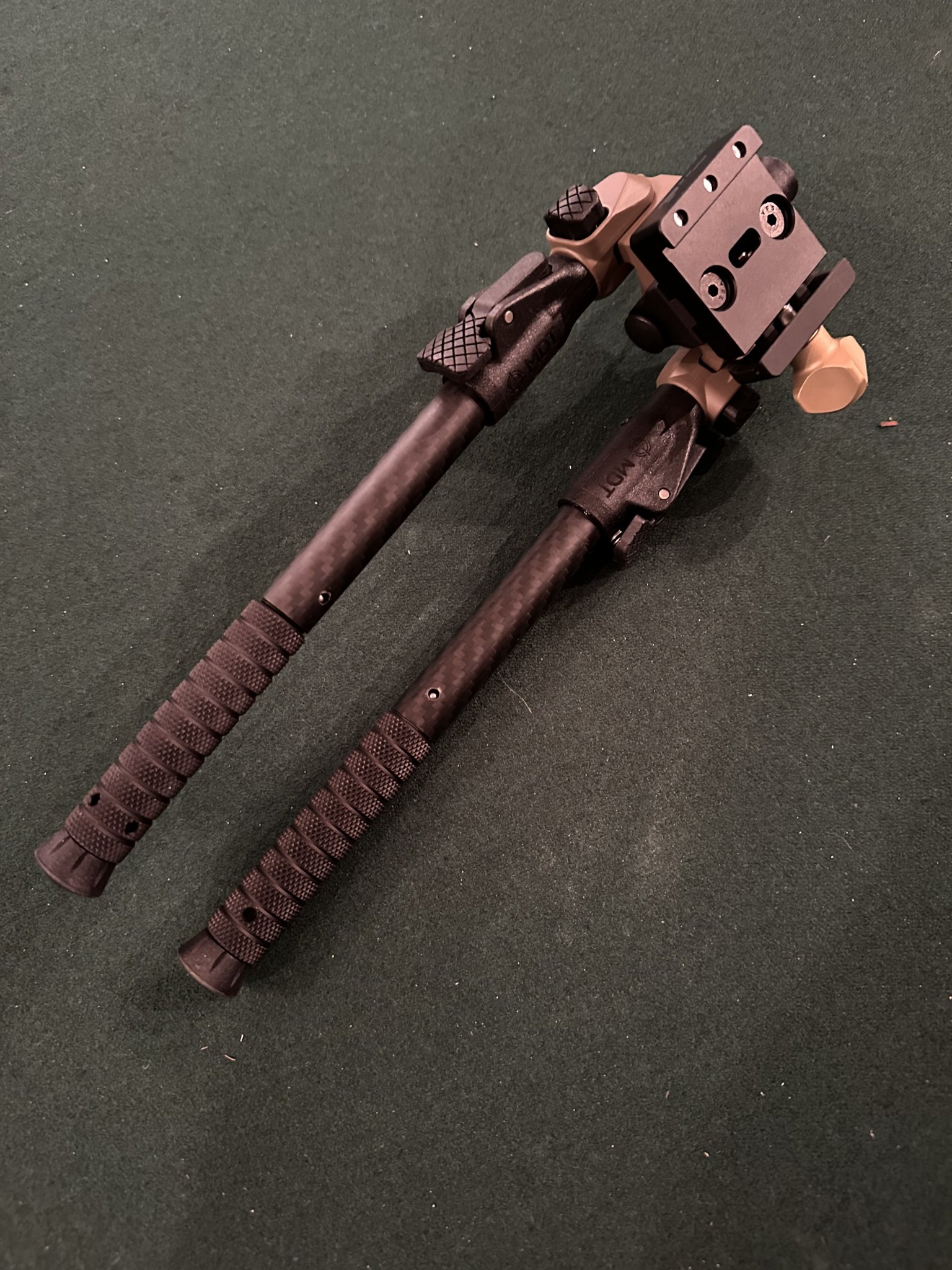

The more I played with the bipod on the rifle, the more the cant adjustment lever bothered me. Not that it is ineffective, but it just kind of dangles out in space. I might have occasion to stow the bipod legs to the rear, which requires the adjustment lever to be dangling more or less straight down from the rifle. On similarly equipped bipods, my preference is to have the lever all the way to the left when tight. This keeps it out of the way but easily accessible with my support hand. Alas, this would have the bipod flopping around if I stow the legs backwards.
TL:DR- I replaced the lever with a knob. This is the same model knob as I used for the Arca tension knob. I drilled and tapped it for 1/4-20 threads (just happened to have that tap from another project) and it works a treat. It is big enough to offer sufficient leverage to torque down the cant, without being otherwise obtrusive. The downside is that these knobs are heavy. Each knob weights 2.7 ounces, where the original hardware- combined- weighs only 0.75 oz.
