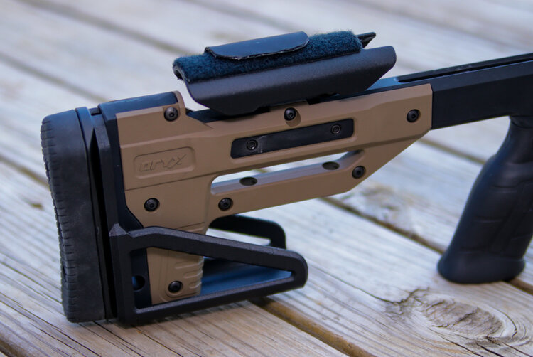

The cheek rest post spacing is different from the ACC/ESS, so the middle Velcro straps on the Weibad pad won't fit without mods. Probably worth giving them a call to add the Oryx as a separate model before ordering one.

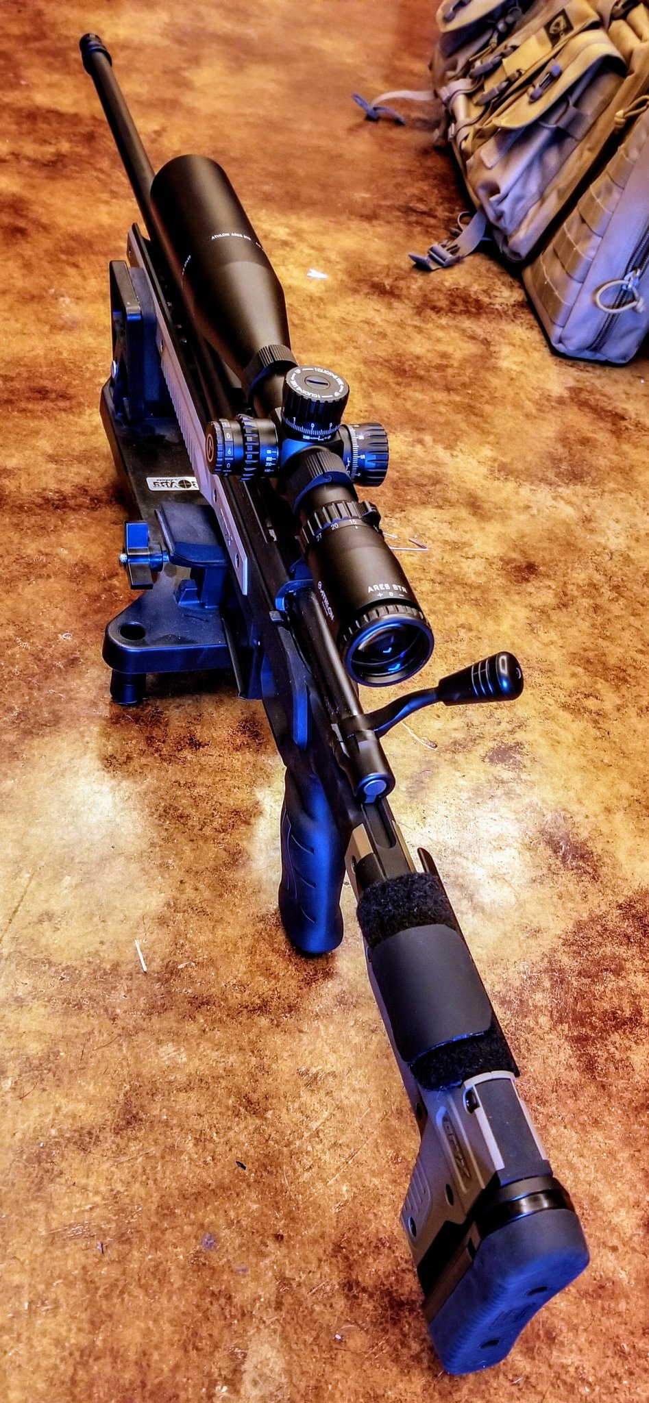

Tapped the stock for a pic rail to mount an Accushot.
Did yours have a thin pad on the cheek rest from the factory

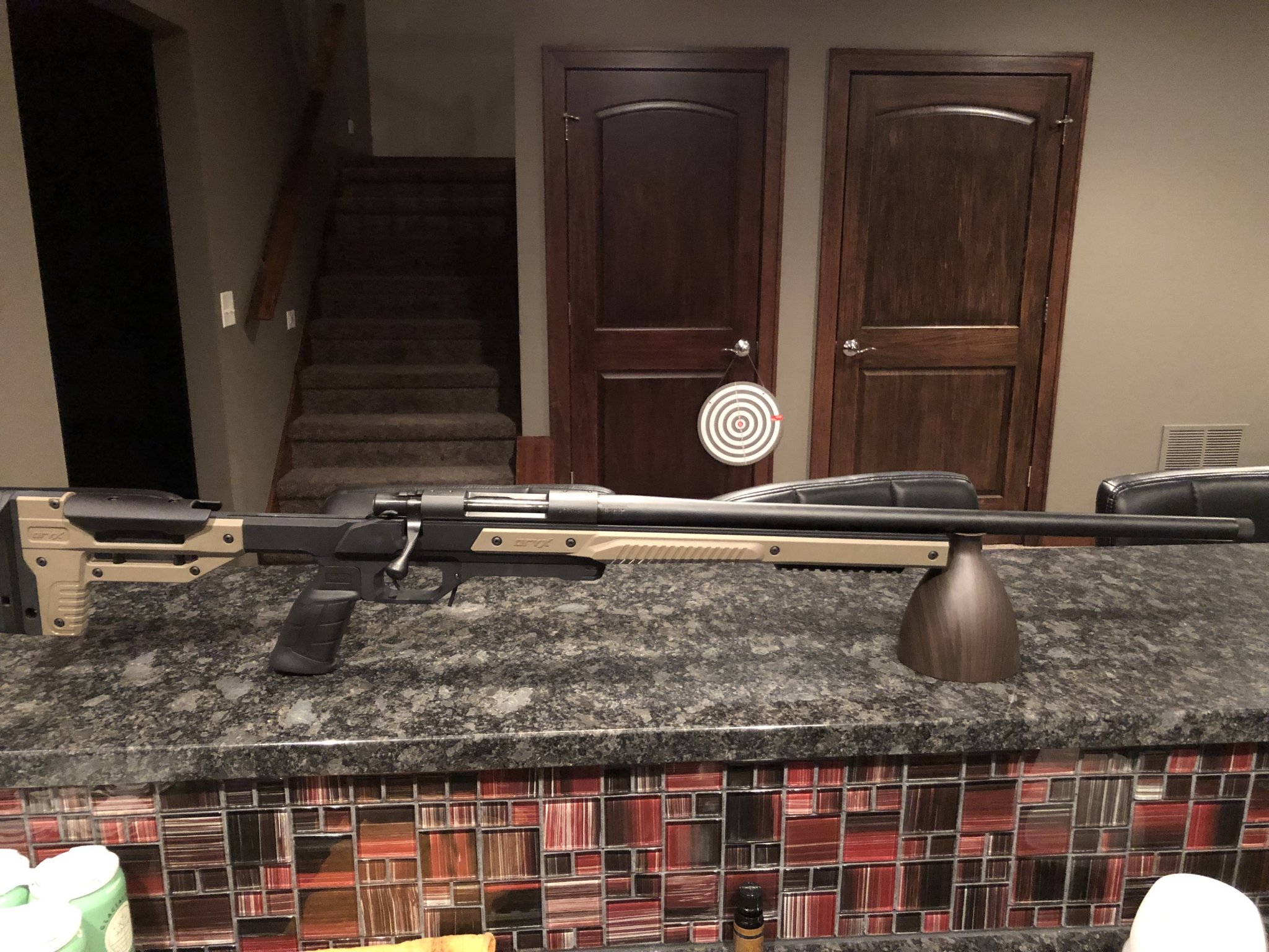

So I assembled the Howa 1500 and the Oryx this evening. It was a piece of cake and a nice fit.
One thing I like is there is an ever-so-slight gap between the back vertical surface of the action block and the chassis inletting... This means that when the action is moving backward in the stock the recoil lug is what stops its motion, and not the back of the action, which is good. The back surface of the recoil lug fits the stock so well I am not sure that bedding the recoil lug is necessary. I may bed it later but I am in no hurry to do so.

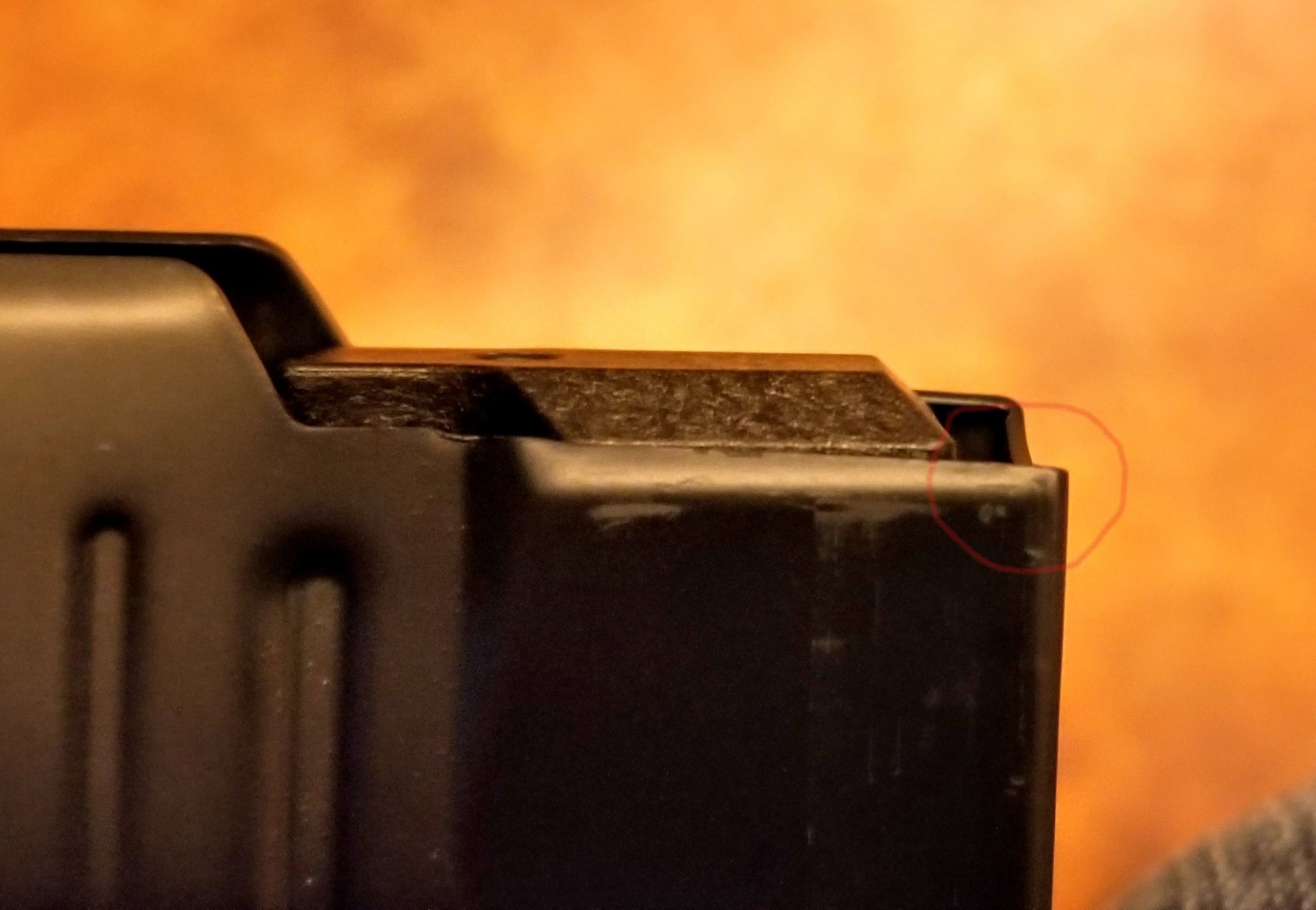

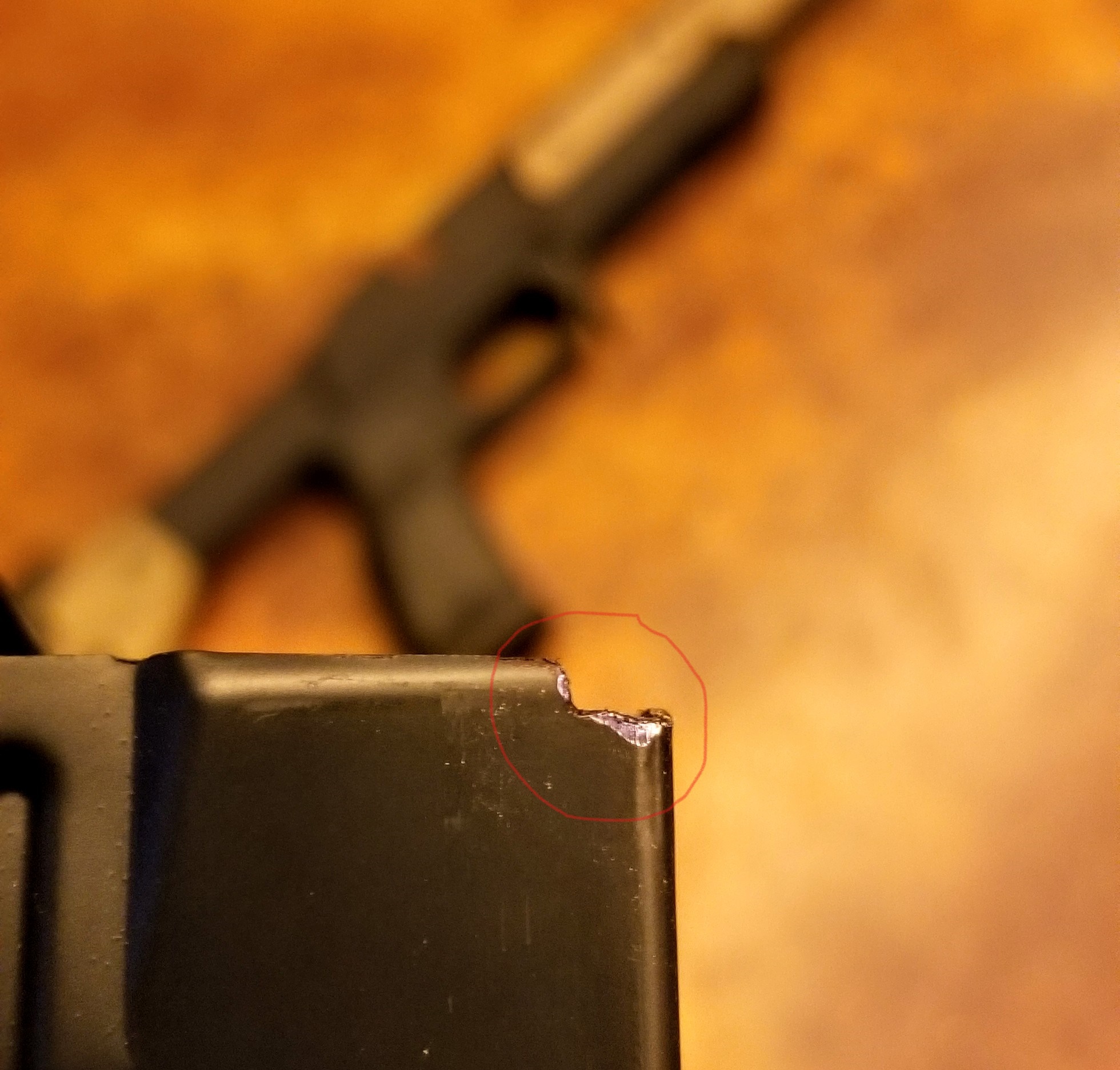

On the magazine modification... While assembling the action to the chassis I looked carefully at the magazine to verify where the interference was. It is simple really, just remove the front top corners of the magazine where they interfere with the bottom of the action block.
Here is what the MDT AICS looks like before modification. The area circled in red is what needs to be removed (both sides, down to the bottom of the saddle shape on the front of the magazine).
Here is what the rough cut looks like afterwards. This will work as-is but I cleaned up the rough edges and painted it afterwards. The magazine snaps in place with a very slight floating movement, and falls free (empty) when the magazine is released. The magazine well is a little sticky in that it is the same matte finish of the rest of the chassis but with a few magazine insertions and removals it should polish up nicely.

Yes, there should be a gap you can see from inside the magazine well on the front and back. The Howa 1500 is meant to be supported on the recoil lug and the tang of the rifle. With our system bedding isn't necessary.
