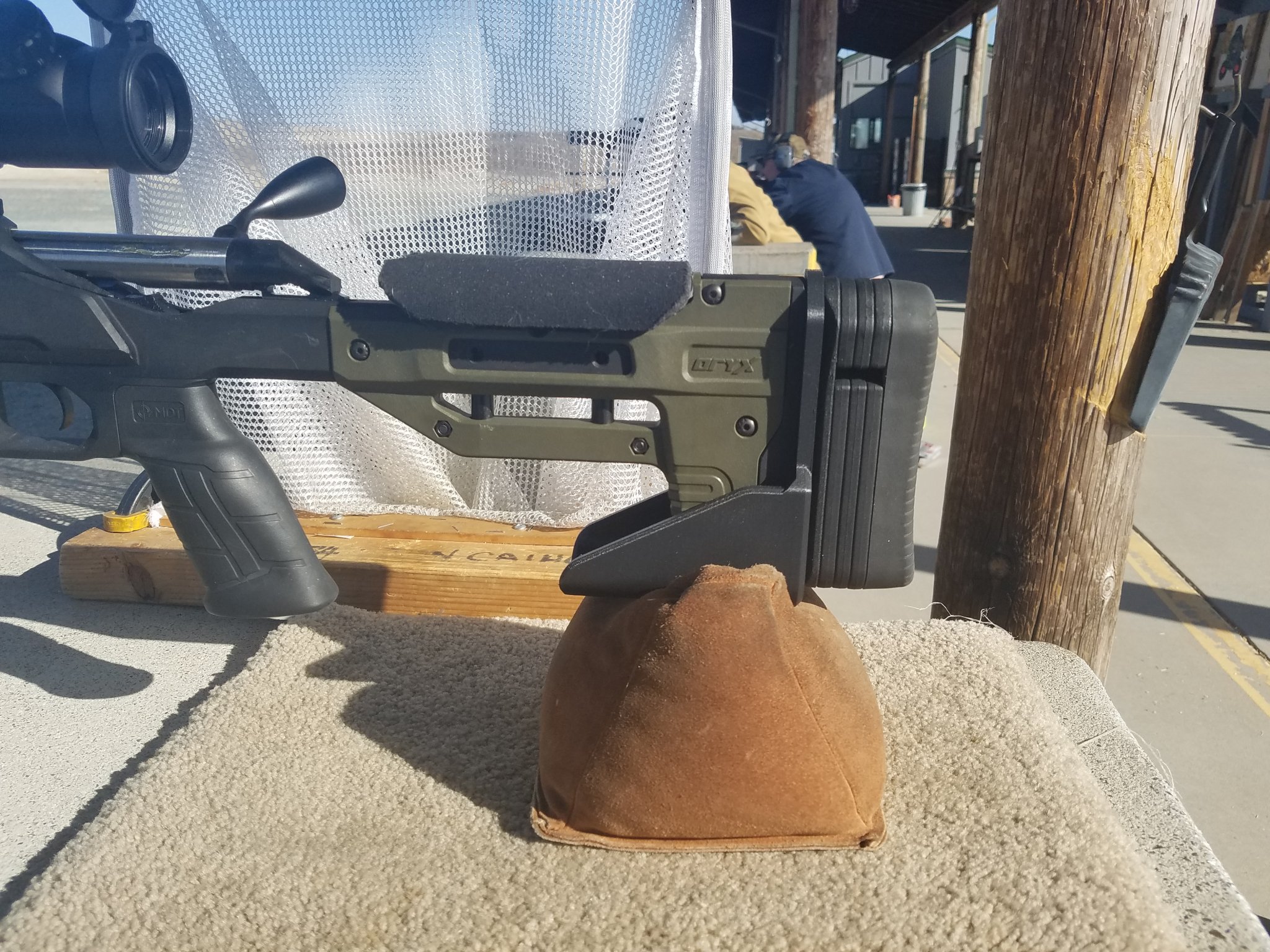

Doing a little testing today

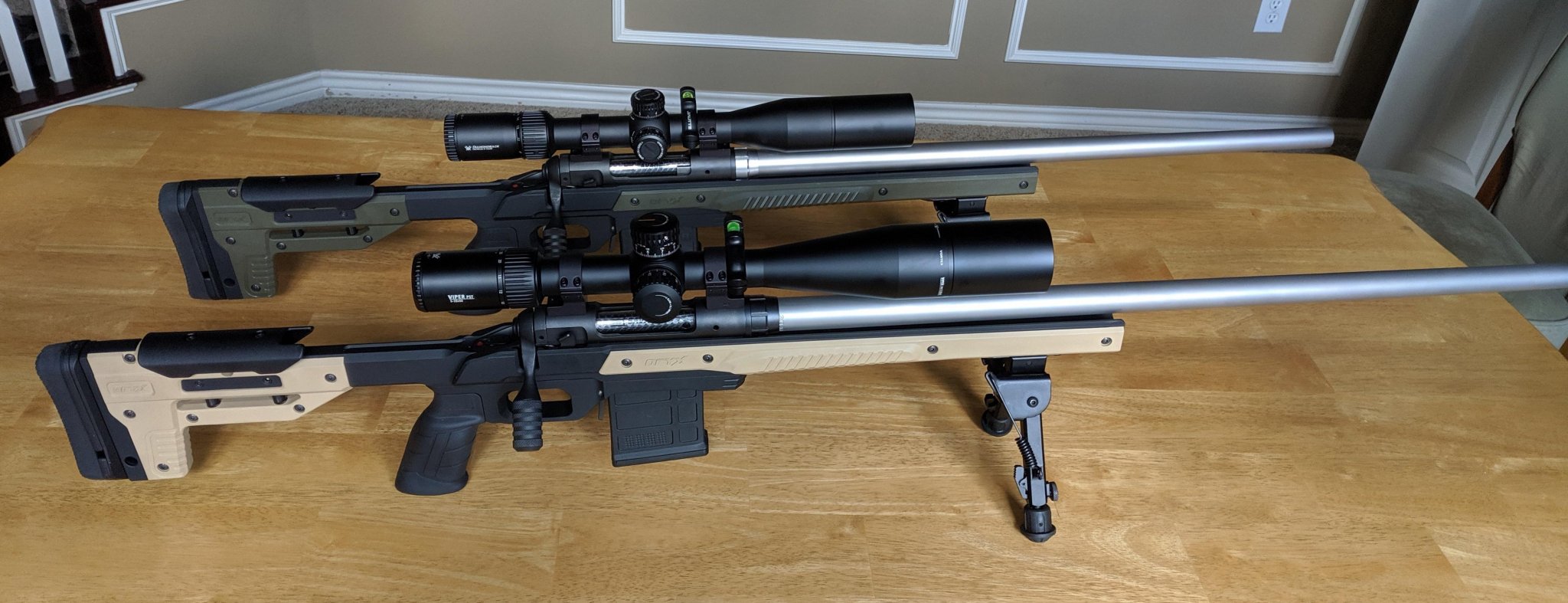

My 2 Oryx chassis for a pair of Savage 12FV donors in .243 and .223 I sprayed the chassis metal in Alumahyde to smooth out the rough anodizing and painted the plastic panels with Krylon for a different look on one of them. I was almost going to pick up a 3rd one on the blemish sale but picked up a MDT Savage Stealth with stock for the same price. As a side note the .223 is using Ruger mags with modified feed lips.
