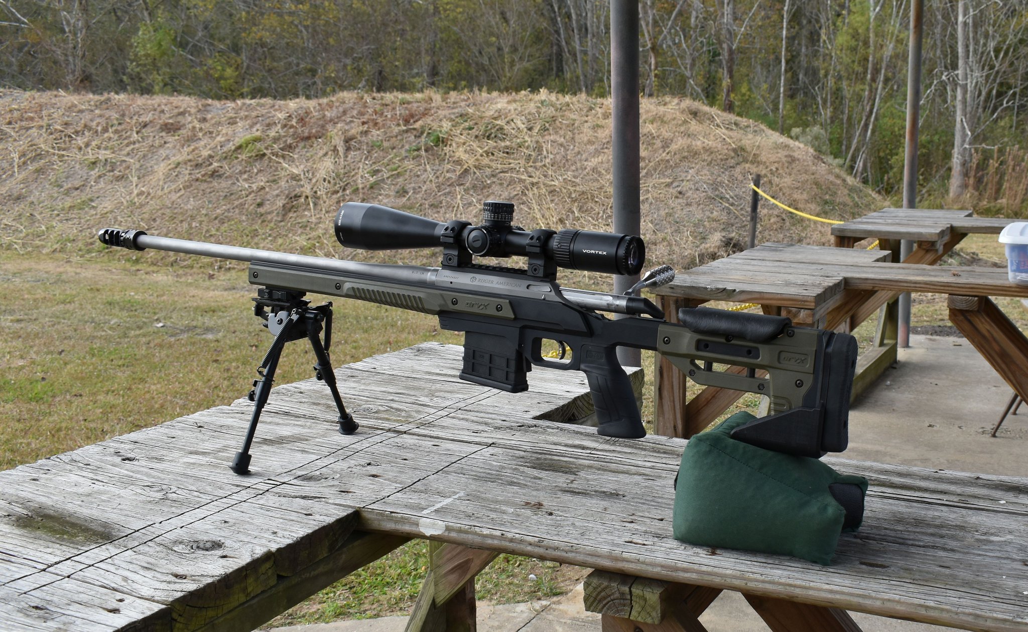

About as hard as removing 2 screws, moving the action to the Oryx and putting the two screws back, takes less than 5 minutes. It would take less, but on of the screws is under the mag release to you have to install that separately after the two action screws.
Looks good man, any issues with mags feeding? Stupid question here but are you using the mag that came with the chassis?
Magazines work excellent in the .473 bolt face Americans ( 308 Winchester, 243 Winchester, 6.5 Creedmoor and so on.) A magazine is not included with the chassis as we cannot predict what caliber you have. It's an AICS pattern magazine well so there are lots of options for magazines.

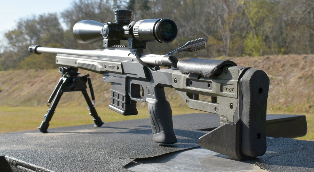

Has anybody tried to modify that oryx chassis with a bag rider? I’m also considering adding some weight to the back end as I’m running a heavy varmint barrel. My groups are all sub .5” with Berger 180 hybrids and also 180 eld-ms but I want more...
I've been evaluating two different versions of bag rides from Jamer (https://www.jamerllc.com/) One vision is shorter, wider and really locks into a rabbit ear bag for shooting from a rest and the other is long and narrow and works well for a squeeze bag. Both versions slip on in place of the LOP spacer. I have the first one on my 6.5 and the other style on my .223.

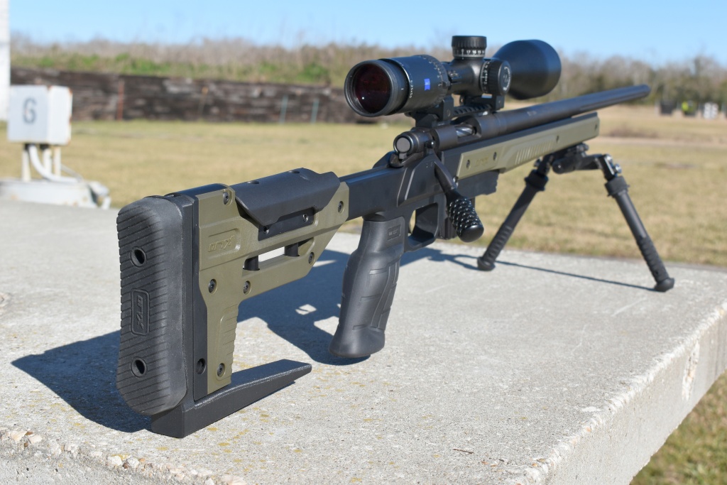

Here is a new option for an Oryx bag rider
thanks I just grabbed one. Has anybody figured out a way to add weight to this chassis? I have a heavy barrel on it and need some weight on the butt stock.
Reactions: JAMER
Hey I just got your bag rider and am trying to install it. Do I install it next to the butt stock or do I put the spacer next to the butt stock? Does it matter?
Got the parts installed and the new spring is noticeably stronger. Thanks for the excellent service!
I tapped the butt for a short pic rail to mount an accupod, and later switched to a homemade aluminum bag rider. That printed bagrider looks like it has enough meat to epoxy in lead slugs, or weights could be strapped under the cheekrest. If you have a waterjet handy,--steel buttpad spacers....

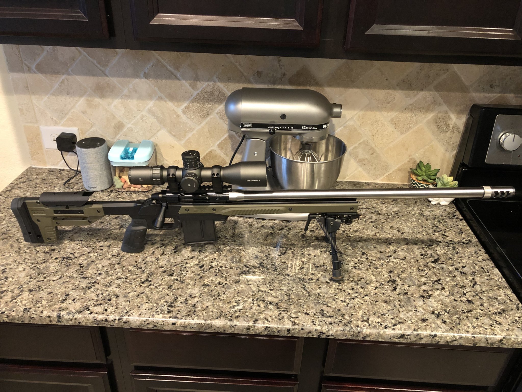

Has anybody found a way to add additional weight to the rear end of the Oryx chassis? I have one in a savage axis inlet with a bull criterion barrel and need just maybe an extra pound somewhere close to my shoulder. I’ve thought about substituting one of the spacers and some how adding a lb in one somehow but am not all that mechanically inclined.
For $400 ($450 for me w vertical grip) it really is a solid value... I’m shooting 284 Win and it’s my only rifle w that cartridge but it shoots solid .35-.55 MOA on 75% of groups @ 100 yards but I can feel it would be better with more weight. Any thoughts?
If you have the means you can have some steel milled/waterjet cut in the shape of the LOP spacers. Should get you some extra weight.
You could also make a bag rider out of rectangular aluminum or steel tubing that can attach with two bolts into the flat section on the bottom of the stock. You could then fill with lead shot. If you heat the tubing with a small torch and melt the lead into one big ingot you wouldn't need end caps.
