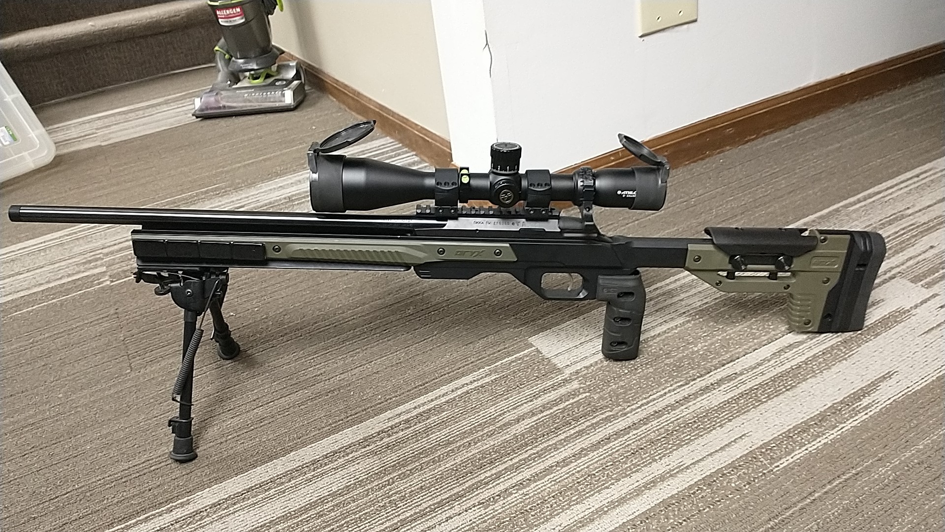

Digging this up to ask if the sling swivel stud on the oryx site can be used in conjunction with the Arca forend?
Looks like the screw nearest to the muzzle on the Arca forend uses the hole that the swivel stud would normally occupy and thus are the same threads as the sling stud. Maybe if the threads are long enough on the stud adapter it can still be used through the Arca forend and into the actual chassis forend?? Arca forend would still be secured by 4 more screws and this rifle doesn't weigh a ton.
I wanted the Arca for occasional hunting, but also like the added weight for general plinking. Definitely also still want to use a Harris without buying pricey RRS and Area419 clamps adapters if possible.
Thanks.
Thanks.
The thread isn't long enough to run it.
-Anthony
-Anthony
For anyone else trying to accomplish the same, I was able to cannibalize the swivel stud from my factory T1X stock and the threads matched the Oryx, and were long enough to engage the chassis, secure the Arca, and still work for a Harris
