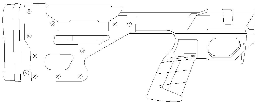

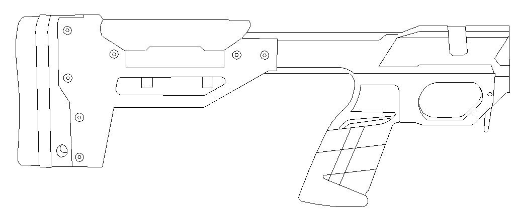

I have one of the Jamer bag riders too, and it’s great but I would also like MDT to make a rear stock shell that had a longer area for a bag. I know I would probably buy another Oryx for a more general purpose rifle if that was available.
This second attachment was an idea/design I came up with a couple years ago and shared in this thread. The first attachment is the Oryx’ original configuration. I wonder if @Tyler Kemp with M-K Machining would have an interest in producing/refining something like this for the Oryx shooters?
Complete side panels would be awesome, but would NOT be cheap. Probably $200 range.
A bag rider is doable at a lower cost, for sure.
My ask for on an Oryx would be an Arca rail built in. Preferably the Area 419 Arca Lok system.
I had one on T 1X , replaced the Tikka with Bergara.
That's not quite what the Oryx was intended for, and it would be quite expensive to make. However, if you are looking for that type of functionality at a lower price, check out our XRS and grab the Integrated ARCA forend; that would be the best thing!
-Anthony
Reactions: Just Chuck
We did update to include the M-LOK slot so you could use an M-LOK bag rider on the current production chassis

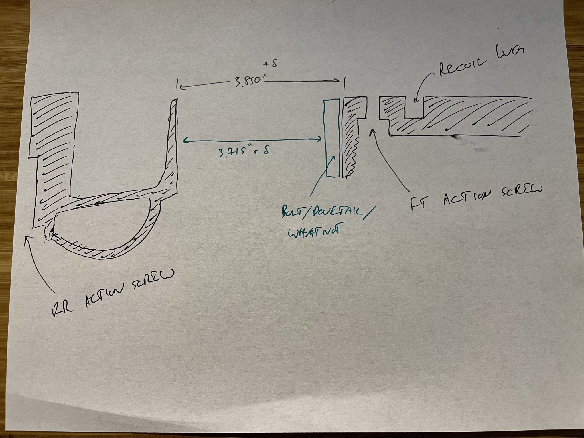

First bit: Several chassis options can do something like this. Have it come with the insert for 3.715 and be removable for 3.850 mags; it seems that the 3.850 capable actions all cut forward instead of both directions.
Second bit: I’m super curious how many people are buying a chassis for their Remington 700 vs buying a chassis for customs/clones/etc. I’m also somewhat curious about the breakdowns of which clone actions are going into chassis systems, but R700 vs clone for people who do more than shoot a deer at 30yd every other year is super relevant to *gestures at the industry*.
