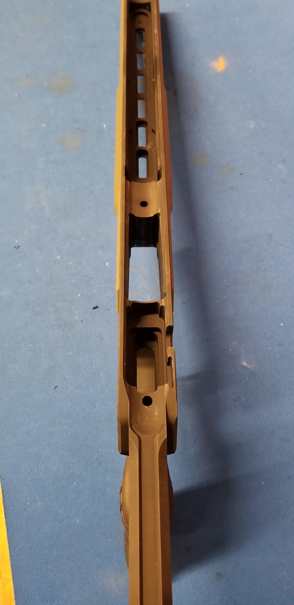

I would like to see a picture of the action bed.
This is not the Oryx V-block, but it looks almost identical unless you're shooting a Howa 1500 SA/LA or Mini.
