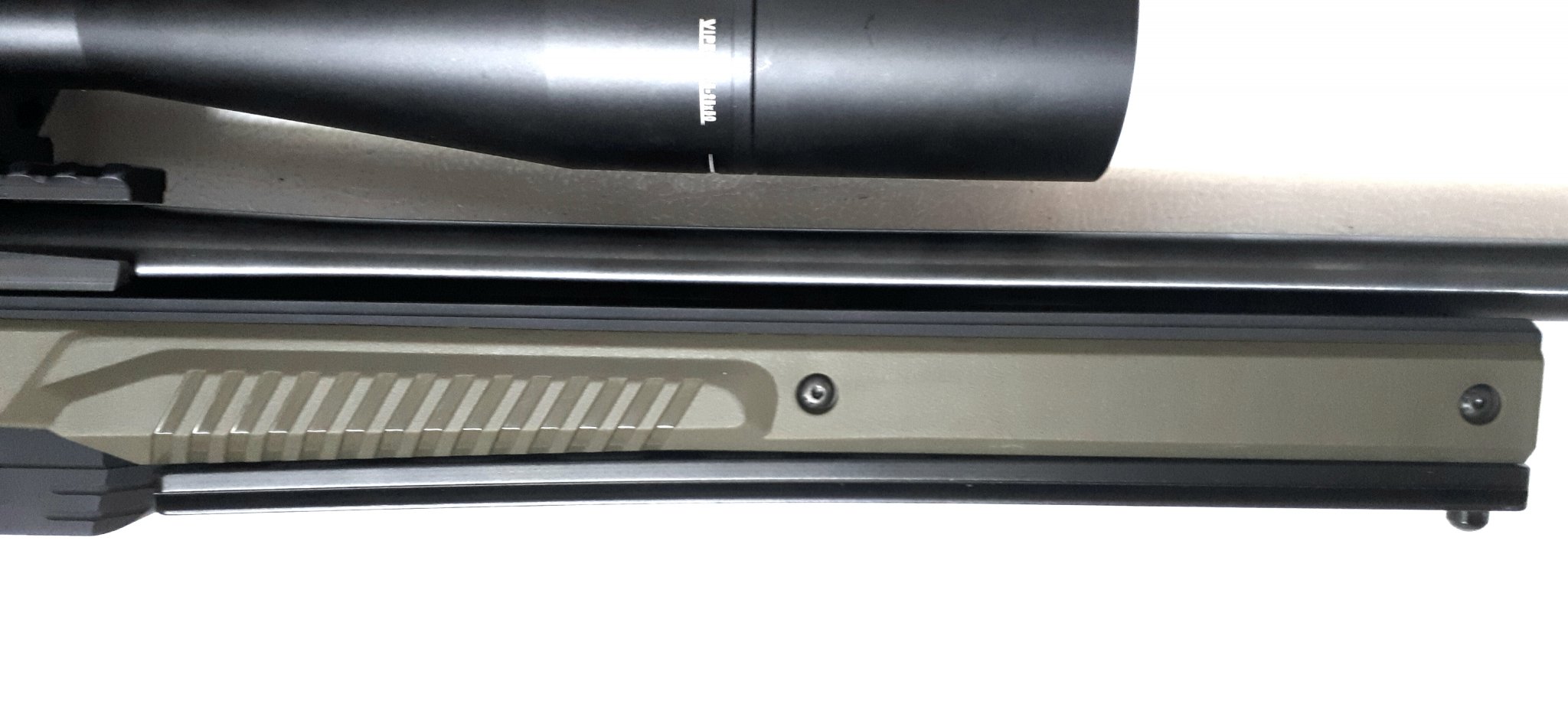

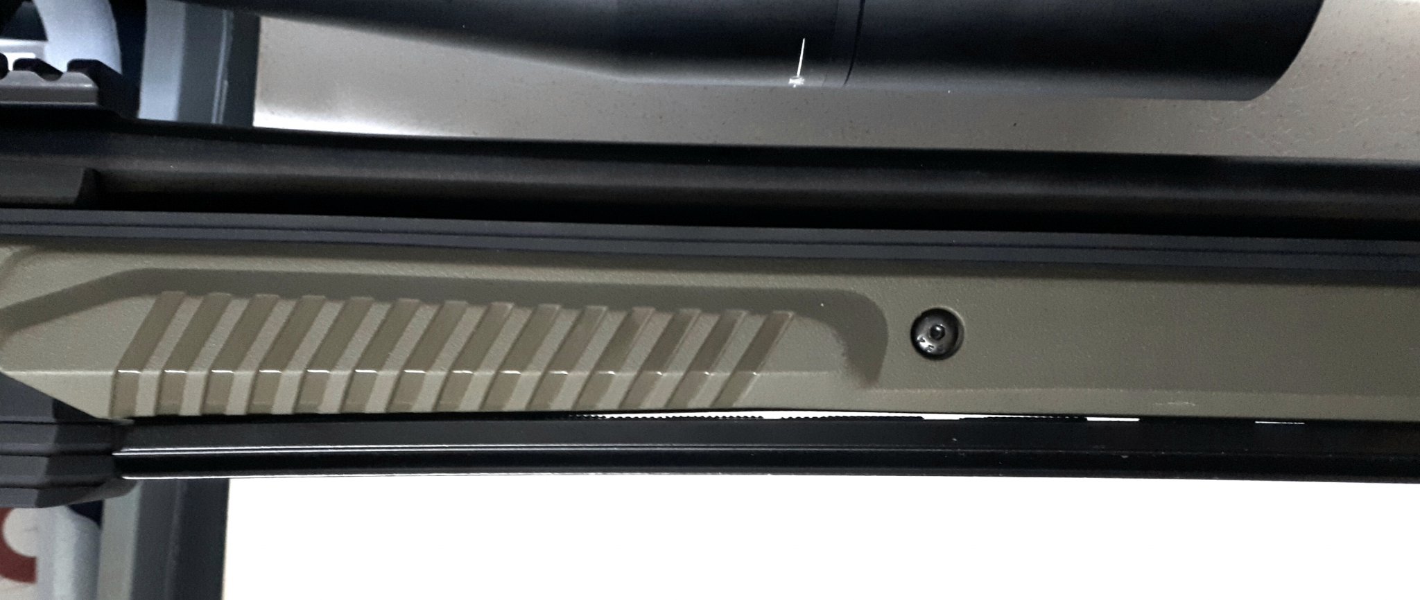

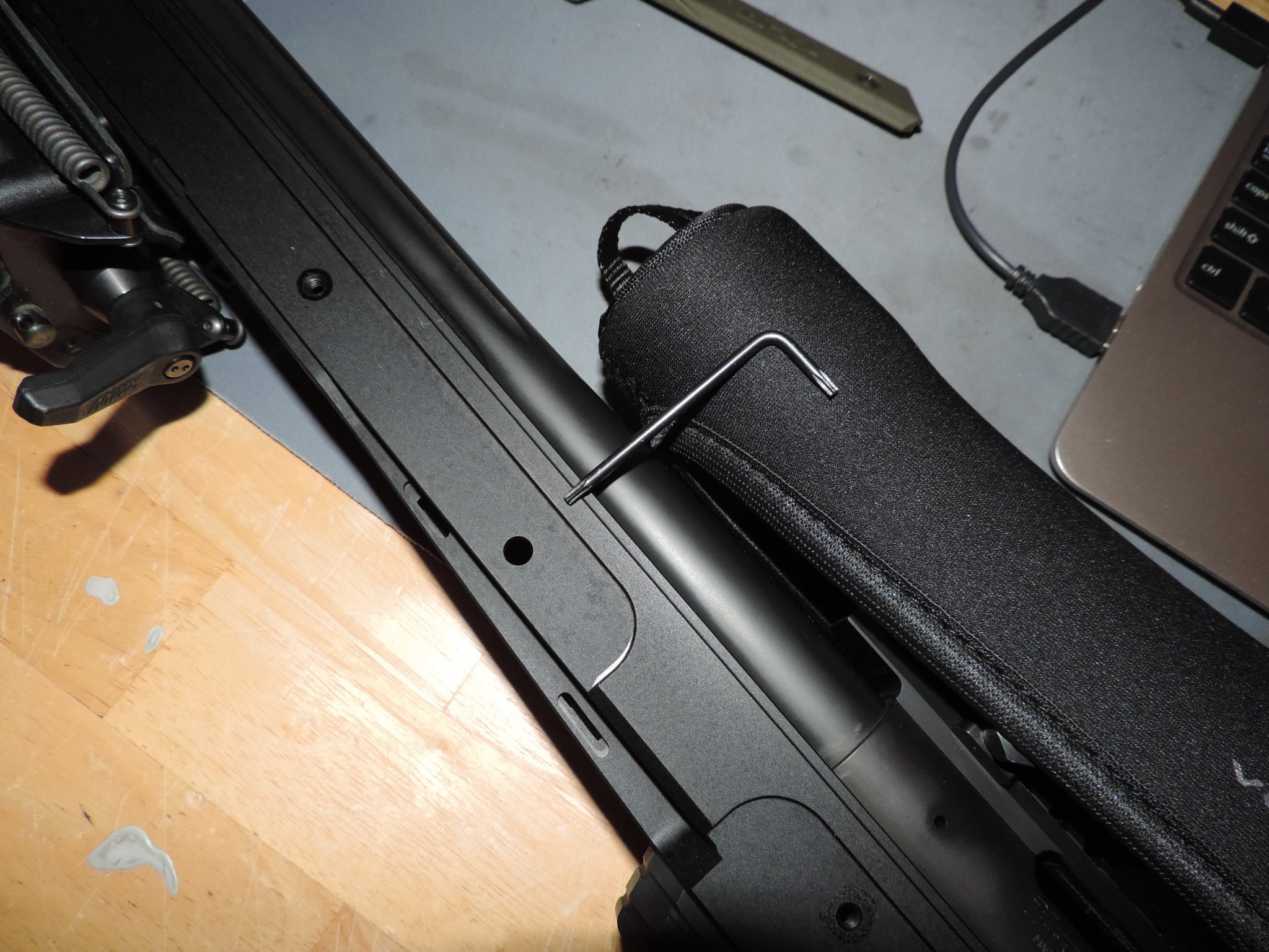

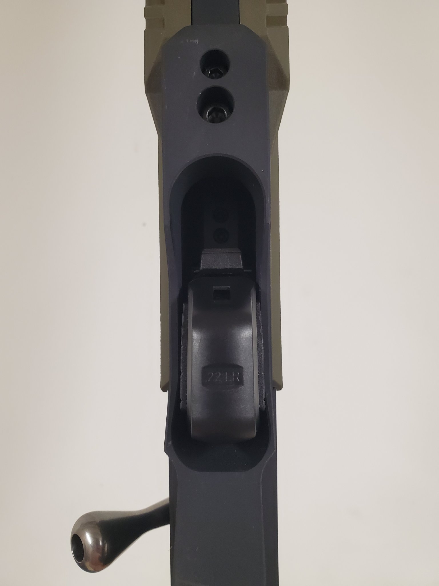

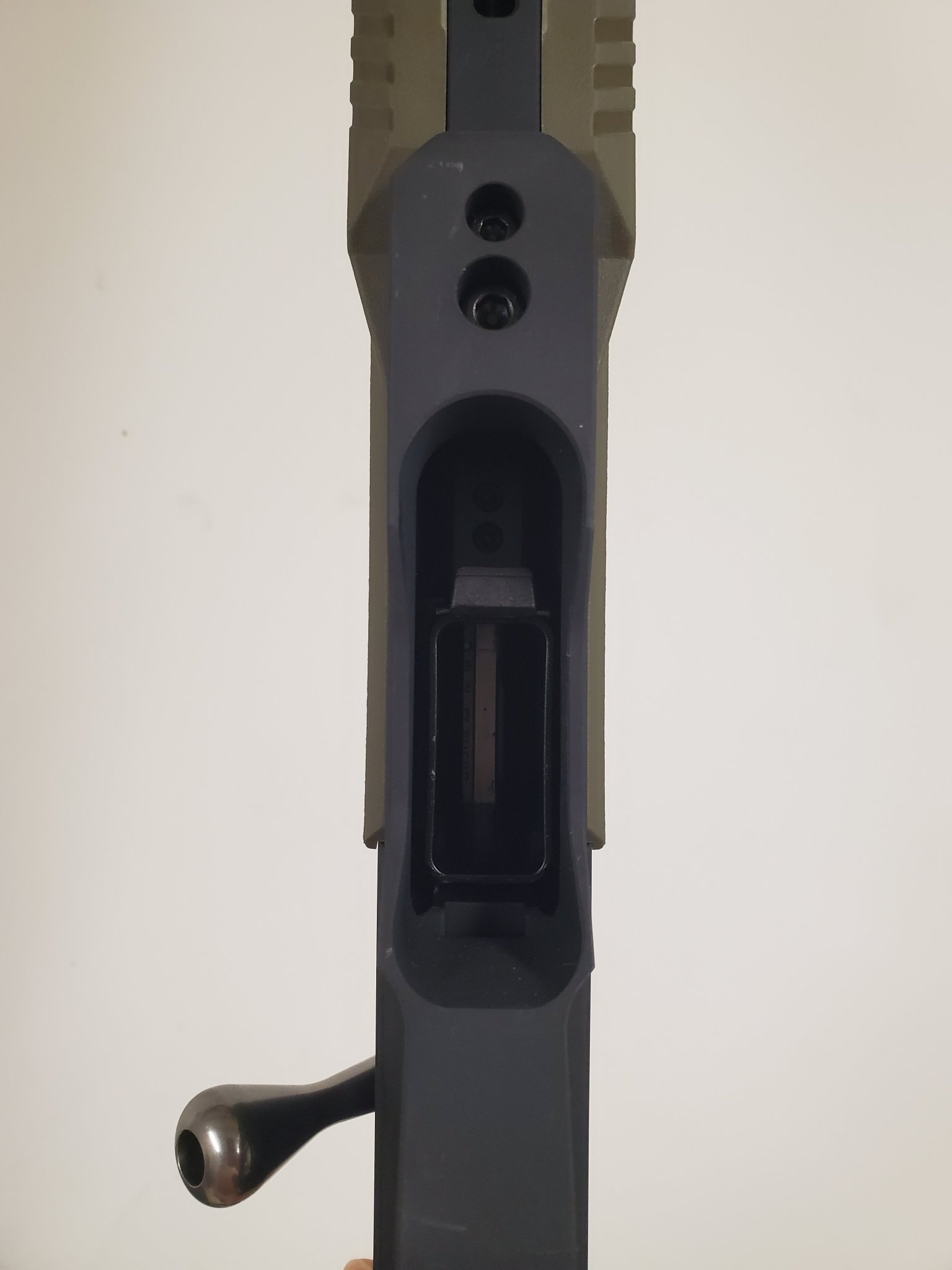

So I've also been wondering about a front sling mount solution. I tried having a sling mounted to the bottom and didn't like the way the rifle hung. I've been thinking about drilling a hole in the front left panel which would correspond with the extra hole in the chassis and then try to rig something up that way. It appears as though there would be ample room for a small backer on the inside of the barrel channel. The pictures aren't great but they should get my point across. I'm not exactly sure where I would go from there but to me, it seems like a good place to start.

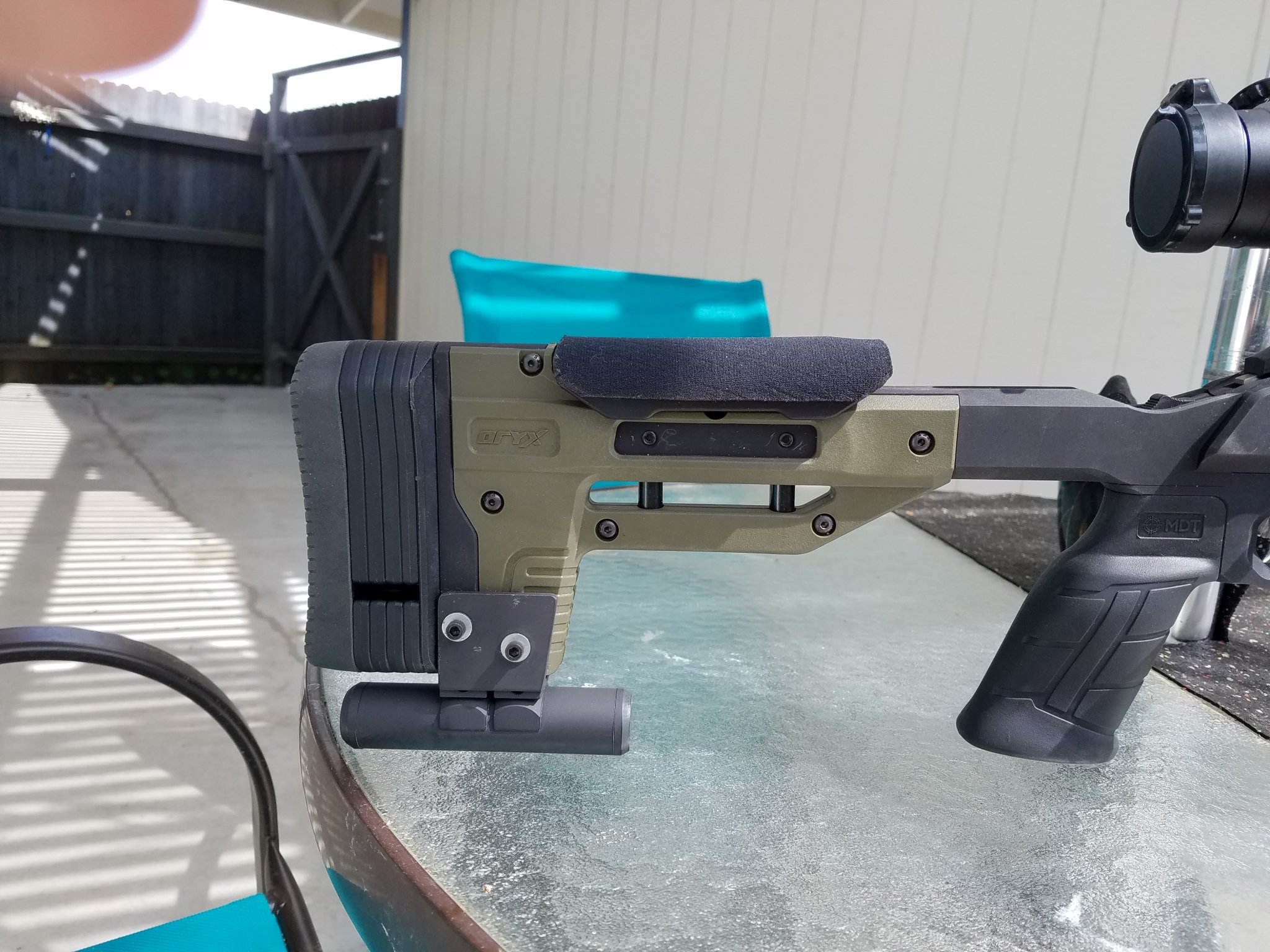

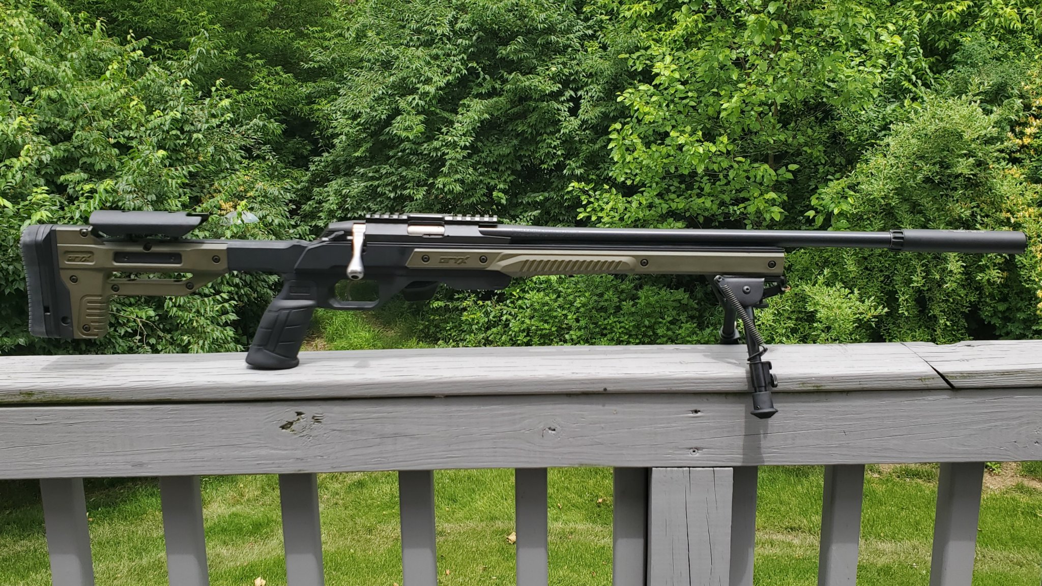

I made this bag rider from a piece of Aluminum tubing some aluminum angle and a pair of 1" scope rings used one of the existing holes for attaching the color side plate and made a threaded plug for the flush mount tube works great and

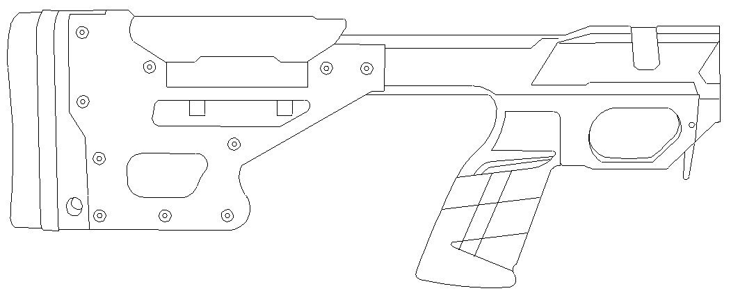

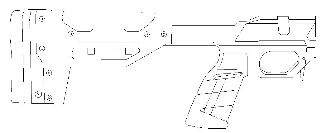

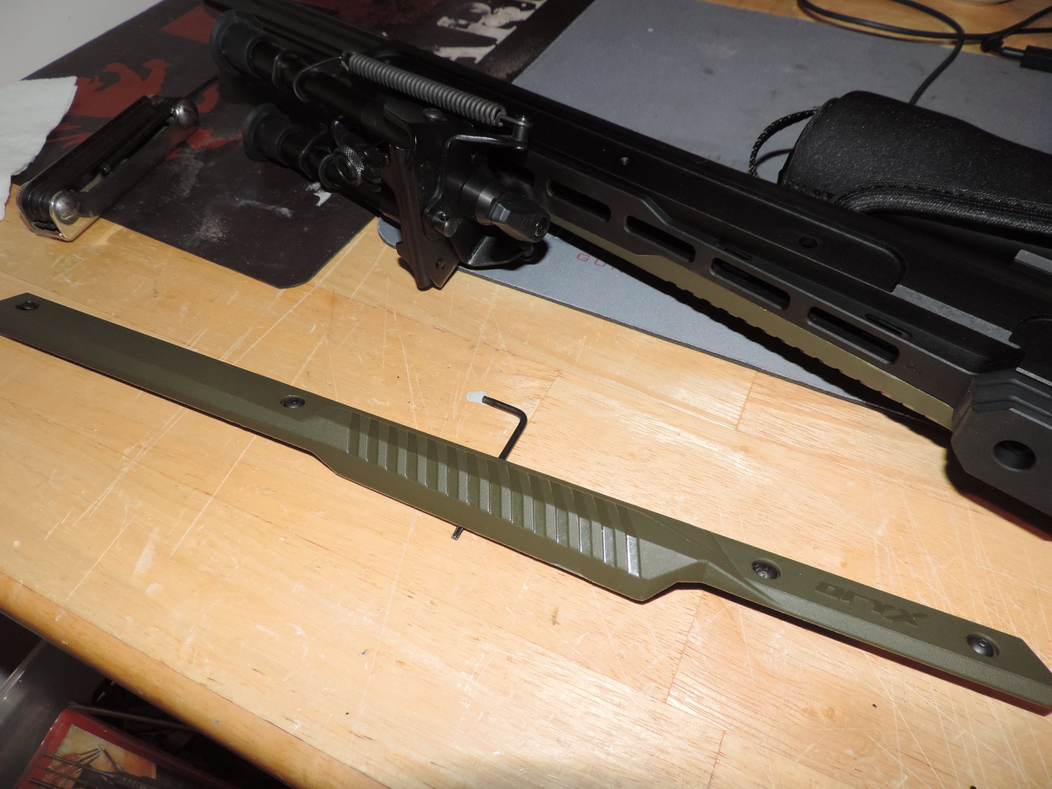

I’ve been following the Oryx for a while now, trying to decide if it’s the chassis for my budget Howa build. I jumped on Brownells’ great sale last fall! I’m torn between it and the KRG Bravo. I too have concerns about the short stock base for riding a bag and I think it could be a simple fix by Oryx, if even sold as aftermarket replacement panels. Why not mold the polymer stock panels with a little bit of an extension forward of the chassis aluminum. Maybe 3” or so, and maybe with a bit of a hook molded in. Other than creating the initial molds, with polymer it should be an easy, inexpensive upgrade for the consumer. Here’s an idea of what’s in my mind...original vs the upgrade.
Anyone know someone over at Victor company? I had a similar thought to you, and their viper skins came to mind. The oryx backbone seems to be similar in basic concept to an AI backbone. I am NOT saying they're the same. I think the main consideration would be whether there are differences in the external measurements between individual copies of the oryx. If not, then a mass producable thing should be possible.

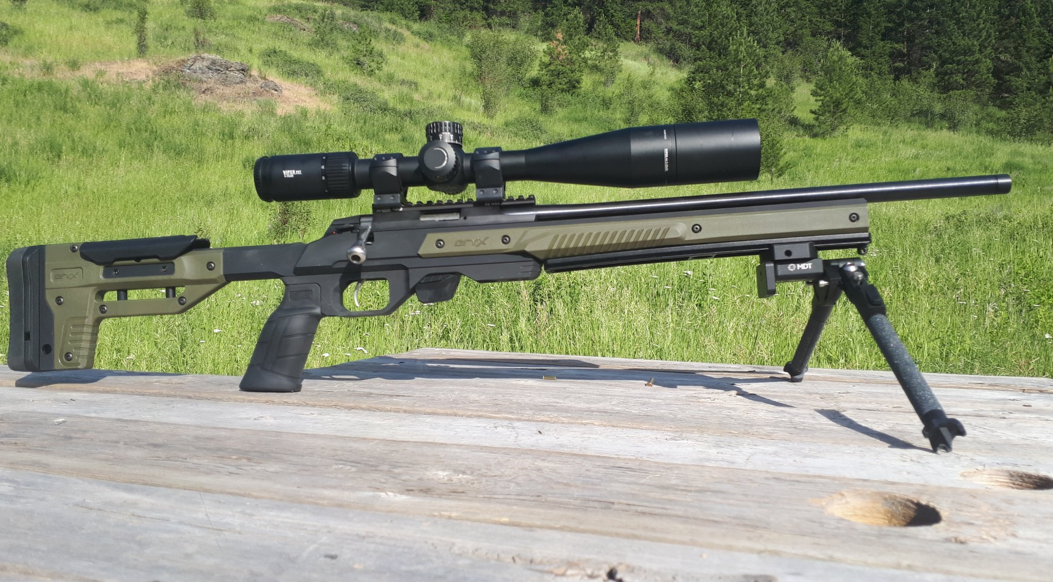

Was able to get my T1X to the range today after installing the Oryx Friday. Love how it feels, and it seems to have tightened up the groups as well.
I do like @sierra2 redesigned rear plastics and would like to see them as an accessory @MDT_Josh. I can see were they would make using a rear bag a little easier. Overall, it is an awesome chassis for the price. It was definitely worth the wait.

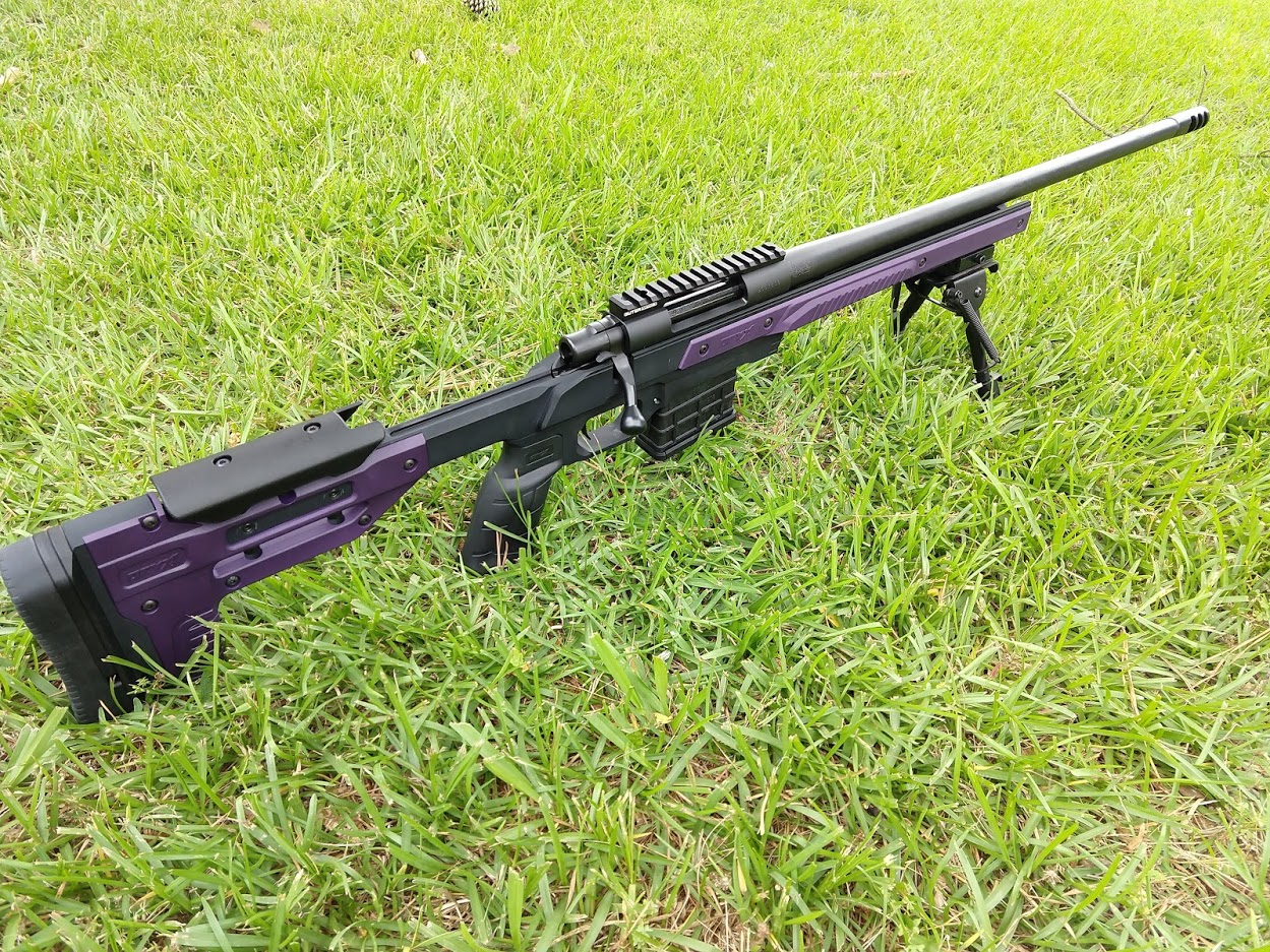

On a side note, has anyone got around to painting their Oryx yet?

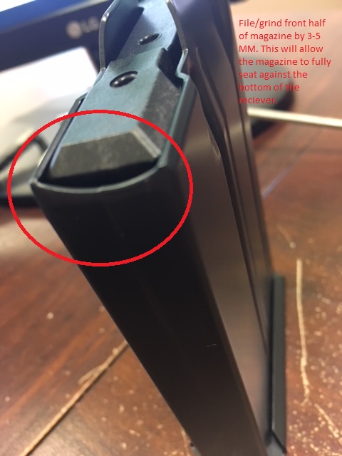

Has anyone found a 10 round mag that will work with the Howa 1500 Oryx?
Im using magpul AICS..had to take out the mag latch and file 1mm off the top so it latches...I have not run it in field conditions yet but it seems
to work fine when 'dry' cycling..
I'll have a chance here soon to try it out and will report back.
Talked to MDT and they were very helpful. They said to just file/remove ~3mm off the front edges/corners of their metal mags to allow it to clear the flat bottom receivers like the Howa. They even sent me a picture showing where to remove the metal.

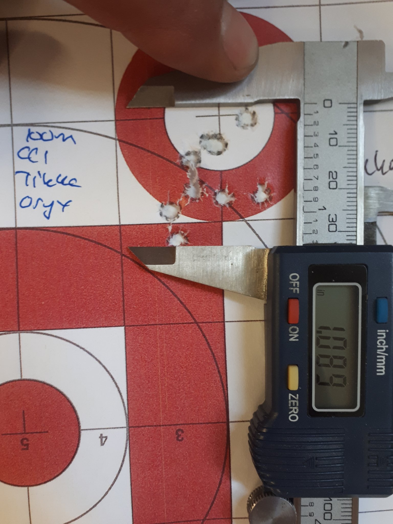

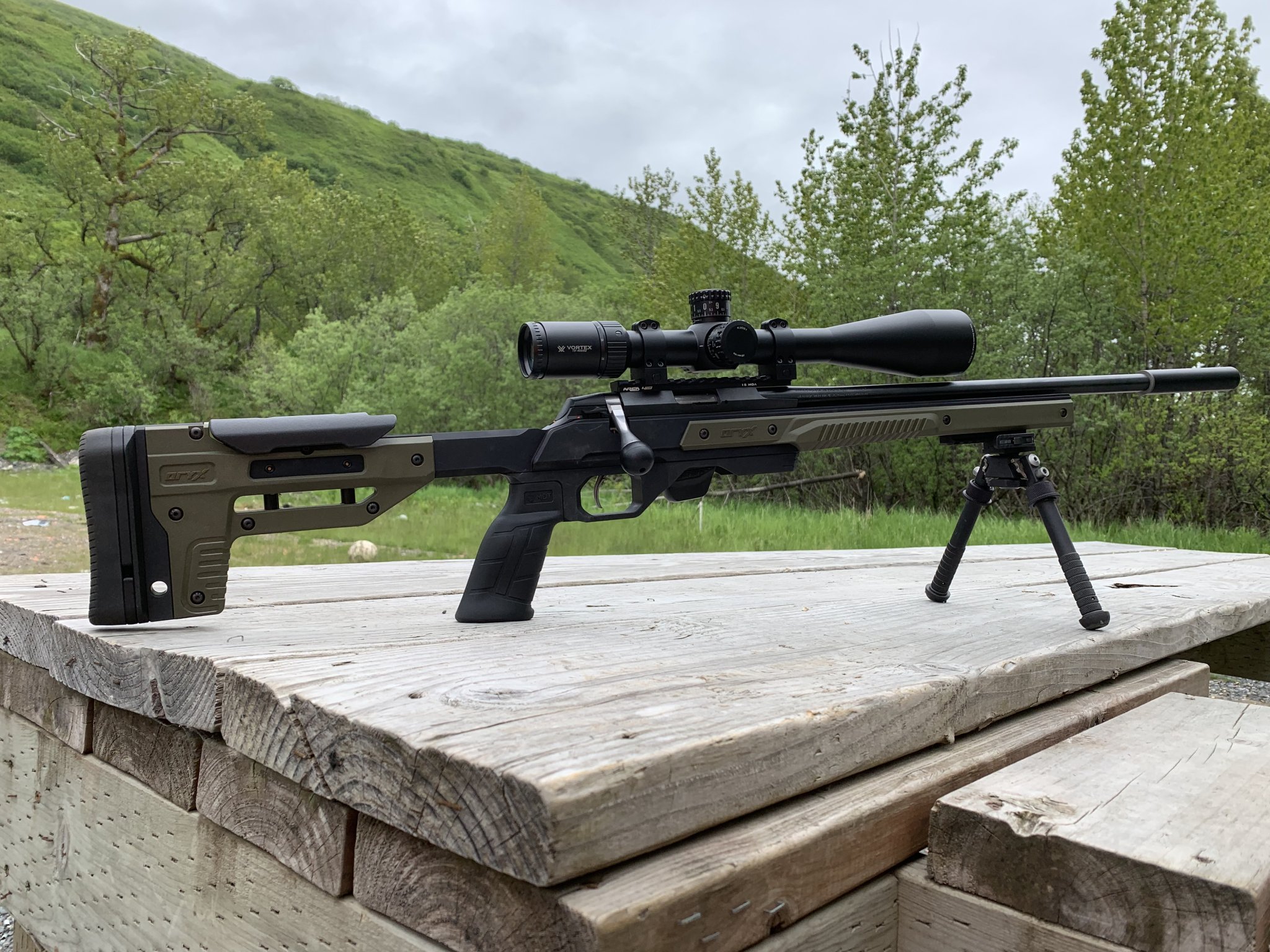

Just installed by Tikka T1x into the Oryx chassis. Just quick trip to the range, shoots great despite the windy conditions. Definitely likes the Action screws torqued pretty tight. Just over an 1 inch at 100m with CCI SV. Shoots SK Rifle Match well also. I installed a generic 12 inch Arca rail on the bottom of the forend.
I'm liking the Oryx chassis in this configuration, poor man's ACC?

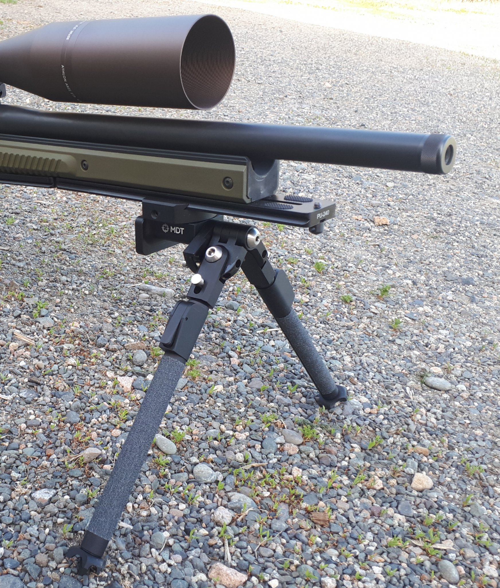

Just installed by Tikka T1x into the Oryx chassis. Just quick trip to the range, shoots great despite the windy conditions. Definitely likes the Action screws torqued pretty tight. Just over an 1 inch at 100m with CCI SV. Shoots SK Rifle Match well also. I installed a generic 12 inch Arca rail on the bottom of the forend. View attachment 7095391View attachment 7095392I'm liking the Oryx chassis in this configuration, poor man's ACC?
Ed
What Arca rail did you use and did it "bend" okay to make the transition from the front to the back of the hand guard?
It was from ebay. 300mm QR Quick Release Plate for Benro Arca Swiss Camera Tripod Ball Head. Here is the link https://www.ebay.ca/itm/300mm-QR-Qu...a-Swiss-Camera-Tripod-Ball-Head-/113369354106
It has a bit of flex that allows it to follow the contour of the forend. Is not a perfect fit, but it allows the Arca attachments to move along the full length of the rail...
