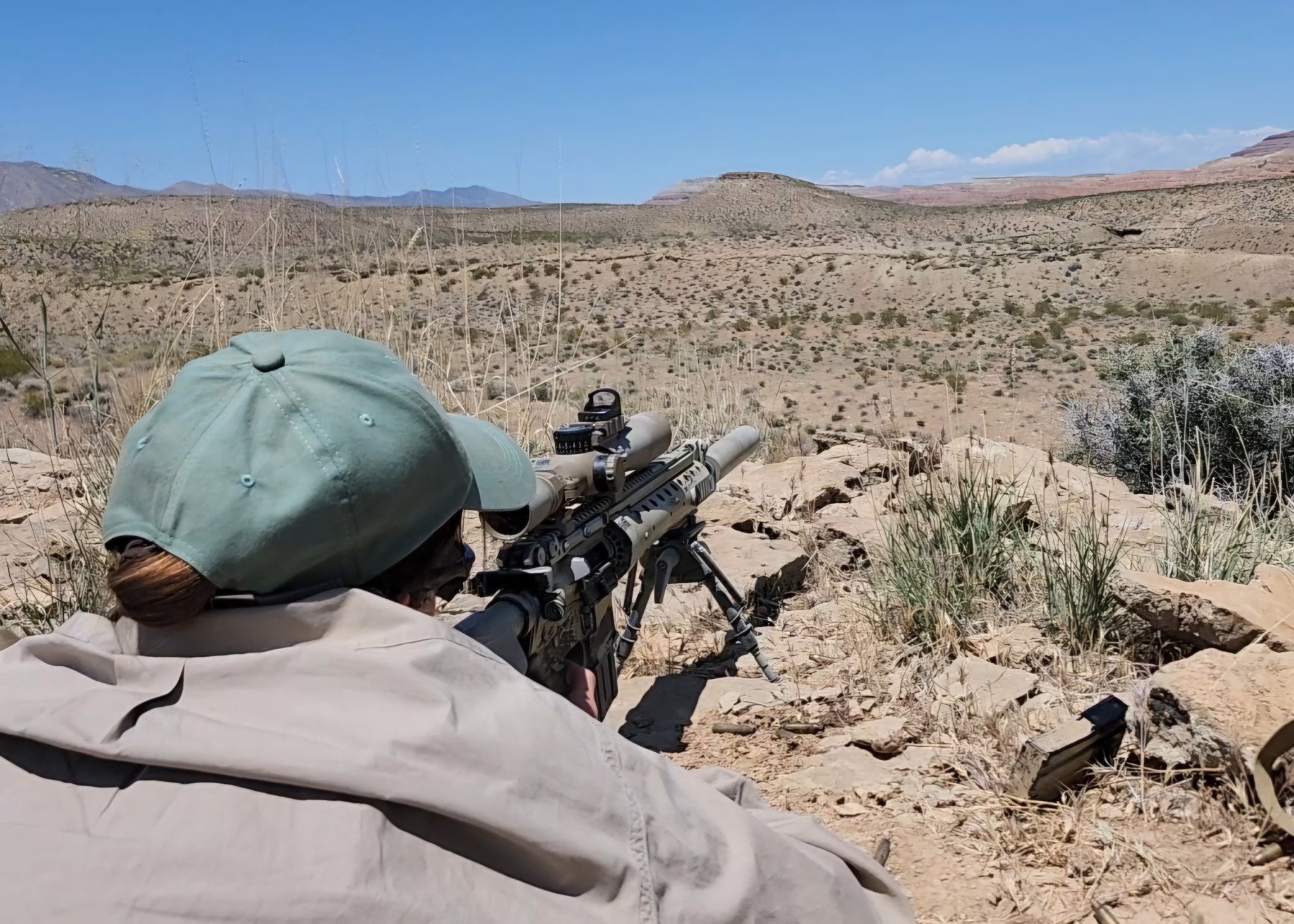

The Polish 🇵🇱 Princess doing Mod 0 activities with @TheGerman and @GumbyActual
She did incredibly well for her first time doing long distance things. 50% IPSC at 530m. She went 3/5 with 2 mil wind hold.

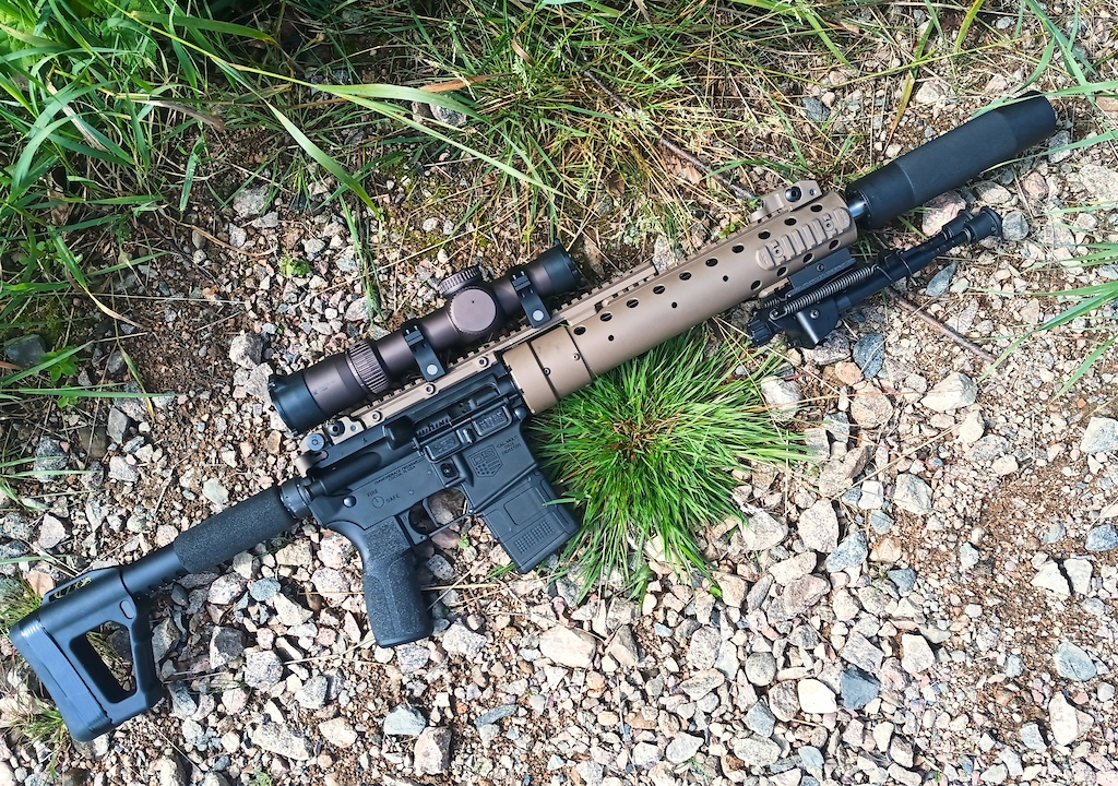

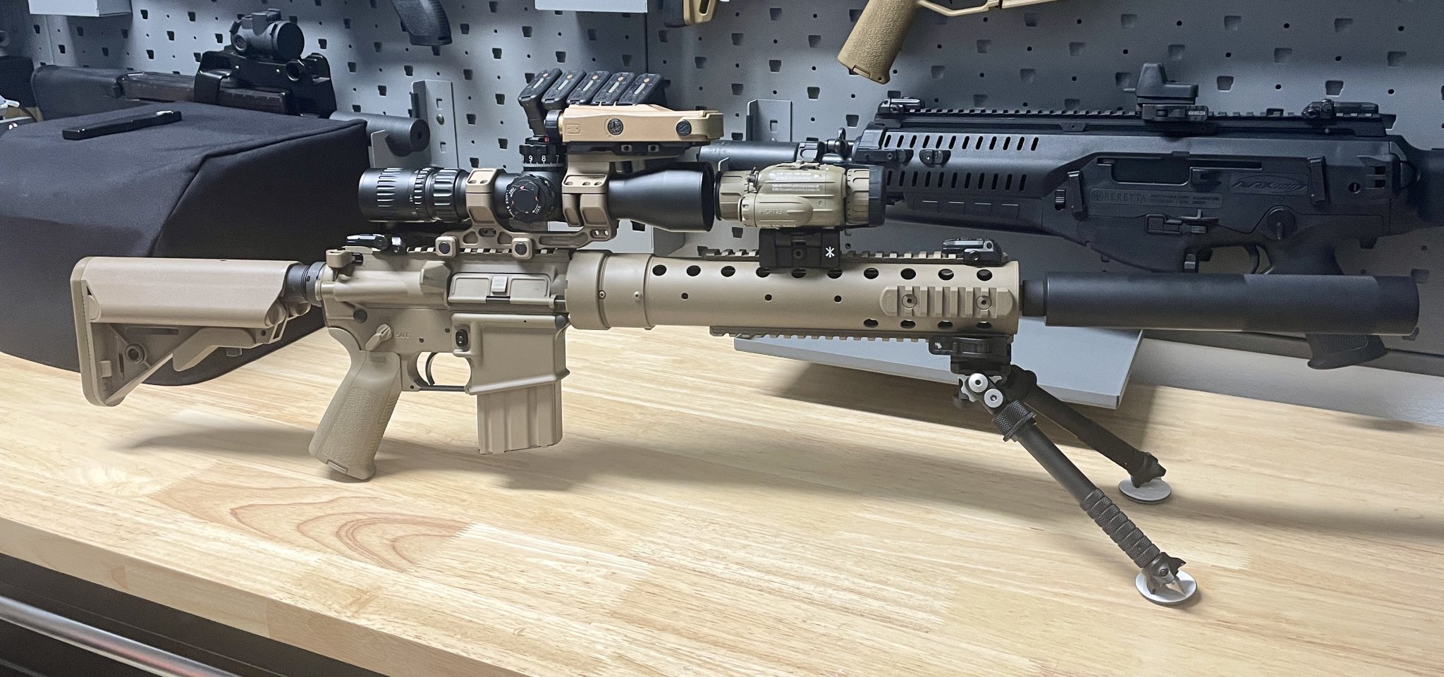

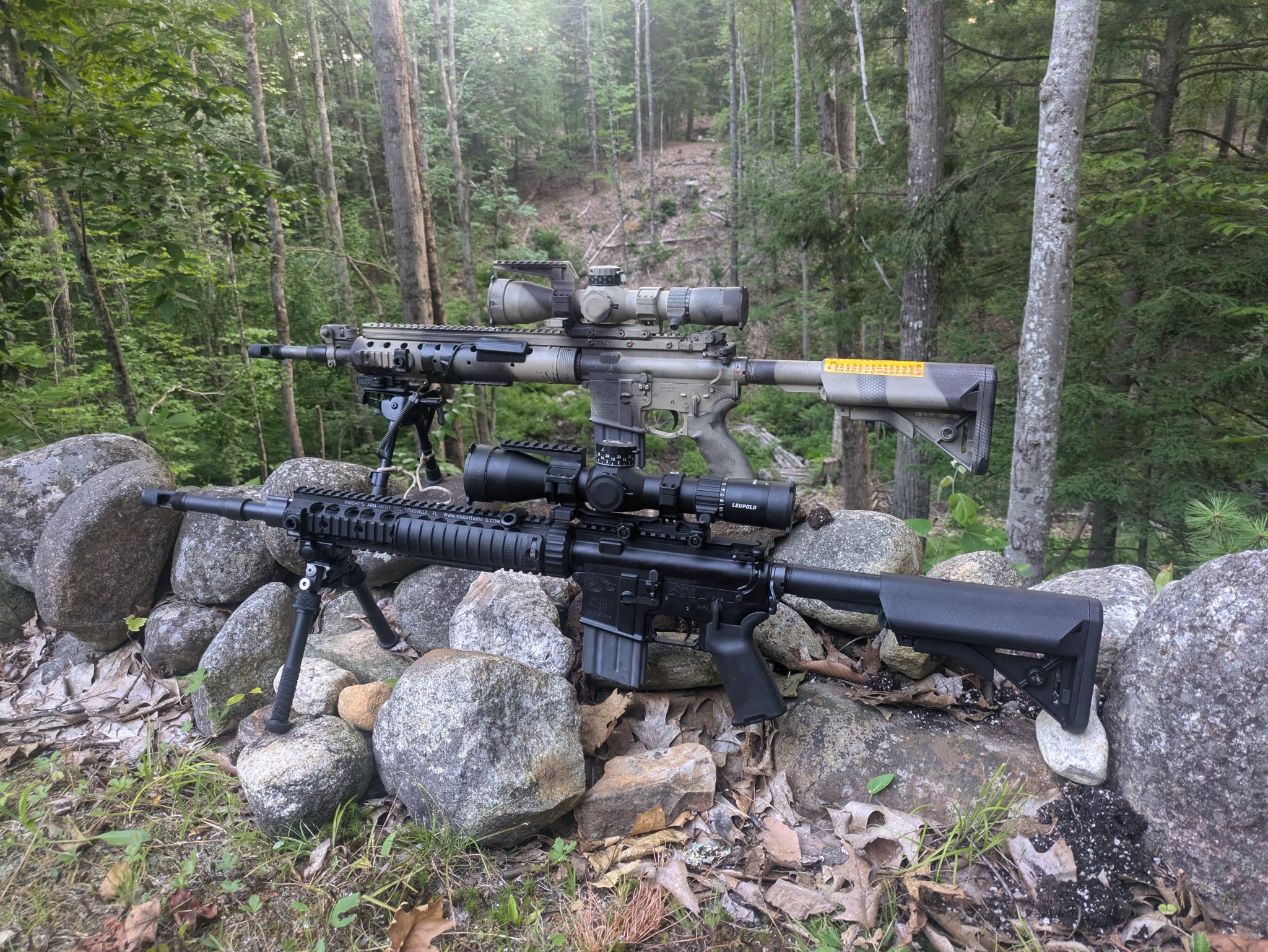

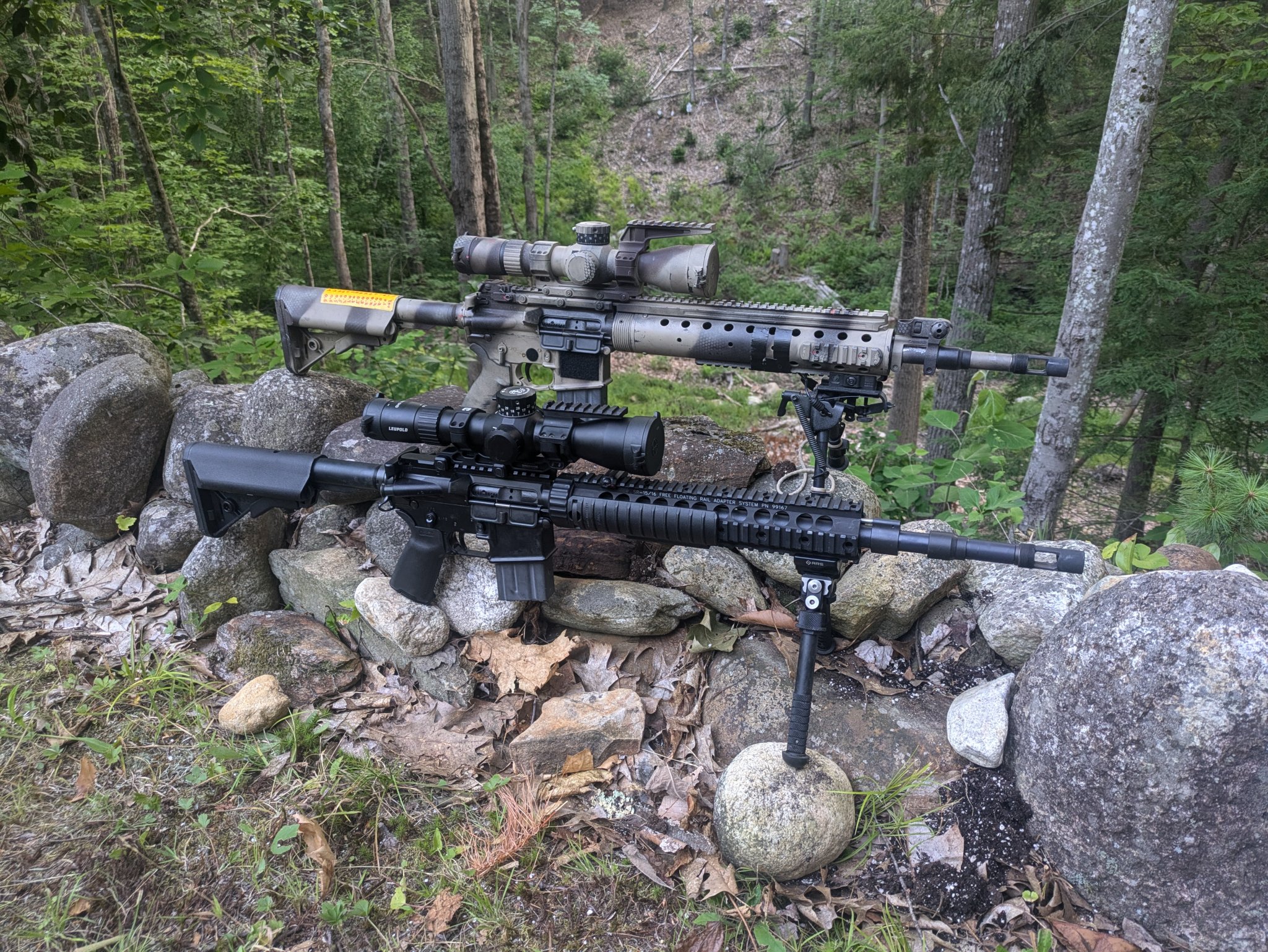

Love the rifle, could you please detail the optic combinations and mounts that you chose for it?
March 1.5-15 Dual Focal Plane shuriken turrets
Badger Condition One mount, 1.5” height
Badger Condition One accessory ring cap
Badger Condition One Impact Rail (I started with the CLIF rail that they make for all diving board optics but the rangefinder was stupid high and goofy looking. The Impact Rail is specifically made for the very tall Vortex Impact 4000 rangefinders to sit lower but I found it fits the MRF perfectly, as long as you aren’t using it with tall clip-on night optics)
Wilcox MRF-Xe WMLRF
Pixels on Target VooDoo-S thermal clip-on, in a Unity Tactical CTM mount

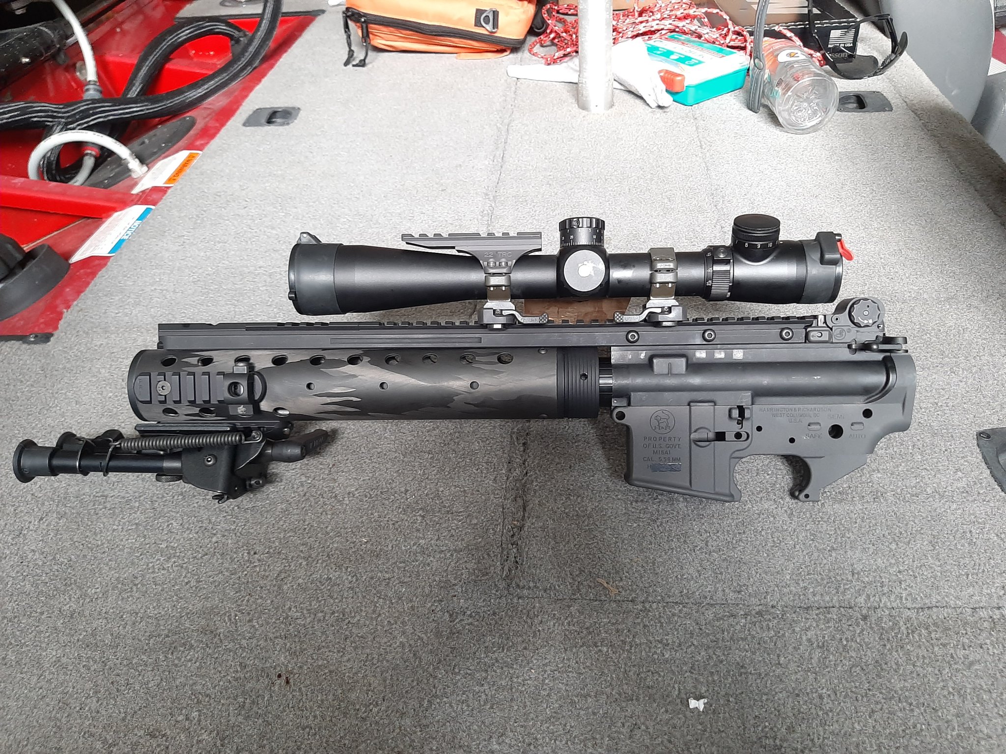

Getting there. Still have to make my barrel but have the brake/collar, trigger, lpk and NOS Allen suppressor waiting. Hopefully the can clears soon, it's on a trust.

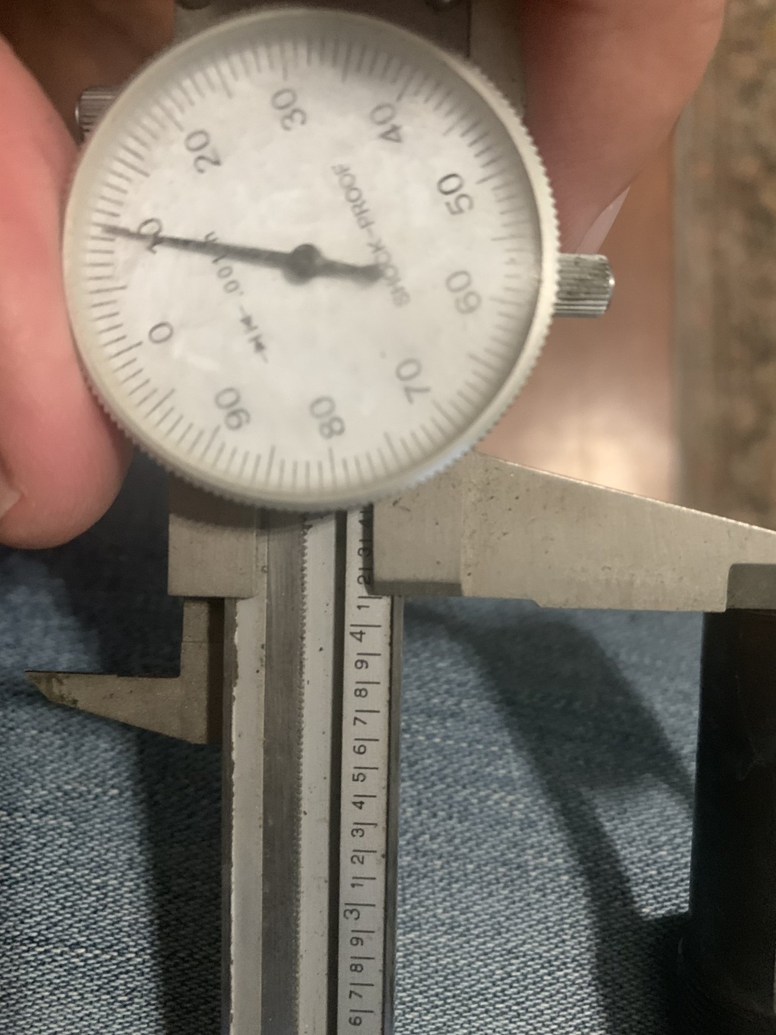

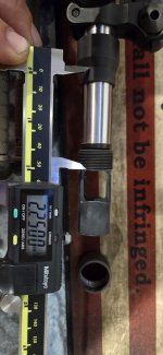

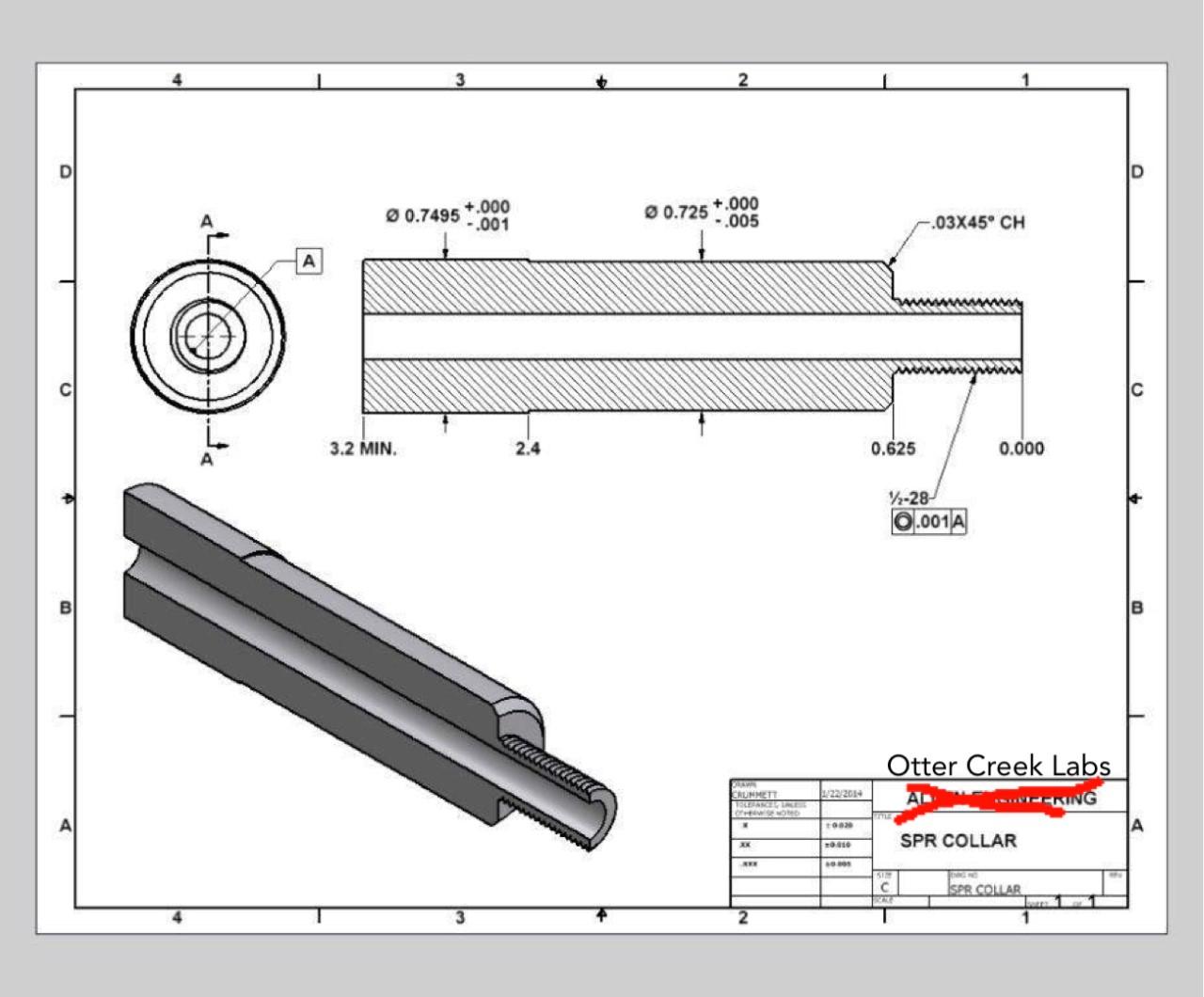

Ok. Been trying to figure this barrel out. I have a WOA spr barrel to work off of but I need this clarified.
Allen states 2.5" minimum from end of the muzzle to the start of the taper. When my brake and collar are on the WOA barrel I get 2.25". Is the measurement truely from the barrel crown or from the tip of the mounted muzzle brake? I can't imaging where I could make up the other 1/4" unless I lengthen the barrel dimension to 18.25".

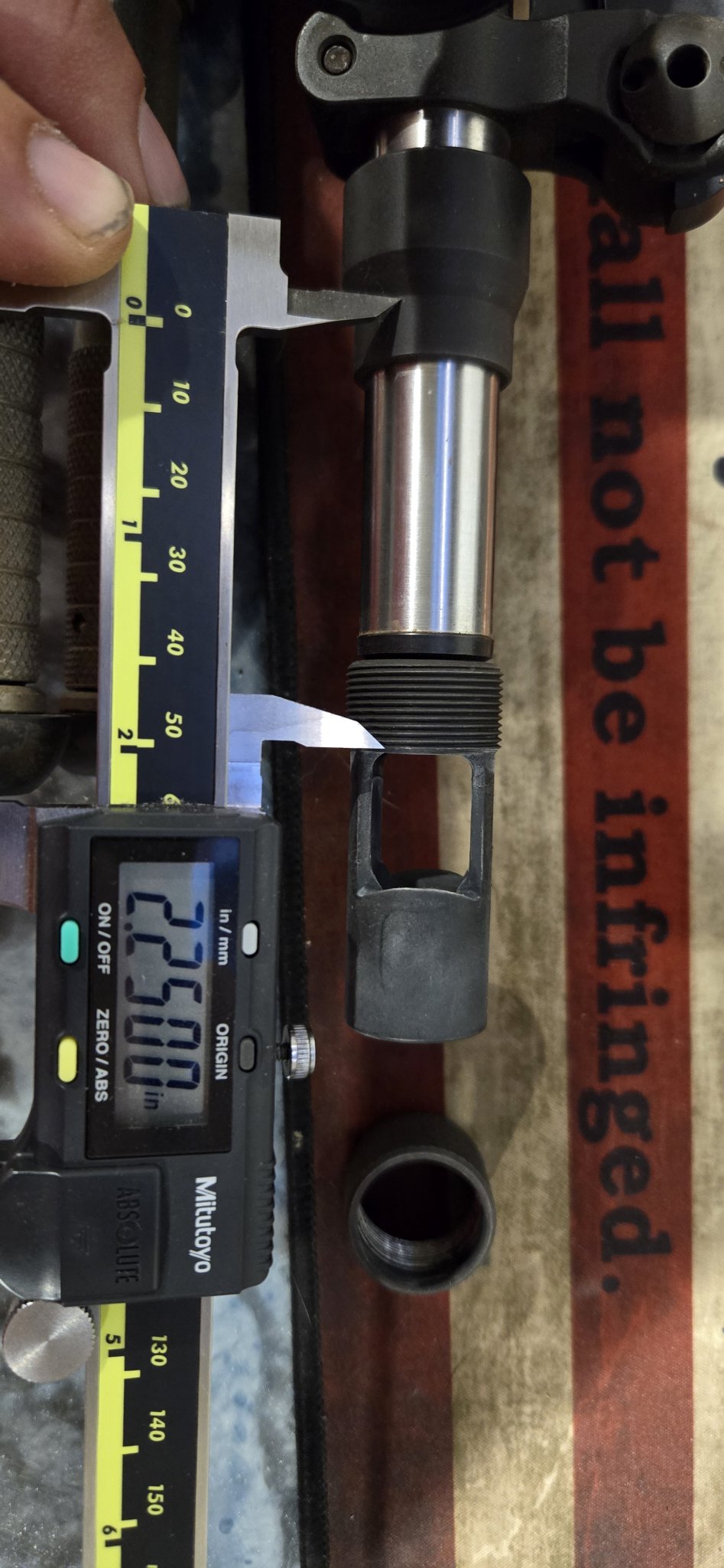

Here is a print from otter creek labs, looks like they used Allen engineerings' print and just scratched out the name.
Second Pic is a measurement from my rifle with a WOA barrel. I get full thread engagement with my OCM5, so it's good to go
Kind of answers my question but now I have more questions lol.
When my gas block is mounted I need to ram my collar practically against the gas block to get that 2.25". Are you running a short collar to have that gap between the back of your collar and front of your gb?
Either way looks like 2.25" will be fine.
It's been like 12 years since I built my mod0, but I do remember there being 2 collars. This is just a guess right now, but I think the long collar was for the mod1 with the smaller gas block.
Just make sure that your collar is hitting the step in the barrel before the gas block.
This is normal. Most of us don’t use the spacer, and use peal washers. This, as well as he original print, only get you 2-3 turns. I spoke to Ron about this years before 7 turns was common knowledge. We cut the barrel for the collar a bit deeper, but you could use the spacer (not crush washer).
Found this, seems like it doesn't matter which one you have and the clone correct looks like the long collar
If you're cutting them deeper, will the long collar still work on mod0?
I get the 7 turns, I just used a crush washer. Are you saying not to use a crush washer? I get that for normal suppressor mounts, but since this one lines up on the collar I thought it was okie dokie.
@lonestar1845
If you use the crush washer or the spacer (looks like a black crush washer but is flat) you are likely to be fine with the standard cut barrel from the print.
If you use peel washers to keep the tension off the threads and help milk out the accuracy, you’re going to have to cut the shoulder for the collar back to get 7+ turns. How far, I’m not sure.

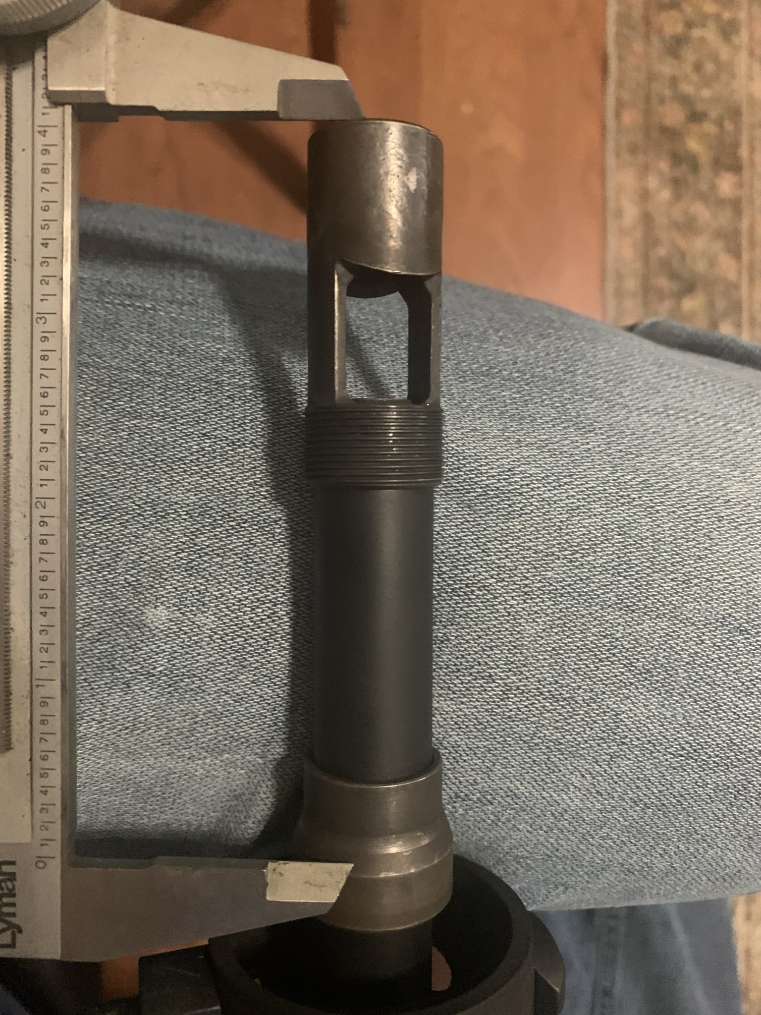

This Mod H has peal washers. Here is the distance from the end of the brake to the middle of the collar. 4.110” get me 7.5 turns on an old AEM5, pre-knurled.
@lonestar1845
If you use the crush washer or the spacer (looks like a black crush washer but is flat, you are likely to be fine with the standard cut barrel from the print.

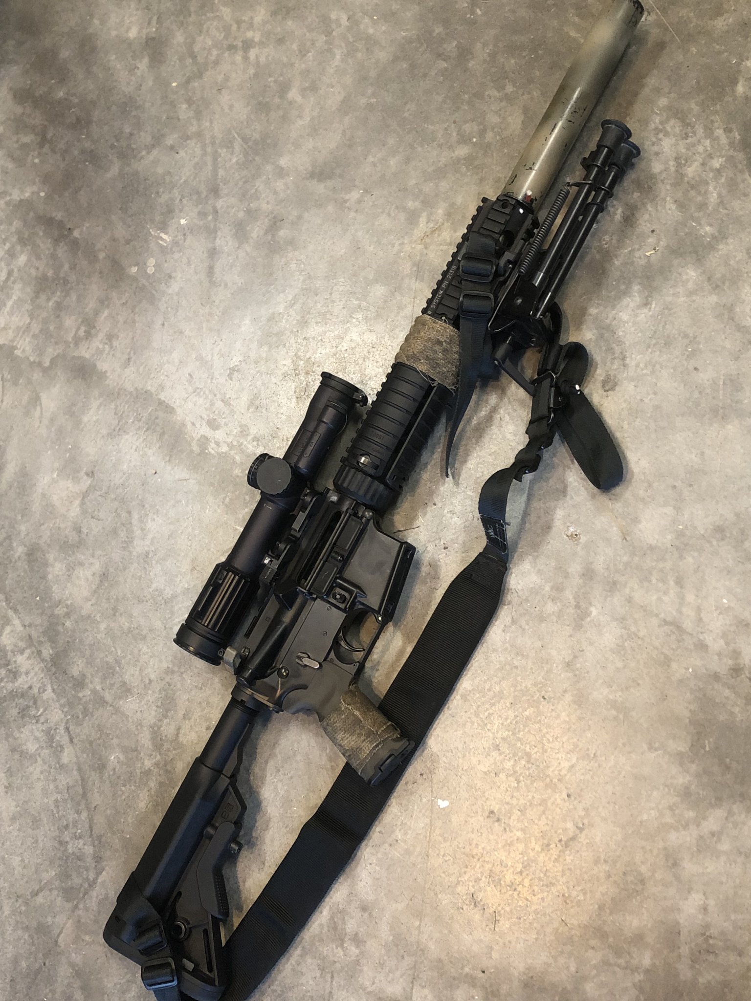

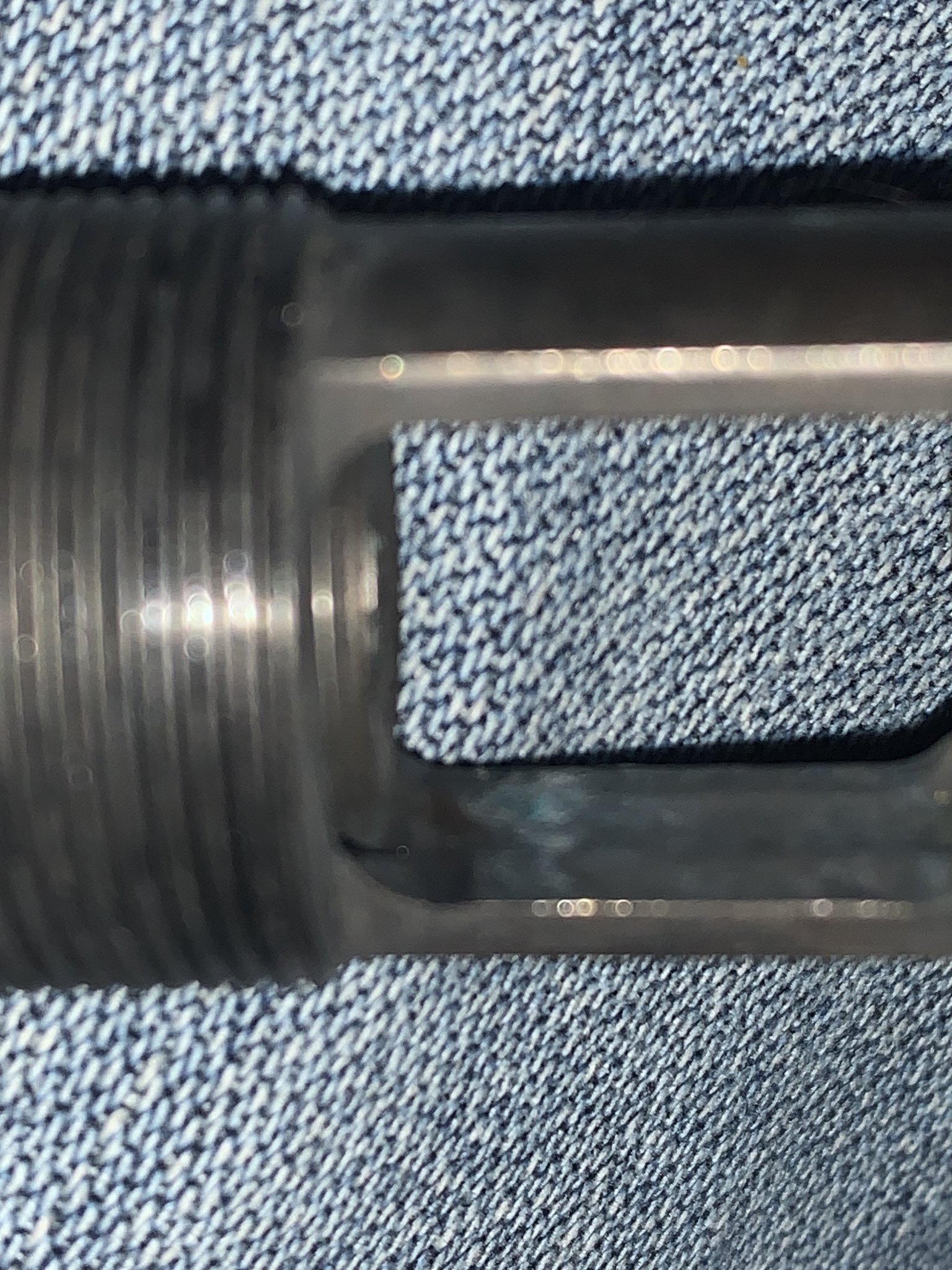

Something else this does is exposes the crown for cleaning and helps keep the caked on carbon from building up. Hard to see as it’s dirty, but the crown is exposed by 1 thread.
Reactions: FUNCTIONAL
Like i said I'm making my own barrel and that's exactly how I threaded mine. In fact that's how I do all my brakes on all my rifles. It doesn't build up on the crown like it does then it's recessed also.

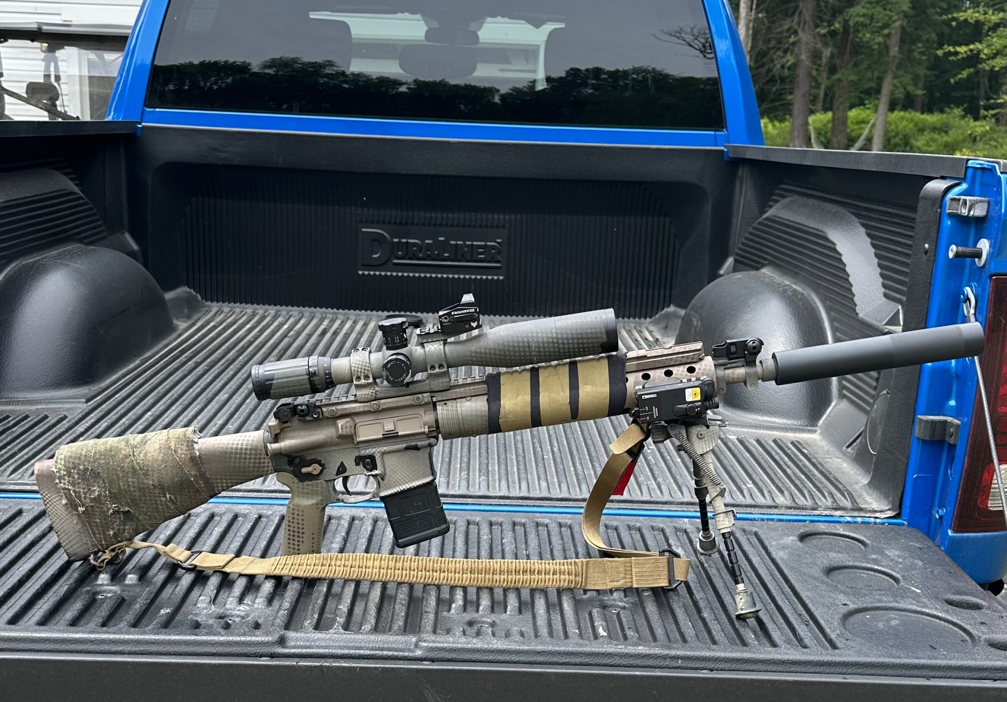

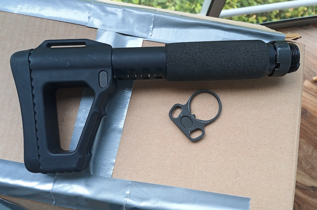

My Mock 12 mod H is pretty much finished. I fitted the ACE Socom stock a few days ago. Had to make a 15 mm spacer for it to be long enough. Very happy with this rifle, even if it is not clone correkt. It is however almost as close as I can get it here in Sweden.
