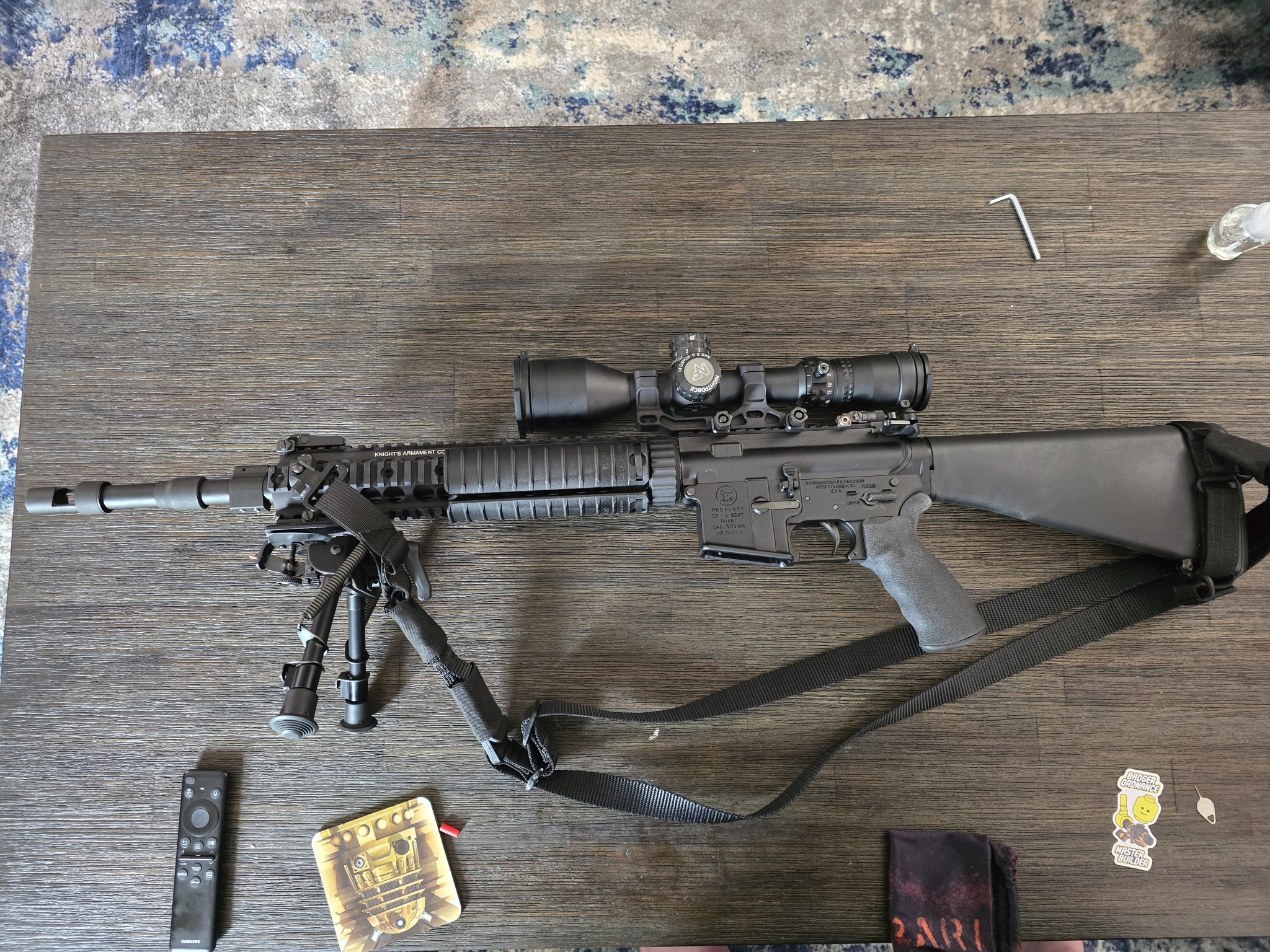

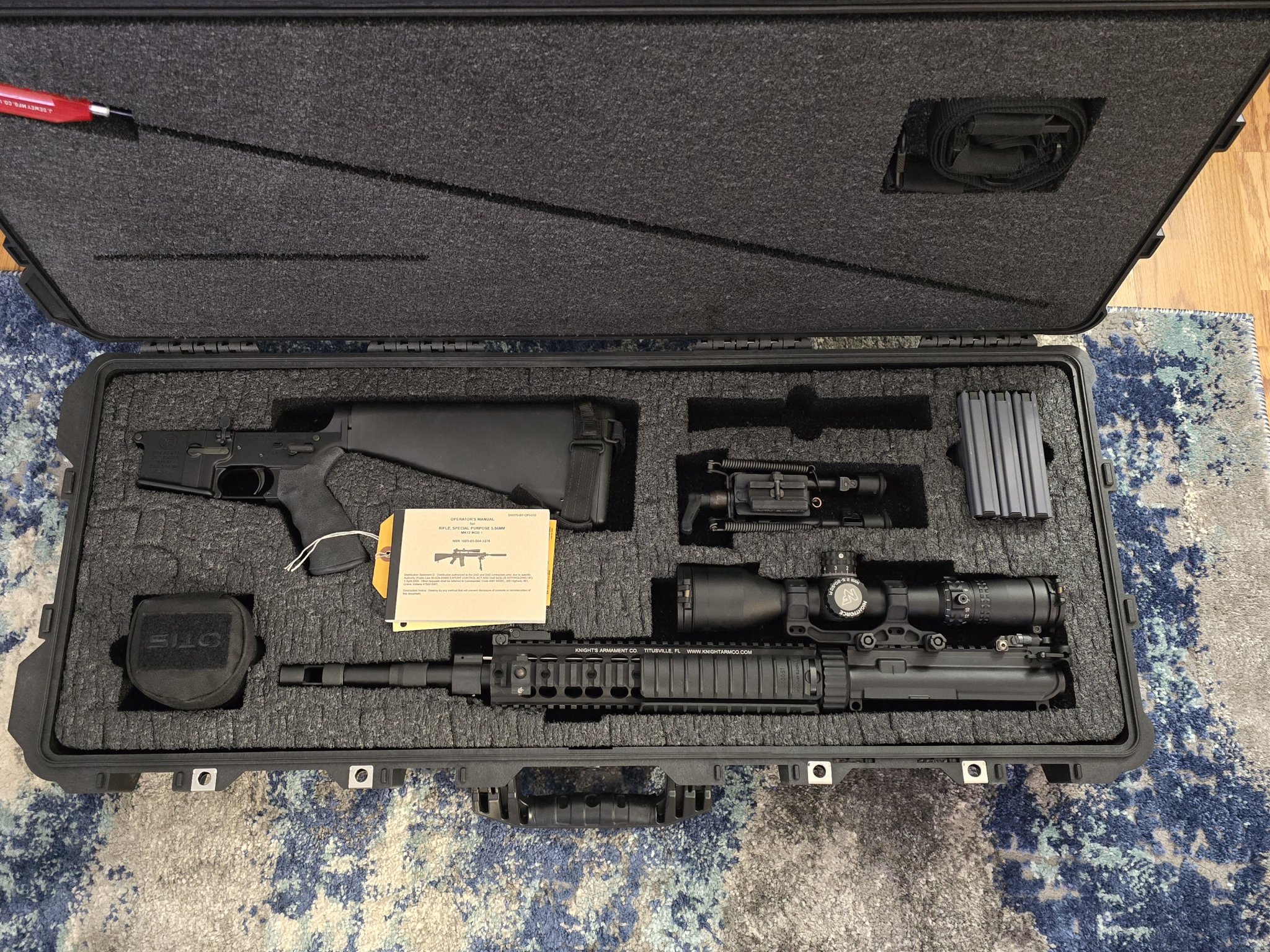

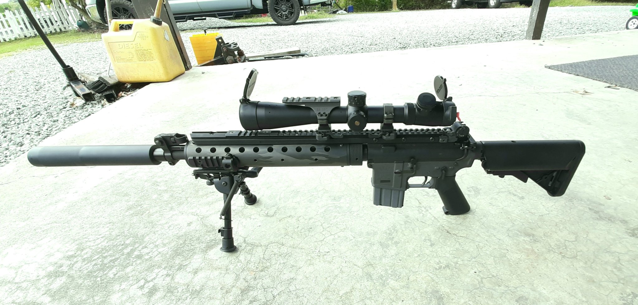

Suppose it's time to post my rifle I finished about a week or so.
Lower
H&r m16a1 lower in black.
Ssa-e trigger
Ergo grip
Schmid ambi selector
Brownells 20 round mags
Upper
Colt upper
Douglas 18" barrel
New kac mk12 rail
Kac bipod mount
Kac sling swivel
Long collar mk 12 w/ mk 12 muzzle device
Kac black frint sights
Kac micro rear sight
Gasbuster mil latch
Nightforce nx8 2.5-20 on a condition 1 mount.
Tas-1 sling
Manual and cartridge book
Pelican 1700 w/ cut foam by cobra.

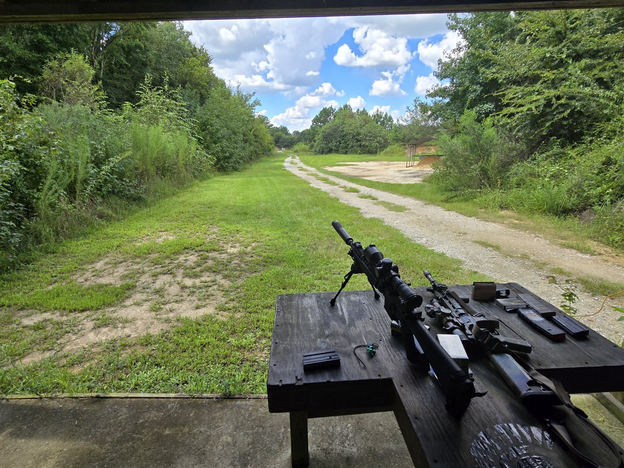

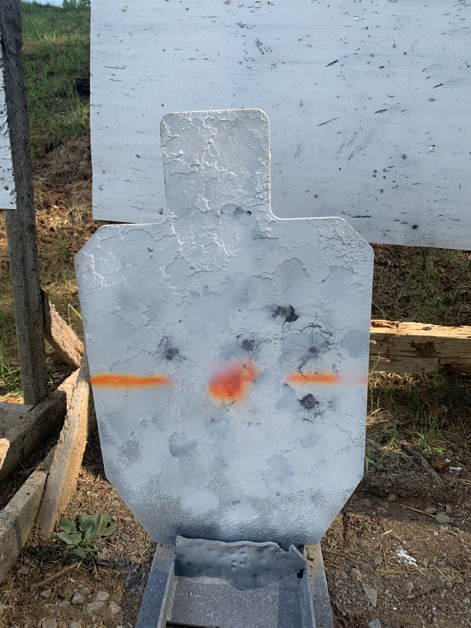

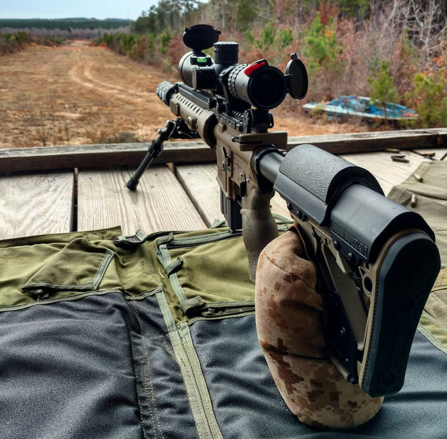

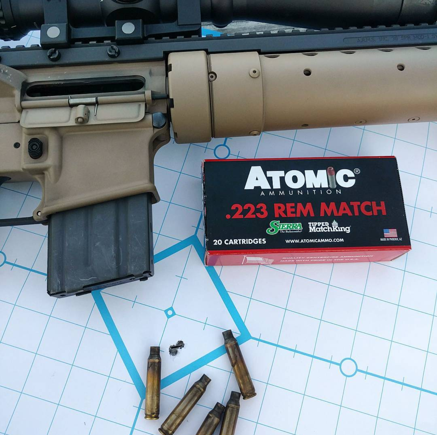

Took my Son In Laws ModH out yesterday. I pulled the 2.5-10x24 NXS as it has some binding in the mag adjustment and it’ll need to go back for service. In the meantime, put a NX81-8 with FC-DMC in a Reptillia mount. Looks crazy out of place but it’s a nice unit so far.

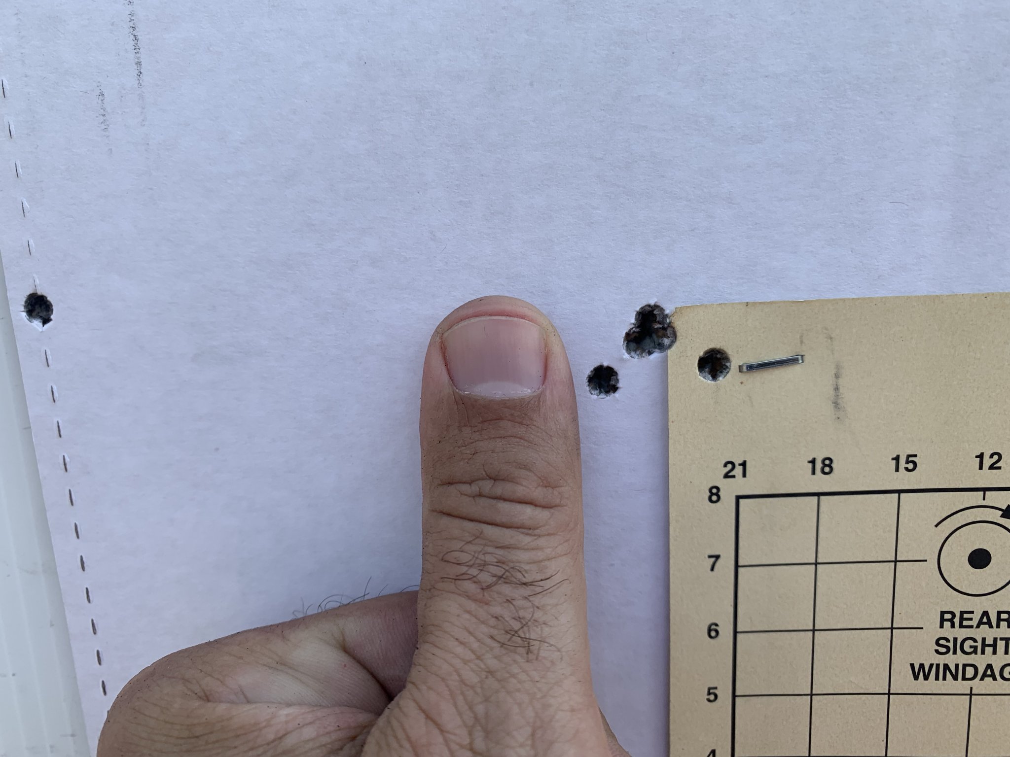

Got a rough zero at 100 and then shot one group to see if the load was working in this rifle.
.91 outside to outside, a hair under .7 center to center. Not bad with an 8x fixed parallax off a Harris and a shmedium out back . Confirmed come ups to 600 yards.
Looks like this load is a touch faster than 2600. About 5 MILs to 600. A little wind and it was 95 with humidity, but for less than 75 rounds down the tube I’m happy with this rifle.
This will probably wear a Mk5 HD 3-18 when he gets it.

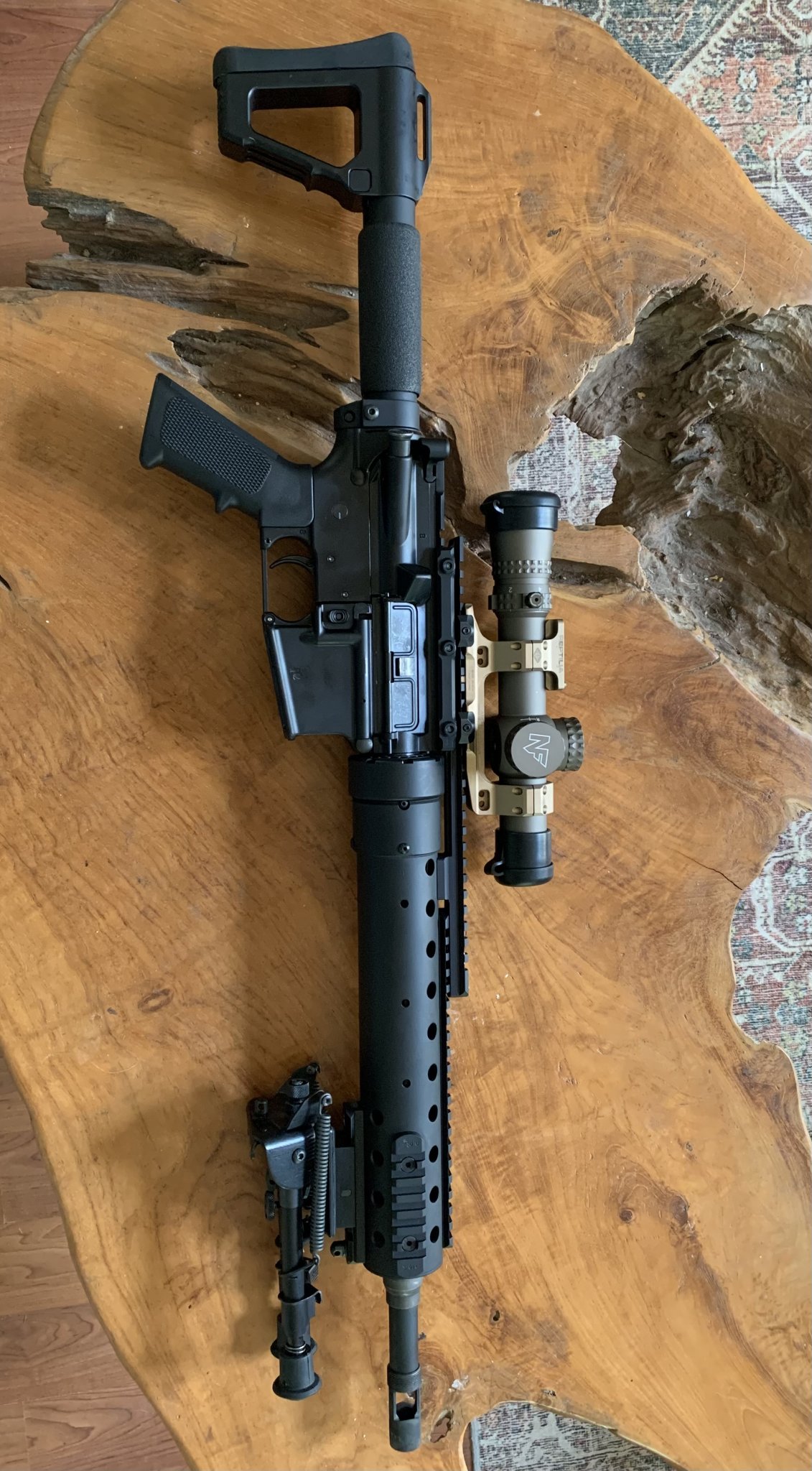

Got the lpk all installed. Went with a h&r m16a1 lpk since it was near impossible to find an A1 grip in stock separately. Trigger is geissele SSA-E. Popped on the mid rings also.
Need a new sopmod stock, I painted the one I have and krylon is not coming off as cleanly as I hoped. Also need a gasbuster. I bought a fde one because I'm stupid.
Was going to make my own barrel but I'm really tempted to just push the way button and get a Douglas. The last one I had on my mods was no joke 1/3-1/2moa with 77 handloads.
My silencer guy also just happened to have an old NOS aem5 from when Ron made them. Said he bought it for himself and just never built the gun and let it go for me. Been waiting about 1.5 months so far on a trust 🤞

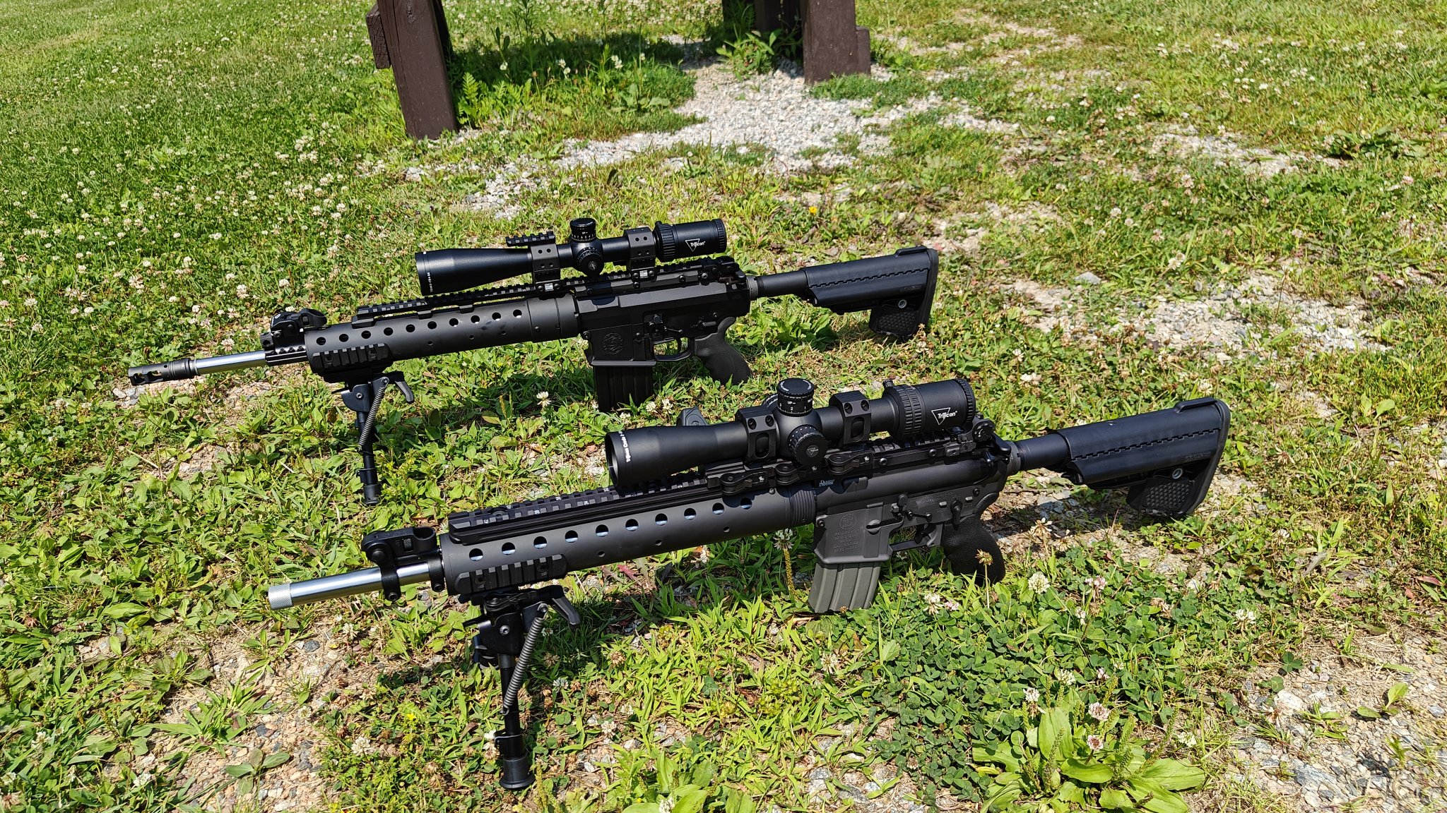

I enjoyed the show, and it’s going to be even harder to decide if my next will be a Mod1 or a RECCE. After shooting the ModH side by side with the Mod0, I may take the MV hit. Might even get fucking crazy and go with an AEM2/4 to keep the form factor and further shorten it. Even if I go AEM5 it would have at least a mid-length, if not intermediate gas system because why not? As long as the gas block is hidden, fuck it. (Triggering cloners before 7AM ;) )

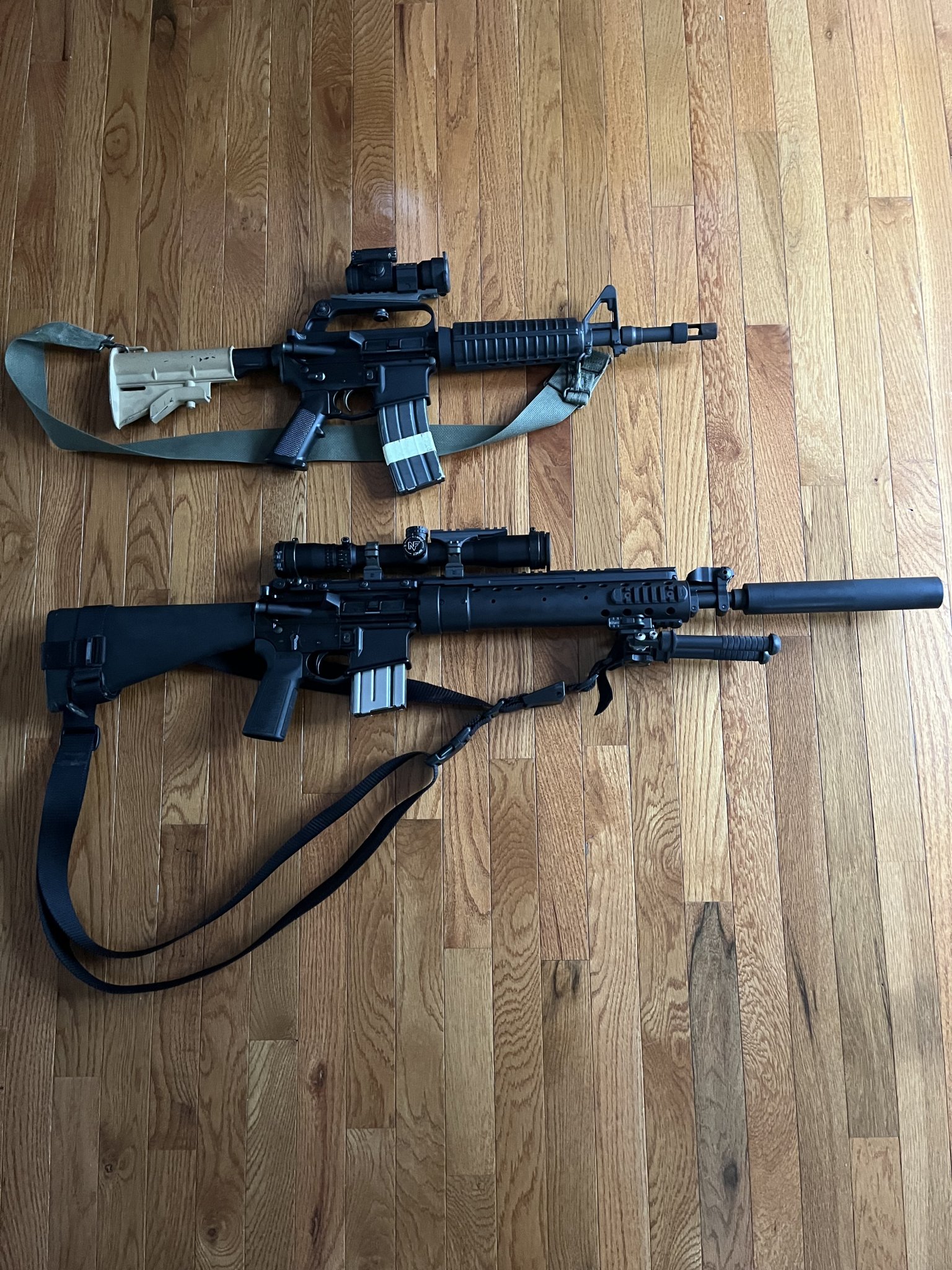

Welp got the atf approval today for my AEM can. Only 1.5 months (submitted mid july) on a trust so I'm way ahead of where I thought I'd be. I decided since it cleared so quick and I have yet to build my barrel I bit the bullet and ordered a Douglas barrel from pri with a 1/8 twist and a proper gas buster. Also picked up a sopmod stock for about $65 while sales are going on.
Figure 2 weeks I'll have my first shots on this "proper" mod 0!

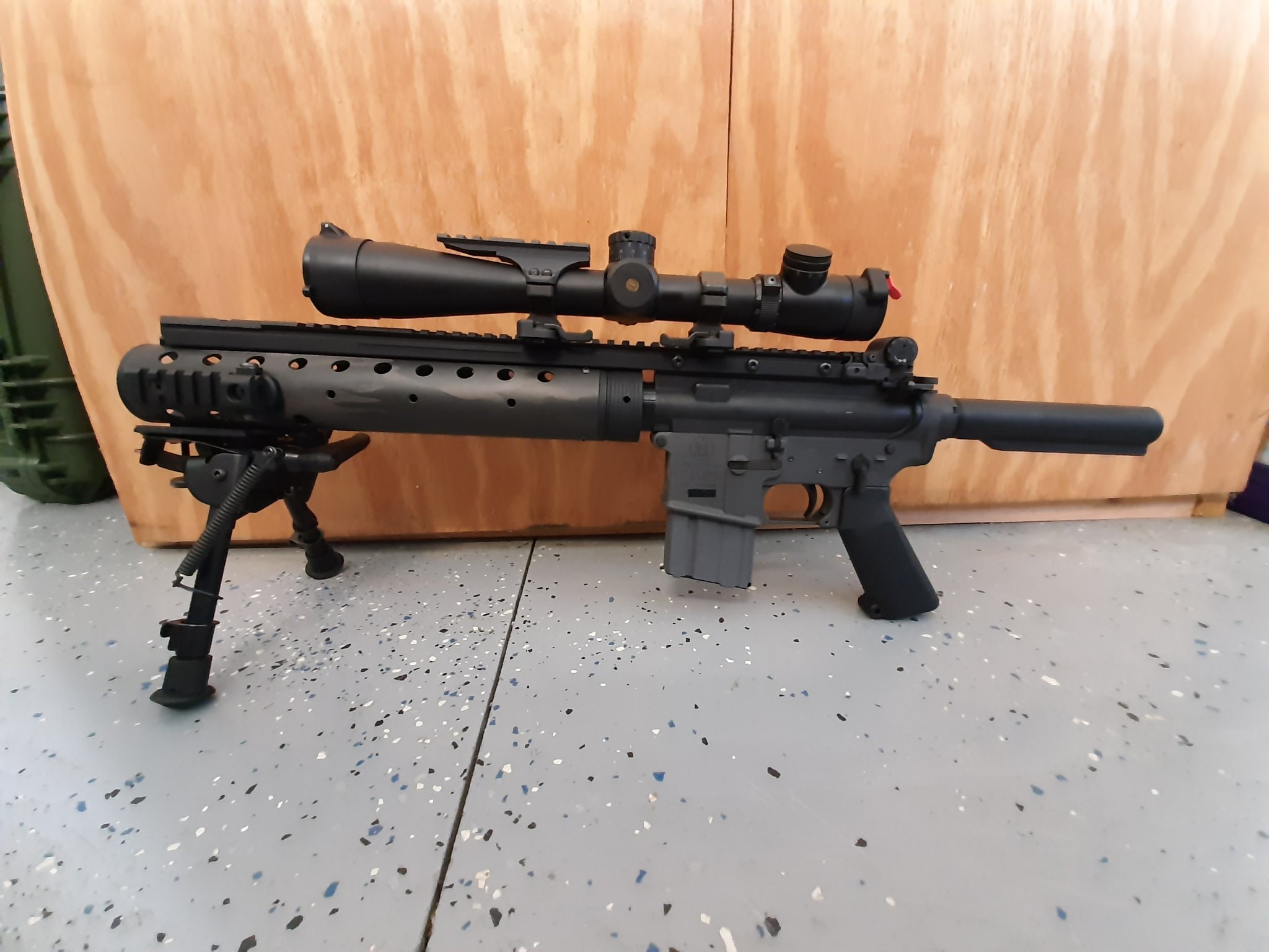

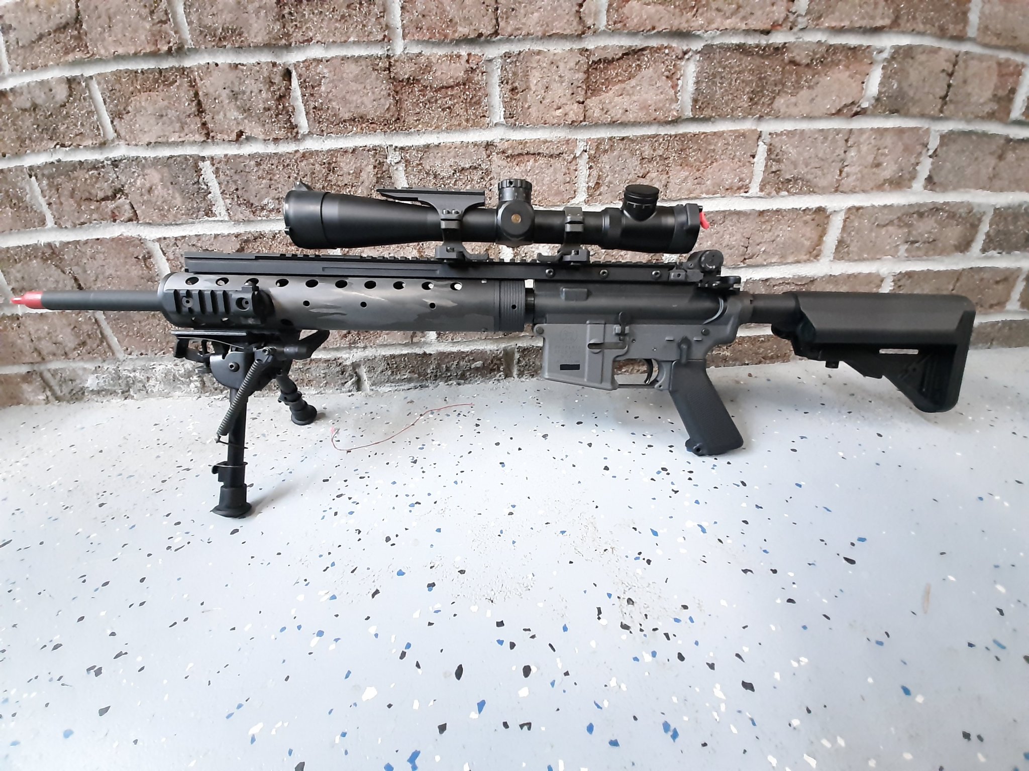

Wannabe SPR. Needs rattle-can:
Could have been assembled tonight but I was an idiot. Left my gas block, bcg, brake/collar at my parents thinking I wasn't going to buy a barrel. Left it there knowing I needed it to make my barrel so I wouldn't forget it.
Anyway, Douglas came in, gasbuster and socom stock. Should have her together and mated with her suppressor in 2 weeks.

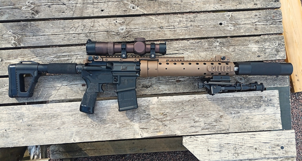

So this is it. The all out build.
It now has a WOA SPR 18" barrel, 1/7 twist. I know, mod H should have a 16" but I cant have one do to legislation.
The suppressor is the European version of the legendary Ops Inc AEM5. Made by Acheron and it is pretty damn amazing. Much more quiet than the flowthrough suppressor I had before, but as you can imagine, also a lot gassier than the flowthrough suppressor was.
I only ran 44 rounds through it today. Best group was 5 shot @ 100 meters, mearsuring 27mm C/C. I am sure it will only get better.

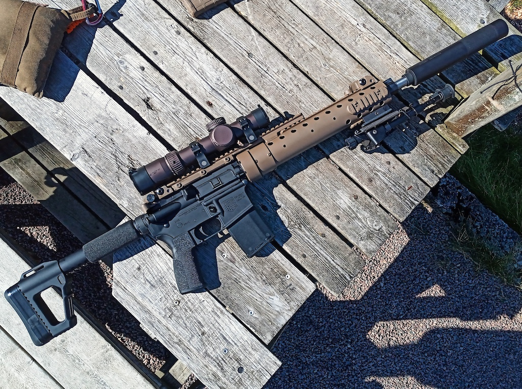

Ok! So back from another range trip.
Wanted to set a good zero with the matchammo I have the most of, which is Normas GTX 69 grain.
After some minor adjustments I collected a 20 round "group" from prone, it is really 2 5-shot groups and 1 10-shot group all shot at the same target from 100 meters, it measuers 67mm C/C (2.63").
I know, its weird and not really ideal as I broke position between each string of fire. But my POA and POI was pretty much spot on, and repeatable. And the barrel should have a few hundred rounds through it before its time to really try shooting bug holes anyways.
