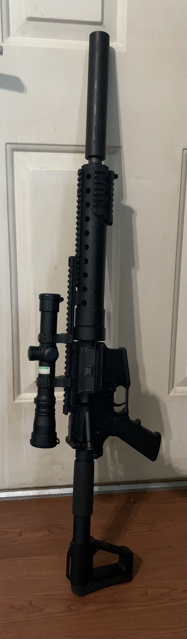

Yay rattle can.
This highlights one of the most important things about the SPRs that some of the original 1992-1994 JSOC Sniper Carbines had to use SIMRADs to achieve due to the presence of the Front Sight Base.
Most cloners don’t think about the emphasis on how the units using these things prefer to work at night.
In my last DM course, we were double-tapping targets at 700yds with 6x NV even with 5.56. I got bored doing it prone and went to kneeling just to show it could be done.
But I don’t get excited much about 5.56 in these types of set-ups.

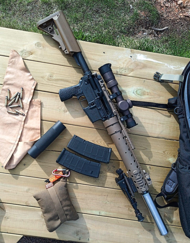

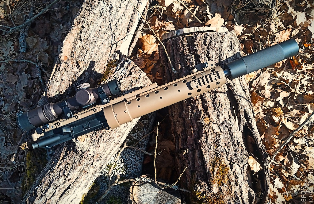

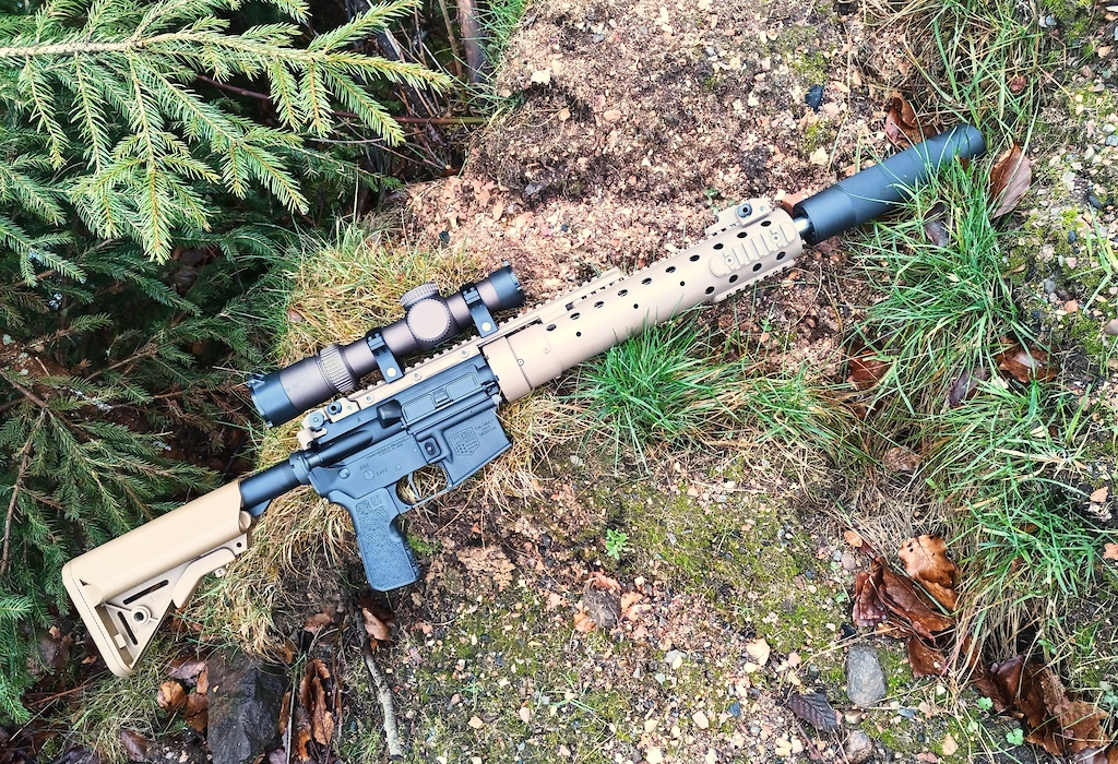

Ive been jonesing around for a Mk12 for years. And after the gunlaws in Sweden changed last year, I got started.
A few weeks ago a small white cardboard box from PRI showed up, I am pretty sure that it is the only one in Sweden.
In it, was the Mk12 mod H build kit and I was more than happy to get it. Rebuilt my upper and this is the results. I guess its a "Mock 12" as I cant get it to be a true clone build. But I am happy non the less.
I kept my Razor G3 1-10x and the suppressor is a Swedish made Infitech IFTS which has a bit of the AEM styling as you can see, but it is a flowthrough suppressor and it works great.
I have a titanium prototype suppressor for it as well, and will get some photos of it tomorrow. As it is I am wating for the yellow DHL truck to swing by with my FDE Sopmod stock to complete the build.

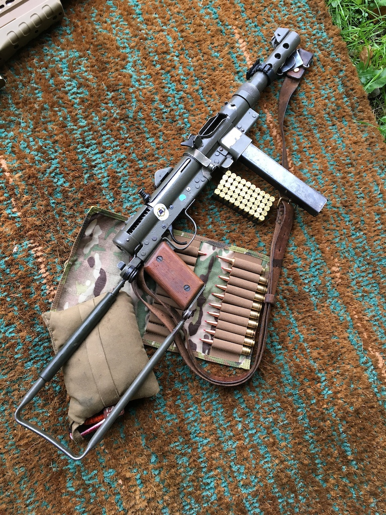

I guess its a douche move to mention Swedish K and not post a picture of one of the guns on the line today. So here goes:
Older picture but same "K". It belongs to my friend and it is pretty awesome in all its crudeness. Naturally it is full auto, they never made anything else. You can shot single shot if you have decent trigger control, and that is (usually) what we do when we shoot with them.
Older picture but same "K". It belongs to my friend and it is pretty awesome in all its crudeness. Naturally it is full auto, they never made anything else. You can shot single shot if you have decent trigger control, and that is what we do when we shoot with them.
Got to play with one recently. You forget just how much subguns feel like utilitarian farm implements once wartime production needs pared them down to their base elements. Then I held an Owen, and the K felt like a Rolls Royce..
Had to Google what an Owen was, and that thing looks pretty horrible.
The K has some pretty nice machinework, but they did not care too much about ergonomics.
Reactions: TonyTheTiger
Yeah seeing the Owen in person is even worse than pictures can convey. Yesterday we were shooting a PPS43 and a Suomi. Even the ugly sheet metal PPS looks good compared to an Owen. The Suomi is just on another level with its old school wood stocked and milled steel construction. The MP34 is easily the nicest SMG I've ever held.

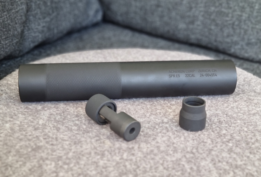

I could not refuse any longer. If one wants to go the whole nine yards, one needs an AEM suppressor, or at least a very well made copy.
So I had to get a Swiss made Acheron SPR E5, which mounts to the original PRI brake and collar system. So now I just have to turn down the front of my barrel a bit, to fit the collar. But thats not a big issue.
As there is not a lot of info about Acherons AEM5 style suppressor online, and no documentation at all in the box. I sent them an e-mail and got a very quick reply from the engineer behind it. He is also a big MK12 afficionado by the way. All that is written online is that the SPR E5 is like a AEM5 but with modern internals. I would say that they are a bit more than that. The Acheron is made of 1.4404 stainless steel and the baffles are made of 17-4 PH, it is fully welded and ceracoated. My guess is that is as close to indestructable as it can be.
And I do believe that the original AEM5 has an alloy main rube and stainless internals? Which really should be more than enough.
