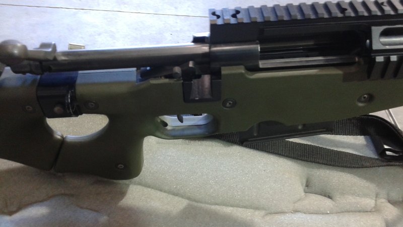

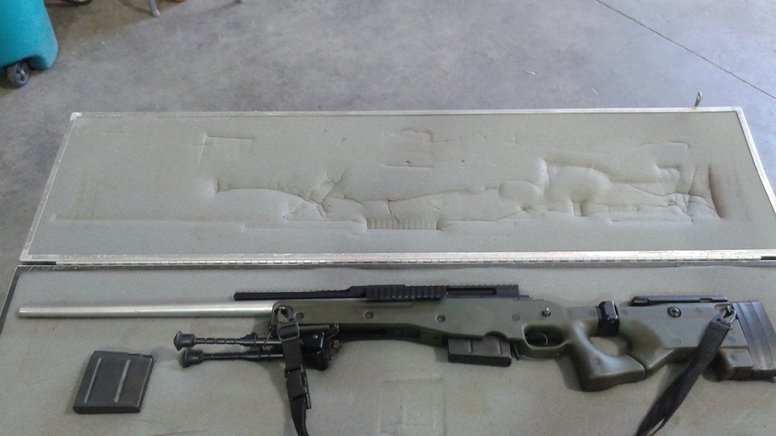

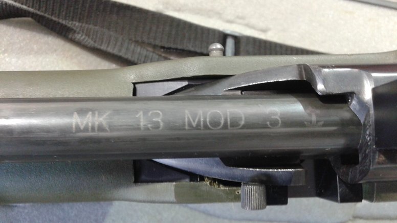

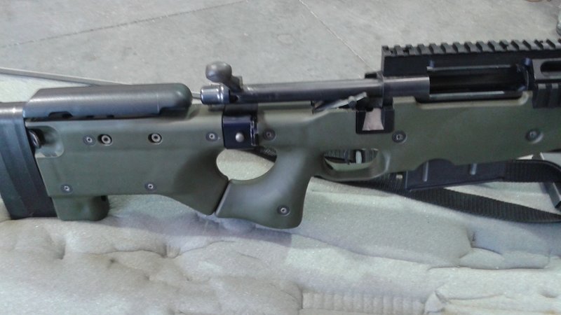

I acquired an MK 13 MOD 3 a few years back. There is not to much info on it on the web - All of my searches come up with info for the MOD 5 and MOD 7. Does anyone out there know anything about this rifle. It has an AI stock, McCann rail, Remington 721 receiver (which I thought was odd) and it is engraved with MK 13 MOD 3 with an anchor on the bolt.
The Mod 3 should also have the KAC MK11 suppressor. It would be the one that Chris Kyle used during his deployment to Ramadi. Its also weird that you have a 721 and not a 700. Do you or can you post a pic of your gun? This is what the gun should look like.
Thanks grunt0311 for responding... Here are a few photos

Green AICS in mod3? Odd. I assume the serial number on the Bolt matches the action?
that's a nice rifle. I know there are some oddballs out there. My buddy swears one of their early 300WMs was built off a Model7.
Unless I am mistaken, the Model 7 was always a short-action rifle. I don't think you could get a .300 WM into a Model 7 if you tried... Maybe a WSM....
But odd things do happen!
I can ask if they ever made any on Model 721's.... Even if, as a 721, it is a replica, it's a nice one! The Model 721's and, especially, its derivative the Model 725 were some beautiful rifles. Not that there is anything wrong with the 700. But if there ever was a 'pre-64' version of the 700.... the 725 would be it!

Maybe I misunderstood him. Or maybe his TBI was kicking in hard the day we were talking about it. He mentioned his early rifles had the Sako extractors because the bolts started out with standard size faces that were opened. He hated the Sako units, said they caused a lot of extractions issues due to brass hitting the rail. I think I sent you a pic of his mk13 on the floor of a team room with the rail hacked into pieces. That was the rifle that had a non-700 action I think. Looking at it, the barrel looks shorter than 26" too? He's told me over and over, lots of non-standard stuff came through them over the years. I wasn't there so I can't say with any certainty, but his word is good as gold to me. 'Cept when he's got a few liquor drinks in him and he starts talking huge amounts of shit.
I saw enough "not the usual" stuff from the SEAL side to know it wasn't always standard with them. They even seem to have their own versions of atomic sit-ups.
That said, the model 7 is a shorter version of the Rem 700 than the 700 SA. But, because you could get a magnum bolt face with them, they were popular as single shots in the target world. From which the SEALs drew heavily. Reason for this was the shorter = stiffer action mentality. Therefore, more accurate with less flex in the action. I haven't seen this done in at least ten years. Too many solid custom actions out there now.
As to the Rem 721, it's pretty much the same as a 700 LA. Some thought the quality was better. There is a little more "meat" in places, but most everything crosses right over. It wouldn't surprise me if a SEAL, back in the day, felt he was going one better and had his rifle built up on a 721.
A good one to ask is AJ Brown, if he saw stuff out of the norm. As stated in a previous post sirhr, you are remiss in not asking him all 100,000 questions we asked you to ask him. So, we at least need a report back on some of them.;):cool:
Another thought on this is look how little is said about post '63 Winchester 70's. Hathcock's tribute was a post '63. He mostly used a pre-'64. It's almost like the military doesn't distinguish between them. If a SEAL were to have his rifle built up on a 721, it would end back up in a classified arms room. Then get released out somewhere 20-30 yrs. later and taken apart as it was 'not right'. ...it never really existed then.
Added: While the 725's were nice they were nothing more than Rem 721 BDL's and 722 Deluxe's. Very nice in comparison, but nowhere near as good as the Remington 720's!! Those were a pinnacle the best Winchester 70's had a hard time matching. The Navy, with no business to do so, came in and scarfed them all up. After the war, seeing they didn't interchange with anything militarily, started handing them out for shooting trophies.
Actually, Sand, I did ask about the variants and 'oddballs' and the answer I got was that far less of this went on than we might think. Crane made things to a 'spec. And though they did make some modifications over time (Sako extractor being one... and not a popular one), less stuff was done in 'the teams' than legend suggests. Not that they couldn't do things themselves at times, but tinkering with their weapons was a far lower priority than training evolutions, deployments, etc.
A phrase that stood out above was "Maybe a Seal had a rifle built on a Model 721...." Well, maybe. It's a diverse community. He could have done himself. He could have had a local 'smith do it for him. They were regular visitors at Crane... so could a guy have brought an action or rifle and said 'can you do this.... for this reason???' Honestly I don't know. So this is just an extrapolation from the statement by Alan that there was a lot less modification in the field than often assumed. Mostly, they ran what they were issued and personalization was limited to taping on cheek pads and painting. Even buying 'off the shelf' scopes was not as common as I had previously believed.
Similar would probably apply to the Model 7... If someone had a very specific reason for a single shot... and it was the best action? Well, necessity is the mother of invention.
One thing that I have learned over the years when it comes to guns is 'never say never... and never say always.' Because everyone had a custom shop of some kind. And once things got 'into the fleet' who knows? A fresh new Boot Marine who modified his AR at LeJeune would probably be skinned.... a SO/LIC operator with a decade of operational experience likely got a bit more lattitude... especially on deployment. So who knows? And strange things happen in strange communities. Heck, Welrods are still in use in certain places...

Rifle looks good but its not a Mod 3. Its actually a Mod 2. Look at my posts from above an you can see more pics. Change out the MIRS rail for a MARS rail and put on a Nightforce. The Mod 2 was issued to Army Rangers not NSW.
The guy that I got if from is ex-CIA... Who knows what arsonal cache it originated from??? Also. this rifle has a trigger a butterfly could set off, is that standard for our boys to modify to their liking???
I think his name was Diamond Jim;). Wait, I now have to remain incognito:cool:...:eek: it's twoo, it's twoo!
