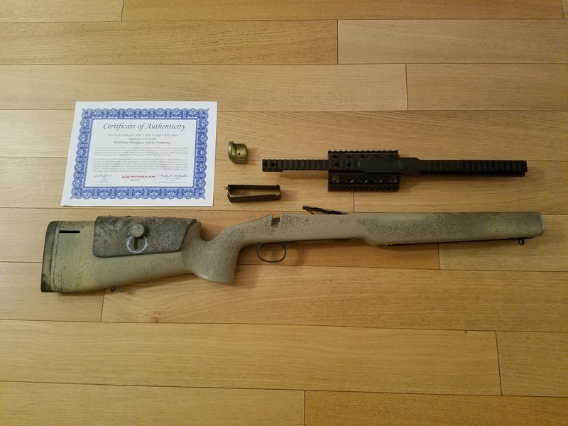

Just dropped an original Mk13 stock in the accessories section of the PX

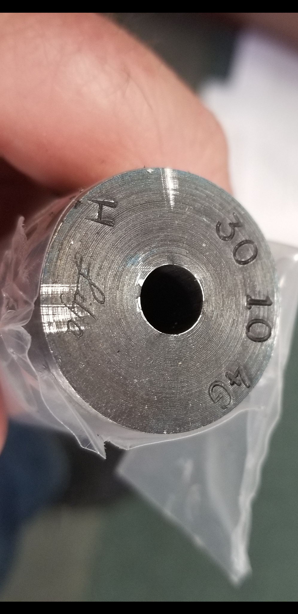

My Lilja barrel came in yesterday... it was the last piece that I needed.

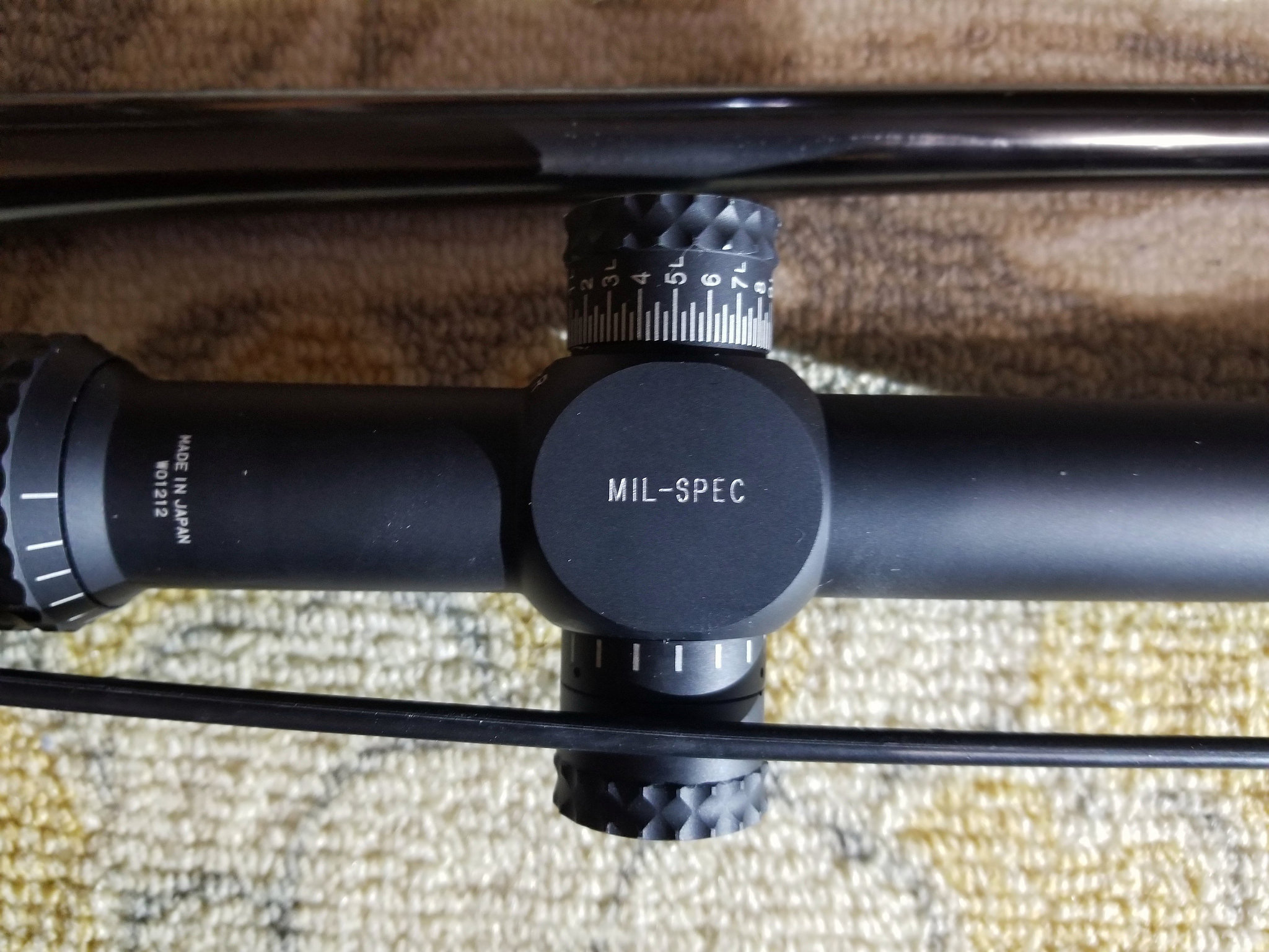

I've decided that I will use the 5.5-22x56
Mil-Spec scope. I will use the mk4 10 M1 on something else.

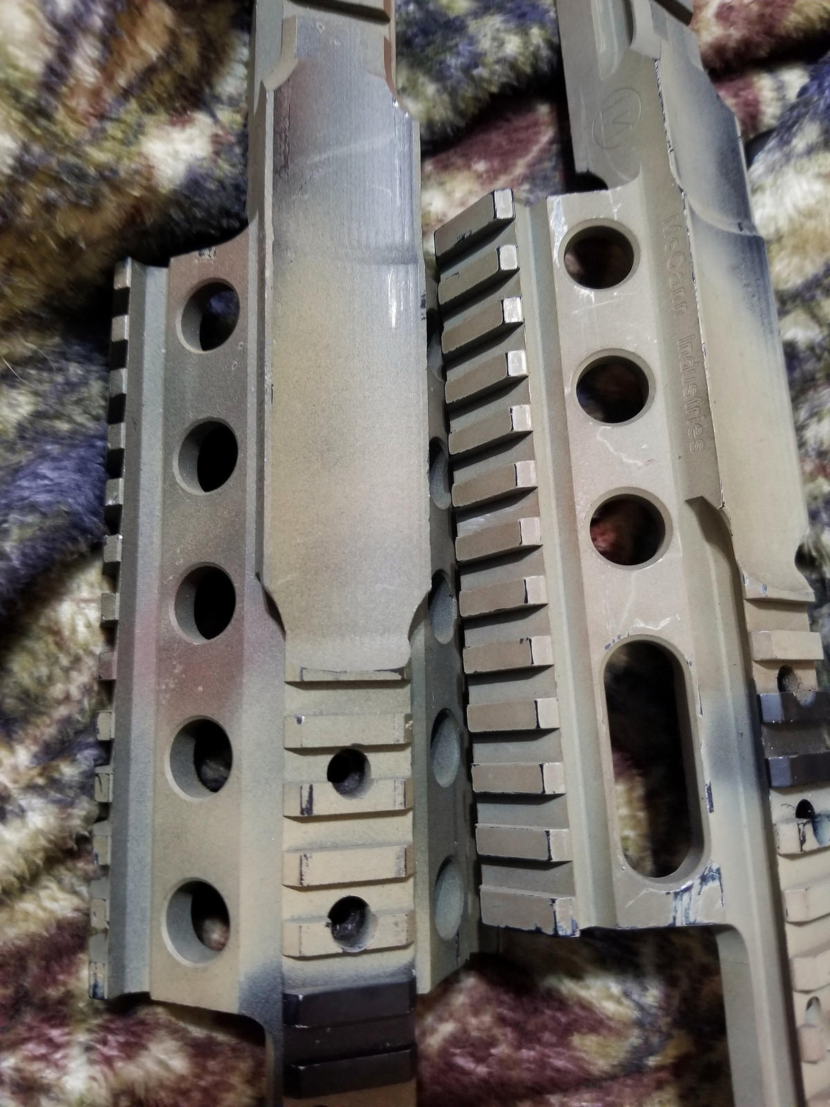

I've notice that of the two MIRS that I have, one has a serial number slot whereas the other has a smaller hole. I will use the one with the larger hole. Neither are stamped RevB/20moa.

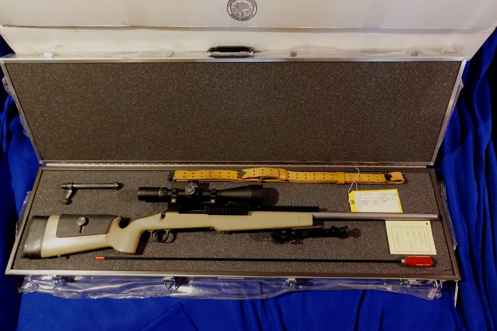

Rubbing it in a bit????
Bastards... Buffalo and I are still waiting for our cases. We're entitled...

Speaking of cases, I managed to score a few Mod 5 cases to go with the Mod 0 cases :)

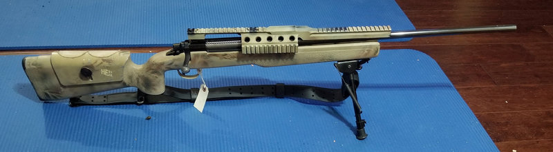

A buddy of mine just got his rifle back from Alan, I'll try to get some pics of it to post on here. Anyone else doinv anything with the Mod 0's?

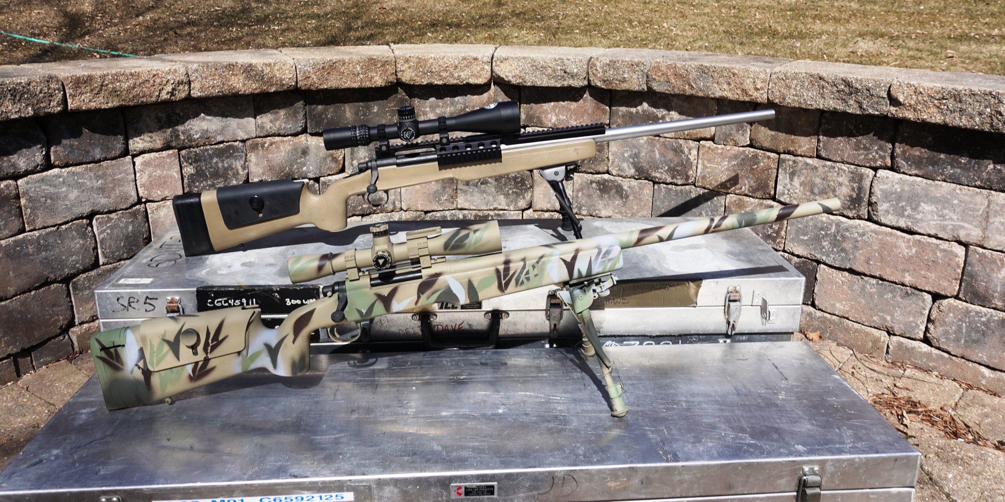

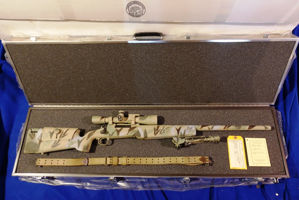

There was one last version I wanted and that is the early MK13 MOD0. The Top MK13 MOD 0 is the later version
with the tan stock, NF Optic, MIRS, etc.. The Bottom MK13 MOD0 is the early version with the gray stock. There was very little configuration management of the early platforms. In fact, these rifles were listed as, " Remington M-700, 300 Win Mag'. This rifle, SN C6,64X has the Ultra M1-A Optic, Ultra Rings, Early Simrad Cap, and mount manufactured either at NSW or a machine shop near by.
There was one last version I wanted and that is the early MK13 MOD0. The Top MK13 MOD 0 is the later versionView attachment 6888487 with the tan stock, NF Optic, MIRS, etc.. The Bottom MK13 MOD0 is the early version with the gray stock. There was very little configuration management of the early platforms. In fact, these rifles were listed as, " Remington M-700, 300 Win Mag'. This rifle, SN C6,64X has the Ultra M1-A Optic, Ultra Rings, Early Simrad Cap, and mount manufactured either at NSW or a machine shop near by.

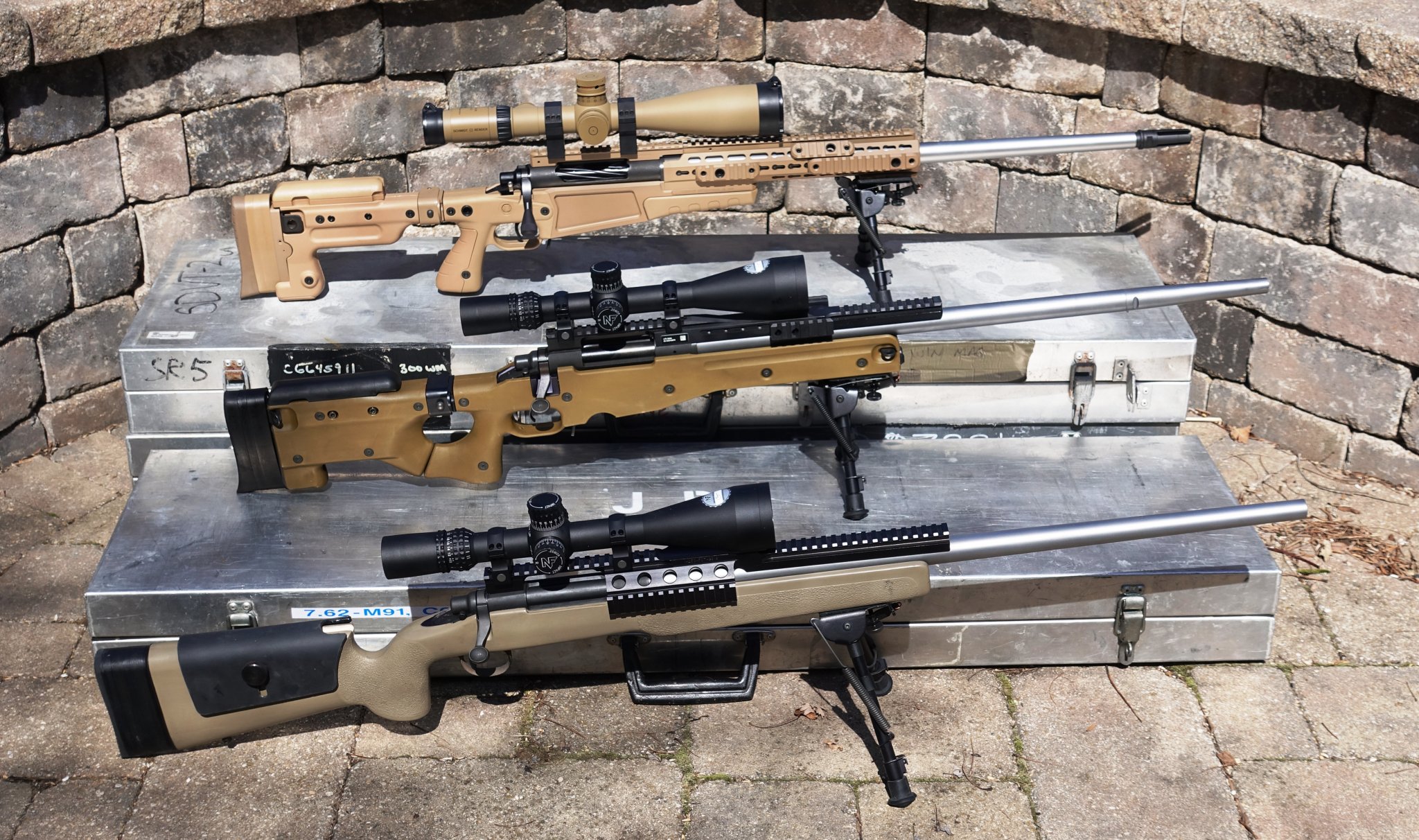

The 700/300 was IMO the best of the breed, but I'm bias as that's what I chose to build, though I have a green mod7 with correct contiguous rail and mk13 Stiller as well.
For me it came down to two things, the cheek weld and K.I.S.S. I am not gonna hang a bunch of shit off a 17# rifle and I can lay behind it comfortably without adjusting (or even needing) the cheek piece. It's a simpler platform and the 140MOA of the Mk4 16x allows it to be used as far as you care to engage before you call for fire. It's so close to the mod0 that it can be converted with 4 screws and a rail, but I love it as is.
