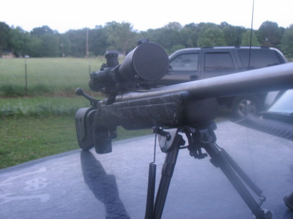

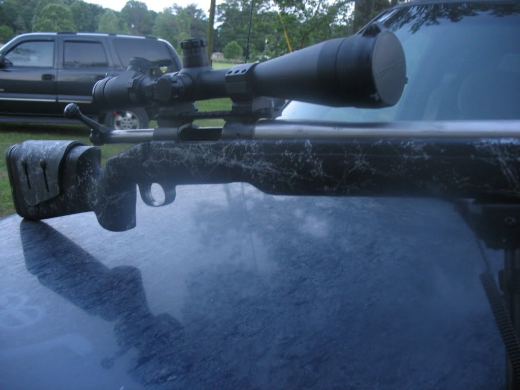

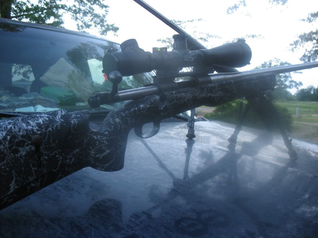

This is one of the rifle I build. I finished it about 4 months ago but jsut got around today to taking some pictures.
Winchester 70 SA (PF). I removed the spacer out of the mag box and trimmed the bolt stop back to allow me to have plenty of room to seat the 140Amaxs where I wanted them. Action was completly blueprinted.
Shilen SM #17 cut to 26.5"
McMillan A3 with adj. LOP and a Karsten cheekpiece. Has the Rail in the forearm. Pillared and bedded.
Wyatt's 1pc bottom metal.
Jewel trigger set at 1.5lbs
TPS base and XTR rings holding the 6-20x50 MK4 Ill. TMR rec.
I've shot it 23 times so far. Seems to shoot mid .3's.
Painted myself so please don't hate on the paint job..

I have to say I like the paint as well. Came out great for doing it yourself. Great to hear it shoots well. Slick looking rifle.
