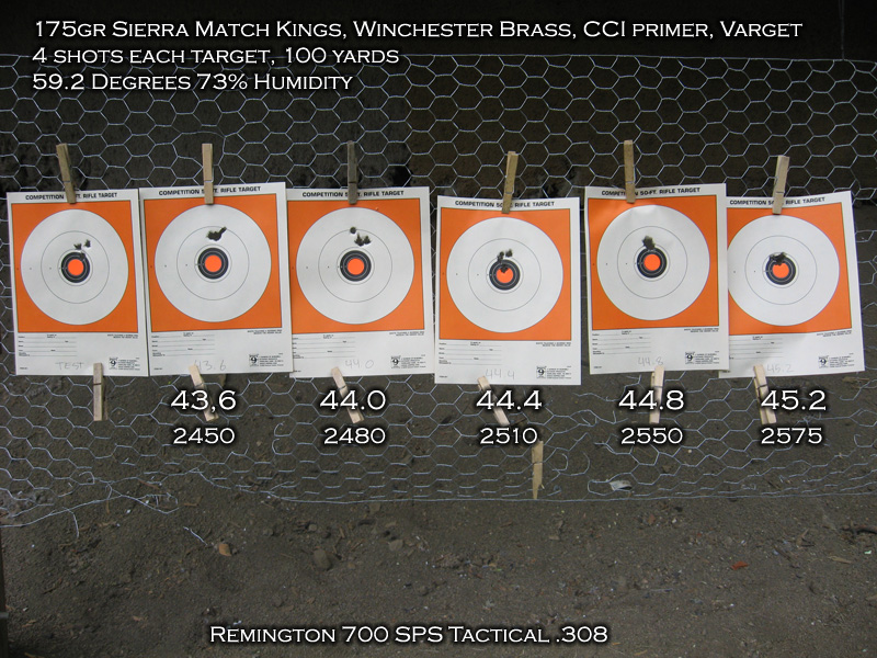

Looks like 44.8gr of Varget will be the happy place for my rifle. Max load according to Hogdon is 45gr so didn't want to go too far past that to test but even at 45.2 I showed no pressure signs at all.

<div class="ubbcode-block"><div class="ubbcode-header">Originally Posted By: suasponte</div><div class="ubbcode-body">The 45.2gr load looks just as good also. It appears to show a little less vertical dispersion than the 44.8gr.
What was the rig you fired it from?
Terry </div></div>
I am almost curious as to what 45.6gr would have looked like. If it had the same point of impact as the 45.2 it might change my load a little. Maybe I will load some and head to the same range in a bit since the conditions right now are the same as they were the other day.
And throwin them out of a Rem 700 SPS Tac .308, 20" barrel, etc. etc.

I would load up another 10-20 rds of each on the 44.8 and 45.2gr and see what consistency is like. Make sure it wasn't just good shooting on one, and better on the other from you.
I'd also heat it up a bit more, if your not showing pressure signs. I'd personally want my 175's moving a little faster than that... I'm moving 185's faster than that.

Loaded up some at 45gr today and hit the range. Fired 11 rounds with the average velocity being 2560fps and a respectable group. I fired 5 rounds at 2 targets, reset the elevation on my scope to the new zero, then one more at a orange sticky and nailed it.
I'm gonna stick with 45gr and see how it treats me at distance. I think the 44.8 might be the more happy load but we'll see. I need every bit of velocity I can with the short barrel.

With my Savage 43.9 and 45.3 or so were my 2 most accurate charges. Sinse most my shooting is at 200 or less I typically stick with the lower node.
