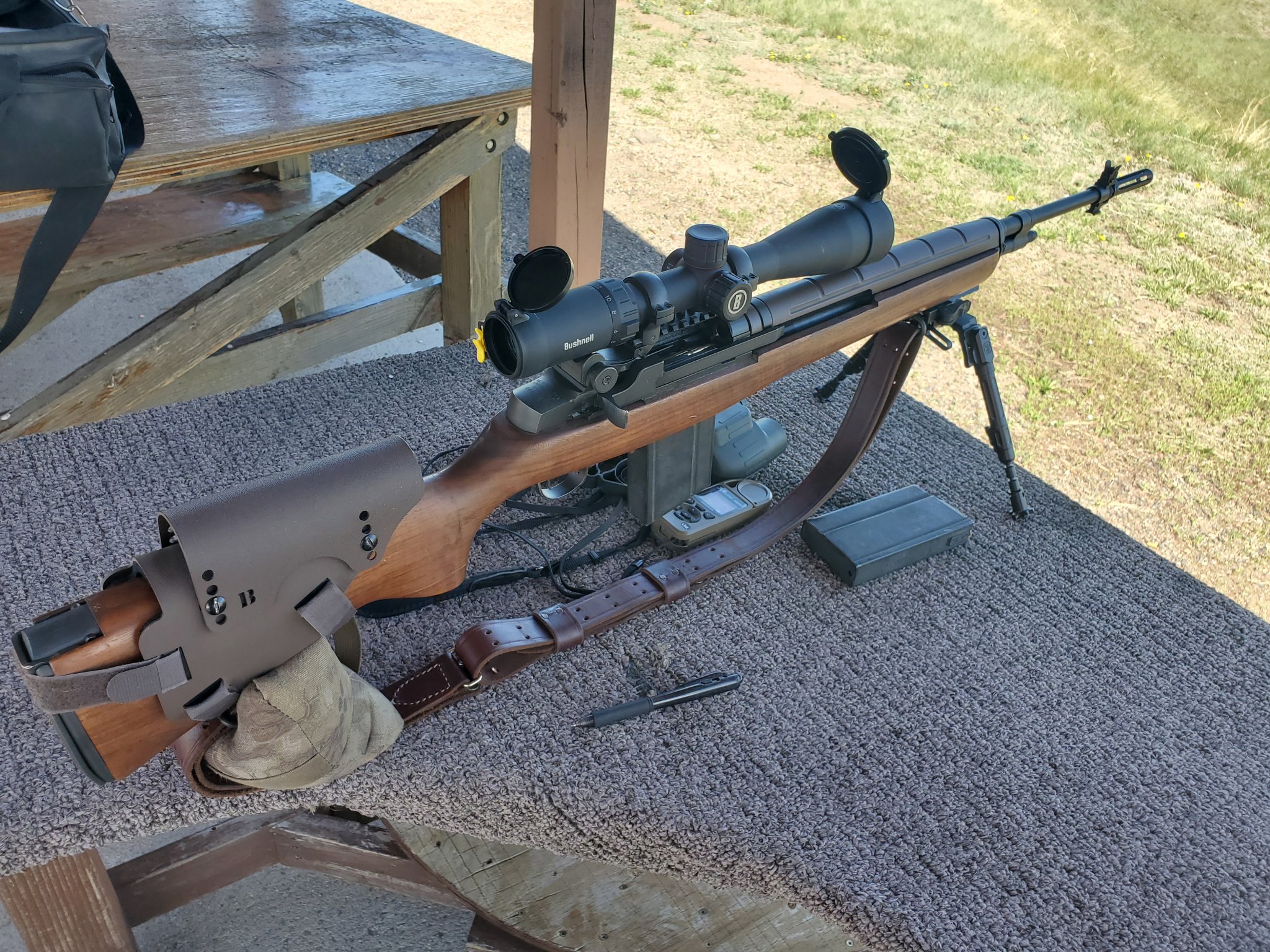

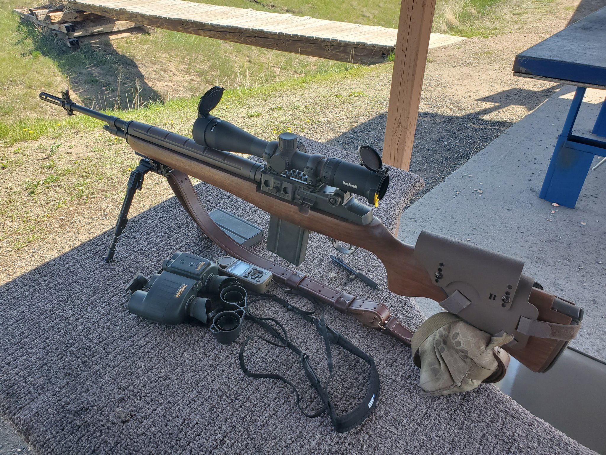

    I've had this rifle over a decade now, and I used it to shoot NRA High Power with. I don't shoot that type of competition much anymore so I decided to scope it.
    First the specs of the rifle
    Glen Nelson built SM from 1996
    Rear lugged receiver
    Douglas heavy air gauged barrel in 308
    TRW bolt
    NM front and rear sights
    Unitized gas cylinder (AMU style)
    NM spring guide
    All other parts are genuine USGI
    I installed an ARMS 18 scope mount. I previously had a Smith Enterprise mount and the ARMS mount sits lower and fits better than the SEI. Rings are Burris Signature rings with pos-align inserts. The scope is a Bushnell Nitro 3-12x44 FFP mrad. The rear sight aperture needed to be removed to mount the scope as low as it is. This isn't a big deal because the iron sights can't be used with this mount.
    Anyway, here are some pictures.

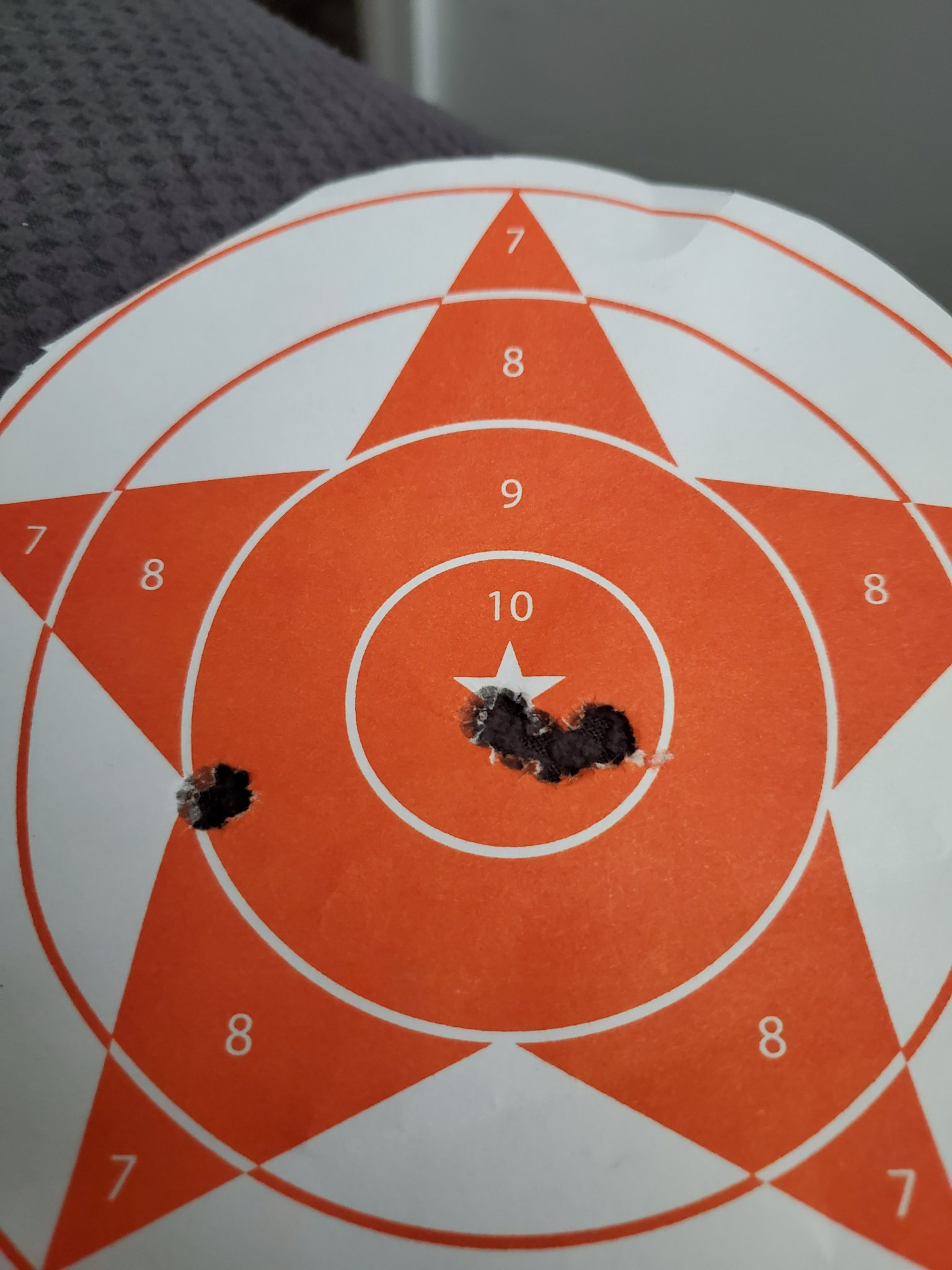

    The flier was on the 2nd shot of a five round string. The wind came up just before the shot broke. Really frustrating, and shots 3-5 went right back to center.
    Ammo used was SSA (Nosler) 168gr match. For as inexpensive as it is I am very happy. Velocity was right at 2650 with an SD of 3.5 over 5 shots. Now I want to develop a 175gr load for it. I've never shot 175's out of this rifle, but I think with the 168's I'm leaving some long range performance on the table.
    Regardless, this rifle is extremely accurate, and always has been. Plus its super fun to shoot.
    Nice. I have a SA Super Match in McMillan camo stock that I bought 25 years ago. I’m embarrassed to admit I’ve only fired 20 rounds through it. I hope to change that and just installed a Sadlak mount and Sightron SIII scope. What cheek riser is that and how do you like it?
    Reactions: JMGlasgow
    Bradley Adjustable ($112). I have them on all my rifles that need a riser. Lots of different colors and patterns to choose from.

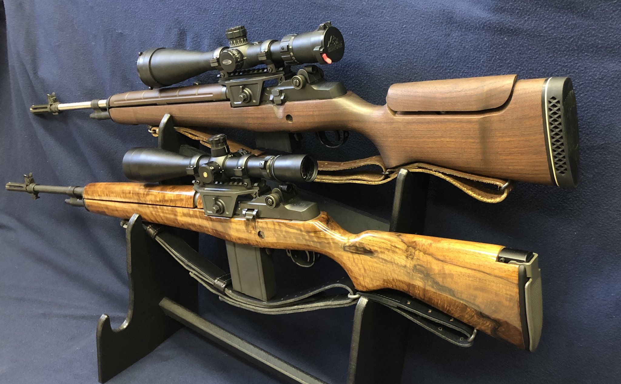

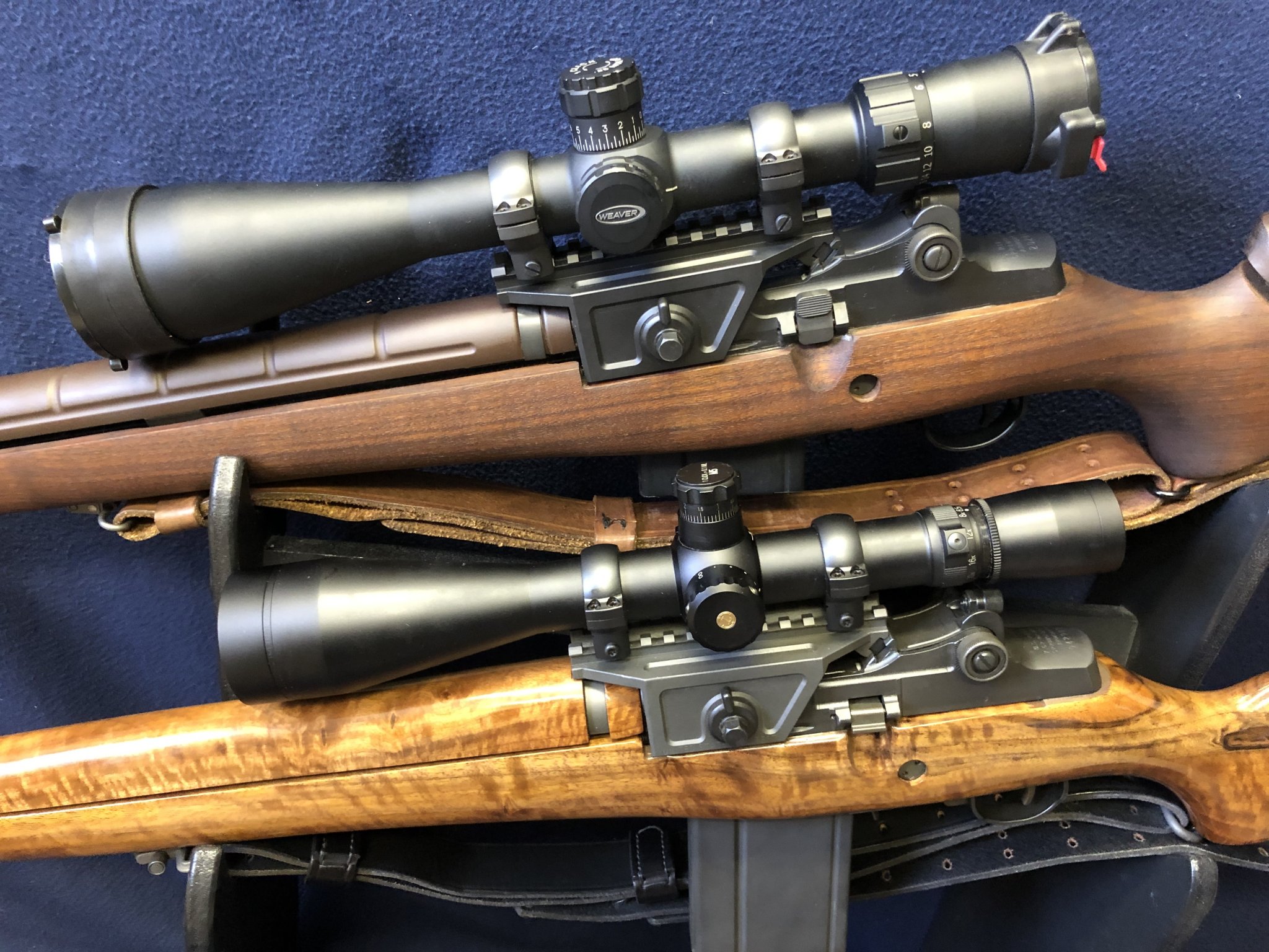

    Thanks for sharing those pics and results. I attached a couple of pics of my 2007 dated SAI M21 Long Range Match and 1987 dated SAI Supermatch shipped from Glen Nelson's shop with a 'fancy grade burley wood stock.' I had a 1998 Supermatch but converted into an USMC DMR replica last year.

    Like the original poster, I too have the Burris Signature Zee rings on my SAI M21 Long Match Match for over 10 years and never had any issues. In fact, I used them on my recent acquisition, which is a 1987 dated SAI Super Match with fancy grade buley wood stock and handguard. Scope mount is an SEI part, which sits a little higher than the ARMS 18.

    I like the Zee rings because they are low profile, adjustable, and they hold very well.
    ...and with the plastic posi-align inserts - they don't leave any ring marks/finish wear on the scope either.
