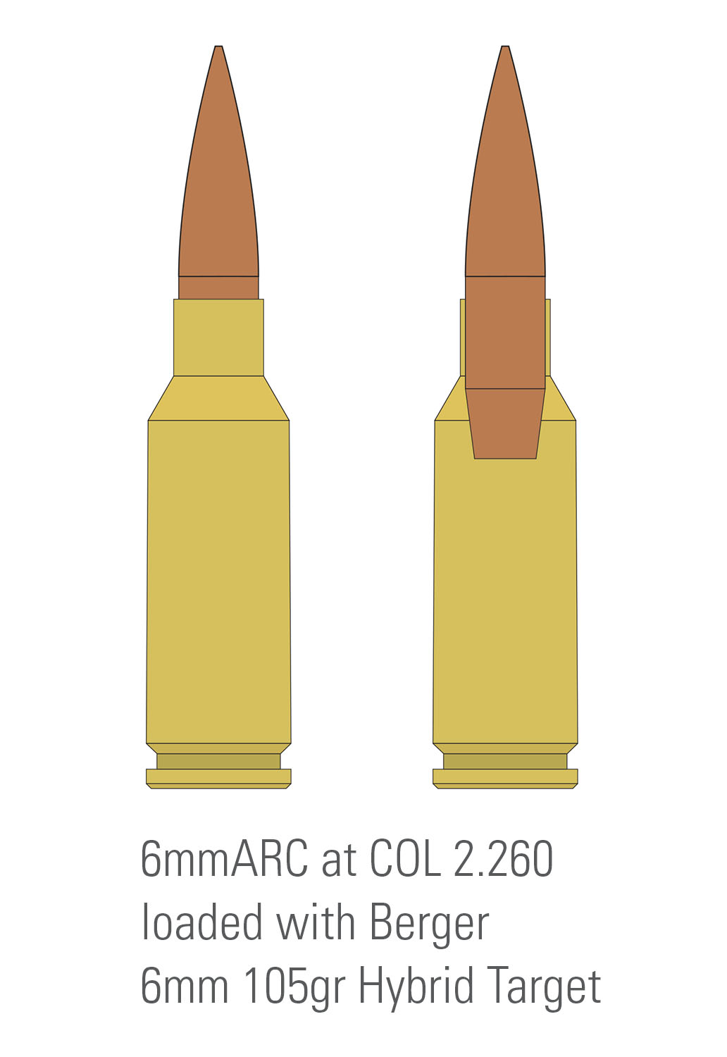

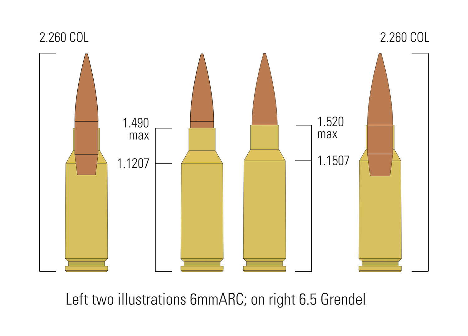

Dimensionally-correct illustration attached shows 6mmARC at COL of 2.260 loaded with a Berger 6mm 105gr Hybrid Target bullet (G1 BC 0.536).
.030 isn't going to make a bit of difference between it and the 6mmAR that has been out since 2006. What will make a difference is any joe blow can walk into a store and buy ammo.
Agree on both counts. 6mmAR, since they're so similar, is also designed perfectly for a long-range 6mm in an AR.

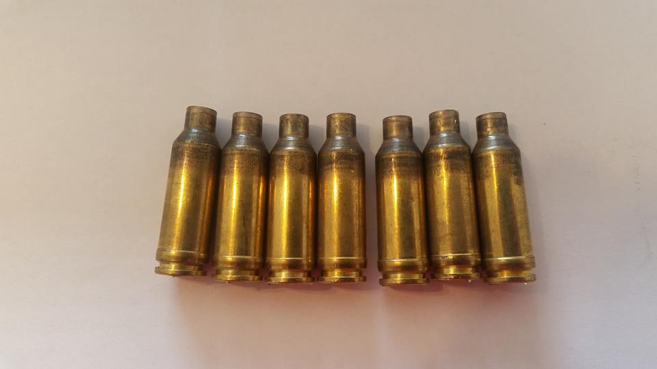

This is what the belted Grendel magnum looks like and it happens when you push the pressure.
The cases above are not mine that photo came from the Grendel forum but there are many more online and back in 2007 I had a few of those on a 6mm version of the Grendel. 2 more photos from other people. The cut through shows why those cases will not handle a lot of pressure.
