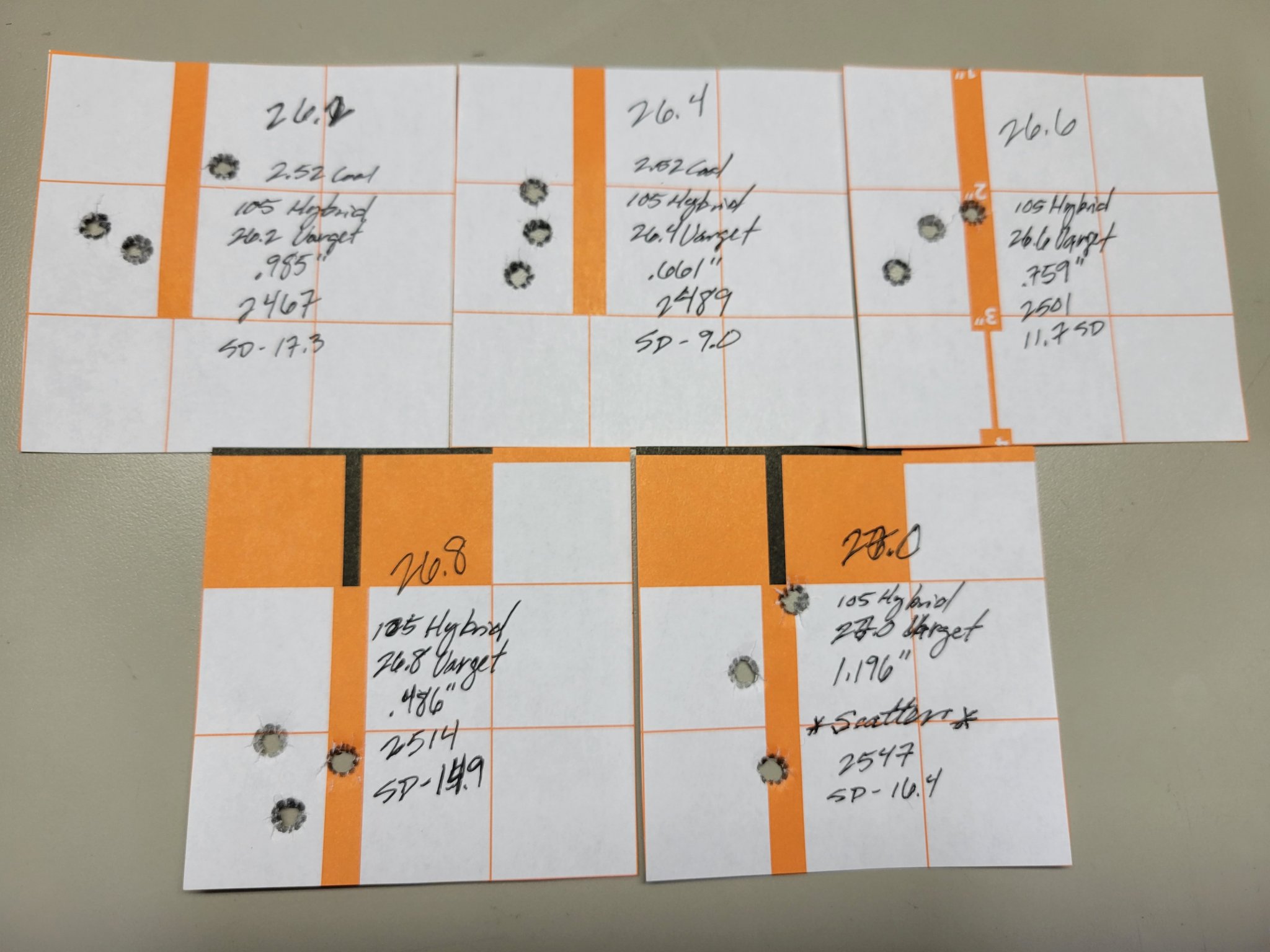

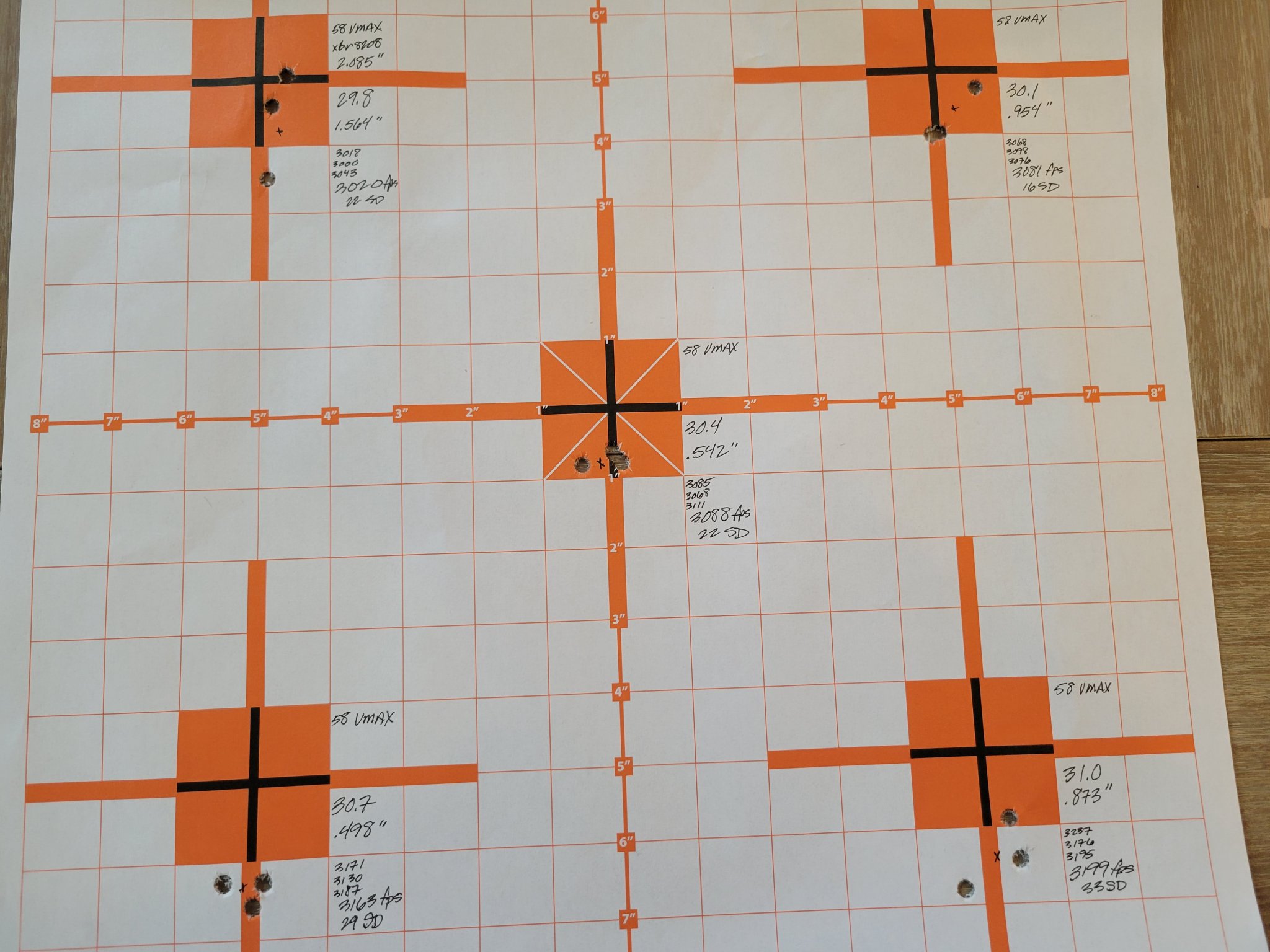

For reference - a couple OCWs with 105 Bergers over Varget and 58 VMax over xbr8208. 18" proof Carbon. Shoot well under moa with both 105 and 108 factory loads as well. My 12.5" Faxon prints into 1.5" with 105s and 2" with 108s at 100 for 10 shot groups. My barrel started to group consistently at about 50 rounds down the tube.

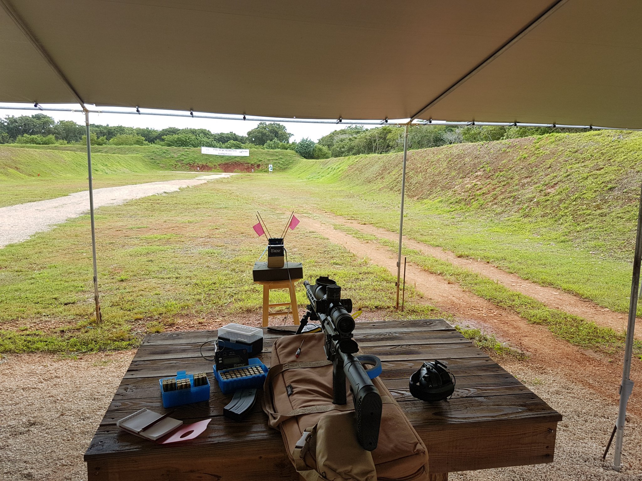

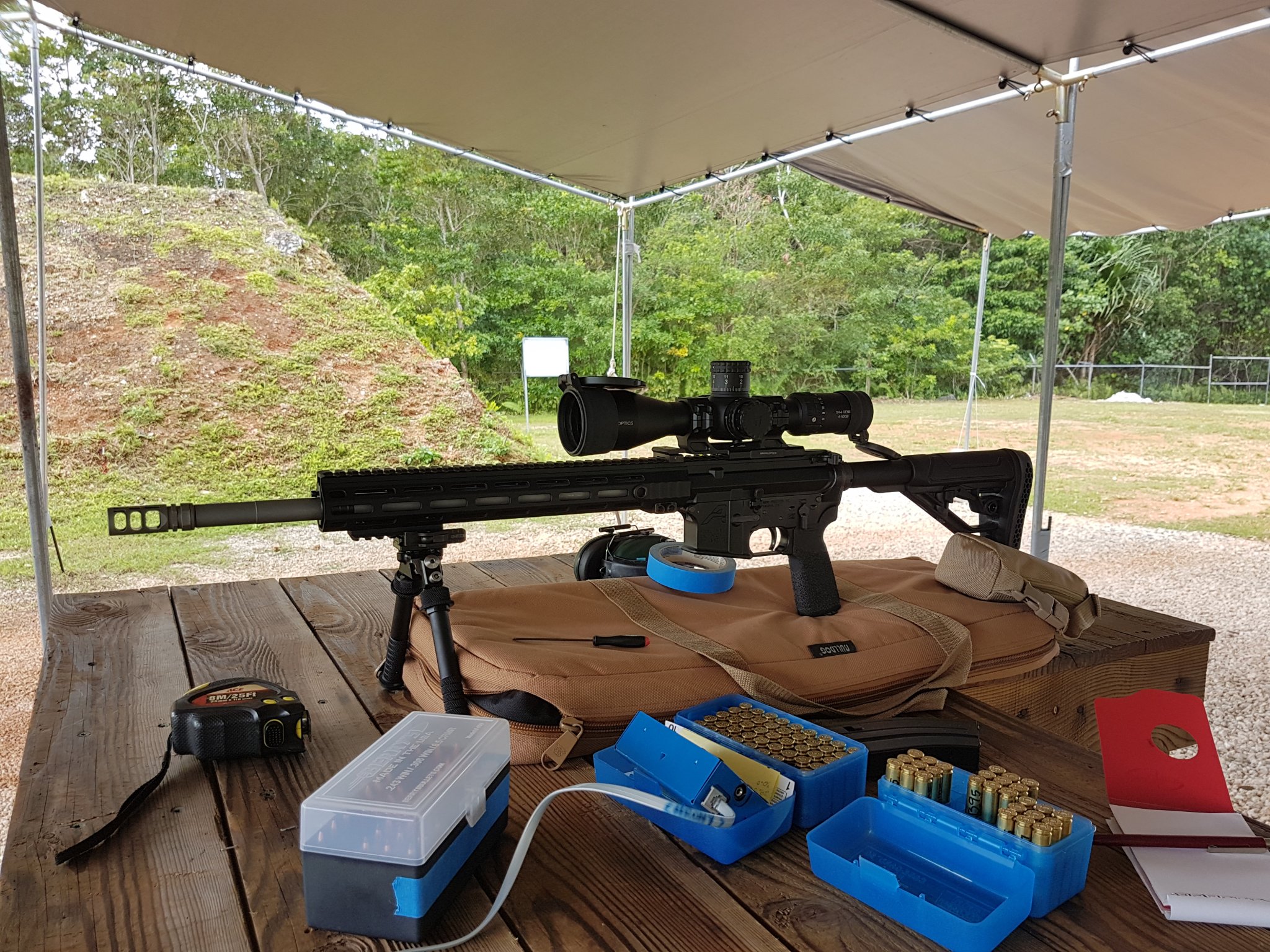

...that particular group was the max Berger 95 VLD load and the 67th, 68th & 69th round of 113 rounds down a brand new BA 18" barrel. It was the 1st time out for the build. I have not been able to get any factory ammo so I went straight to handloads. I only use factory ammo to validate a build and establish baseline data. If you scroll back in this thread my results from that day are posted. The focus was testing powder charges for pressure, not accuracy, ensuring the bullet passes over the optical sensors of my old chrony, having an aiming point down range helps to keep that bullet as centered as possible over the sensors. Pic I took waiting for the rain to pass, had to bring chrony under the canopy.
I know alot of folks post disparaging comments about BA barrels, but I've been using them for over 10 years (300BLK, 223 Wylde, 556, .308 & 6.5CM) and haven't had a bad one yet. As for your experience, before returning it I'd suggest put enough rounds thru it to "break in" before returning under their MOA warranty guarantee. I would also complete break in before making any changes to establish a good baseline. FWIW, I only torque my barrel nuts to 35 lbs and I also face all of my receivers. I do have extra receivers and I'll match the barrel to whichever receiver has the tightest fit. Haven't had the need to go with shimming or gluing/bedding yet.
In building, patience is your friend.... if you want immediate accuracy results, maybe buying a factory built reputable brand of rifle (and its recommended ammo) specific to accuracy might be less frustrating for you.
Good luck in your future endeavor with 6ARC.

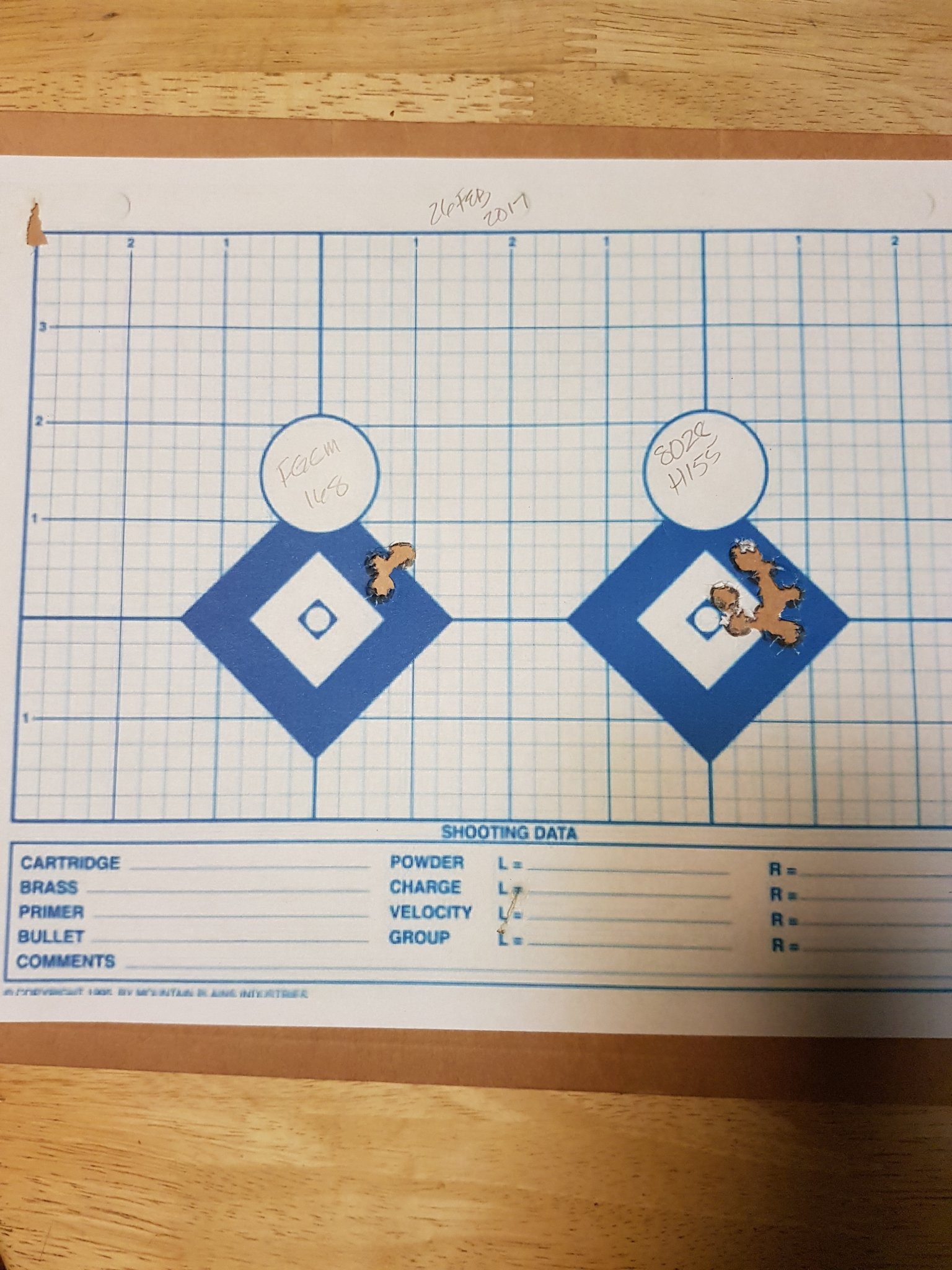

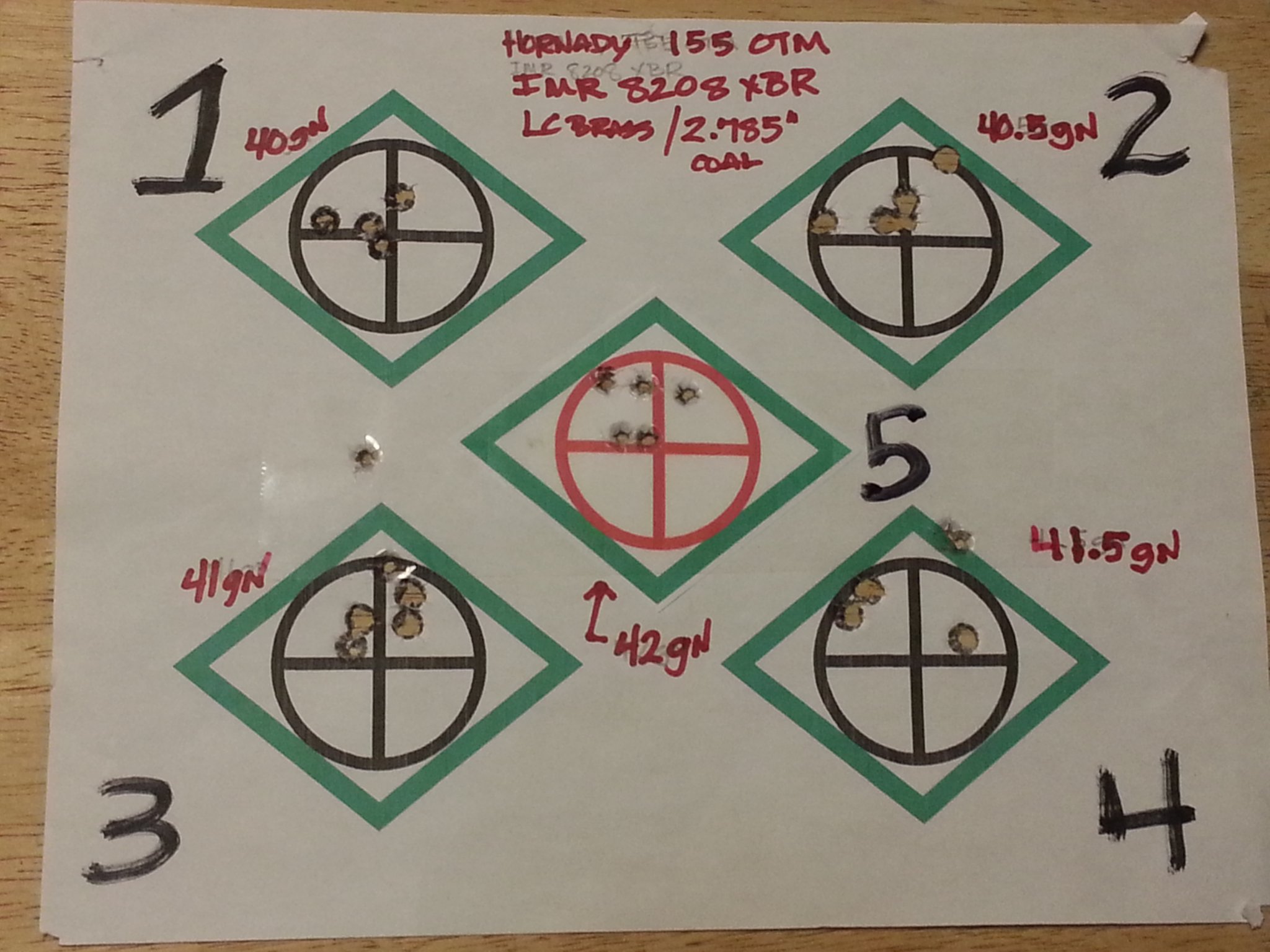

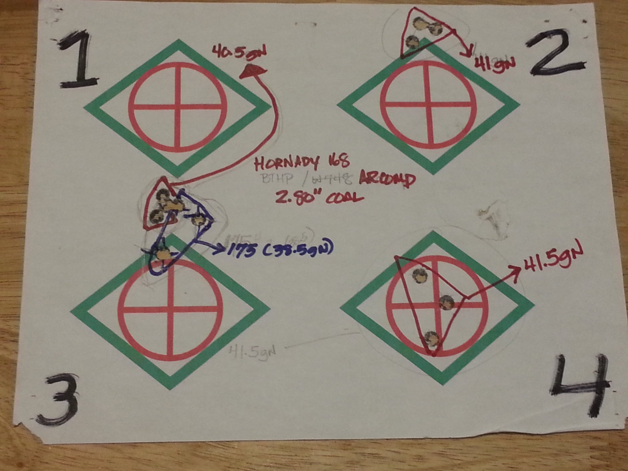

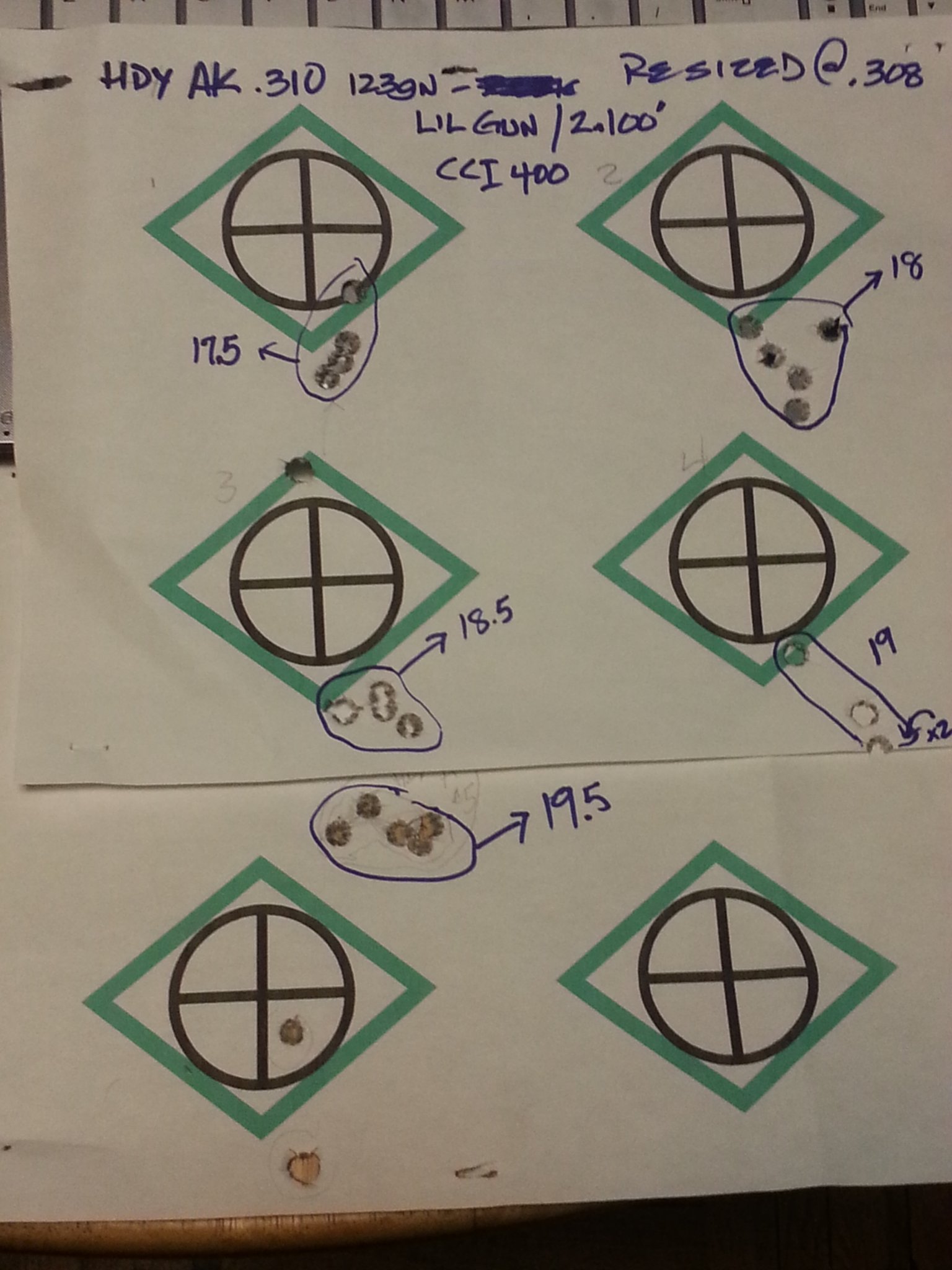

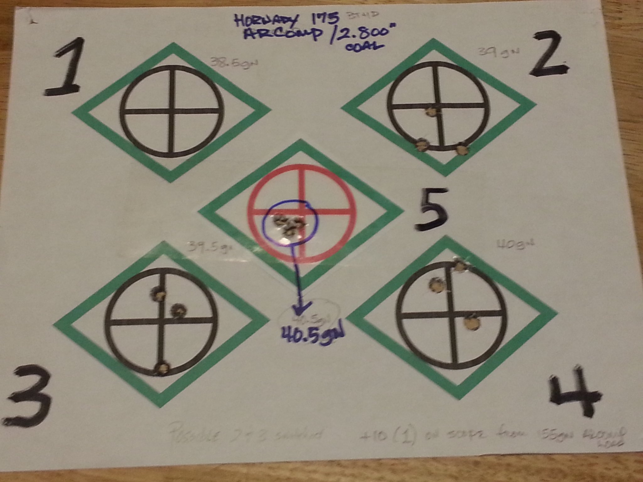

....JKGTR, here are some pics of MY test results out my BA 10.1" Hanson in 300BLK and 16" Hanson in .308 barrels. It is results like these why I keep using BA barrels... I feel I get my bang for the buck, simple as that.

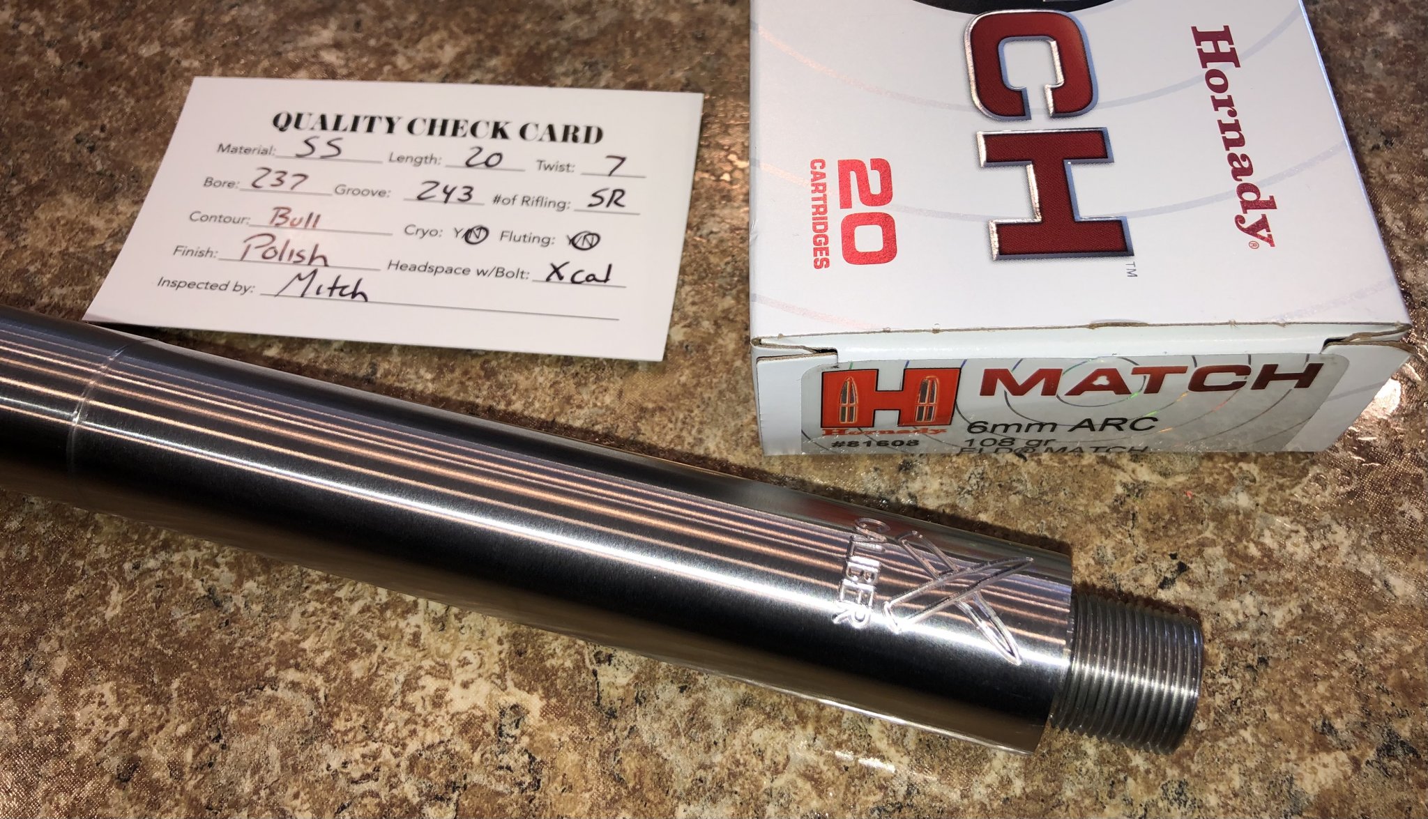

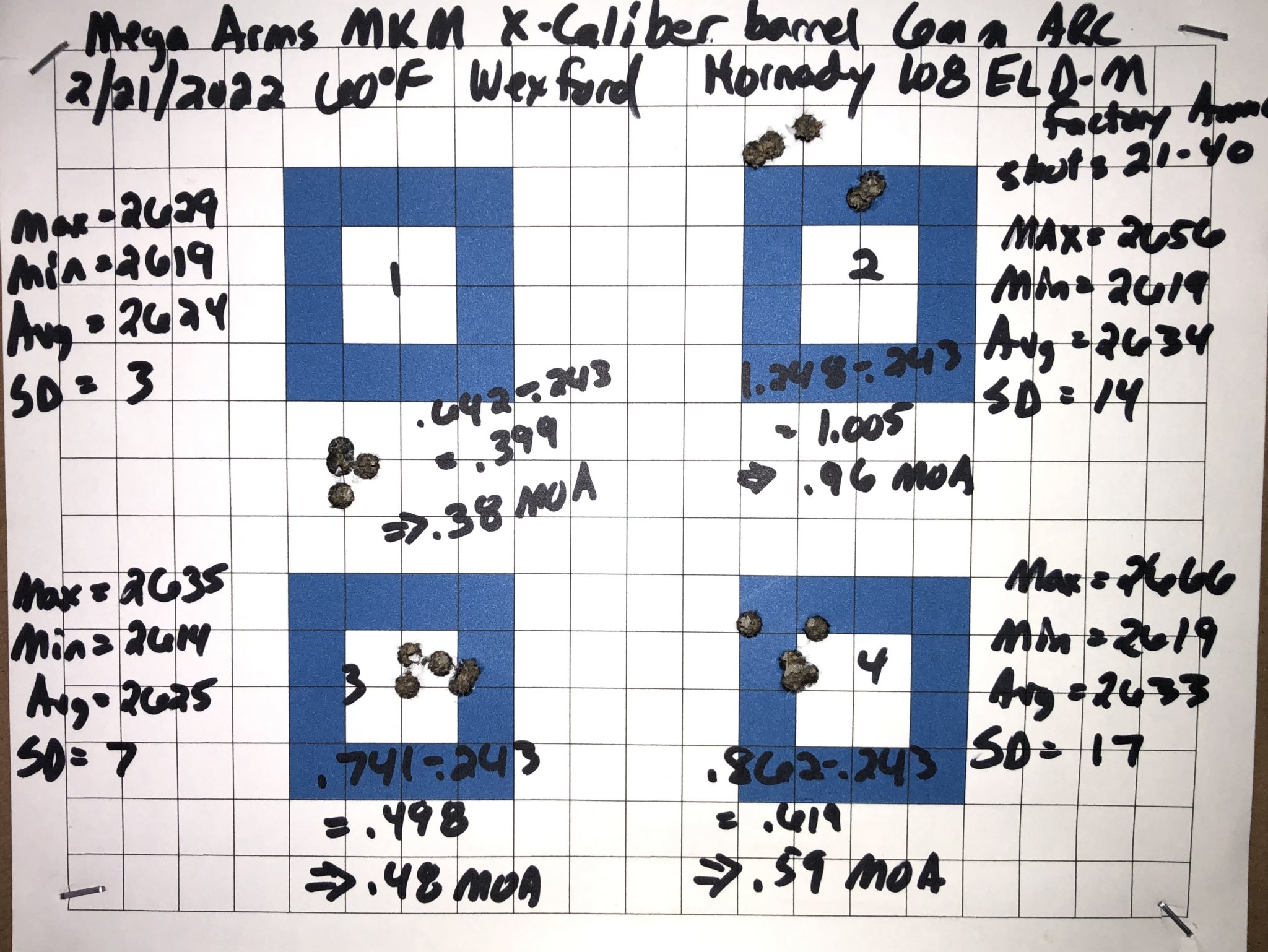

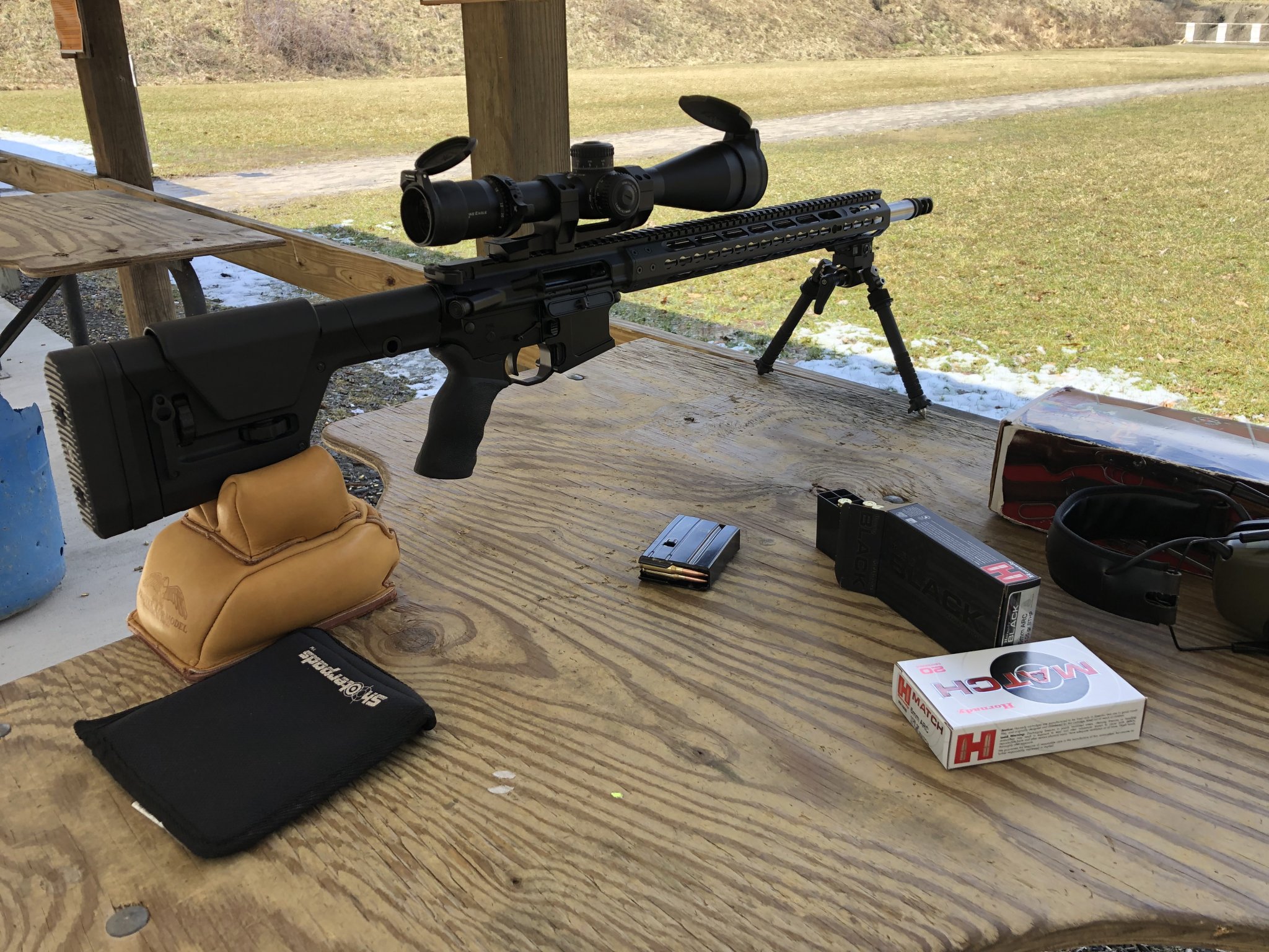

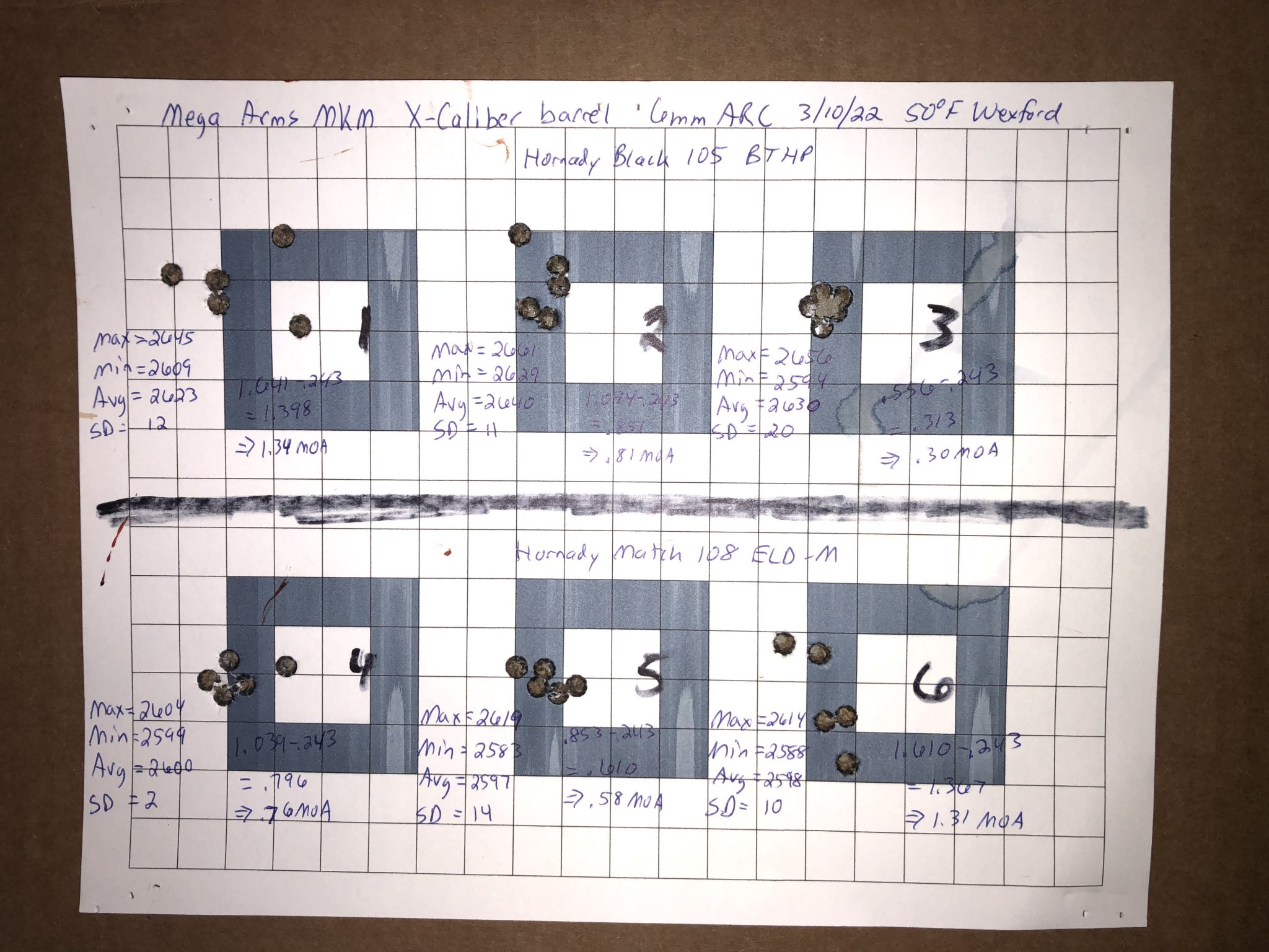

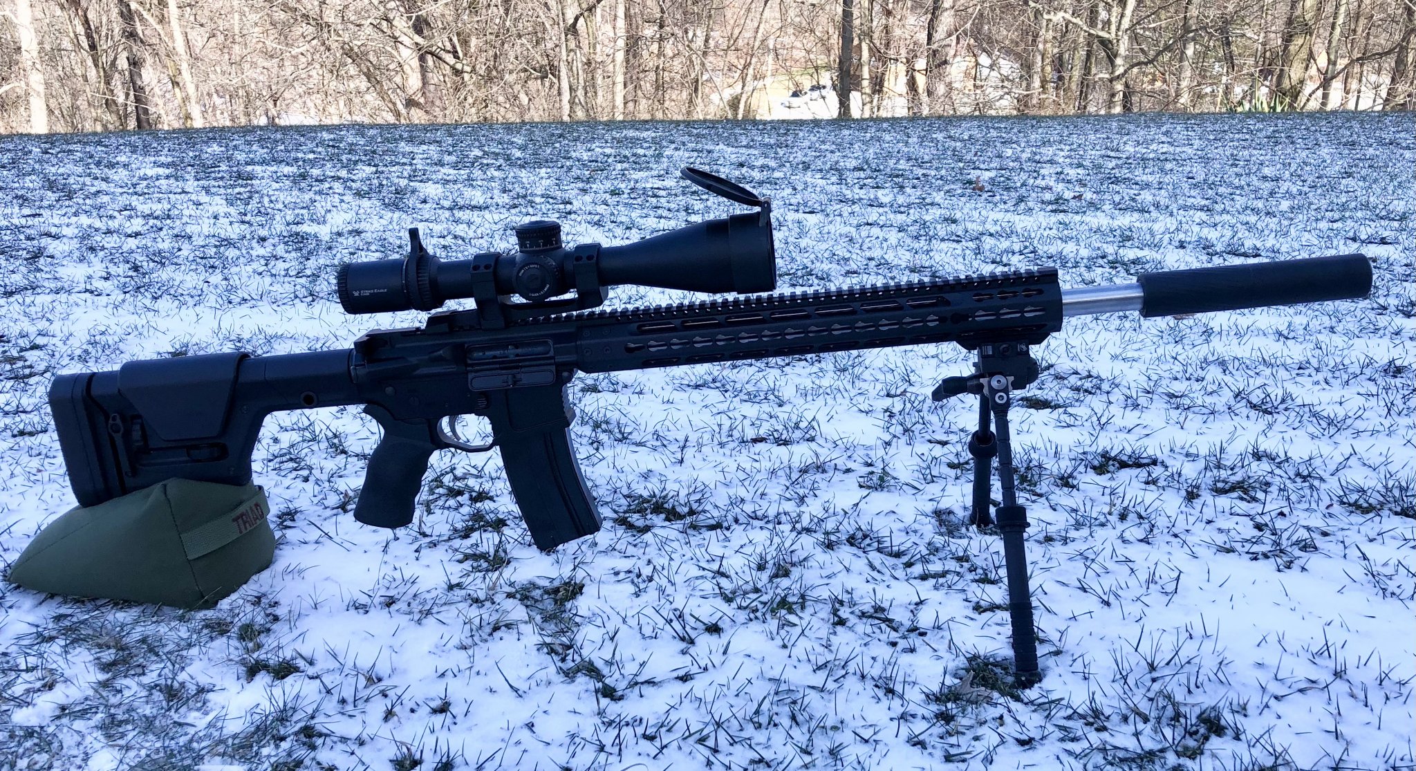

Well I’m a believer in X-Caliber now. This is my first X-Caliber barrel. I couldn't resist the nice weather so I hit the range a few days ago and did a 20 round break in (doing the shoot and clean method) and then shot four 5 rounds groups. All groups were shot from a bench and using an Atlas CAL bipod and rear bag. The range I was shooting at doesn’t permit shooting from prone, otherwise I would have shot prone. The early results look promising and make me think it's a shooter! For factory loaded ammo at 100 yards, I'd say it's going to be tough to duplicate this through hand loads. The point of impact for each of the four groups changes because I was dialing in the scope zero. Hopefully I gain consistency in muzzle velocity by hand loading. I'm very pleased.
Well I’m a believer in X-Caliber now. This is my first X-Caliber barrel. I couldn't resist the nice weather so I hit the range a few days ago and did a 20 round break in (doing the shoot and clean method) and then shot four 5 rounds groups. All groups were shot from a bench and using an Atlas CAL bipod and rear bag. The range I was shooting at doesn’t permit shooting from prone, otherwise I would have shot prone. The early results look promising and make me think it's a shooter! For factory loaded ammo at 100 yards, I'd say it's going to be tough to duplicate this through hand loads. The point of impact for The point of impact for each of the four groups changes because I was dialing in the scope zero. Hopefully I gain consistency in muzzle velocity by hand loading. I'm very pleased.
View attachment 7819305View attachment 7819308View attachment 7819309
Those groups look solid. What was the lead time from order until received?
Very nice. I was looking at X calibers website. Lots of options available. What are your specs?
Thanks. Yes, it is truly customizable. I went with a 20 inch, stainless steel, 1:7 twist 5R rifling, bull contour, rifle length gas and standard length gas journal and 5/8-24 threads. The specs are also shown on the card in the second pic in my post. No other options.
Ah, ok. I did not notice, my apology.
Interesting twist for the hornaday ammo. From what I’ve heard, no less than 7.5” twist rate should be used for that ammo. However yours seems to be shooting nicely. 👌🏼
I want to stick with the heavy 100+ bullets for this rifle, so I selected the faster 1:7 twist. My understanding is if a lighter bullet is desired to be used a slower (1:8) twist rate can be used. As far as the 108 ELD-M bullet, I believe Hornady recommends the 1:7.5 (or faster e.g. 1:7) twist rate. I'm very pleased with my results so far.

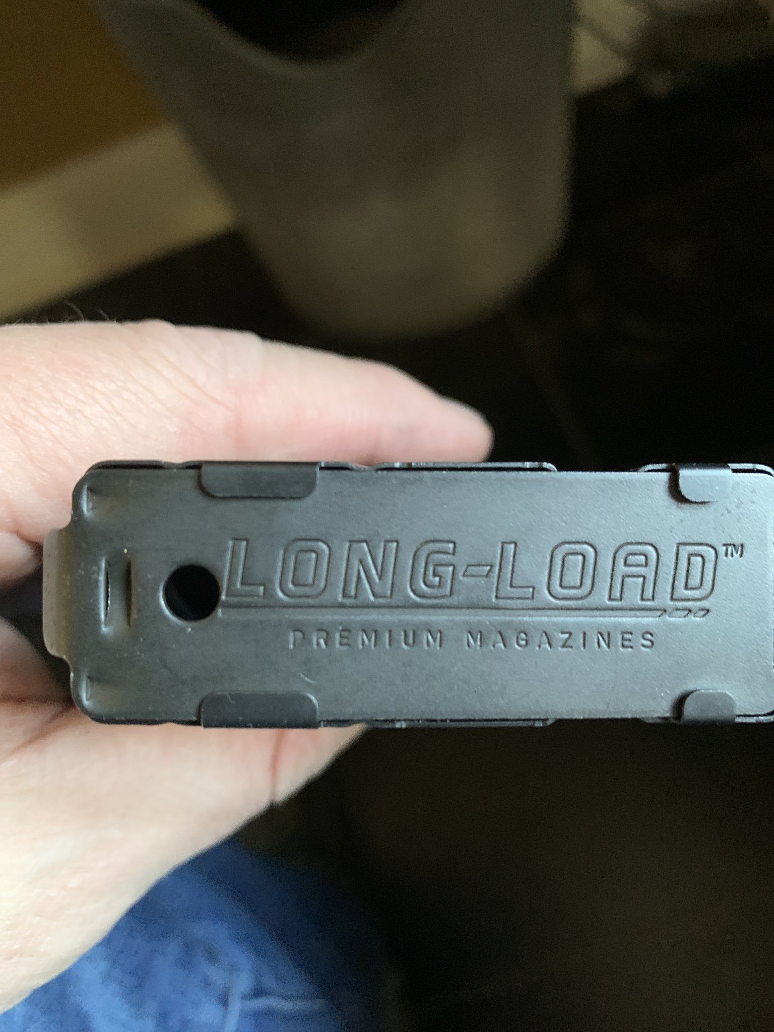

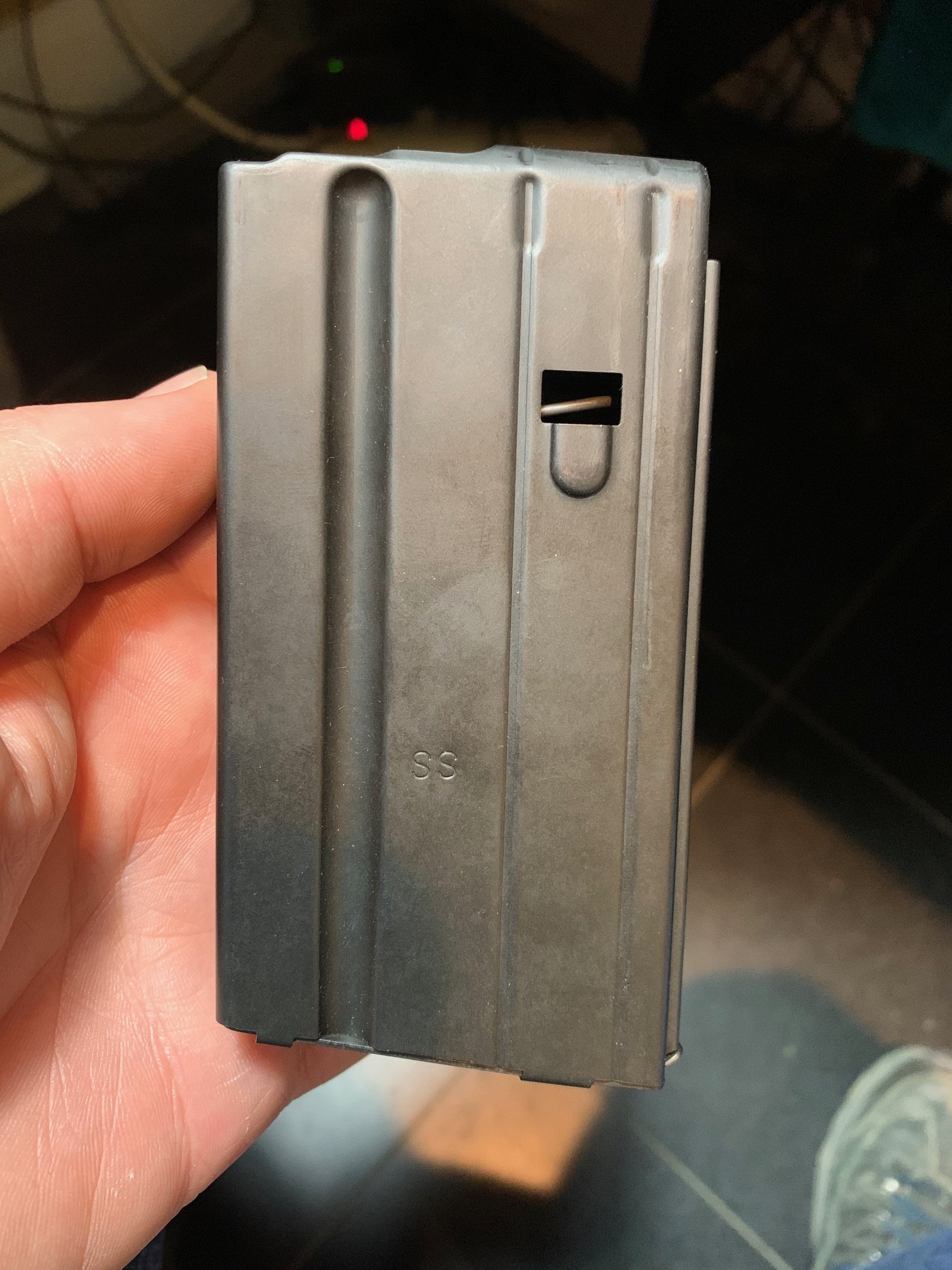

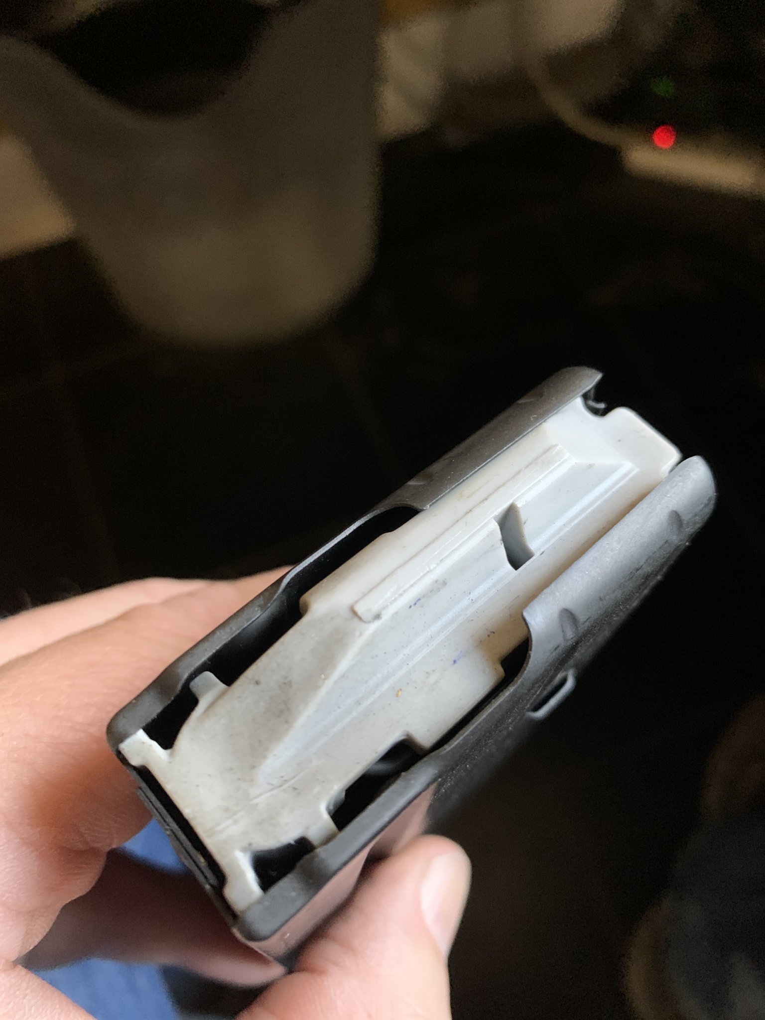

I don’t think there are. Brenton has pushed the width to the max which is what the Grendel case needs. My PRI 6.8’s don’t work very well cause they’re to narrow inside.
Here is a pic of the bottom plate& follower on the Brenton’s
I don’t have any elanders to compare so let me know?
Reactions: Cherodjr
Here is a pic of the bottom plate& follower on the Brenton’sView attachment 7827629View attachment 7827630

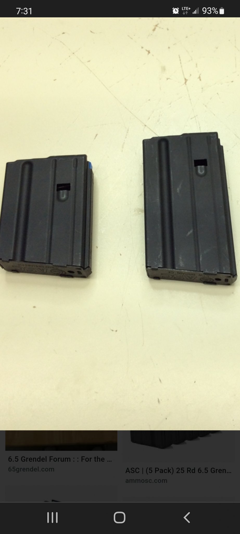

This is an elander. Looks the same too me. Like I said, not always a problem, but the elander is like half the price. Or less.

They aren't cheap, but again based on that e-lander pic above, the Brenton's are not the same.
Compare the mag catch window shape & the indented stiffening ribs adjacent to the window. Brenton's ribs are much shallower. This is what gives Brenton's wider inside dimension for the Grendel case. Also notice the 2 stiffening ribs on the Brenton get deeper right below the feed lips.
Small details matter more with Grendel sized cases.
ASC OEM then it looks like.

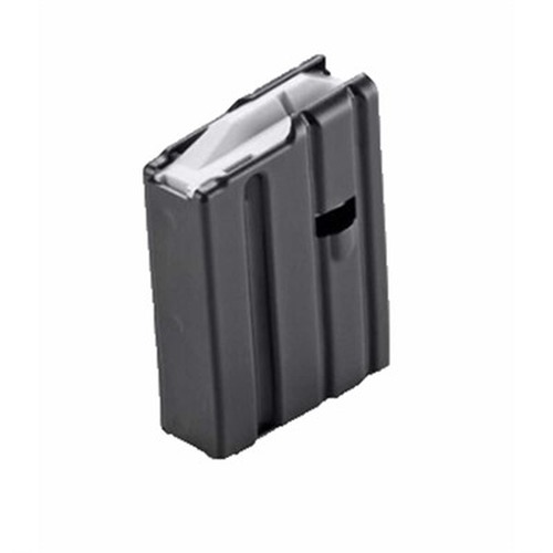

I just ordered some Geissele 15 and 25 rd mags from Brownell's. I believe this is the first time they have became available anywhere. They have a stainless steel body and are black oxide coated, and have their 6mm ARC tweaked followers.
AR-15 6MM ARC MAGAZINE STEEL
I want to know if these are a rebranded product like their last overpriced magazine…
Brownells has had them up for maybe two-ish weeks, but at the cost I’m hoping someone else will do the research for me.

They look like ASC magazines. Same 410 Stainless Steel Body. https://www.ammosc.com/categories/ar...s/6mm-arc.html
I emailed Geissele to see what they have to say about it. If they manufacture the mag bodies and followers in house or not. That's one reason I get and try a lot of gun stuff from Brownell's if the price is comparable. Because you have 45 days to get a full refund, other than the shipping cost back to them. Also, Geissele says they are using their own extended feed ramp barrel extensions for the 6mm ARC cartridge.
https://www.brownells.com/helpcenter...ndex.htm?id=57
