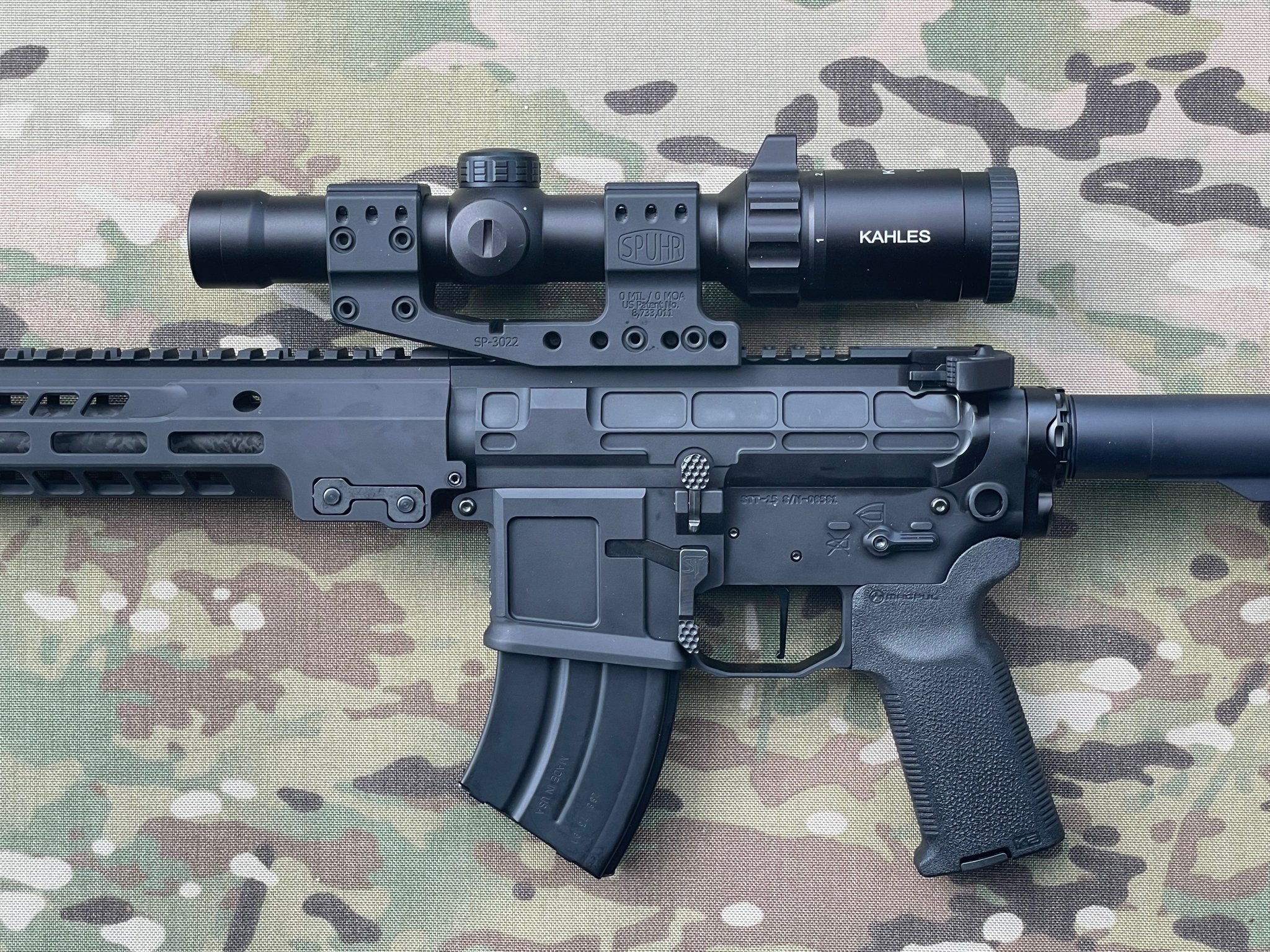

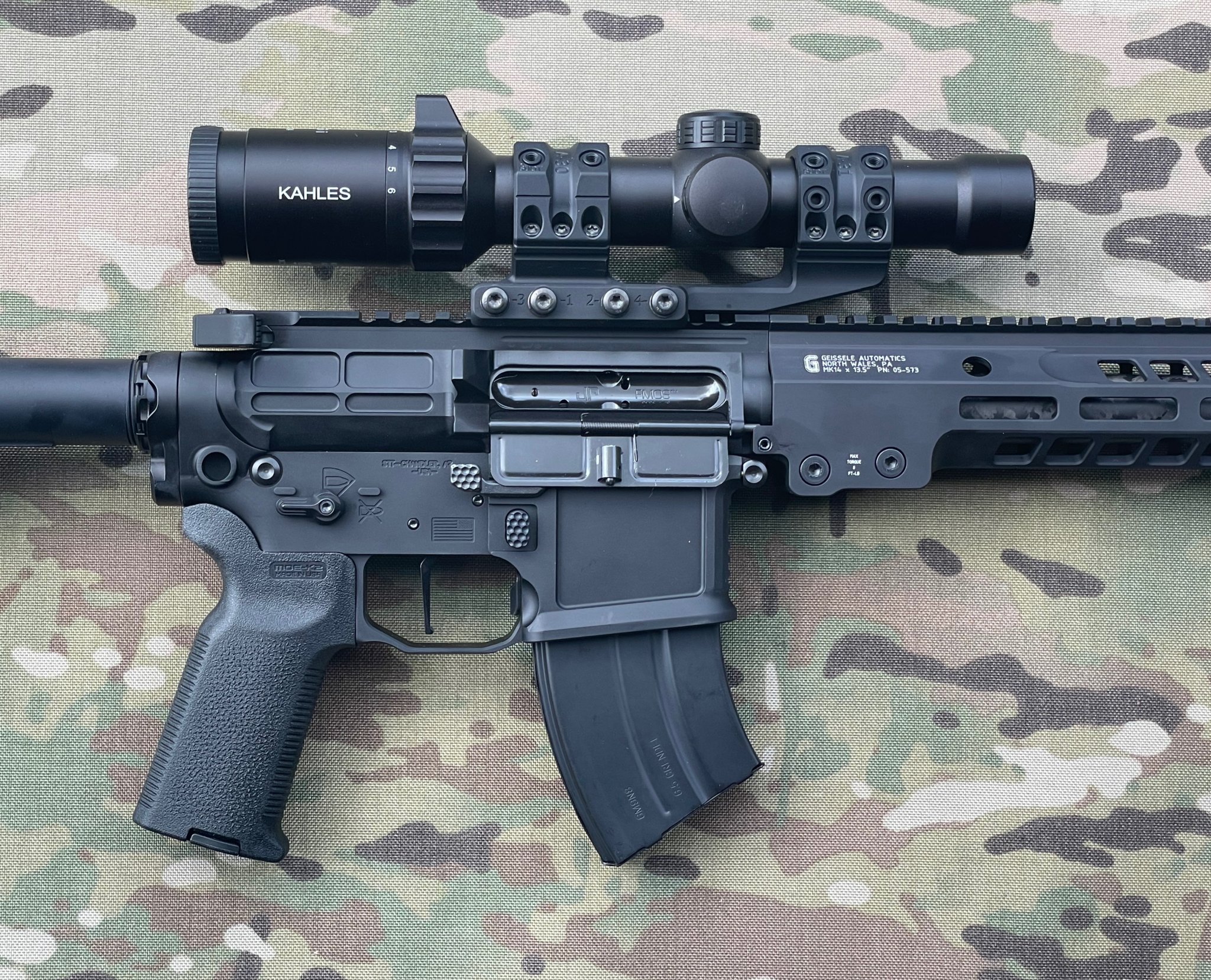

I received my Geissele 6mm ARC 15 and 25rd mags today from Brownells. They fit perfectly in both my AR15 lowers. Mag release worked fine, the bolt locked back on them and the bolt release worked fine. I have nothing to compare them to, but the fit and finish looked fine. The follower worked very smoothly in the mag body and I could not make the follower dip or hang up at all. I do not have a 6mm ARC AR yet, so I can't comment on how they feed the ammo yet.
I received my Geissele 6mm ARC 15 and 25rd mags today from Brownells. They fit perfectly in both my AR15 lowers. Mag release worked fine, the bolt locked back on them and the bolt release worked fine. I have nothing to compare them to, but the fit and finish looked fine. The follower worked very smoothly in the mag body and I could not make the follower dip or hang up at all. I do not have a 6mm ARC AR yet, so I can't comment on how they feed the ammo yet. Here are some Pics I just took of one of them.
I received my first 15 round today and ordered 2 more. Plan to order a couple of 5s and 25s. Just took my parts to my Gunsmith today, so can't comment further.

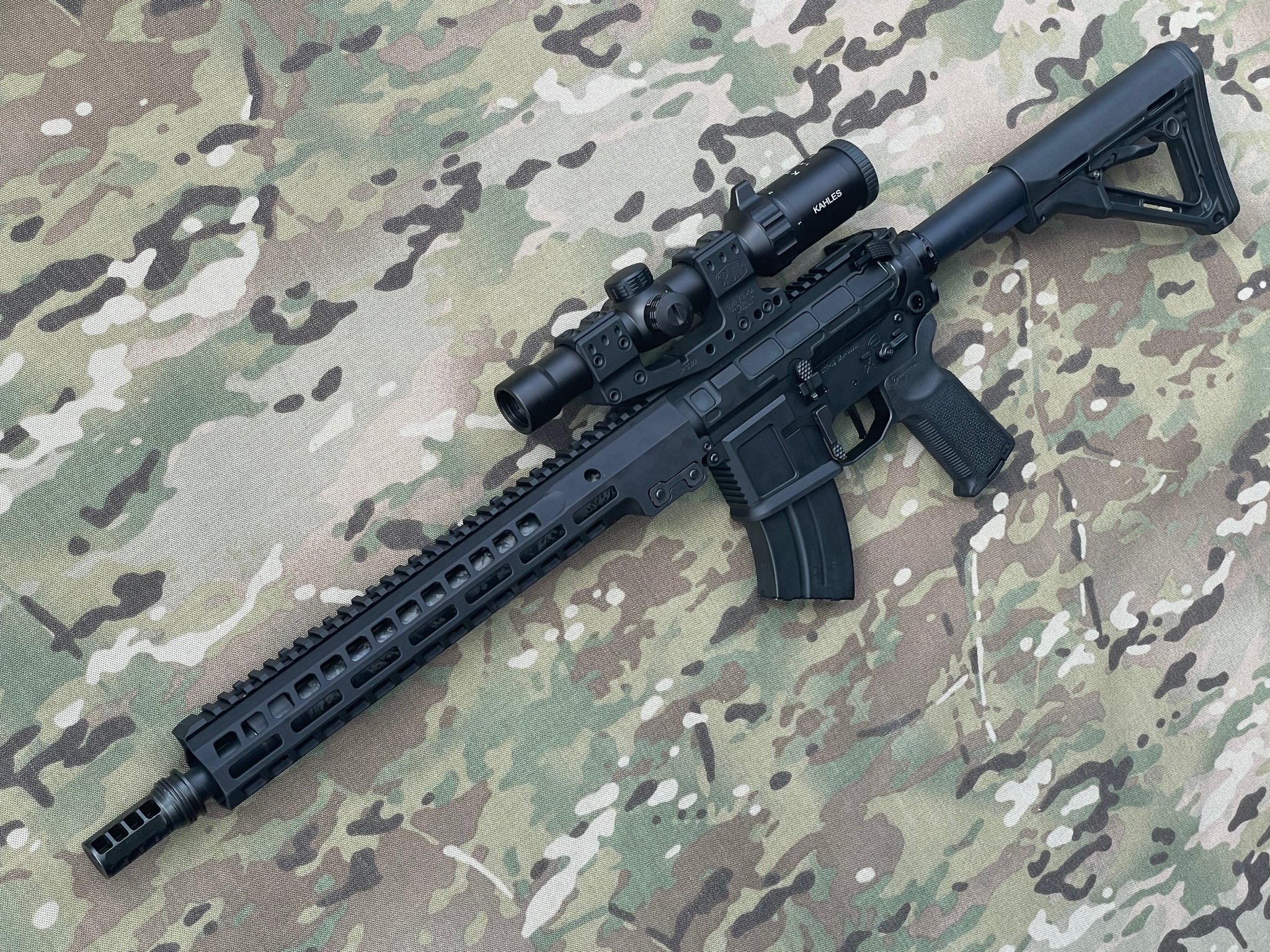

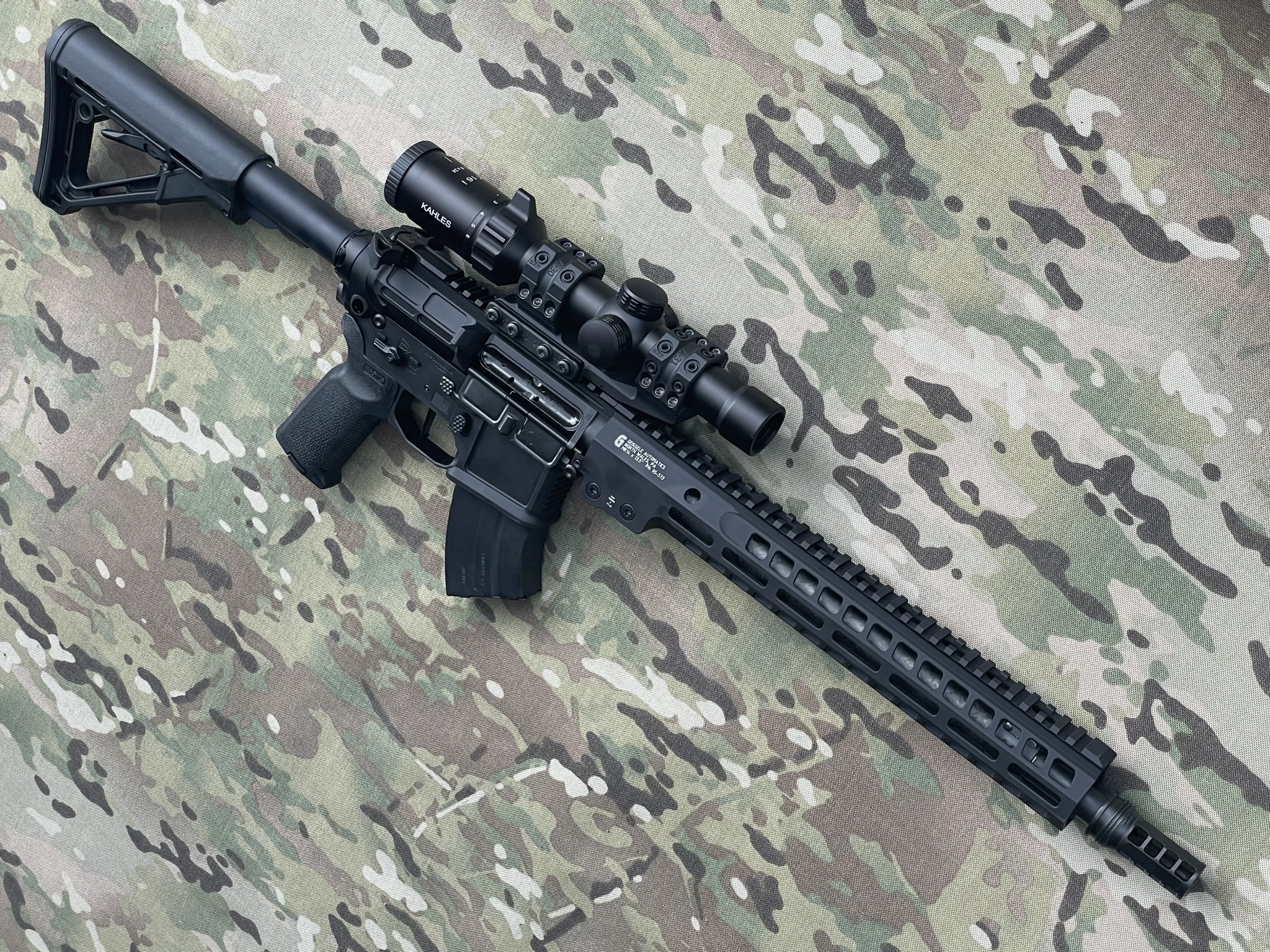

Just put 20 rounds of Hornady ELDM through a Proof 20” CF to zero, break in, and tune AGB. Used E-Lander mag. So far so good; 100% reliable and very promising accuracy.
How’s the gas? I was hoping to avoid an adjustable gas block.

Well I started with the AGB fully closed off. I also was using a brass catcher, so I didn’t really tune it to eject at a particular “time”. I was shooting suppressed.
First shot bolt didn’t move. Turned it open 3-4 clicks. Again didn’t move. Another 3-4 clicks and it was ejecting smartly into the catcher.
It was more of a shake down cruise to see if my Franken-build would run. First 20 rounds is very promising.
Of course have more work to do. But I don’t have an optic dedicated to this rifle yet.

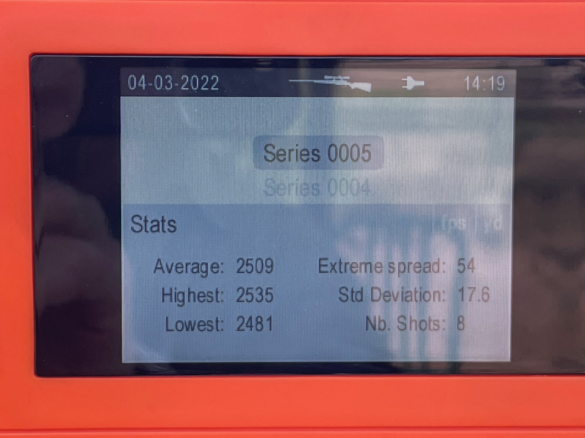

It seems lever evolution does not like to be compressed. Up to about 29.0 grains it behaves as it should. However above that things start getting weird.
Velocities become inconsistent and actually drop going from 29.0 to 29.5.

I figured it out.
My dumb ass forgot to trim. My cases were .010" too long. That'll cause weird pressure issues quick.
