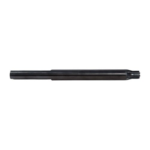

Too bad I don’t have a mill. I would make my large and small frame wheeler, steel action rods into complete barrel spuds.
Why not just buy the Geissele small and large from reaction rods that many of us have been using for god knows how many years? They are built to last forever. I have many 100s of builds on each of mine...
These can be had for even cheaper multiple times per year during sales. Black Friday being the next one most likely..
"The rod is cut from a solid bar of 4140 Chrome Moly steel, properly quenched/tempered and ground to an exact diameter that is smooth and straight so the rod will enter an upper receiver without wobble."

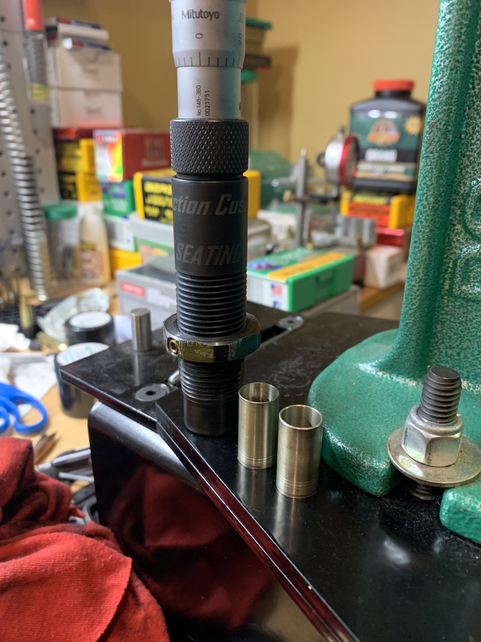

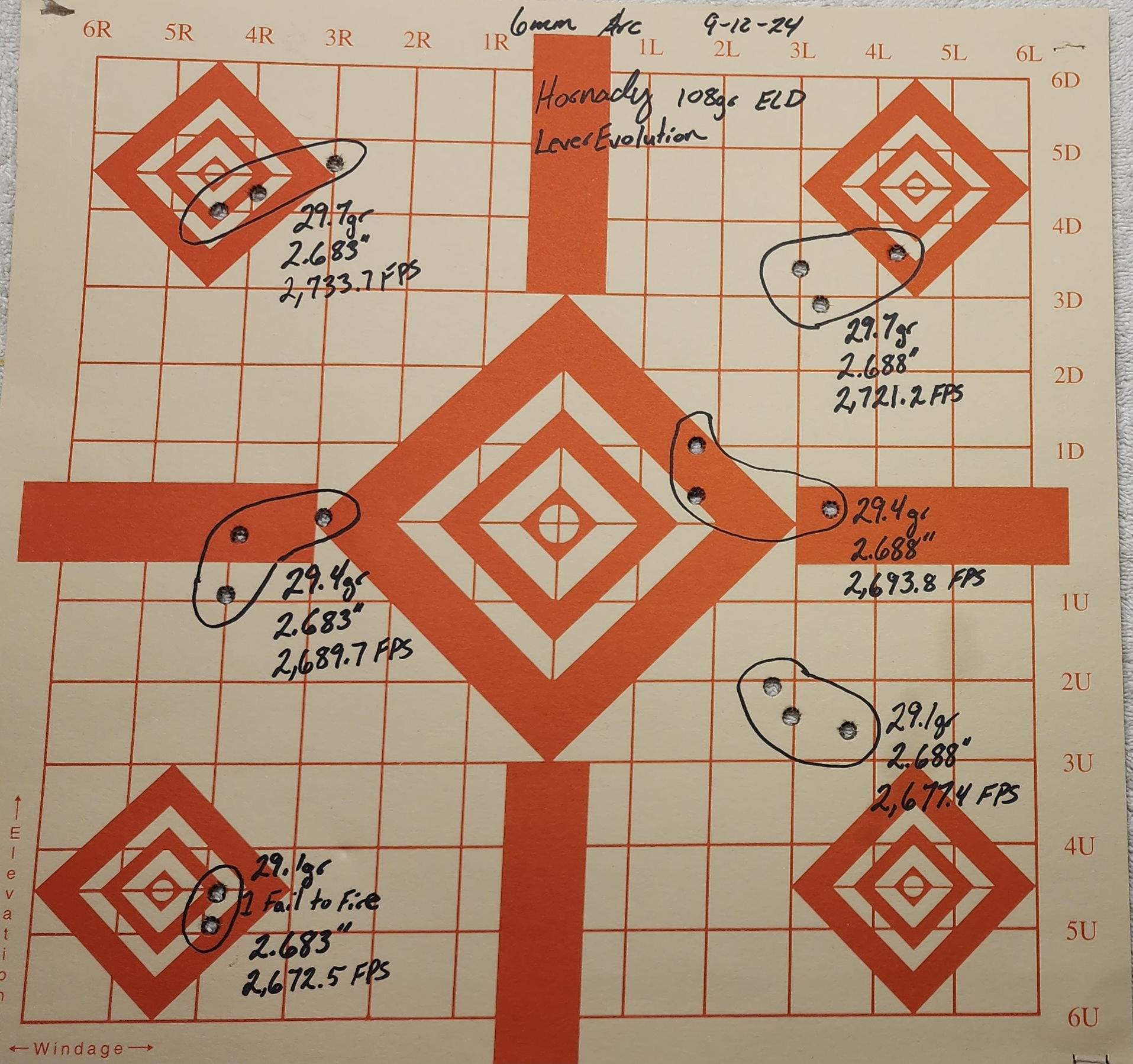

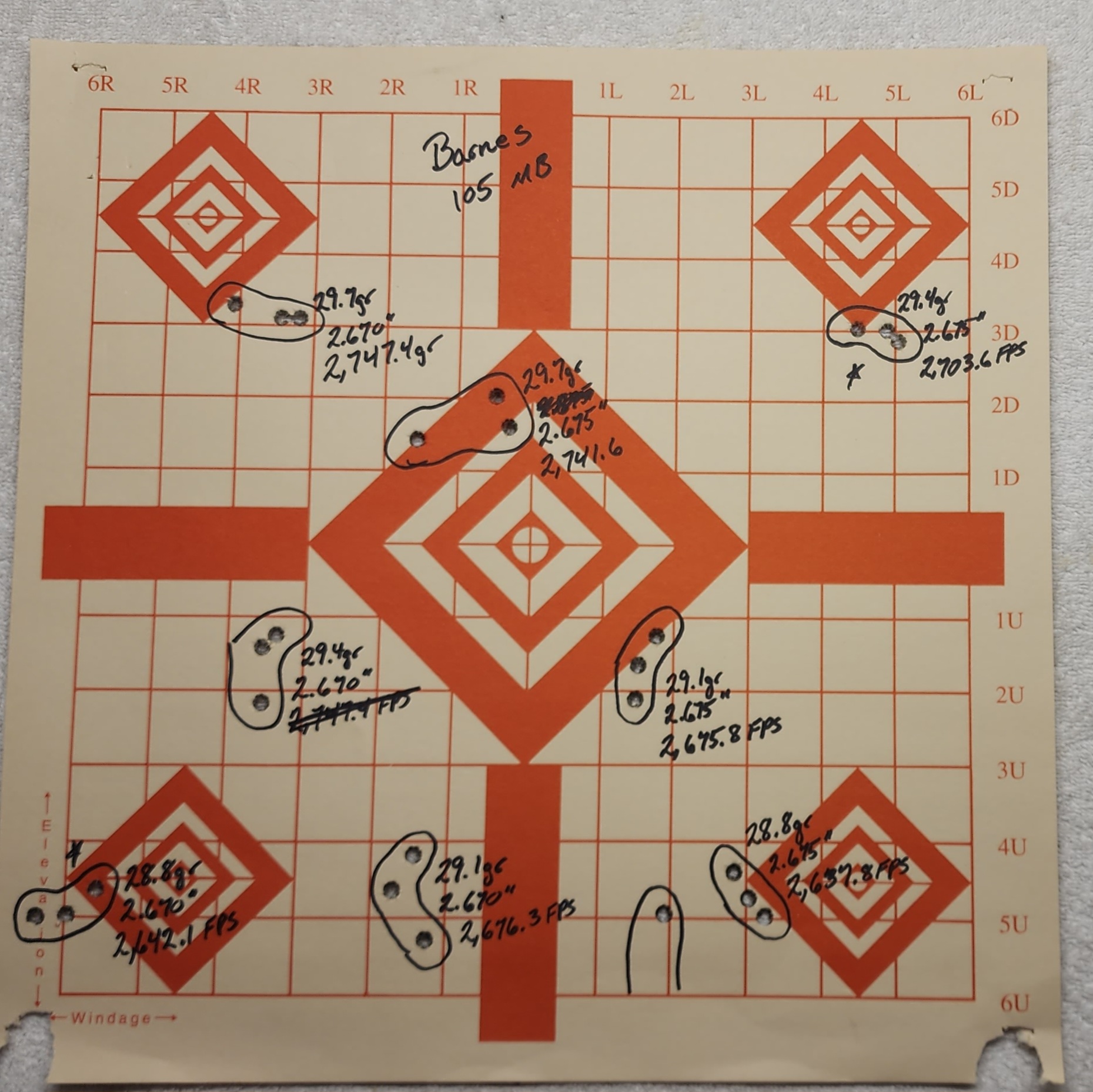

Here's the results from my loads testing seating depth. I had one round failed to fire probably due to no powder, and I had one instance of the gun doubling and it threw the shot up onto the next page. Not sure if it was trigger rest issue or if I managed to bump fire the round. But regardless the hornday 108's and berger 108 elite hunters just don't want to shot. The hornday 75gr vmax did ok but velocities felt kinda low. The barnes 105 match burners still did really well especially the 29.4gr load with an 1.5 es, and .6 std! I'm gonna play with the 105 match burners some more in a week. As for the horndays and bergers I don't know why they just won't shoot. Maybe it the crimp, maybe it's the dies but something isn't right. I also had a hell of time getting a consistent seating dept with them, plus they had rings on the projectiles from the seating stem. I'm just kind of at a loss on those.
Padom, I've been doing some reading on other dies and I'm curious why you didn't run the mighty armory sizing die for the 6mm arc?
FWIW I use the Short Action Customs seater. Made two bushings that taper lock into the very bottom edge of the die. One is 6ARC & the other is .224V, works excellent.
The sleeve length just engages the spring loaded sliding sleeve in the SAC die by .010, so to remove it you just push a case in & slip your finger off the side SAC spring sleeve gives it a snap and it pops right out.
Edit: the 2 stems with this seater have seated everything I’ve ever tried without damage.

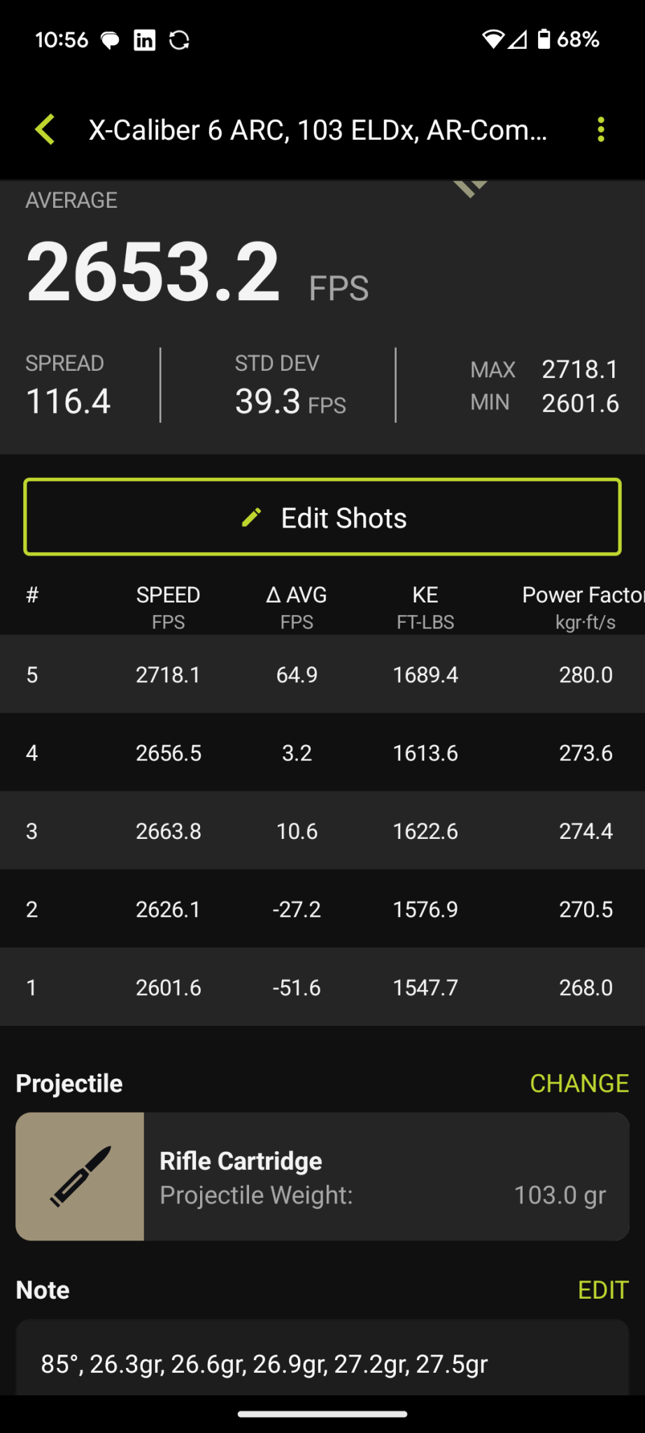

Has any one tried AR-Comp much in their ARC? I realize it's faster than optimal, but I shot this spread to check for velocity last time out, and it wasn't bad. The case heads were pristine, and I usually have a little ejector marking on my brass from my standard LVR loads suppressed, although that admittedly is from timing since I have it gassed in bleed off mode to run suppressed and unsuppressed. I think 26.6 is probably getting over ARC pressure but I may load up 26.3 and 26.6 to see how they group.
Velocity spread and my normal load same day in the 18" for comparison.
It's my go to powder with 85's. Stupid accurate and great speed. Read back a few pages to see my targets and data

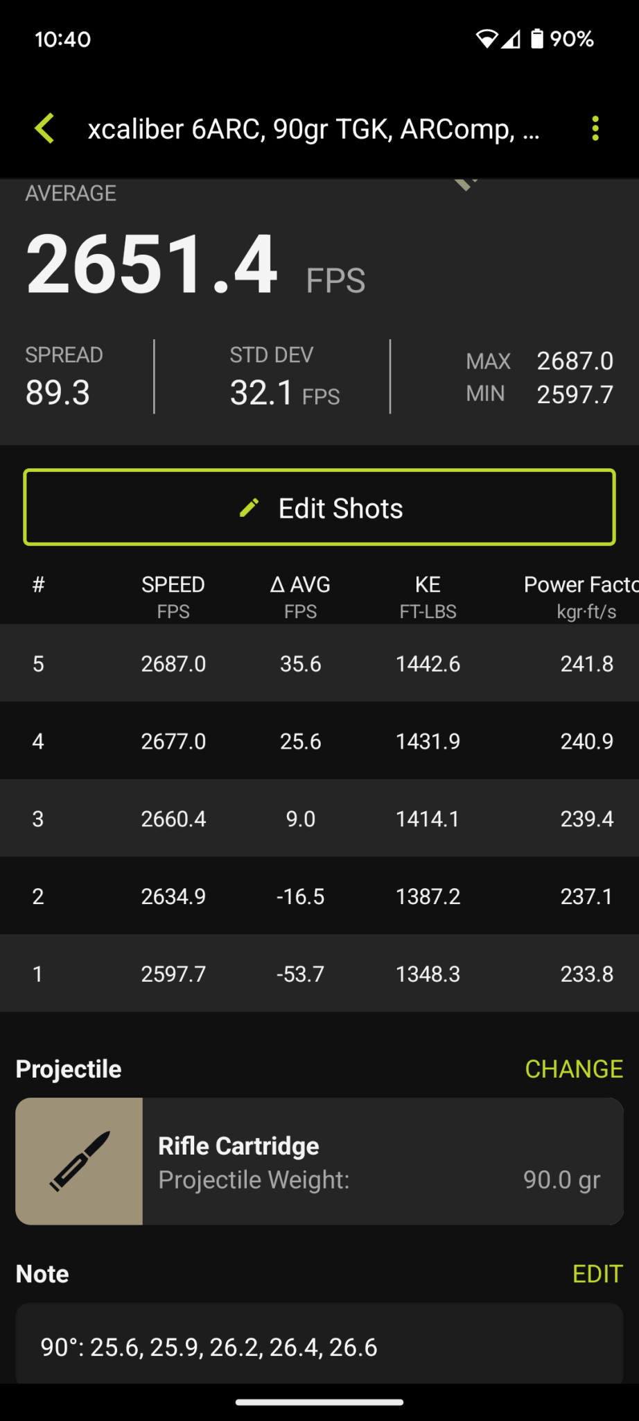

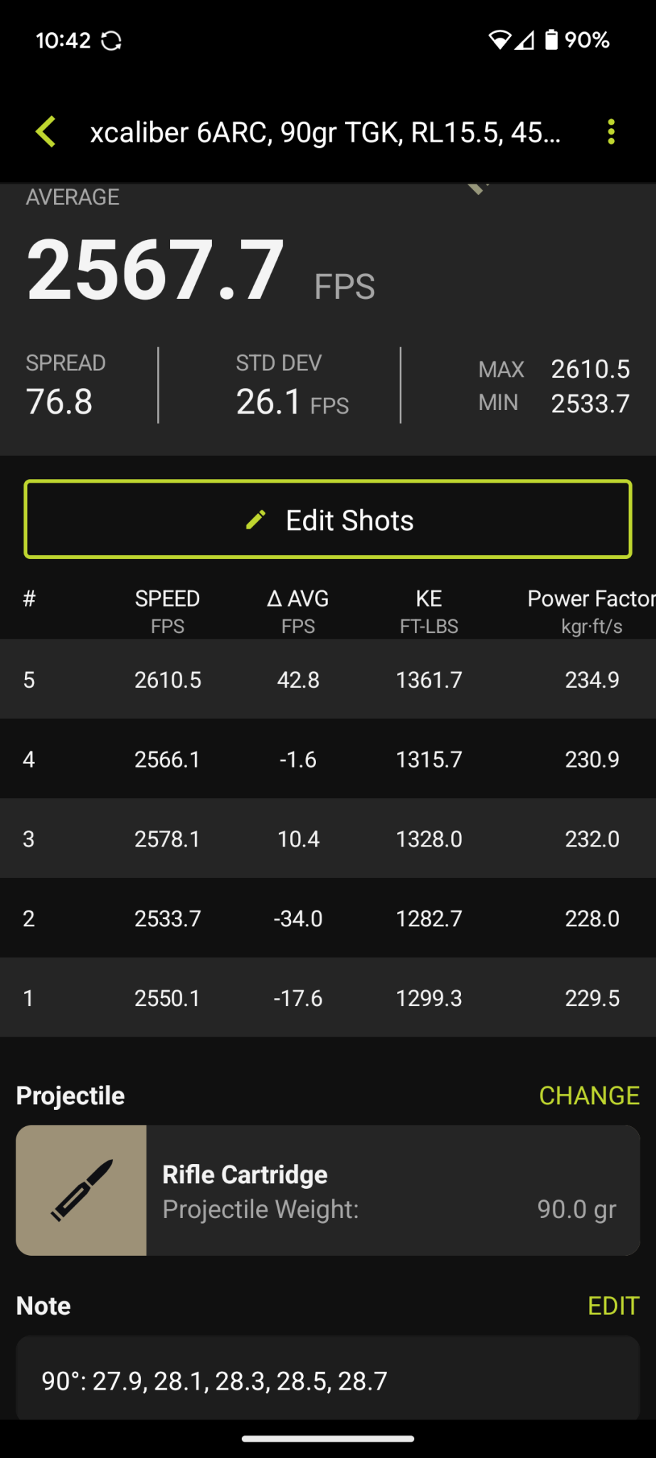

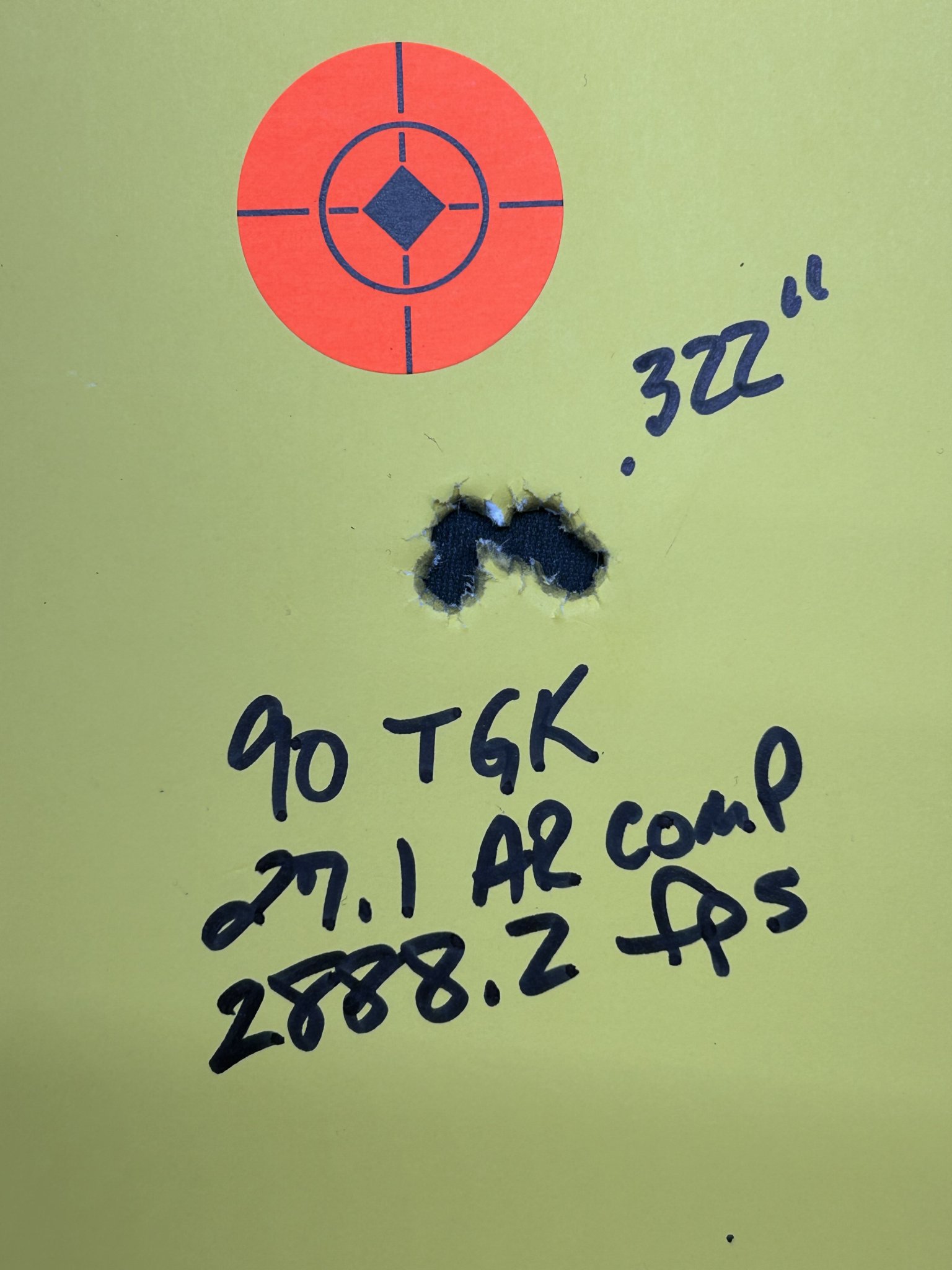

I found a load with AR Comp and 90 TGK that shoots tiny groups at 2890 from a 22" barrel. It's my favorite powder for Grendel and 77s in 223.
It was my main powder in my Grendel and I also use it in .308. I have some 90gr TGKs laying around, curious what your load is?
I shot these spreads with AR-Comp and RL15.5 a while ago, but haven't worked up a load with either, probably stopped a bit low with the AR-Comp.

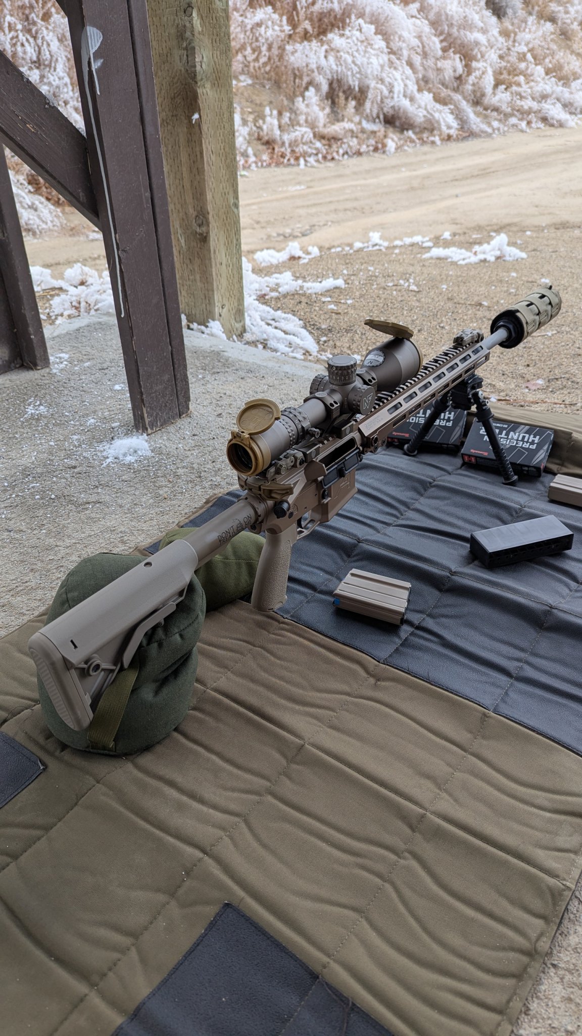

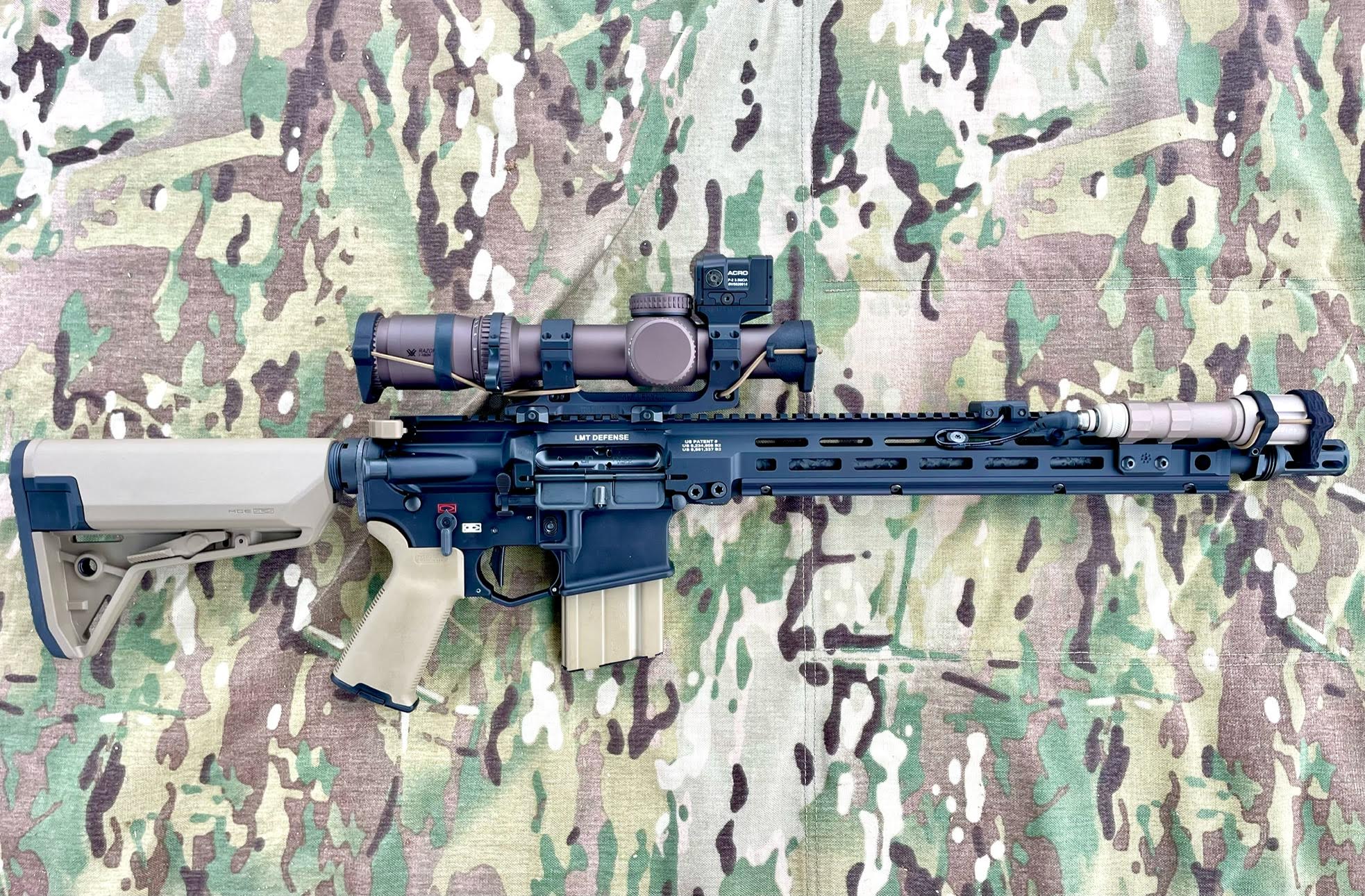

14.5" 6 ARC with factory loaded Hornady 108 ELD-M's. The shot was at 130 yards, liquified the heart then deflected off of a rib on the backside into the shoulder joint. He went 5-10 yards and dropped stone cold dead. It's a sample size of one at this point but color me impressed so far. For a low fence Texas Hill Country buck he's a solid harvest, 8 points and 103 lb carcass weight.
14.5" Proof Carbon Fiber barrel LMT converted by D. Wilson. 100 rounds down the tube, unsuppressed (HuxWrx Flow 6K in jail) shooting Hornady factory loaded 108 ELD-M's. I hope those numbers jump up with a few hundred more rounds down the tube and the addition of the suppressor as I was hoping to be around 2500fps. The final three round group was a banger.

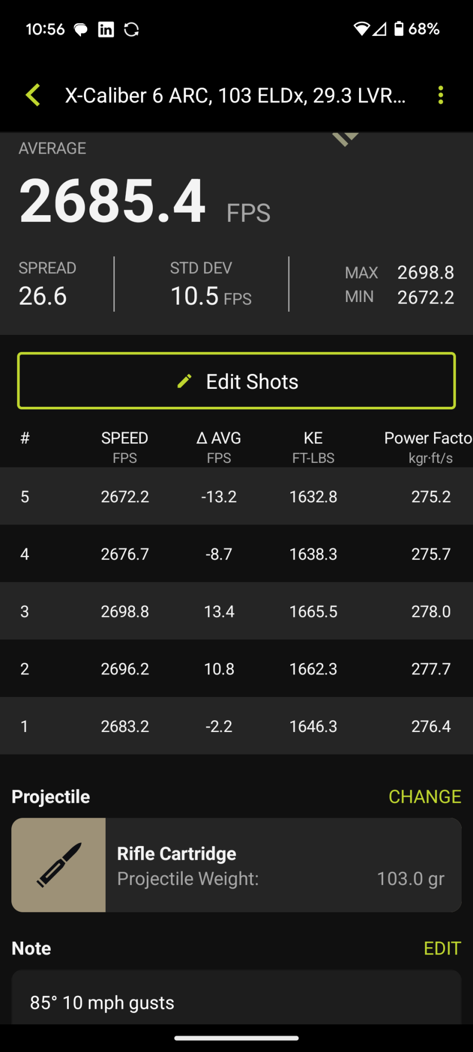

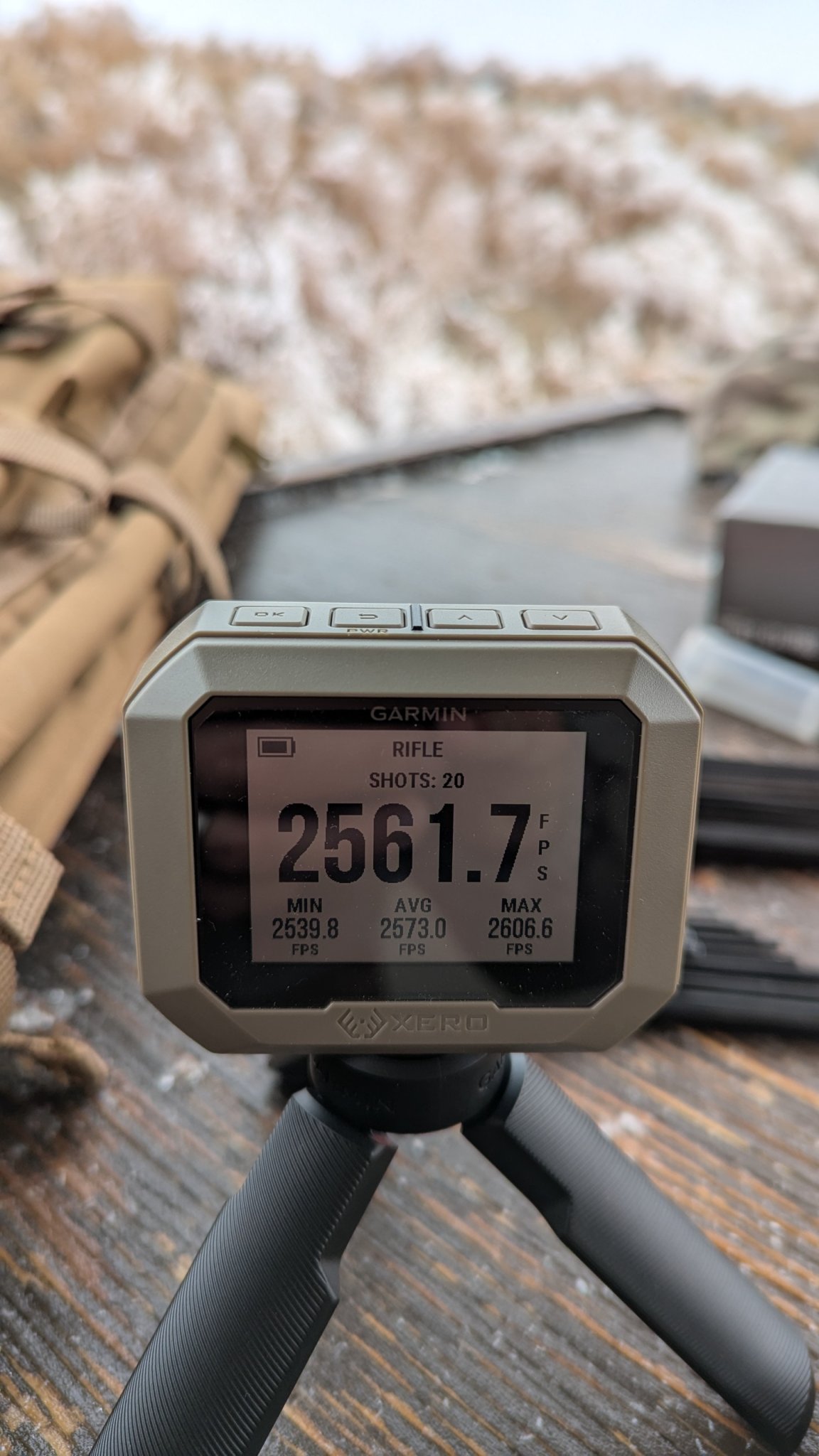

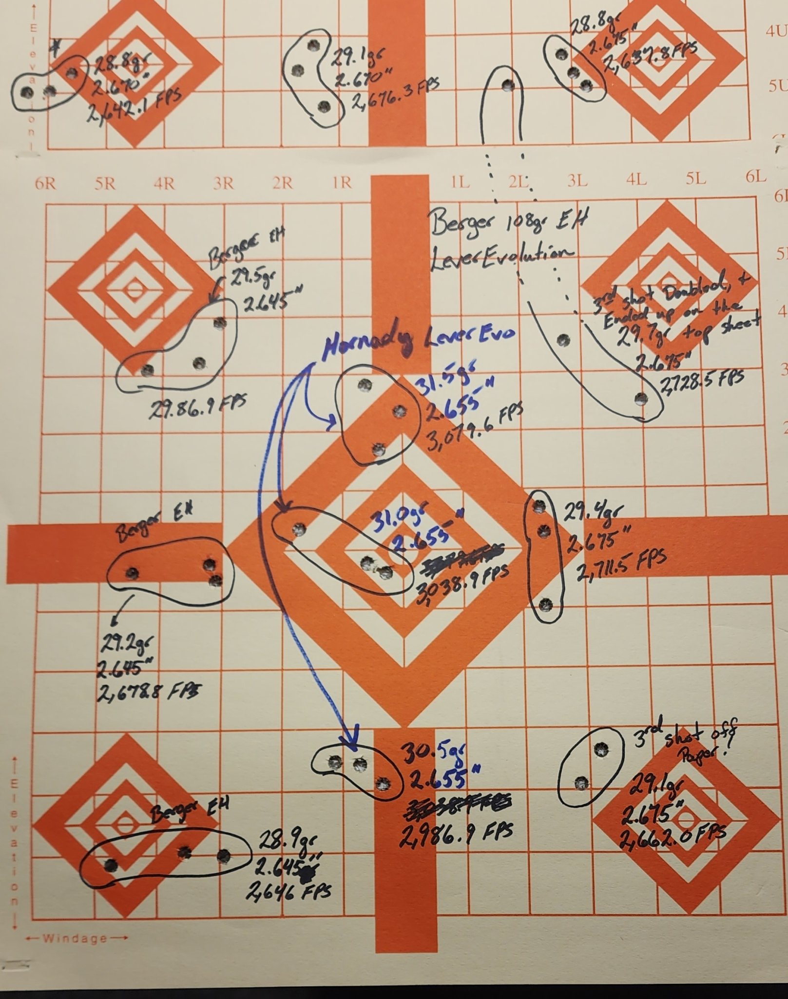

So what is the powder everyone seems to have settled on for the 108 grain loads? I am about ready to start loading for mine. I finally have depleted the factory ammo I bought for barrel break in and learning the platform a little more. I see AR comp for the 90ish grain loads. I am sitting on a full case of 108 ELDM to start load development.
With the factory Hornady 108 I am getting around 2670 for velocity with the 20" Proof barrel. If I can keep it around there I would be happy.
Broke in the home build today. 20rds of factory 103 ELDX Precision Hunter. Will debut during a late season doe hunt in Nebraska. Last 5 shot group was 0.78 at 100m. Hoping it will snug up as the barrel is broken in. Barrel is a Noveske SPR, 18".
Temp: 28F
Alt: 2,231ft
Baro: 29.89 and falling
Humidity: 89%
Dew: 30F
Wind, left to right 5mph
I'm doing 26.5 grains of Varget under a 108. That nets me 2430fps from a 16" proof. Very consistent. I've had single digit SDs either 30+ rounds.
I've tried 28.3 CFE 223 and get 2500fps from the same barrel but SDs are usually in mid to high teens.
Varget/cfe is 2480/2540 in my 18" proof respectively.
If min maxing velocity isn't your goal, I'd give Varget a try.

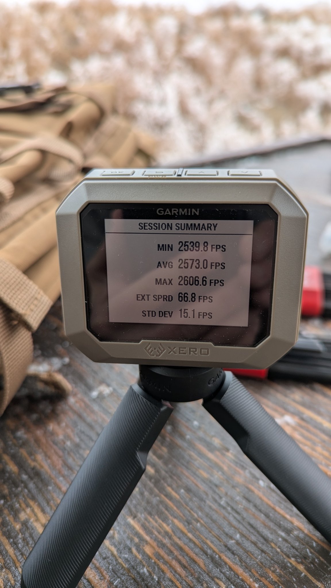

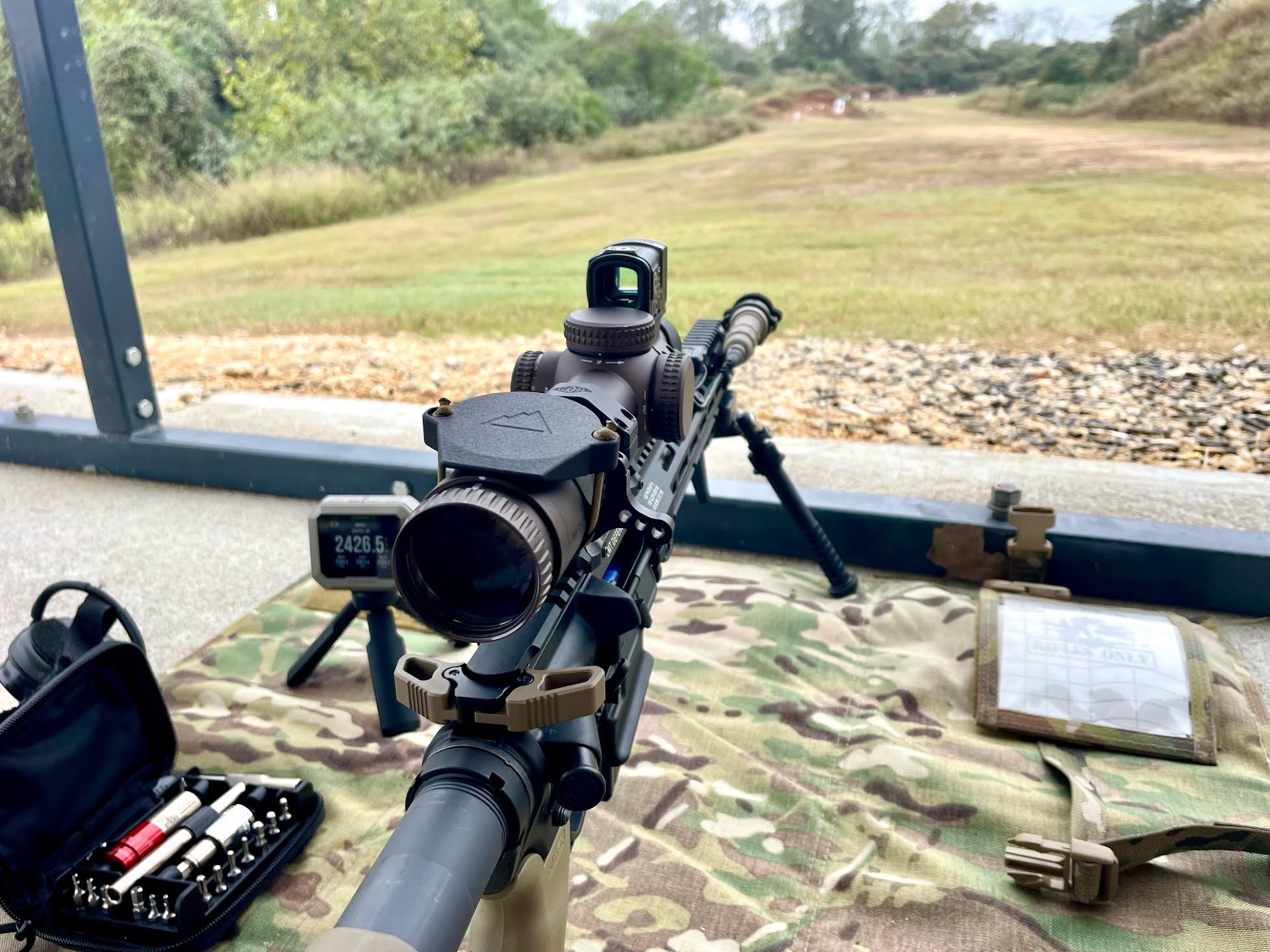

I ran Hornady factory loaded 80 ELD-VT, 103 ELD-X, 105 BTHP and 108 ELD-M at 100 today to get velocity and group numbers from my 14.5" Proof CF. The 108's are still slower than I'd like to see at 2450, the 105's averaged 2510, 103's saw 2555 and the 80's came out to 2740. The group on the 108's was 3/4", the 105's were 1.25", the 103's came in just under 1" and the 80's were horrid at 2". I left my rear bag at home so it might have played a role in some of the groups but it was still in the prone with a bipod and well supported at the rear.
