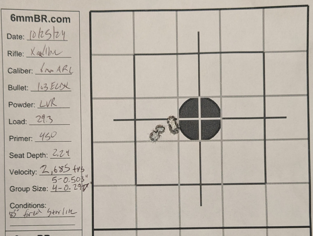

As a reference for LVR, here is what some of my load workups looked like in my 18" X-Caliber.

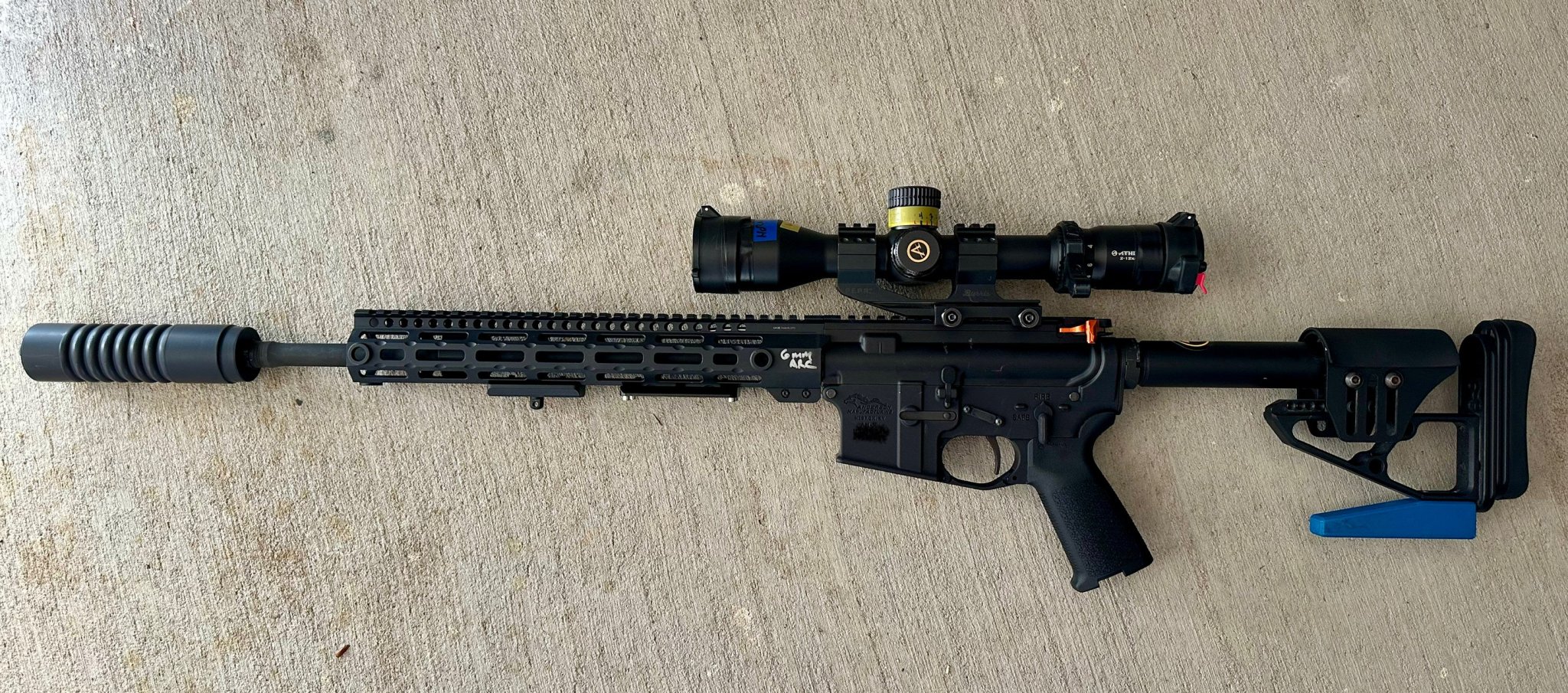

Haven’t had this anywhere but the range, but have it dialed in with 105 BTHP handloads and gassed right with the can.
Looking forward to bloodying it later this year.
Faxon Gunner 16”, AB Warthog 308 can. Timney trigger and Athlon 2-12 scope. The rest are
parts from other abandoned projects.
Balances nicely being held or on the tripod.

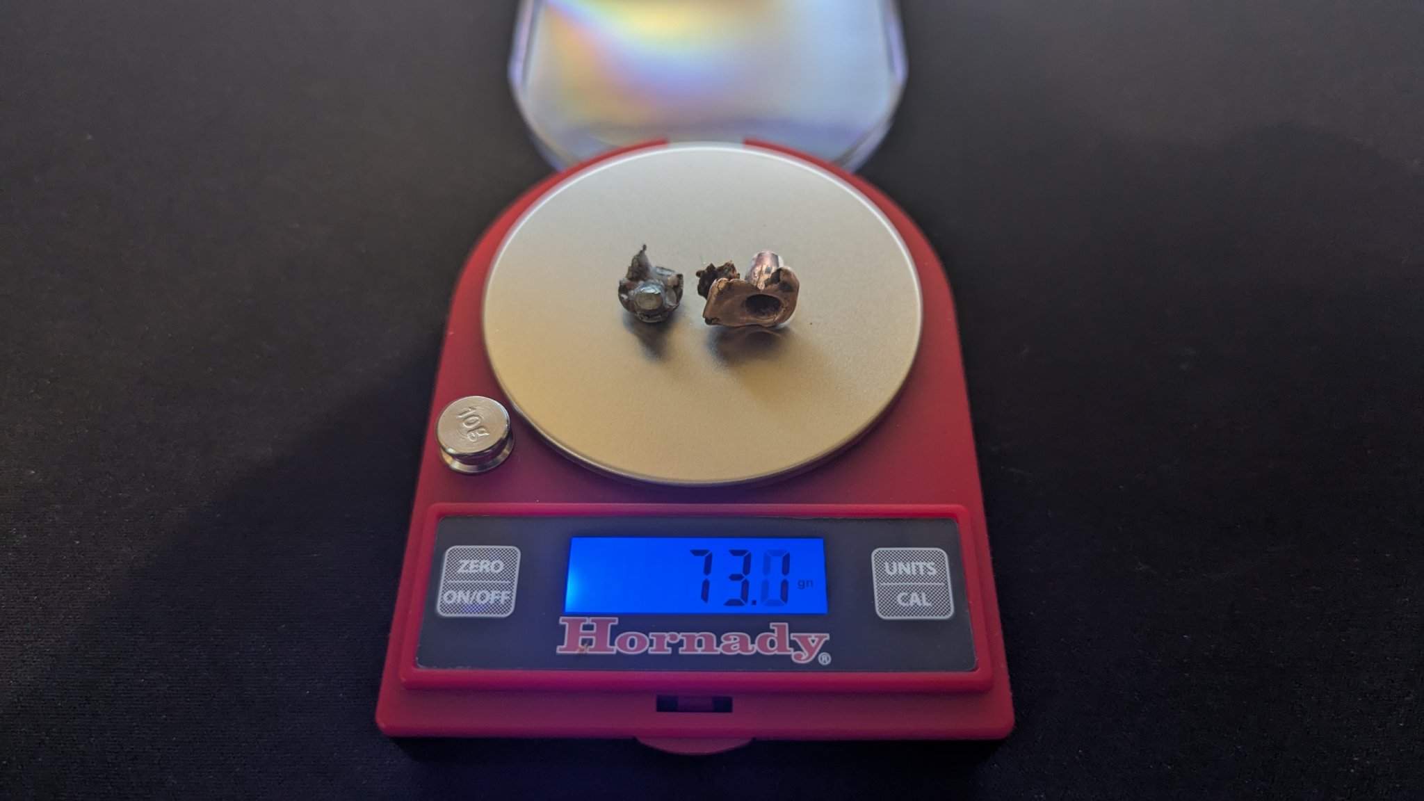

Late season antlerless whitetail Nebraska hunt was a success. Tagged out and the 6ARC performed well. Very cold temps the first two mornings, -9F, so the deer were bedded down in the cedars and holding very tight. Specifics are below but both rounds were recovered just shy of hide on the other side of the animal. No bone was struck that we could see. Very light recoiling platform and a lot of fun. We dispatched a few coyotes as well (way too many out there this year) and deer numbers seem to be down compared to previous years.

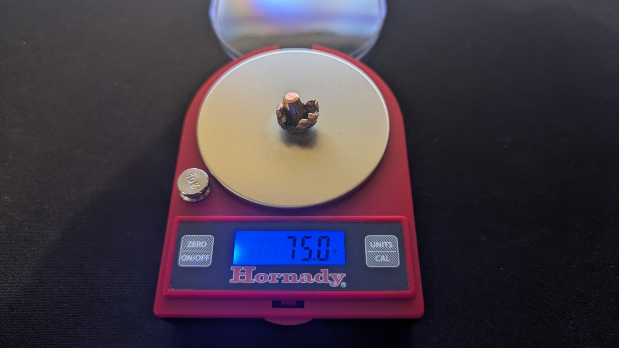

Doe 1 shot at 117 yards broadside, vitals. Round 1 recovered below. Factory Hornady Precision Hunter 103 ELD-X met target at 2,357 fps and 1,270 ft lbs of energy. Recovered round weighed in at 73.1 gn with core/jacket separation. Walked 10 yards and expired.
Doe 2 shot at 187 yards broadside, vitals. Round 2 recovered below. Factory Hornady Precision Hunter 103 ELD-X met target at 2,236 fps and 1,143 ft lbs of energy. Recovered round was intact, nicely mushroomed, and weighed in at 75 gn. Walked about 20 yards and expired.
Round 1 recovered
Round 2 recovered
Round 1 recovered
Round 2 recovered
Great feedback with the recovered rounds and retained weight.

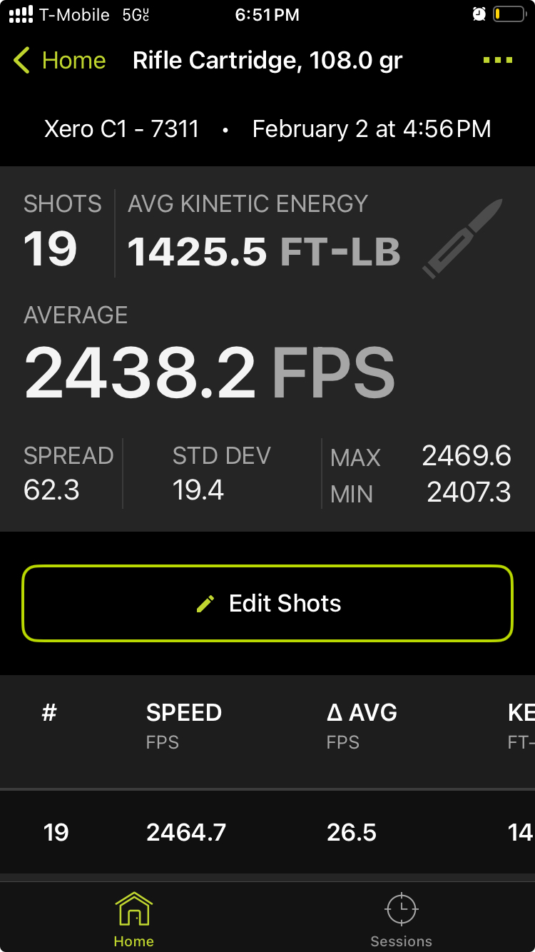

Seekins 18” Proof CF 1:7.5 (barrel was new)
Garmin Xero
Hornady Black 105gr BTHP
2942, 2527, 2532, 2521, 2546
2530, 2535, 2552, 2533, 2547
SD 16 ES 59 1.2”
Hornady 106gr TAP
2596, 2587, 2583, 2592, 2599
2604, 2584, 2592, 2597, 2605
Hornady 108 ELDM Factory
2483, 2500, 2493, 2491, 2526
2495, 2477, 2513, 2485 SD 12.5 ES 39.7
Hornady 106gr TAP
SD 7.5 ES 22.6 2”
Berger 108 Elite Hunter
29.3 LVR
2640ish for comparison
