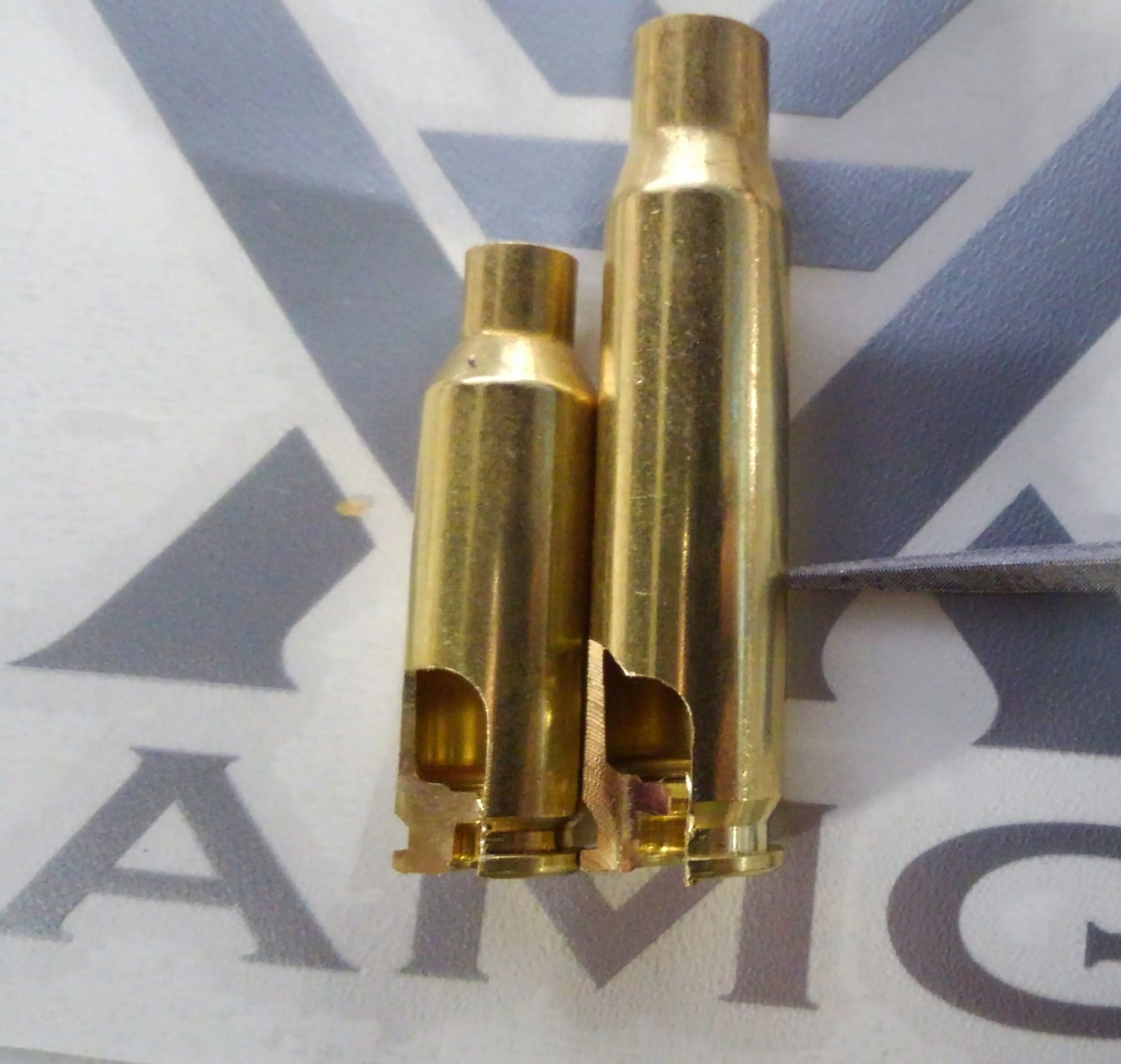

I don’t see 9310 as that significant of an upgrade to 158. I was thinking more along the lines of more aermet series. I think LMT used to make 7.62x39 bolts out of that.

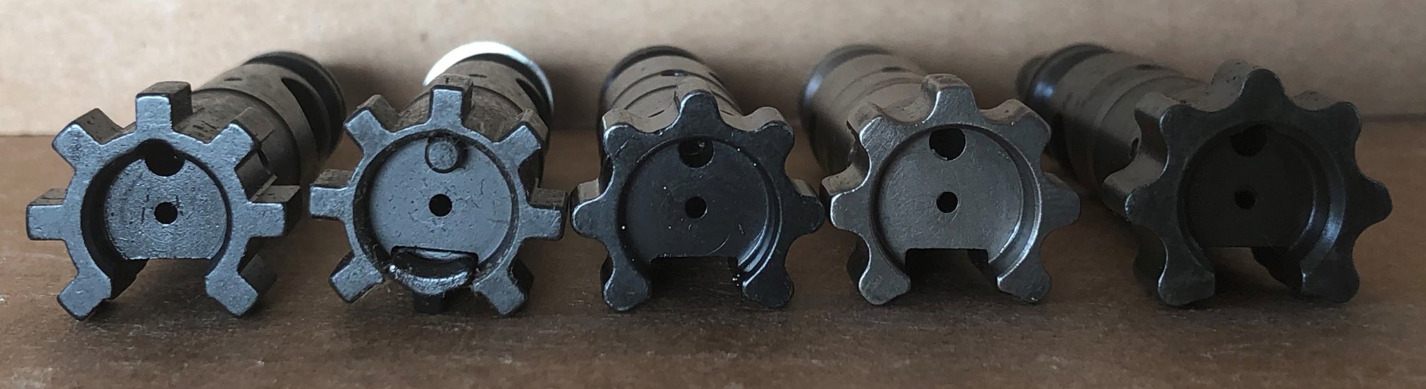

one on left is like all bolts on the market including JPs, mil spec square lugs. 2nd is superbolt, Titan, 750XD and 800 series. The 800 series was made first(2007) so I could chamber the 6BRX(.473). 750XD(2013) was second (.473, .442, .421 cases), Titan(2015) was the last version because the long ogives of the .224 and 6mm bullets were laying too low in the barrel extension lugs to enter the chamber correctly.
Grendel/ARC brass can barely hold up to 52000psi. It will be interesting to see what that ammo does in 120* temps.
That's incorrect. I've run the stuff to 60ksi in my Cz. Verified in a SAAMI pressure barrel cut with the same reamer. I have also shot 110's with no real detriment. It's about as heavy as a guy would ever want to go for the case capacity, but far from being unreasonable. Better than trying to push 130gr class pills in the Grendel.
We've talked about that picture before (belts). IIRC you never physically handled the particular barrel and by pixel-estimating lengths I'm fairly certain there was a machining goof to produce those belts.

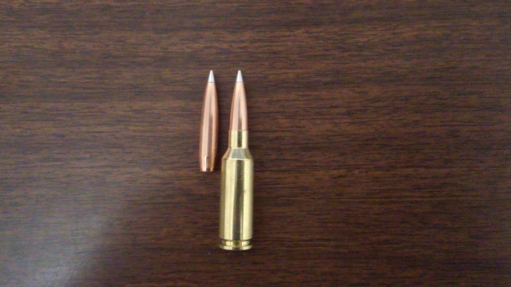

110 in the ARC @ AR15 mag length:
I've got the benefit of having a 2.33" or so magazine in the CZ. Anyone running it in an AICS kit/mag will have 2.50.
Nice! Did not know these existed. I assume you have to use a proprietary extension? Similar to the KAC E3 bolt?
Have you ever noticed the chamfer at the breech of all AR15 barrels? Did this guy have a goof?
Yes, The 800 series and 750 XD used the same extension but the newer Titan extension is different. The 750xd and 800 series bolts are a lot larger than the KAC. I would guess the Titan bolt is .010 larger in major diameter than the KAC.

The Titan bolts have a .124 recess. I designed the extension so a normal mil spec bolt could be used with them if it was an emergency , so that means a 7.62x39 bolt. You can see how that may be a problem with all other ARC barrels using a .136 recess type 2 bolt. I'm sorry I have no idea what I'll do yet. I've been making 6mmARs/243LBCs/6mm Predators and Banshees since 2007 and now we have something just a little different.
No sweat, it came back to me a couple minutes ago of the recess difference between the two but you had already replied before I could edit my post. Multiple ways to skin a cat

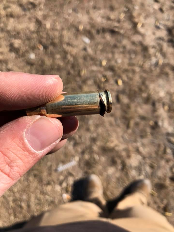

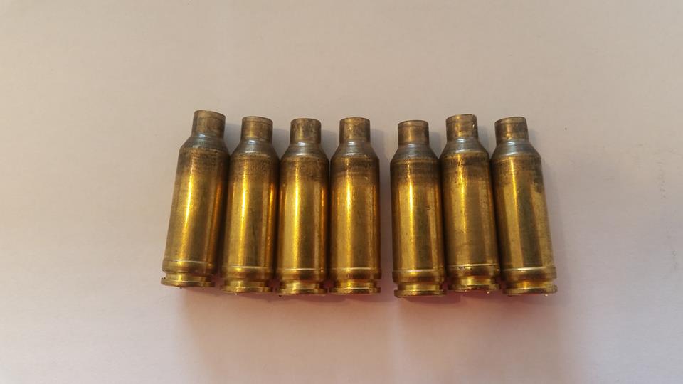

Does it appear the belts are being caused by the dies or by firing where that portion of the case is unsupported?
After a few firings of Hornady brass, I'm getting a smidge of that belt on my cases. I don't remember seeing it when I ran AA and Lapua brass (same thing I know). But, that was a different rifle too. It was a Satern barrel/extension and bolt.

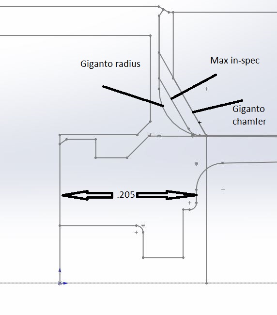

It is caused by being unsupported, the chamfer at the breech. Since 2007 the 6mm stuffed in a Grendel case has always been a wildcat, there were no loads printed so we had to work up loads and in doing that some are going to be high pressure I mean you don't know what is high pressure until you get there. Most other cases, 5.56, 308 etc will show flat primers first or ejector swipes but with these thin cases you may get that belt or even a rupture before the primers flatten and flat primers is usually the big sign to back off. I've been a wildcatter since 1982 and in all of those years I have only had 4 case rupture when developing loads, 2 of those were from a 6mm in a Grendel case in an AR. The first was using H4895 with a 95gr SMK bullet. Now that this thing has been SAAMIed and there will be many more people working up loads there will be many more belted magnum photos popping up. I suggest measuring the diameter of the bases just above the groove as a pressure indicator instead of waiting for the primers to show signs.
Here's the loosest in-spec fit you can get.
The vertical line is where the belt is showing on the cases pictured above based on pixel count vs. 'known' diameter. I tend to think the breech face or chamfer is generous on the barrels producing that. Even when I was blowing primers on the Wolf Gold grendel brass (large rifle pocket) I never got a belt. That brass was the thinnest softest crap ever.
It's whatever. Obviously it happened, but I don't think it's fair to say it's a systemic issue with PPC-based cartridges. I'm more inclined to believe it's a manufacturing error on the barrel side. Again, without knowing what the dimensions are of the parts that produced that, the pictures are near meaningless as far as determining the root cause. If you posted pictures like that of 5.56 brass (I've seen those, too) I suspect the immediate response would be "Out of spec barrel".

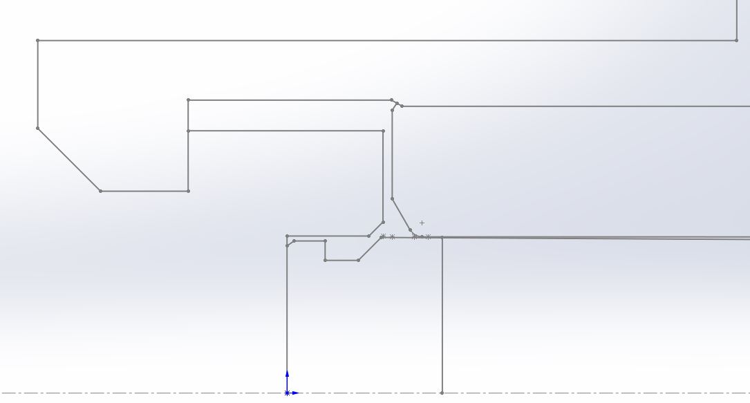

you know the rim on a Grendel case is around .050 thick right? And you drew the chamfer how big? Some barrels makers use a flat angle like you have drawn but better companies use a radius chamfer. I think if you ever get you hands on an AR barrel and measure the chamfer you will see that most are not what you think they are. Bolt guns don't need much of a chamfer.
Next instead of guessing why don't you section a Grendel case and measure the thickness of the brass in that area and then do the same with a 5.56, 308 and 6.8 related to the base of the case . The section photo above is pretty clear but I don't think you will understand until you measure it yourself.

This is a 6BRX(just a fuzz less capacity than a Dasher) Using 95gr SMKs in a 22" barrel at 3200fps. Quick function check after Robert Whitley said it would never work. It's been 10 years but seems like that was 34gr of N550.

Gotta love all the broken bolt talk when a grendel is brought up. Here's a novel idea, stop being so poor and spend an extra $75 and buy a spare bolt. They rarely ever break these days. And for God sakes if you're worried about getting belts on your cases, it means YOU made the ammo too hot, not that it's some sort of design flaw.
What about this guy?
Like I've mentioned before when you posted these pics in previous 6mmGR threads, I've never had that bulging happen before??!!
That's after putting 1500 rounds of various loads in a 6mmART40 and 800-ish in a 6mmFatRat. My loads were/are, not light, I'd consider them medium heavy.
I don't know which bolt Whitley or Lee Wells used.
My Lapua cases have a slight ejector smear and primers are starting to get flat and velocities are/were, high. 2870 fps in a 22" Wilson 8 twist with 95 SMK in the FatRat and was in the same FPS region with 105 Amax in the 26" 8 twist 6mmART40.
There's no trick or magic to it, just don't push the pressures beyond what the "system" allows.
Oh, and both of these have the +2" gas port so that may be why I haven't had any problems???
Also I learned to stay with H-4895 which is temp stable.
Some of you seem a little sensitive about things I have said so IMO the 6mm version of the Grendel 6mm ARC or whatever is one of the best cartridges for AR15s for hunting varmints, long range shooting and PRS. IF Hornady makes their brass thicker at the bottom it could solve the bulging problems, If someone made a bigger stronger bolt they may last longer. If someone made a bigger magwel Magpul could make mags that would work with .442 diameter cases without modification. Get all that done and it would be perfect.
Case dimensions are to SAAMI spec. I hit the middle of the spec for rim thickness, .054". Chamfer is .550" major diameter @ 120 degree included angle. Regardless, even if I blow that major diameter out to .615 to account for the same width of chamfer (looking from the back) as a 5.56 a guy would have to push the breech face forward .025-.045 to get the chamfer intersection with the chamber in the same place as those belts in your pictures. Essentially .035-.055 clearance in front of the bolt, OR a .100" radius, or
Cross section is .039 vs. .047, 6 ARC vs. .308 on web thickness before the radius transition. Height is .205 (arc) vs. .215 (.308) head to the point that would fail.
I'm over this conversation. The chamfer/radius geometry and bolt nose clearances are EASY to make work with this case. If you cut the tennon an extra .025-050 short before screwing the extension on that's not the case's problem. I've seen AR-15's on the internet in 5.56 with the issue, and I know someone personally that fucked up the chamfer on an AR-10 .308 barrel and the resulting belts and/or blow-outs were not the cases' fault. No different with the Grendel/ARC.
You'll have to go find those 4 threads and tell those 4 guys why their cases are swelled, they sounded pretty worried.
Reactions: RanchRifle
