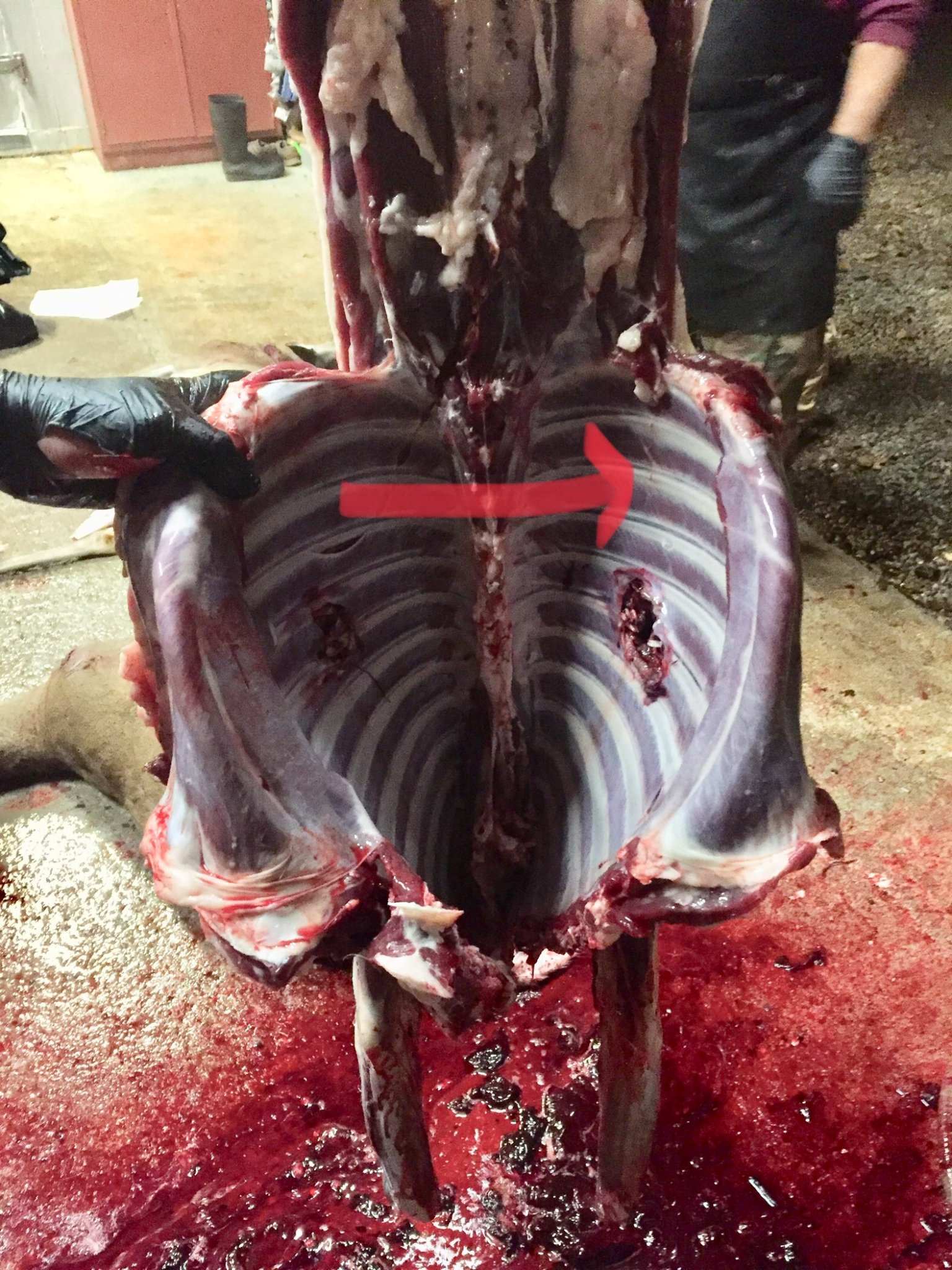

Hornady bullets do go splat nice once you hit something.
Yes they do...Hornady Black 123 grain ELD Match. Vaporized the lungs and the buck didn’t make it 30 yards.
Booyah. The 123gr Grendel’s effect on game is why I have two bolt guns in it now. Wonder how the 100+gr 6mms will compare; I’ve never used that bore size, let alone those specific bullet weights in that diameter, on an animal. Will be hard to top the 123gr 6.5s though.
