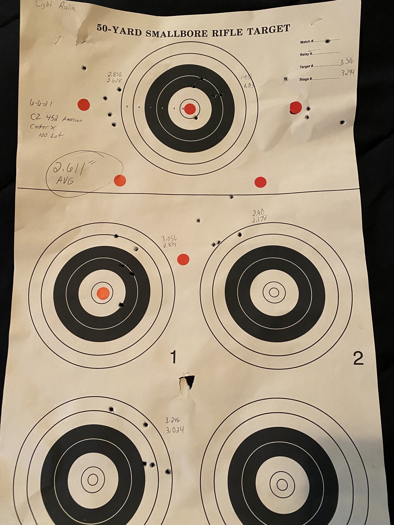

Since getting my RimX with a Green Mountain barrel I’ve shot maybe 6 bricks of Center X through it with there being 4 different lots out of that 6. They’ve shot anywhere from.2-.4” at 50yds. I’ve never lot tested or really seen the need for it with the old Center X. I switched to a new lot a couple months back and all I’ve done has been sight it in , get chrono numbers to plug into my Kestrel and off I’ve went. No clue what type of groups it’ll really shoot at 50-100yds. Only time I’ve shot 3-5 for a group is checking zero at a match. I’ve won two matches with this new lot so far, so it’s good enough for this game. Haven’t even had time to do a DSF yet due to work and weather. But it’s starting to sound like the new stuff might not be the same. Might be due to Lapua just trying to get stuff out since we all went into full panic mode after the election or could be new machines or new dies.

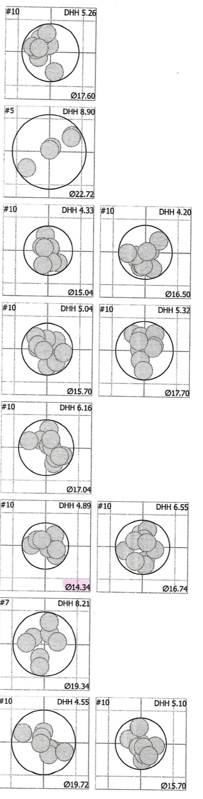

Finally got out to test the new box center x I bought recently. I could not tell any difference between new and old from 50-300 yards. I was scared as hell cuz I just bought 3 bricks at the inflated prices just so I could have some. Glad my vudoo likes the new cx at least this batch.
I've never had that happen G.
I believe you. Many lots will shoot well in many good barrels. But there's no guarantee that they will shoot well in all of them. In your case, the absence of evidence to the contrary doesn't prove that a lot that shoots well in one good rifle will shoot well in all good barrels.
If it it were so simple it would reduce the need for lot testing at testing facilities. Over the phone, technicians at Marengo or Mesa could advise shooters thinking about sending their rifles for testing to save time. "You want a good lot? This one shot well in a rifle yesterday. No need to send your rifle. Save time. We'll send you the last two cases."
Shot some more of it today. Rifle is 457 that has Bartlein w Eachus. My 2 lots each of SK+ and SK LRM continue to pile on one another. SK Rifle Match ( 2 lots), Eley Match, Eley Club nearly as good. I've spun tuner in a .250 range looking for positive consistency. Not getting it. One thing I've noticed is I get drastic deviation in horizontal plane. Looks just like drive band damage except it is just as likely to go left. Maybe even more so. 70 yards Almost zero wind.

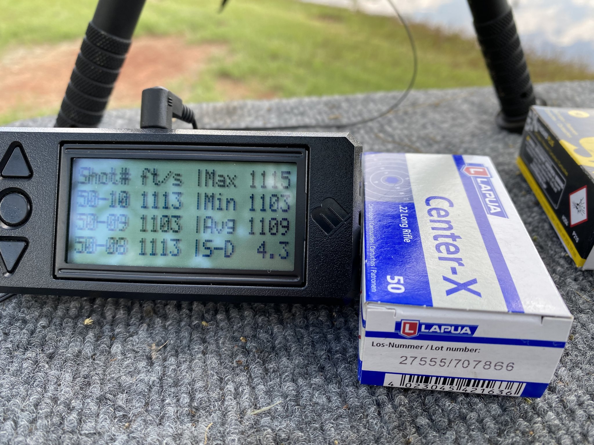

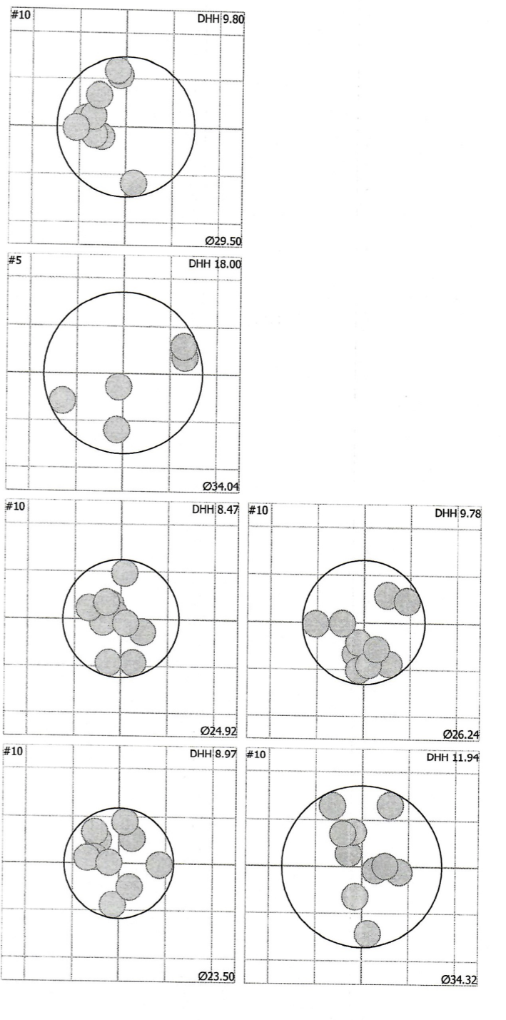

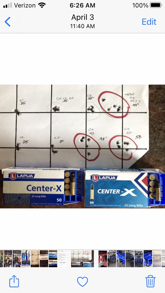

This is new lot tested Center X. It barely bested my best old box style, free range CX, but it did at 100 yards., not at 50 yards. This is 200 this morning.

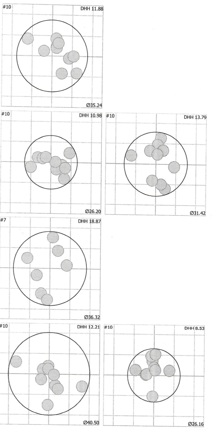

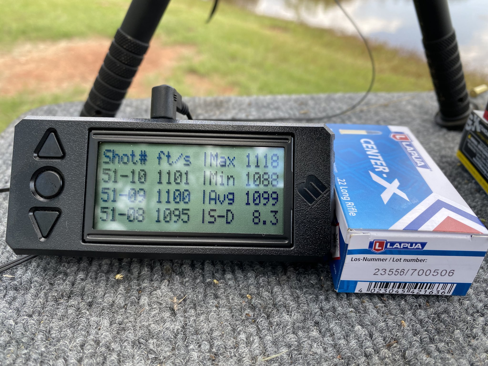

More food for thought on old vs new. Although both chrono readings are good, the old definitely has the edge. It was 93* today.
Ironically, both test revealed the highest velocities on the first shot. Wondering if I might have a carbon buildup starting.

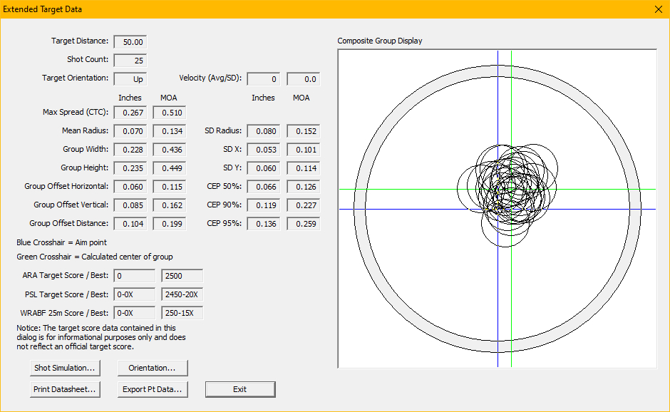

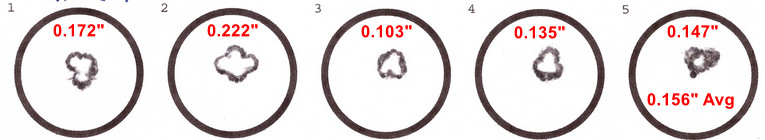

After waiting for what seems like forever, I finally found some new Lapua to test. Of the 8 lots total I received, there were 3 lots of Center X.
In my Phase 1 testing of the first 4 lots I tried there was just 1 lot of Center X and it produced the groups as well as the Virtual Composite of all 25 shots below.
Of the other 3 lots, 2 were Midas+ and 1 was X-Act. This lot of Center X had the best results for the 8 total Phase 1 tests, but there's a long way to go before I know if it progresses thru all 3 Phases of my testing.
Testing was conducted in my ballistic tunnel day before yesterday and if the weatherman's correct, testing will continue again in a couple of days.
