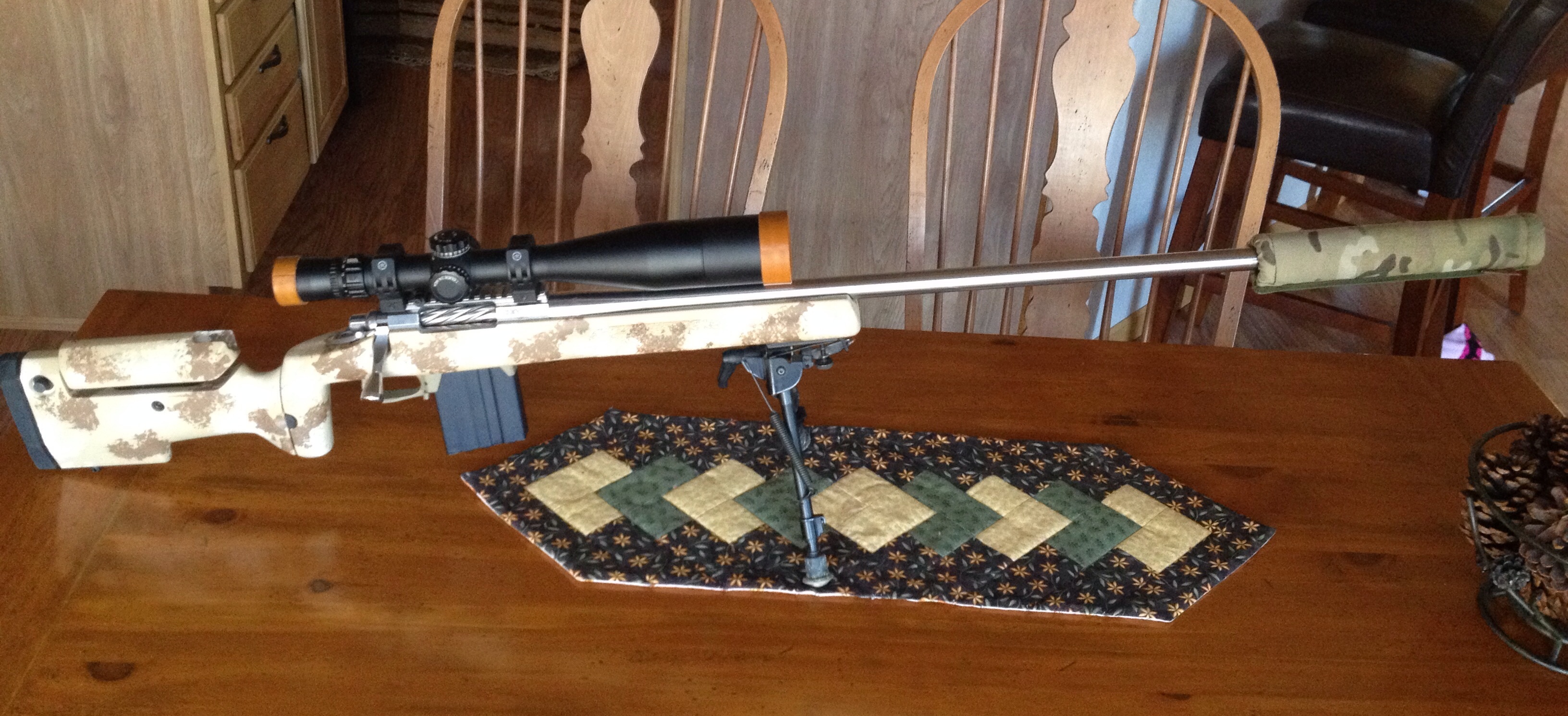

I was going to build another 6 but decided that this had some serious potential. Finished build a couple weeks ago,, tac rig on a deviant. Will post rifle pics later. I went through lots of combinations but finally found a tuned load. Here are some the final groups it was doing when trying to find the sweet spot. The 3 shot was the last group shot with a seating depth tweak to take the smidge of vertical out. More load info to come. This is out of a 27.5" 8.5 twist bartlein (med palma) and the hybrids are pointed and bn coated.
Went and ran my steel out to 700yds in a 15mph crosswind. Bang bang bang ding ding ding. It is definitely a wind cheating sob.

Smith work done by Eric Miller @ sage flats shooters,, Jordan MT. I do my own bedding. Defiance Deviant, Manners T4F, surgeon bm and 8.5 twist bartlein,, all topped with the 5-40 March. SRT XL Ti hangs on the end.
I have both alpha and accurate mags and the 6.5 saum has been running very smooth out of both.

This rifle/cartridge combo has already earned spot in the line up for this years match rifles.
