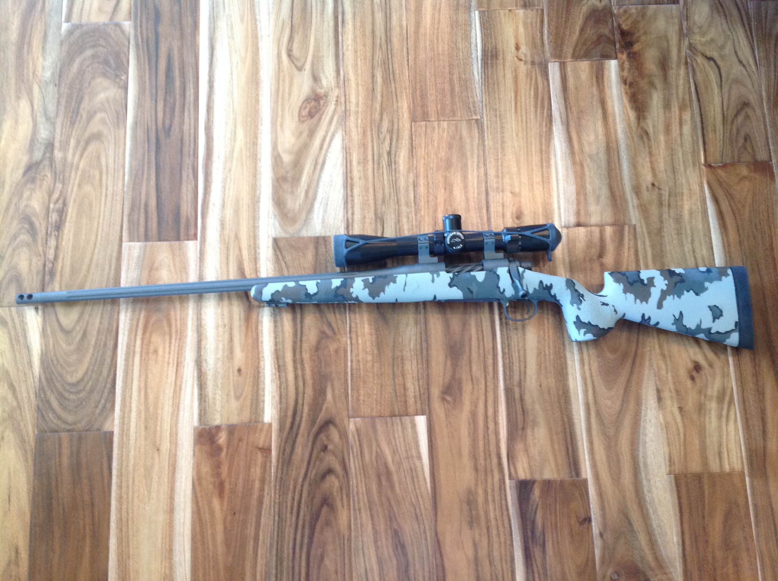

Just got this one back!
Specs
Pierce titanium Sa
24" #4 Brux 8.5 twist (ordered a #3 but was shipped a #4) I didn't notice when I dropped it off at the smith!
McMillan gamescout with edge package. Hydro dipped Kuiu Vias
Shilen trigger
Talley LW rings
Cerakoted charcoal (50/50 mix of two colors)
Huskemaw 4-16x42 scope
Weight as shown 7lbs 10 ounce, would have been 1/2 lb lighter with a #3 bbl. still a sweet carrying weight.
Smith work done by Cloud Peak Gunworks, bedding by me.

Nice looking lefty....really like that vias camo...

That is a great looking build. #4 Brux is the same as a #3 Bartlein other than the 1.250 shank. I was going to get a #3 but decided on a #4, for a little more diameter for the brake.

Where did you get the hydrodipping done? What did it cost?

Thats a really nice rifle!

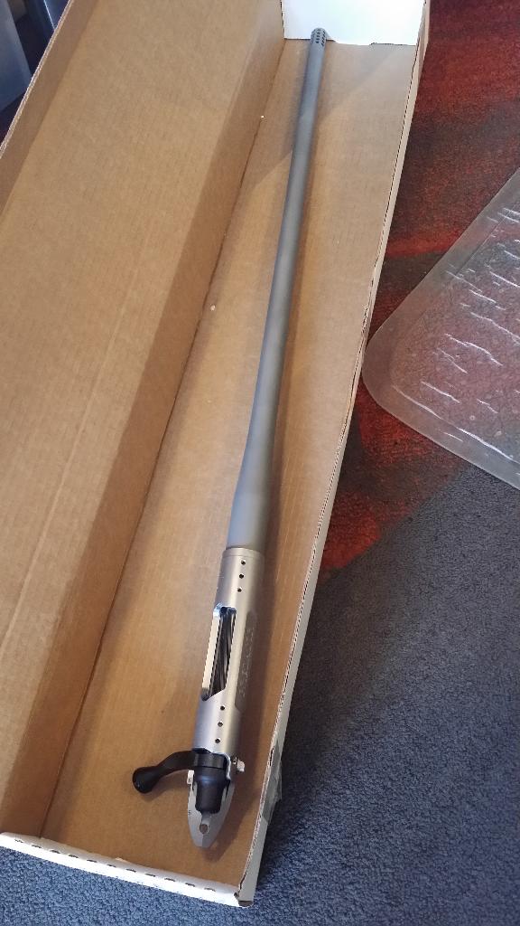

Well, fedex just dropped this off! Quick specs is GAP did the work. Its a stiller predator action, 6.5 4S of course, #3 Bartlien in the original specs, 24 inches, went with the vias. Looks so lonely in the box, I'll get it built up with proper photos and a range report. Pretty excited, and completely worthless at work at the moment!

Nice!! The bolt is even on the right side

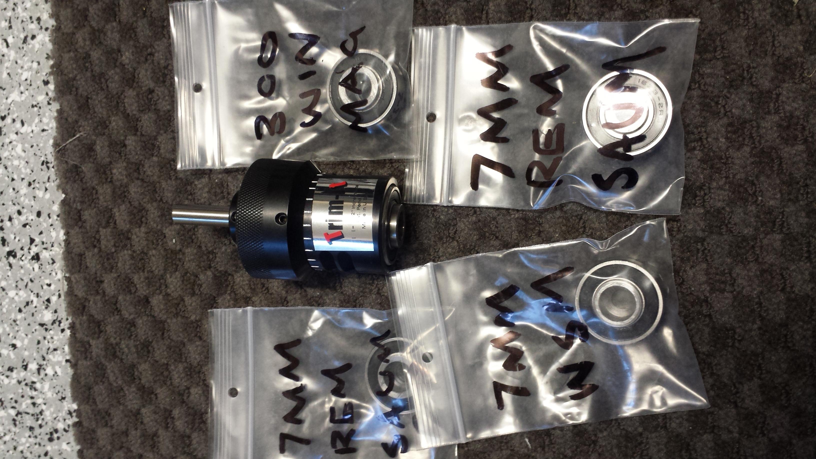

Does anyone have any feedback on the Whidden 6.5 SAUM die set?
Papa, I picked a set up....did some resizing and loading with my redding and whidden, then headed to range...rifle and targets did not seem to know the difference which die set was used...
Never used whidden before till now, but I like the dial on the whidden better for dialing in my coal, it's much smoother and seems like I can adjust seating depth a little better then the redding,,,I am no expert on loading but other then that, kinda of the same for me.
