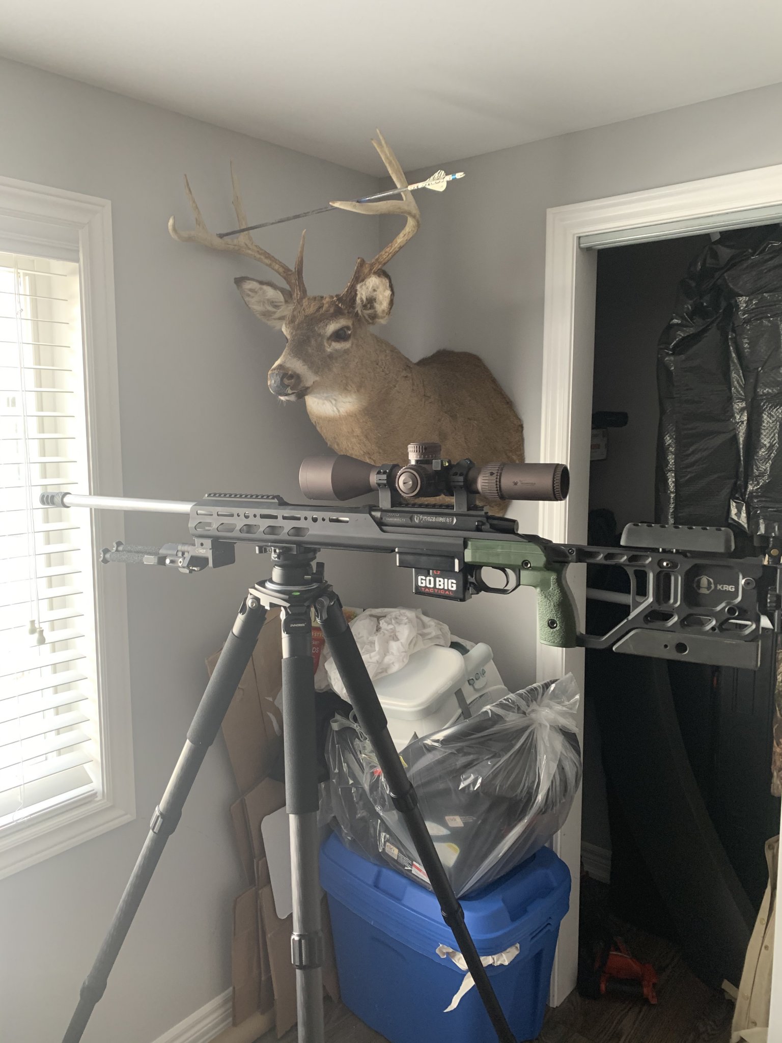

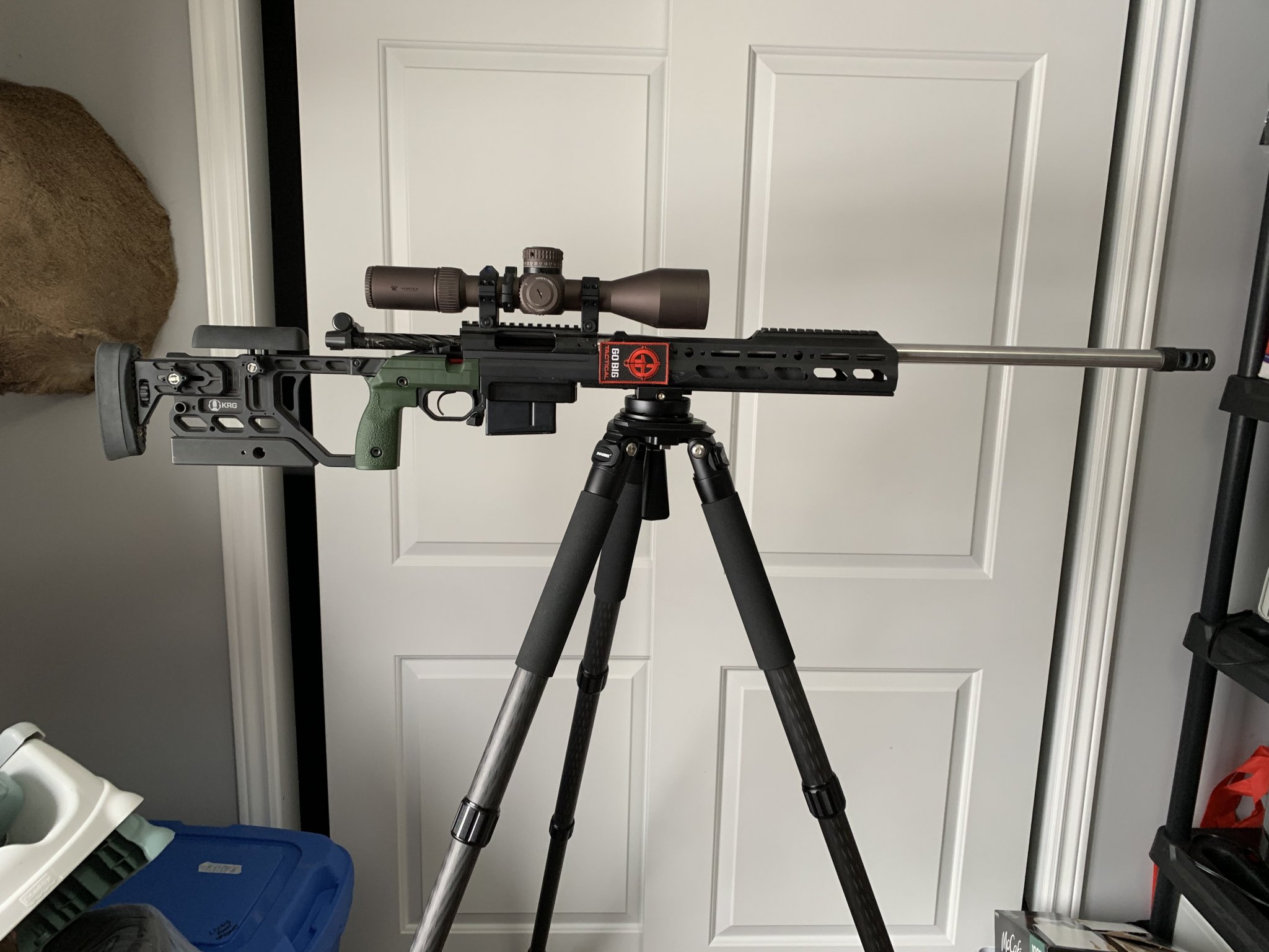

As far has chassis/stocks go. They are very personal preference. Looks, ergonomics, fit and everything. That said personally, I’ve shot and/or own mdt acc, krg bravo, krg whiskey 3, mpa ba comp, and a handful of stocks. As far as I’ve shot, the krg whiskey 3 stands out. The others are all excellent, but the krg just seems so perfect for me. A lot of nice features.
The terminus is fantastic. The quick change barrel feature, threaded trigger pins, the outstanding customer service is all excellent. Pair it up with a tt diamond and it’s awesome!

Yes you will be able to run both. I mainly run aics and arc mags in my terminus whiskey 3
