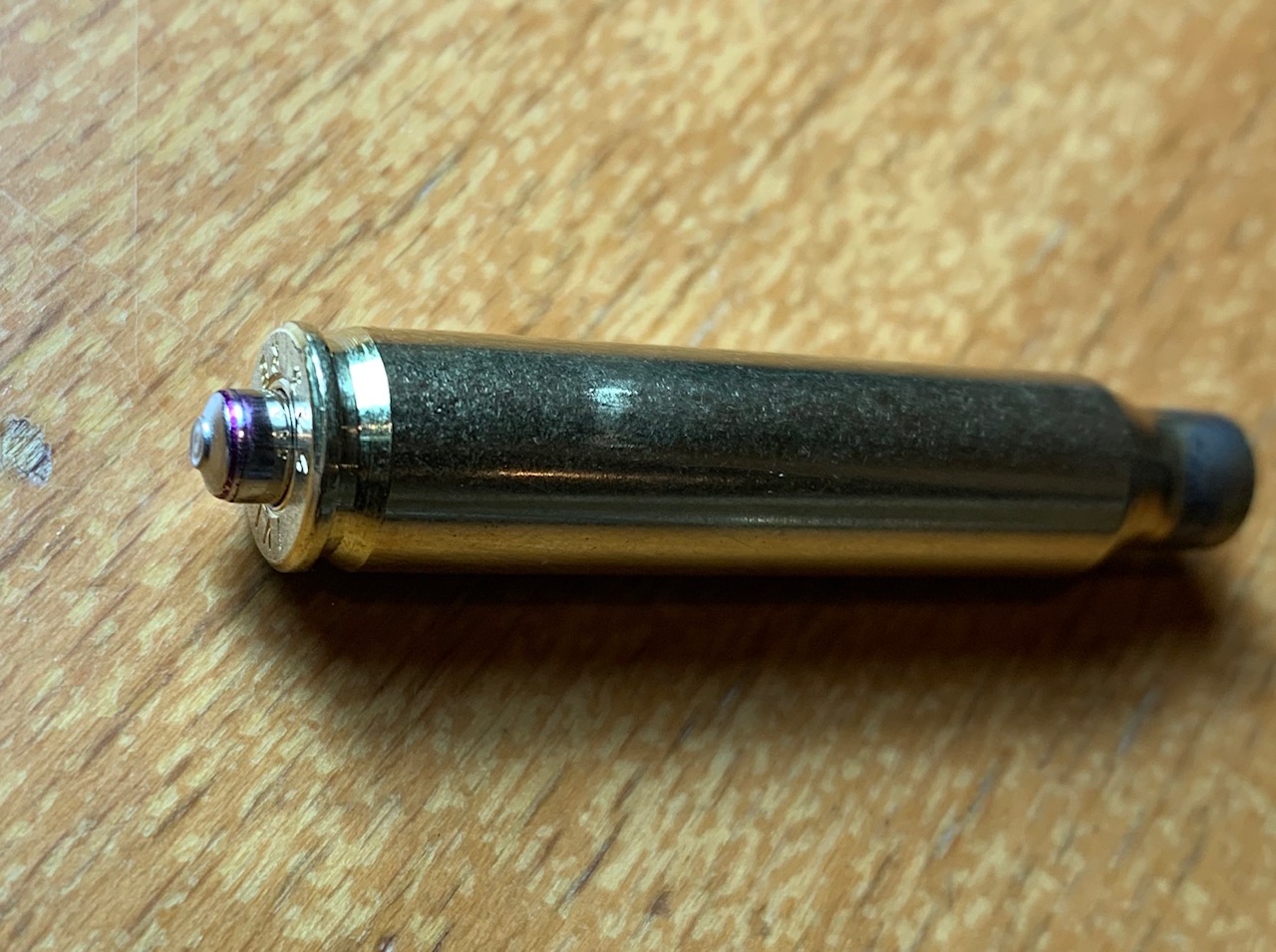

Full stroke with a Harvey De-primer confirmed my suspicion (this has never happened before). I'll have to de-prime this stuff on the press.

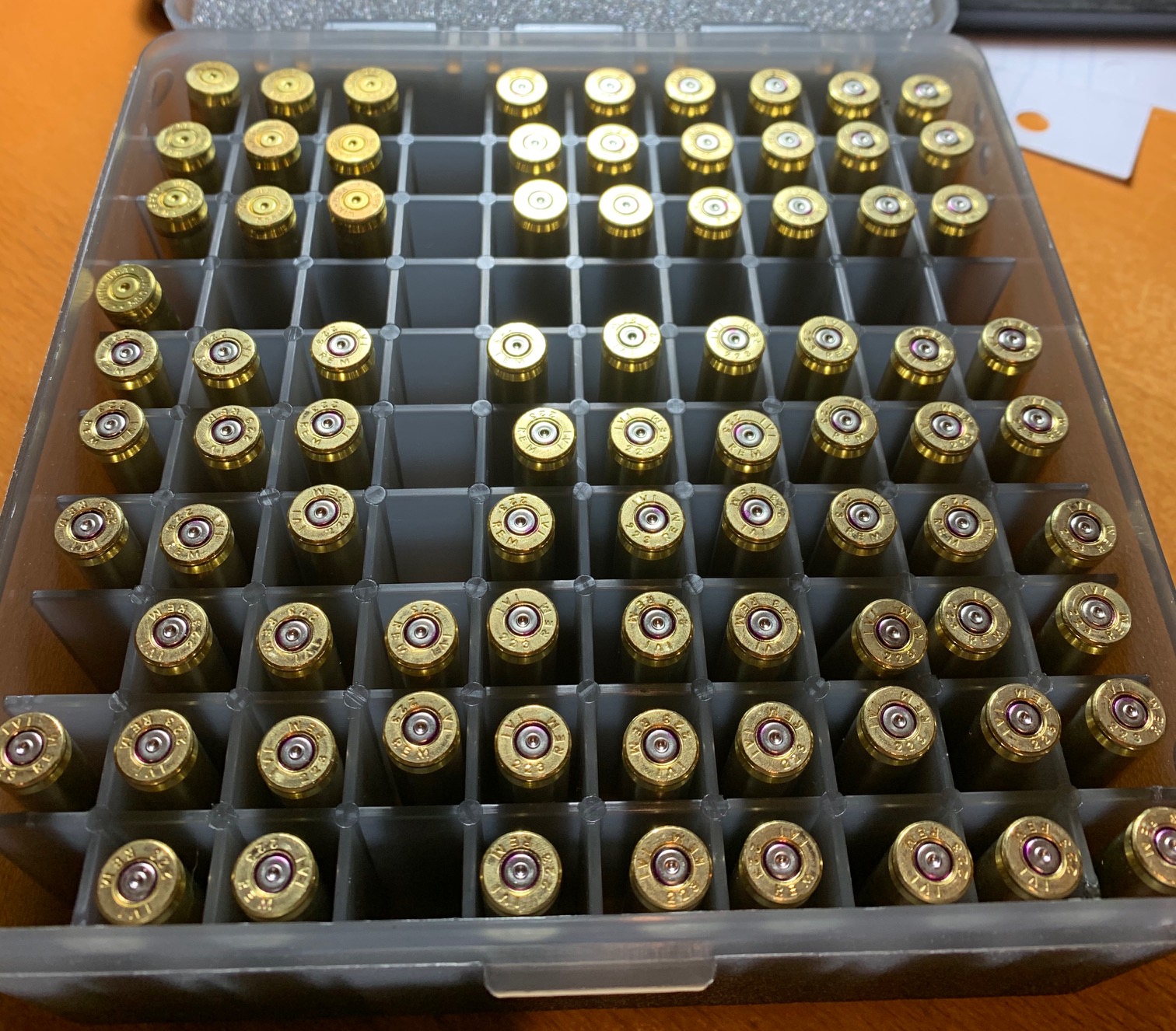

See if you can tell low loads vs high? I cant & never had any indication of pressure with any of the loads shot today.

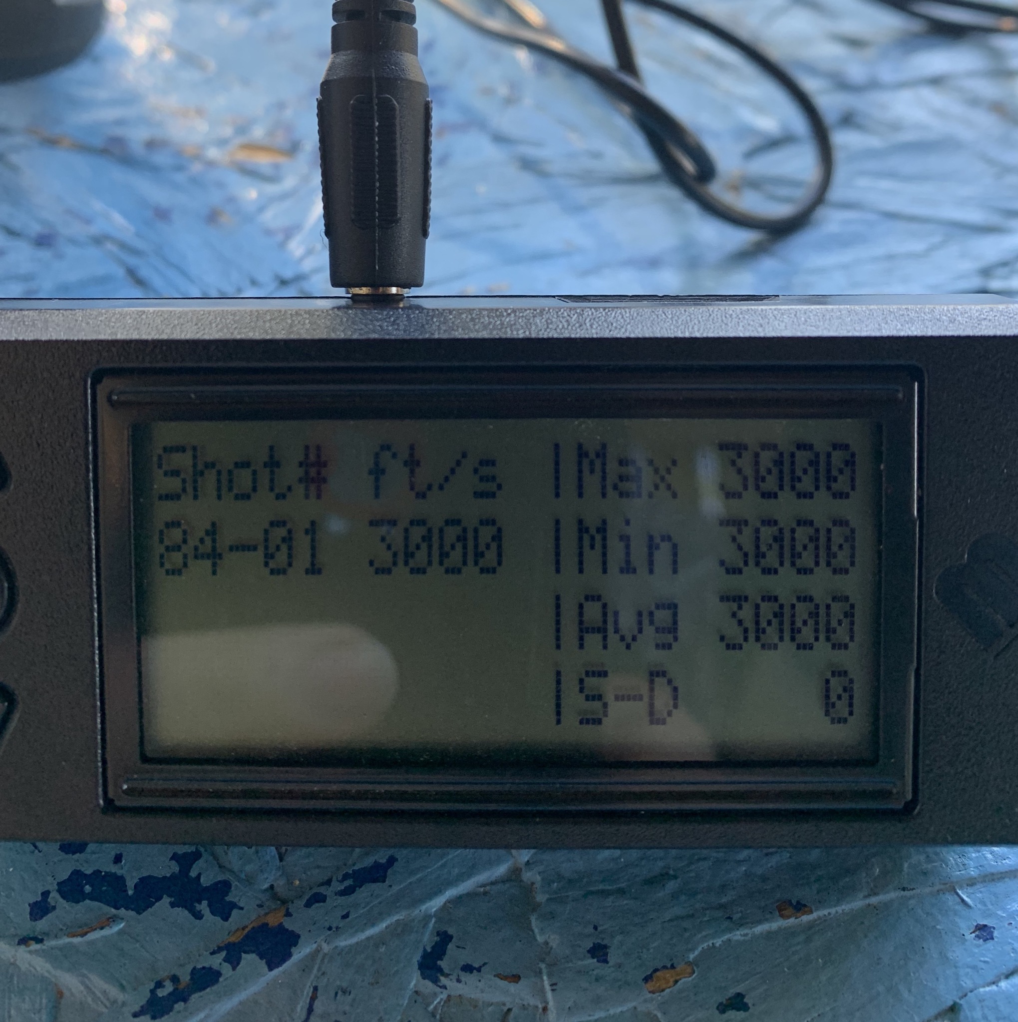

25.9gr - 3000 / 2.4 / shot 2 @ wrong target

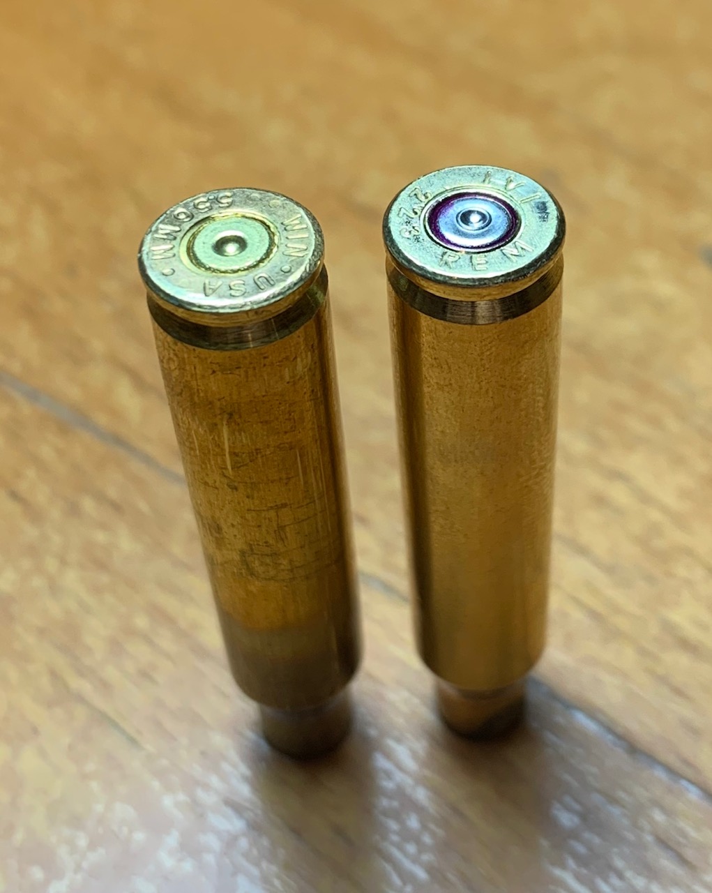

Tested 6br with a 108 Berger. 31.7 is where it seems to be a good spot. Going to shoot for groups tomorrow. I was at 2820, which isn’t that fast compared to what I can get with xbr.
32.2 is about where I stopped after having heavy bolt lift.
Shot two ladder test starting from 29.5-32.2. Bottom group was 31.4-32.2. Just off the groups it appears promising. O and these were shot at midnight using light from my vehicle, so not the best conditions for making groups.

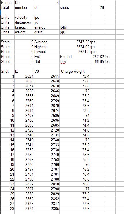

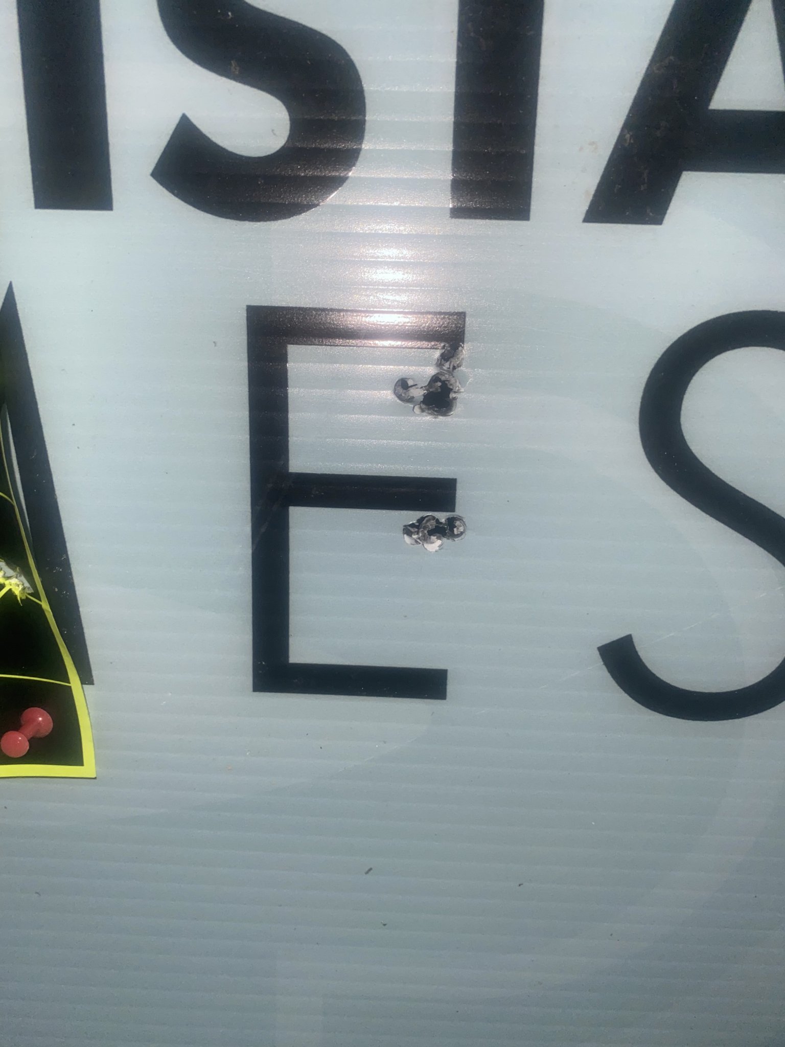

I got out to the range today and did a ladder test with the new HD in my
300 Winchester magnum
bullet : 225 eldm
Coal : uhhh barely fits in AICS mag
barre length 26"
round count on barrel : 400
twist 1:9
I experience NO heavy bolt lift even at 77.8 , no pressure signs . the official load data on the data center tops at 78. so you might be able to go a bit higher if you really need more speed
bullet : 225 eldm
barre length 26"
twist 1:9
bullet : 225 eldm
barre length 26"
twist 1:9
bullet : 225 eldm
barre length 26"
twist 1:9
bullet : 225 eldm
barre length 26"
twist 1:9
What brass? What primer? What coal? Tell us dammit!
Thank you for the info... Been interested in learning more about this powder in .300 WM, especially with the 225 ELDM.
I managed to grab 2 pounds of Retumbo over a year ago... But I've never opened it. I didn't figure there was any reason to test it if I can't get anymore of it. Nice to see I have more options.
What brass were you using?
Mike
Norma brass . btw across the board I have found that 225 eld's like the 2800fps node , try 75 grains of retumbo , 74 of h1000( if you have any ) and 77 of SBHD
