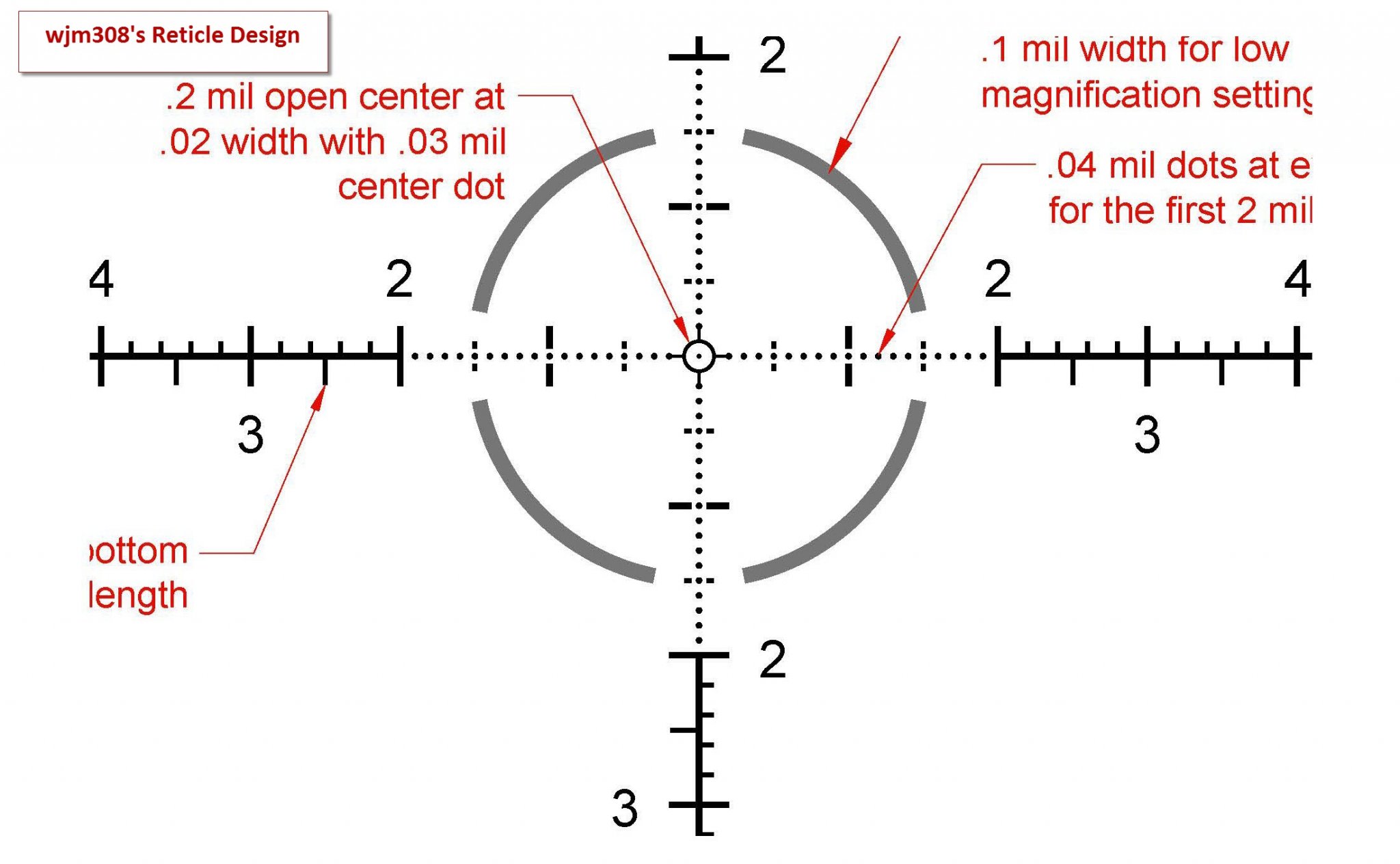

I'm not Frank but I have a reticle I'd like March to consider :) I have the full specs if you're interested and can provide high resolution CAD file.
WJM - would the .2 mil part need to be illuminated? Looks interesting.
I have specs on illumination in the greater design but I also understand there are challenges in semi-conductor photo-lithography processes and especially with illuminating those tiny etchings without bleed. It is my hope that the .2 mil circle could be illuminated but it is not absolutely necessary, the outer large 3 mil quartered circle would not have to be illuminated because I believe it would be too distracting in low light situations. The idea came from the realization that our eyes are naturally drawn to concentric circles. The sight picture being the largest outer circle, then you you have the 3 mil circle, then the .2 mil circle and then of course the center dot, everything is leading toward quick acquisition at all magnification settings in a high magnification scope, but it's not too messy to distract from holding wind or elevation if necessary. One of the greatest impediments of FFP reticles in high magnification optics (5x and above) is that the reticle tends to get lost at low magnifications, this design was an attempt to have a reticle that could function well in all magnifications.
The centre circle could be illuminated if line thickness is increased . I saw this reticle posted
in an Athlon thread as well , it reminds me of the reticle in the LRHS Bushnell , except
with more subtensions . Good for point and squirt , but the outer circle distracts me on
higher powers for longer shots . I keep wanting to look away from the centre detail .
You are spot on about getting reticles to work at high zoom ratios , it’s quite tricky
which is why most manufacturers won’t even attempt to do it .
I remember another difficulty in illumnating reticles in high zoom optics , the line thickness
and colour bleed in the laser etching . The more complex the design , more difficult to etch
without edge errors , and a high rejection reticle component rejection rate .

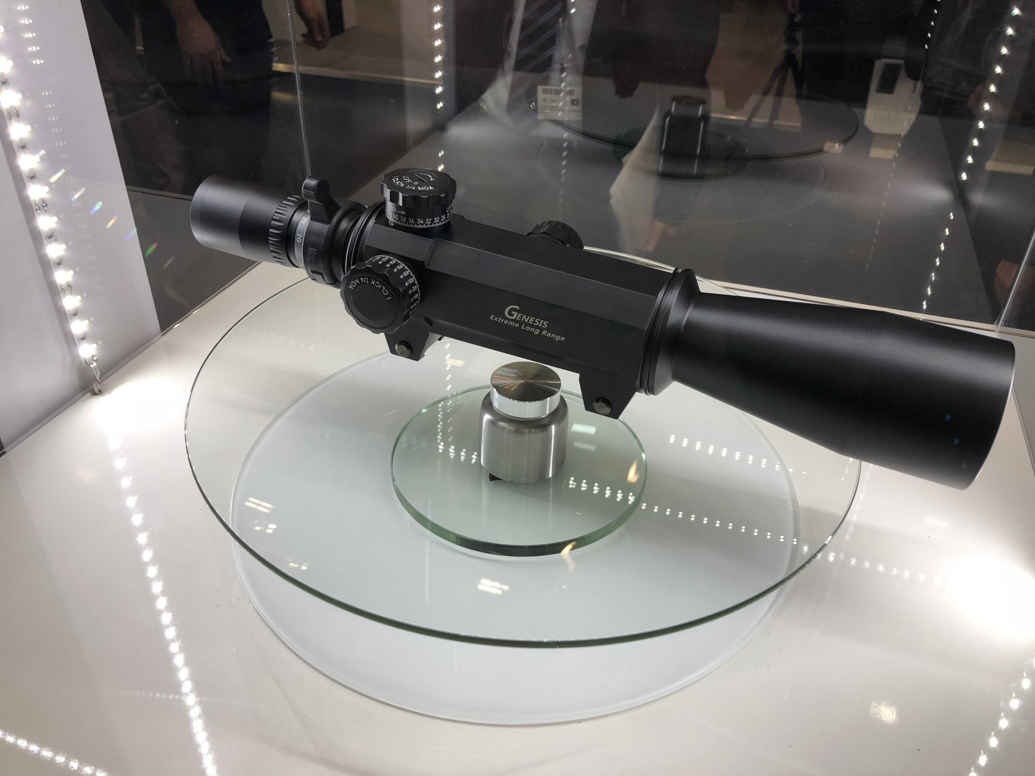

400moa/110mil internal adjustment
150moa windage throughout elevation range
50moa/turn. 1/4 click
Highnaster lense
Integral mount
No optical compromise - you are always looking they the ‘centre’ of the optics
6-60 x 56. FFP
3.5# weight
Pretty neat for ELR, scope that seems to have caught up?
