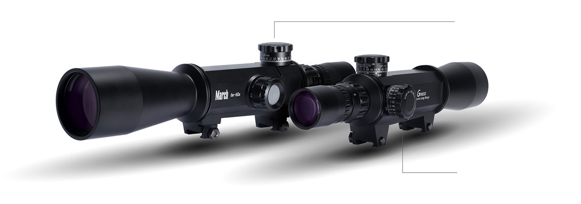

I'm guessing this is the start of a new series of scopes that will use the Genesis system to allow for huge adjustment ranges. If you're going to make a splash introducing a new technology, there's nothing wrong with going extreme right off the bat to establish the parameters.
March DEON have just moved the goalposts into the next Zip code; it's a whole ne ball game now, if I may be permitted to mix my metaphors.
I notice that the 400MOA of adjustment range is divided into 300MOA up and 100MOA down. That's 5 degrees of up. I also notice that the view remains through the middle of the objective lens, even at 5 degrees, so you're always looking through the sweet spot of the optics.
The zoom range is 10X, so one could expect such things as 2-20X or 2.5-25 or 3-30X and so on. I don't know how useful 300MOA of up elevation is with a 25X or 30X scope, but the possibility is there.
I also notice the 50MOA per revolution knobs are at the rear instead of the middle. I do not understand the significance of that yet, but I suspect it's a product of the sorcery used to move the FFP image while still looking through the middle of the objective lens.
I can't help but wonder what the significance of the "large spherical slider" is at the junction of the objective bell and the scope body. There seems to be the same apparatus at the rear, where the body joins the ocular. "Central gimbal system with slider bearings"? So this is the sorcery part, and it's patent pending. The gimbal is a single-axis model and is for roll motion. Would this be useful for scope leveling, especially since there are no rings involved in the mount.

The issue is the pricing and the fact the Charlie Unit is $1500 and works with existing scopes. Plus the user can set the Charlie unit and adjust it on the fly too. (There is actually a new version of this coming that does it in a better way)
The adjustability is good, the fact it keeps you in the center of the glass is better, and you can get so much elevation in the scope works.
The problem is, ELR is very small percentage wise of the shooting community, the scope is very expensive, companies tried the $5000+ price point, it failed. To win they should have considered a "smaller version" along with a bigger more expensive one.
It's a step forward but you're fooling yourself if you think it is revolutionary. It's an elegant externally adjusted scope, those have and do exist.

If I were to hazard a guess, price was not a big concern here. In my mind, Deon (March) wanted to show just how far they could take the state of the art by using the best of their current technology and produce a riflescope that has it all and is so far above any other riflescope that noses will bleed.
They already had the 10X erector. They already had the High Master lens system. They already had the morphing FFP reticle. They added the newly-devised Genesis system for adjustment and the wide angle ocular. Perhaps they thought that 8-80 was a magnification too far (exit pupil would be very tiny and the eye relief would be problematic,) and they settled on 6X base.
Add all these things together, and they created something far above anything else currently on the market. We've already discussed the fact March scopes are boutique scopes; definitely not meant for everyone.

As an outside observer, I look at the Genesis offering and read the spec sheet and see what they highlight:
400MOA of elevation adjustment. 50MOA per rev.
The High Master lens system (Super-ED glass.)
The highest zoom ratio and FFP magnification in the World.
Wide angle eyepiece.
Parallax free from 10 yards to infinity.
Yes, I do see the Genesis, not as a "tour de force" but more like a statement "this is the state of the art if FFP scopes."
As an outside observer who knows that March is a boutique riflescope outfit; they have just elevated the state of the art very high but they won't take the industry by storm simply because they do not have the production capacity to be anything other than a boutique company. That's also why they can create such products as the Genesis and scopes like the March-X 5-50X56 or 8-80X56, the highest zoom ratios and the highest magnification riflescope on the planet.
Now, I see where we diverge. I do not see how Genesis can make a claim to "state of the art in FFP scopes" and I can take that argument apart in a matter of seconds.
I can easily see how Genesis can make a claim to "state of the art in ELR scopes" and that is the discussion I am most interested in.
As far as your list of specifications goes let's look at them one by one:
1) Adjustment range: this clearly the key specification and is what really makes the scope interesting
2) High Master lens system: this is a marketing term and means nothing other than it is likely better than the previous optical system used by March. I hear good things about it and it sounds like contrast has been improved. However, I have no obvious way of saying whether it is better than competing designs that had notably better contrast and micro-contrast than earlier March scopes. Given that so far the High Master re-design has only effected SFP scopes and the very expensive Genesis, most of us (FFP shooters) will never know what this really is until there is a more relevant High Master optical system to our world. I do not doubt it is very good, but I am not keen on the superlatives.
3) Highest zoom ratio is a technical challenge, but for scopes of this type I can make a good case that this is a solution looking for a problem. It is less important to me than an appropriate and usable magnification range. Highest magnification is important to target shooters and ELR people and since this is where I see this scope making an impact, this is a good thing (I am not going to rehash my questions about larger objectives).
4) Wide angle pieces simply brings March more in line what what other top end scopes already have, given that the eye relief has gotten shorter. Given the application, I would have probably preferred a larger diameter WA eyepiece that would allow them to keep the eye relief where it was.
5) Parallax adjustment from 10 yards to infinity merely brings us back to the question of whether the parallax adjustment is going to be finicky or not. 5-40x56 was not bad, so I hope this one is as good or better. Still, perhaps I am missing something, but why would I care about a 10yard parallax on an ELR scope? I would gladly sacrifice short parallax distance if it gave me greater adjustment granularity at long range.
Lastly, something that was not mentioned before: I see that the illumination adjustment is listed as a "6 level" adjustment. Is it a new design that fixes the limitation of the current illumination system?
Reticle illumination is where March has traditionally been a little behind the curve compared to the competition, so I am very curious about this one.
ILya

Excellent point. I agree that "state of the art in ELR scopes" is more apt.
It is my understanding that the High Master Lens system uses Super ED glass, which from my photography penchant means Nikon glass as they introduced the term with some of their lenses. Then again, they (Nikon) also have fluorite glass lenses, so go figure. Of course, someone else might be using the term Super ED. So who knows.
As for the illumination thing, I have the add-on 6-level illumination module from March on my 5-50X56. I replaced the original module with the 6-level module. However, I cannot say that it is the same 6-level module as the one used on the Genesis because I can't see the proper details on the pictures of the Genesis. My 6-level module goes on and off by pressing the middle and I adjust the intensity by rotating a built-in dial. When I turn it off and then on, it stays at the level that I selected on the small dial.
For the parallax adjustment, I added the large focus wheel to my scope. The neat thing with such a short focus range, for me at least, is for dry firing.

And what exactly is "wrong" with the reticle. I have a habit of putting the dot on where I want the bullet to go and use the spaces for aiming off. Is there a better way?

1) Comparing erector ratio of a riflescope to horsepower of a car is at best a silly comparison. At worst... well I promised to keep it civil, so I'll let you fill in the blanks.
2) I have looked through HM scope a couple of times, but not enough to get a detailed evaluation and I am a detail oriented guy. What does it have to do with NXS? These do not compete against each other. Just like the Bugatti thing, this is just a false comparison. A little intellectual honesty instead of fanboy-ism seems to be in order.
3) This is a loaded question. For a dedicated long range scope, I do not think zoom ratio is anywhere in my list of things to consider. By itself, it is not important enough. For other scope types it is important. For this one, I am not so sure.
4) I am not looking to have a custom scope made and I have talked to Deon people a few years ago when they were all at SHOT. Given the language barrier with them and the fact that Shiraz with whom I do not have a language barrier seems to be on this thread, input is exactly what I am providing here. A larger diameter eyepiece that keep the eye relief a little longer with wide FOV may not be a bad idea.
5) Cheap ELR practice is a great thing, but unless you plan to sell these to airgunners somehow, I do not understand a need for 10m parallax in lieu of more precise long range parallax adjustment. As for the World Champion stuff, this seems to be brought up all the time. We all know that some exceedingly capable shooters in their disciplines are involved with March scopes, for example Shiraz and Denys who have posted on this thread. Does that excuse the product announcement from some constructive criticism from the rest of us?
6) I am very curious how that will work. There are two illumination modules I have seen for March FFP scopes: Lo and Hi intensity. Low is not quite low enough and High is not quite high enough. If the dynamic range was extended and combined into a single unit, that is a very good thing.
I look forward to seeing how the scope develops between now and full scale production.
