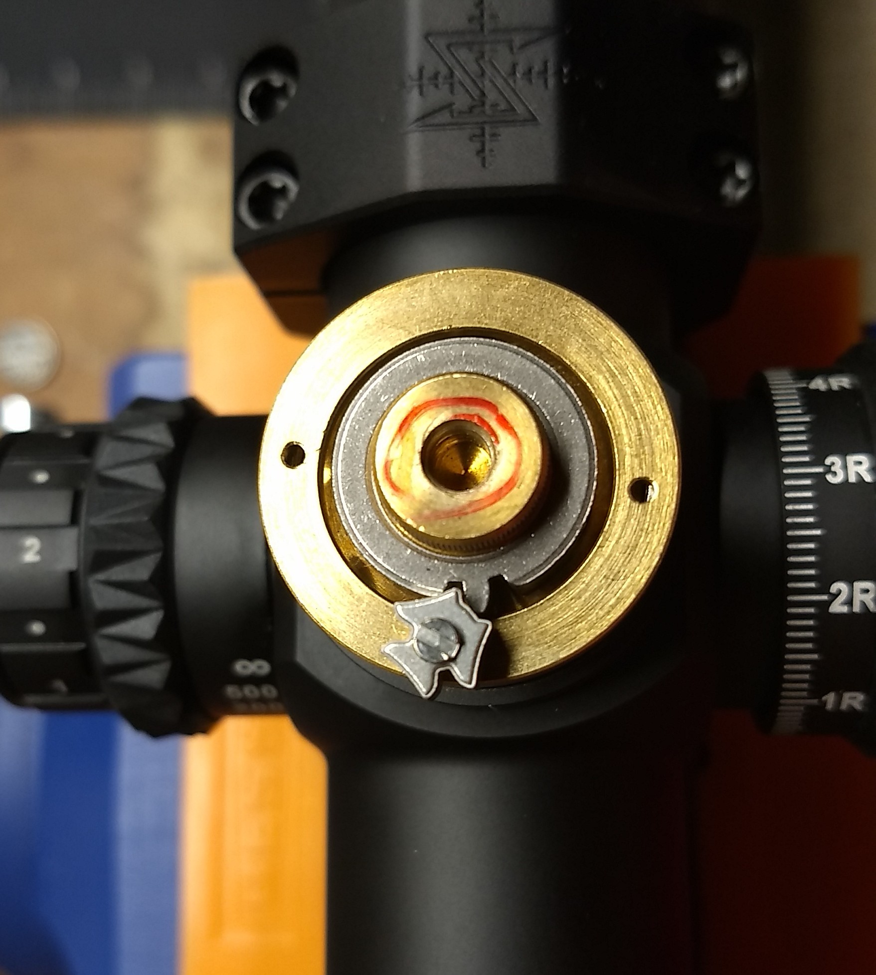

Has anyone set their zero stop yet? I am an idiot and can't figure it out.
Thanks in advance
Eddie
Here you go:
There are three Allen screw set-screws positioned around the zero stop collar.
Using a 1.5mm Allen key, loosen the three set screws, being careful not to back them out so far that they fall
out or can get hung up on the stop when rotating. A quarter-turn per screw should be sufficient.
With the set screws loosened, rotate the collar CLOCKWISE until it is FULLY SEATED against the stop.
TIGHTEN the three set screws so the collar stays locked in place against the stop.
Here you go:
My three set screws came in a baggie and I see no where to screw them in. Can you take a pic showing where they screw in?
The 3 in the bag are extra setscrews. One thing to pay attention to is that you may need to remove the stop gear (held in by the slotted screw) to get at the last setscrews. Pay attention to how that gear is oriented when you put it back on otherwise your zero will end up a rotation or two off.

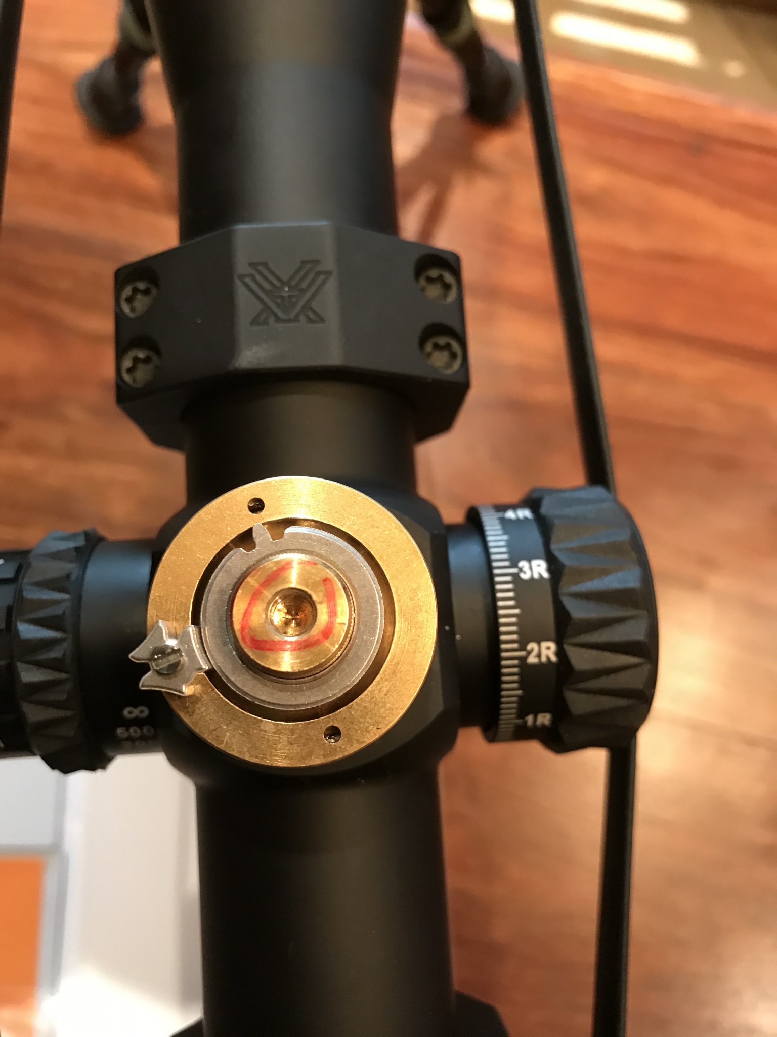

Does the gold/brass piece come off?
The brass piece doesn't come off. From your picture, just loosen the 3 setscrews on the silver collar and rotate it clockwise until it hits the stop. Here's how it should look at the zero position:
The top of my stop collar is level with the brass piece. I couldn't see the set screws, I had to pry the collar up and then it was all easy. Thanks Jl937, all good now.
Next time just pull the turret up like you're going to adjust it and the collar screws will be accessible once you remove the turret. Guess I forgot to mention that part
