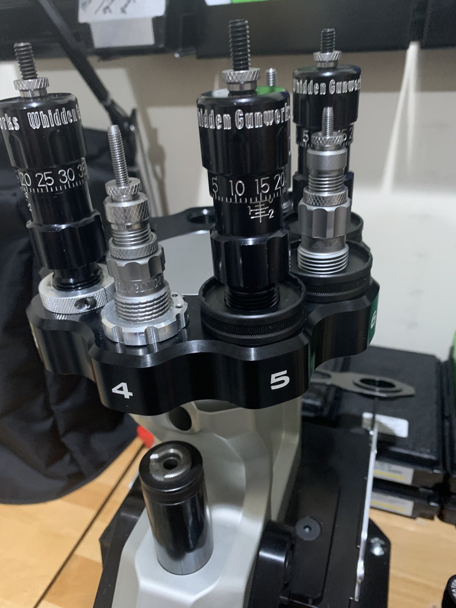

The Inline Fab Ultra mount I already have is too tall and the bench mount is too short. Sadly Inline is a few days out for their 4" mount.

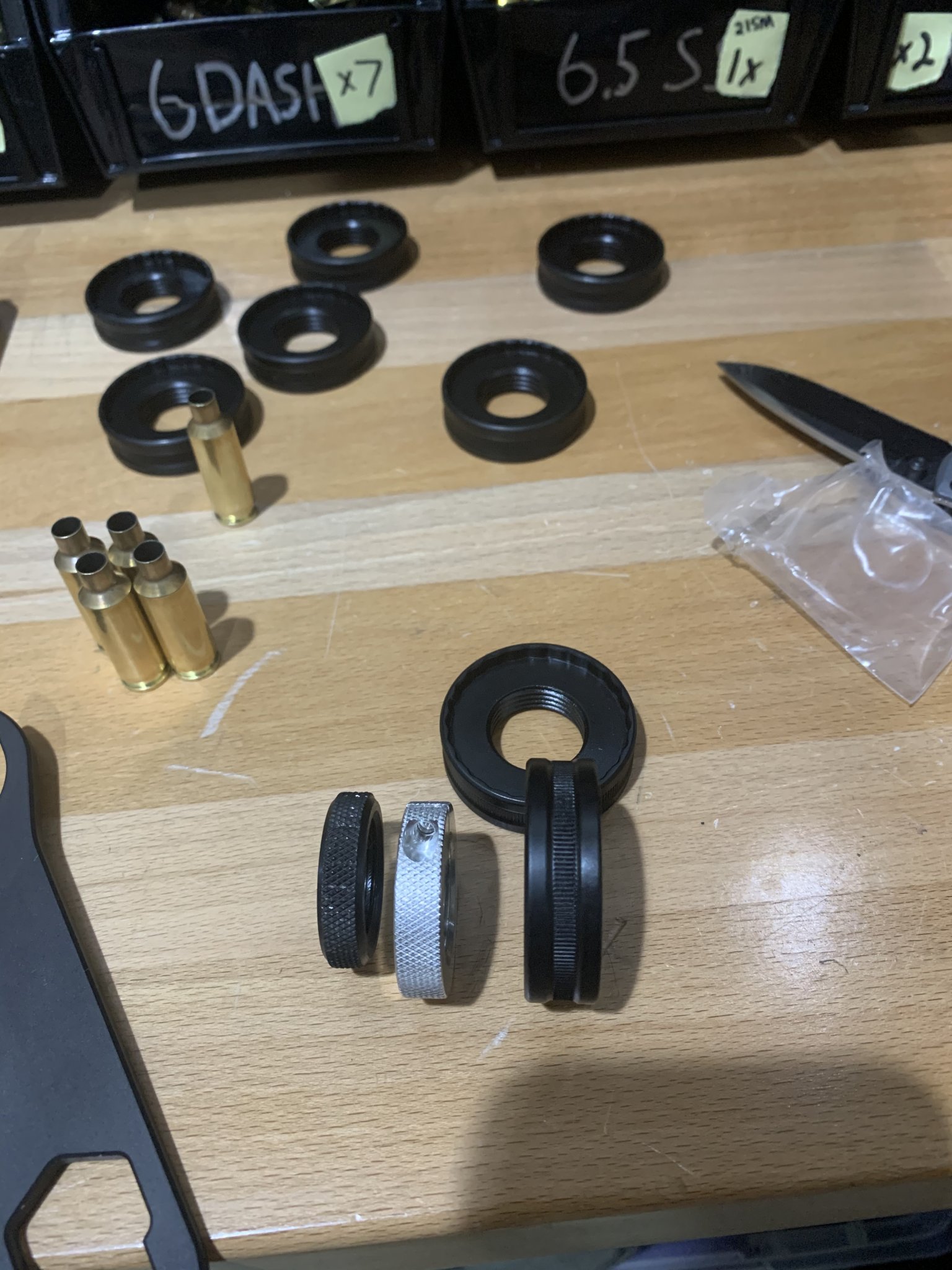

    Just came in and got it mounted. Sized a couple 6 dasher to test it out and then gonna try some 300 Sherman mags. I was skeptical when ordering it but I’m getting convinced.

    So I was able to size a couple hundred pieces of dasher brass which left some impressions.
    I currently have a co-ax, Redding T-7 and a rockchucker to compare to. Using redding shell holders and whidden custom dies. Using mitutoyo calipers and dial indicator for measurements below.
    Some initial takeaway. The ram is huge. The shell holder on a T-7 looks like it’s a same size as the ram. On the zero the shell holder gets swallowed up in there new shell holder system. The bottom of the downstroke feels like a rubber band that starts to snap back and helps kickstart the upstroke. Area 419 goes into this in depth so thats all I’ll say on that.
    The big dog steel mount is awesome and I love the turret holders on the back. If you get a zero spend the extra money and get the big dog mount. Super solid and was very easy to install on my bench.
    Sized the first 30 pieces and 29 had identical headspace measurements. The last one was .0005 off. Continued to check every 5 rounds and headspace stayed the same for the rest of the 645 pieces of brass in the lot. Runout was awesome. The dies help but the largest amount of runout I measured was .001. I had some that got to .00025 but the rest hovered in the .0005. The normal runout on my co-ax is .001-.002 which isn’t a huge difference but it was slightly better using the same dies and brass. Is it noticeable on paper? I don’t think it matters for prs but that was what I saw.
    Overall i like it and will keep using it. I do wish the had designed it to fit an inline case eject system instead of an add on like the rockchucker.

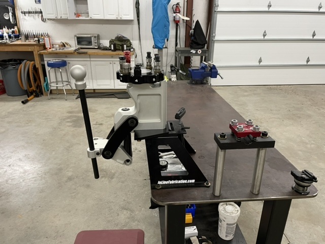

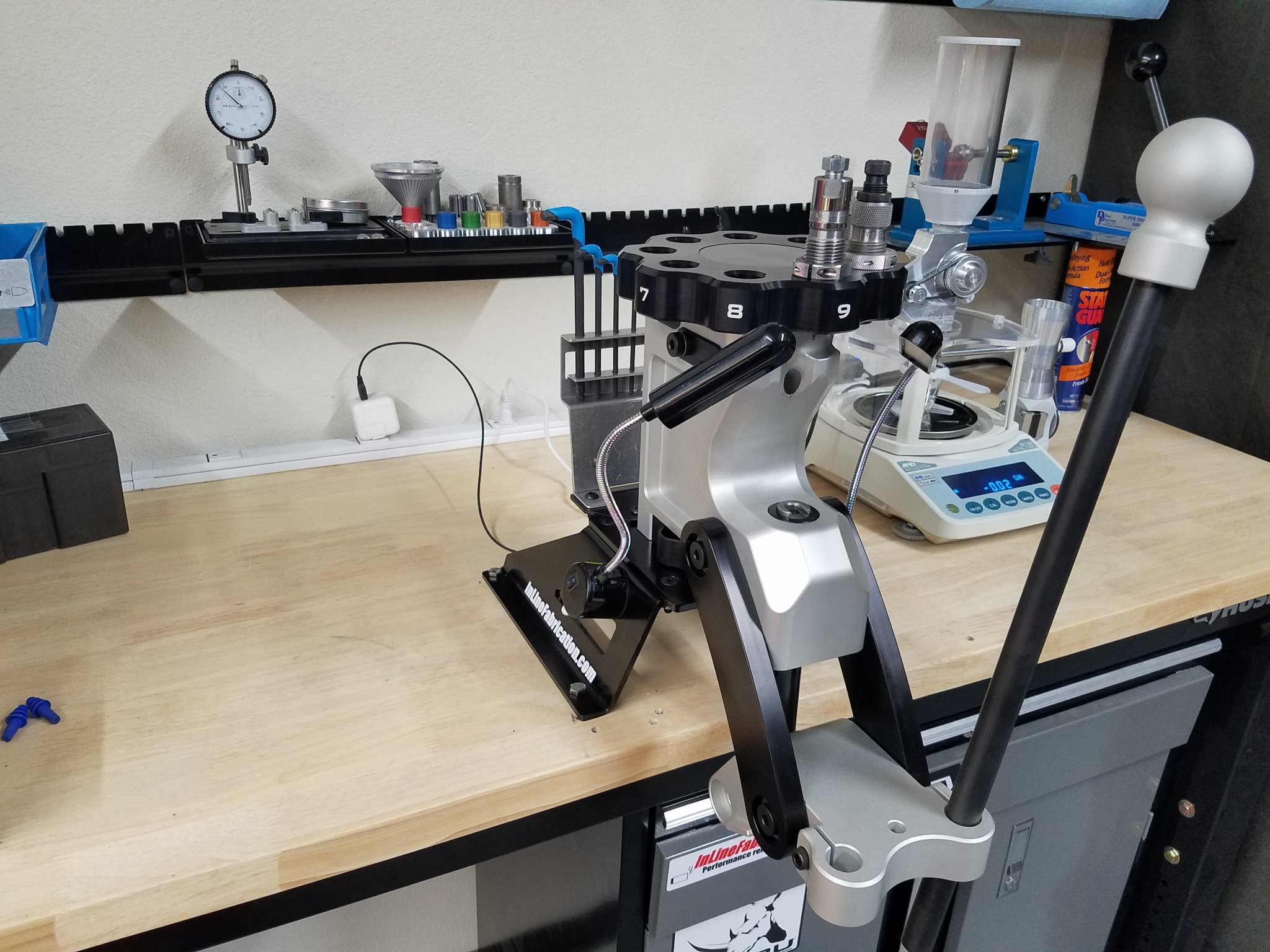

    Mounted on an Ultra mount. It's 6" too tall but the other mount won't be here until next week.

    I mean, do you even reload? I don't see any type of messiness going on. 😜😜😜
    Jk looks great, I like my bench clean and simple.

    I have everything cleared off the bench because I'm reorganizing. I'm planning to consolidate all of the dies on the wall into the tool heads of the Zero press but I'm waiting on the second tool head. I have other presses and a Inline Fab quick change mount on my other bench. The Zero is replacing a CoAx.

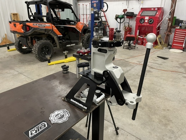

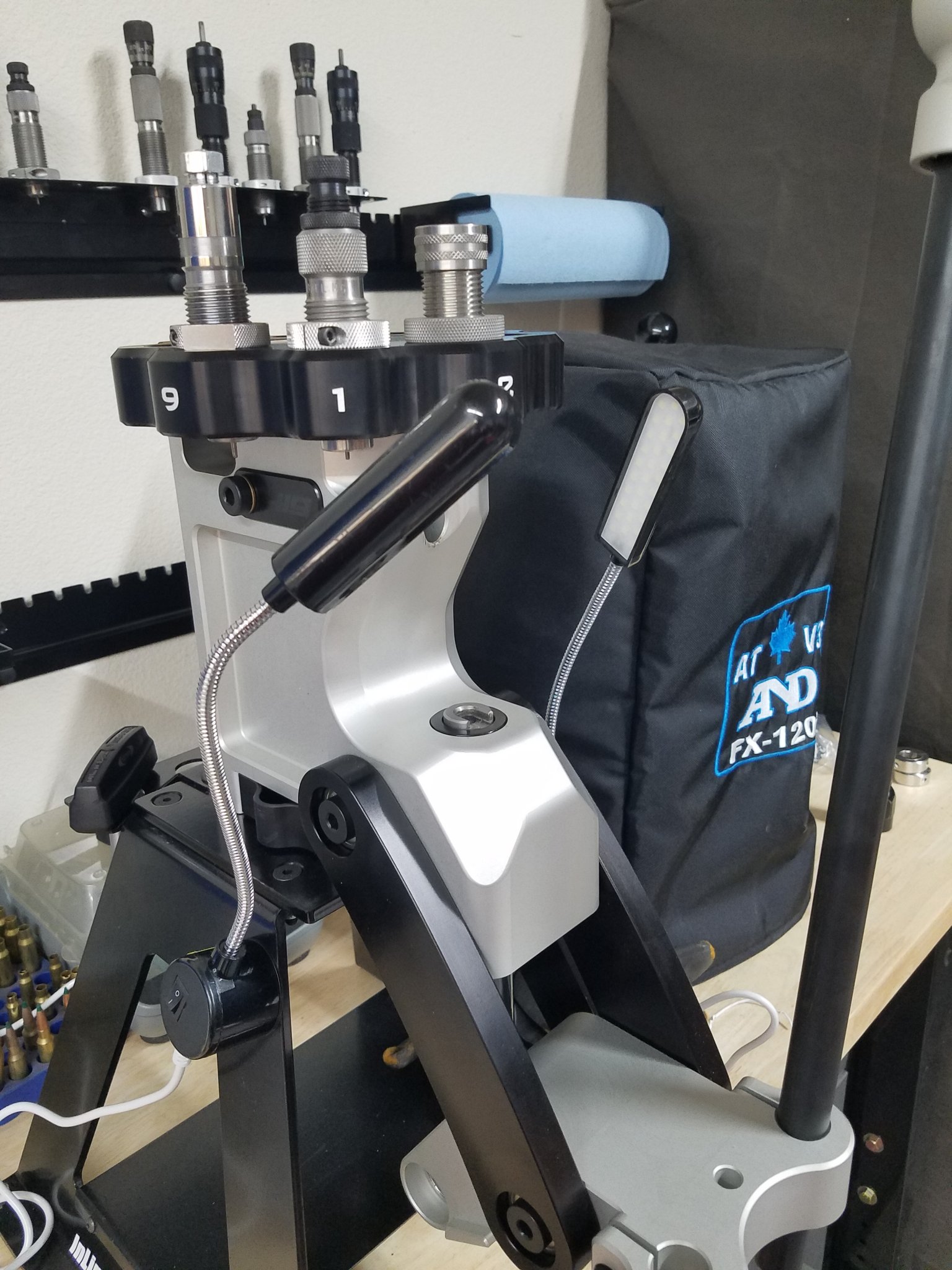

    The new mount came. The height is perfect now with the handle lowered about 1.5". Still waiting on extra turrets.
