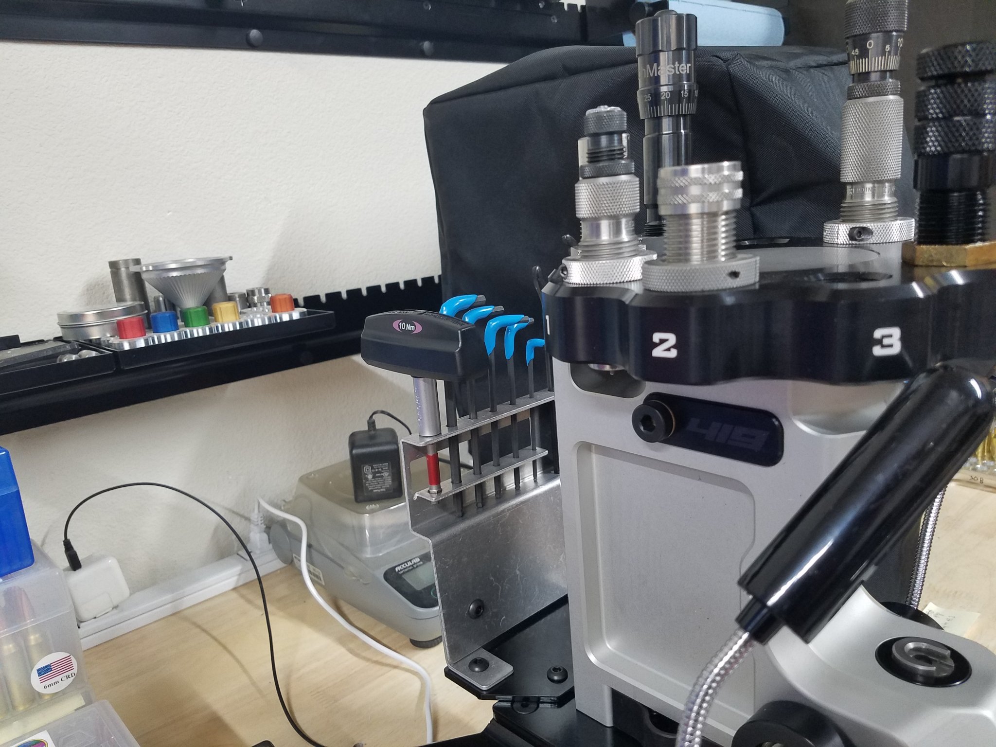

@flyer1a what’s the best way to center a die using these?
With the ram all the way up and a shellholder installed, screw the die into the turret until it contacts the shellholder. Lower the ram, thread the die in another 1/4 turn, run the ram up to apply some pressure to the bottom of the die, lock the ring down. The upward pressure from the shellholder will push the die into the center of the 60* thread faces, and the lock ring will also pull it to center. It's how we do it, and have seen others suggest similar setup.
Of note, we always set up dies this way and then get the headspace we want using Redding Competition Shellholders. Perfect, no-fuss setup every time.

Thanks for the suggestion. This should work extremely well with the seating dies. For FL sizing dies that are not able to be touching the shellholder without causing a headspace use, should I just pull up on the die to force upward pressure into the threads? Other than using something like a caliper calibration block as a spacer after getting the die length set up I'm worried about not being able to hold it straight and get upward pressure

A calibration block as a spacer is the better idea, if for no other reason than it's simpler.

May be I am wrong, but do the same process with a FL die is not diferent than Seating die, just use a (for example) +10 to install the FL die, pressing it against the die. And them, change to a thinner shell holder, like the +6, so you get less 0,004 "bump".
Disclaimer: I dont use the Redding Compettition shell holder, but it is the way I understand how to use it. But, again, I may be wrong.

I’ll take some pictures later but the gaps between all the FL dies are not consistent enough and the gaps are larger than the tallest Redding comp shell holder. Double checked this with my comp shell holders. Thanks for the idea but it won’t work out for this projects without over sizing the brass by a lot
The feeler gauge idea is a good one. Once you have the die set write down the feeler gauge measurement and you’ll get it there every time. The gaps between the sizing dies and ram are quite a bit.

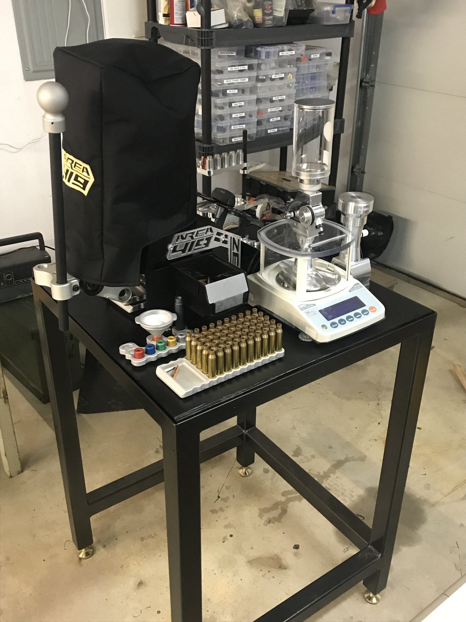

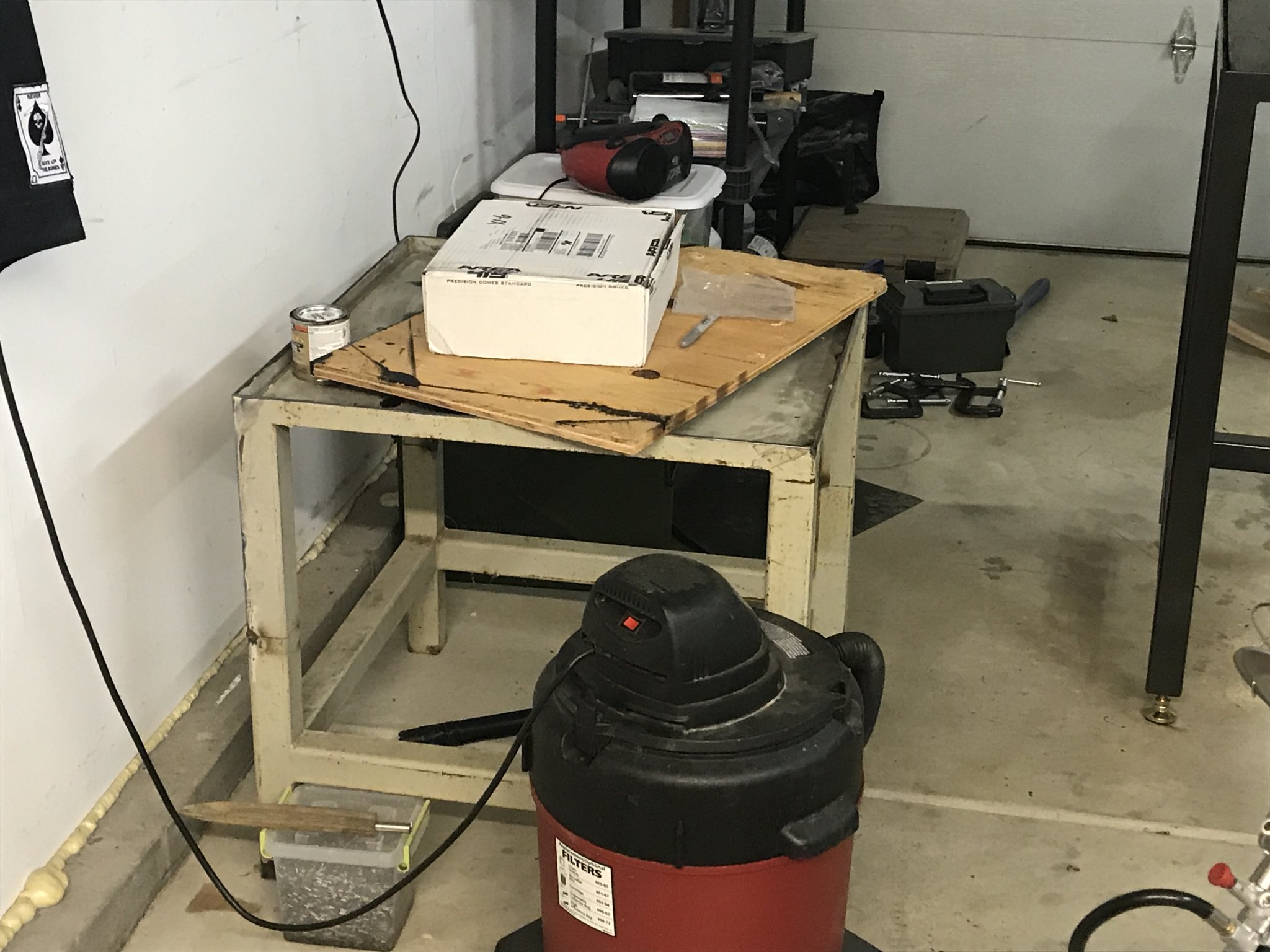

Ya’ll convinced me to start bolting things down.
The last pic is what the bench used to look like. I’m still debating how I want to set-up case prep. Would prefer a similar bench over using the tool chest.
Reactions: E-Tool and kthomas
Plenty of room for case prep if I move the scale, I figured i’d level and recalibrate prior to each session anyway.
How stable does the scale base need to be? I assume as heavy as possible away from airflow and tube lights?
All my shop lights are LED.
I have mine on a piece of 3 inch granite. I'm not sure how much movement the scale can withstand. I just figure the more stable you can make it the better you'll be.
I do mine on my coffee table on carpet while Im seating bullets with the press mounted on the same table and Im no worse for the wear. I occasionally have to relevel it but it doesnt change in the middle of a loading session. SO long as its solid and repeatable and not a rickety rocking chair that will never go back to the same place twice.
If it goes back to its same space it doesnt really matter if it shakes a bit so long as you arent slapping the handle on the stops during the final tenths trickle. Just dont actually move the scales position around because changing its level will have a much bigger influence on the actual zero and reading. I dont displace anythings actual position on the coffee table, but you can tell when I slap the handle and the vibrations go through the table that the scale reading will fluctuate and that can lead to an over charge in its final trickle.
