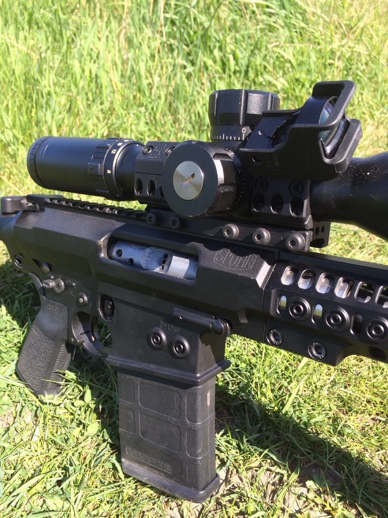

I have no opinions about the stock but i wanna respond to The cheekrest discussion.
The only good way to obtain a good cheekrest on any AR is to use lower mounts.
To do that with a scope with a big Bell prohibits 12 o'clock rail on forend. Another issue is the very short actions on the ARs that makes low mounts difficult.
Here is a buschnell 3,5-21x50 mounted on a 1,1" mount on my prototype AR10.
This was a specialmount we made for GA Precision and its made to be used both as cantilever and straight, whatever you prefers.
But The lack Of continious picatinny on forend makes the low mount possible.
The rifle is different to other ARs as the reiciver is 1,25" longer than normal AR10s.
Anyhow cheekrest is great and the issue with cheekrest is not a problem for The stockmaker to solve but The scopemounrs and riflemakers.....
All 100% correct.
