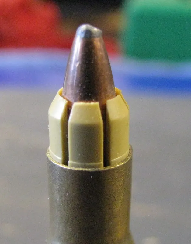

    Anyone remember these:
    The major problem with them in the past was that 30 cal barrels didn't have enough twist to stabilize them. Then, if you got them fast enough to stabilize, the sabots failed. But in a 300Blk, you can shoot these at relatively low velocity and have enough twist to do the job. If it worked, then you would increase the usability of the 300Blk even more by being able to use 22 cal bullets.
    I got curious enough that I ordered a couple hundred from E. Arthur Brown just to try out.

    I was given half an old box of them for my 3006. Shot like crap but the recoil was amazing

    I haves several 1k of the sabots. Experimenting with them in a couple platforms now.
    I experimented with them in 30-30, 308, 30-06, and 300Win back in about 1999 or 2000. I never got them to shoot.
    But then again, I never shot them in a 7 twist barrel at 2,000-2,500fps either.

    Very interested in your AAR

    The problem wasn't twist, it was the projectile slipping in the sabot under acceleration.
