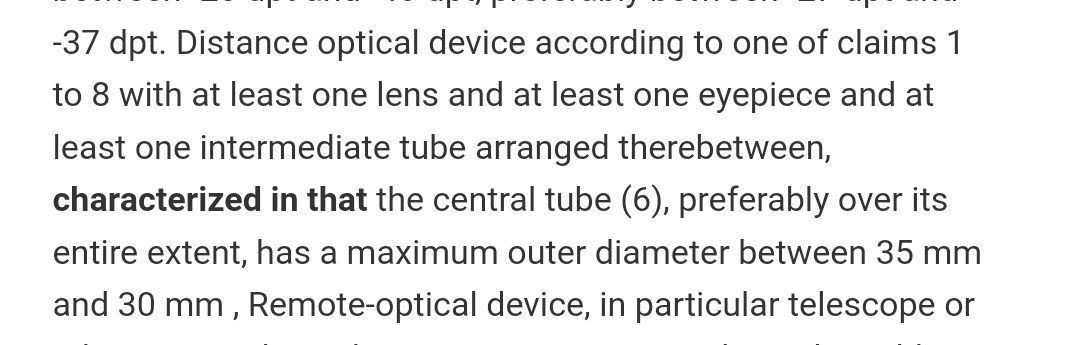

Noticed a sentence in the patent that's interesting...
I wonder if that's why we're seeing 36mm scopes. At the time the patent was written Swarovski was obviously trying to lock up the market for 30mm and 34mm tubes which covered pretty much every high magnification / high elevation travel scope on the market in 2006, but 36mm is obviously greater than the maximum 35mm outer diameter specified in the patent. So maybe ZCO didn't go 36mm for reasons of more elevation travel (although that's certainly a side effect of doing so) but rather to avoid patent infringement issues.

That is an interesting observation about the tube diameter, but oddly enough it has been reported that ZCO is also using a field stop and has limited their FOV, some have even questioned the FOV of the USA scope (vs. the spec).

OK, I have read over that patent.
IF I was the lawyer for S&B, I would advise that this is an enforceable patent and not to challenge it. Instead, approach Swarvo about paying a royalty for a license to use it. Or attempt to 'wait it out' (3 yrs at this point).
Why?
Patents are about the state of the art AT THE TIME the patent was issued. In this case, 2006. I was a precision shooter back in '06 and there were no scopes available on the market (at any price point) with these performance capabilities. This is not a definitive statement that the patent is novel and therefore valid, but its a good indicator.
Additionally, the patent lays out an optical system that advances the state of the art. It covers the old state of the art, see figures 1 and 2a-c. Then it illustrates a seemingly novel system in Figures 3a-c, with a new "optical beam deflection device #2" (as shown in Figures 3a-c). This new device apparently produces AFOVs of >22* with at least a 5 fold optical magnification system. Device #7, Figures 3a-c, is added to reduce CA.
So the issue becomes, is S&B building this new 6-36x56x scope with an optical system using the art covered in Figure 3, specifically that Device #2 and #7? I don't know nearly enough to answer that question. Legally, it might take a lot of time and $'s to disprove (remember, burden is on challenger, S&B). Also, damages are often awarded at 3x the nominal amounts (made $100 off this patent, you pay $300), meaning risks are high.
Now, the question is why hasn't Swavo taken advantage of their own invention? Why haven't they built such high performing scopes? If they can't, why haven't they monetized this patent by allowed others to license it, at a reasonable and fair price? I don't know why, but I imagine this patent has held back scope capabilities for a LONG TIME, not just this new S&B, but other S&B scopes in past, Premier's efforts, Leupy and NF, as well as all the Euro guys (probably most especially the Euro guys as this is a European patent and Swavo is European).
Don't like this? Well, welcome to modern capitalism.
