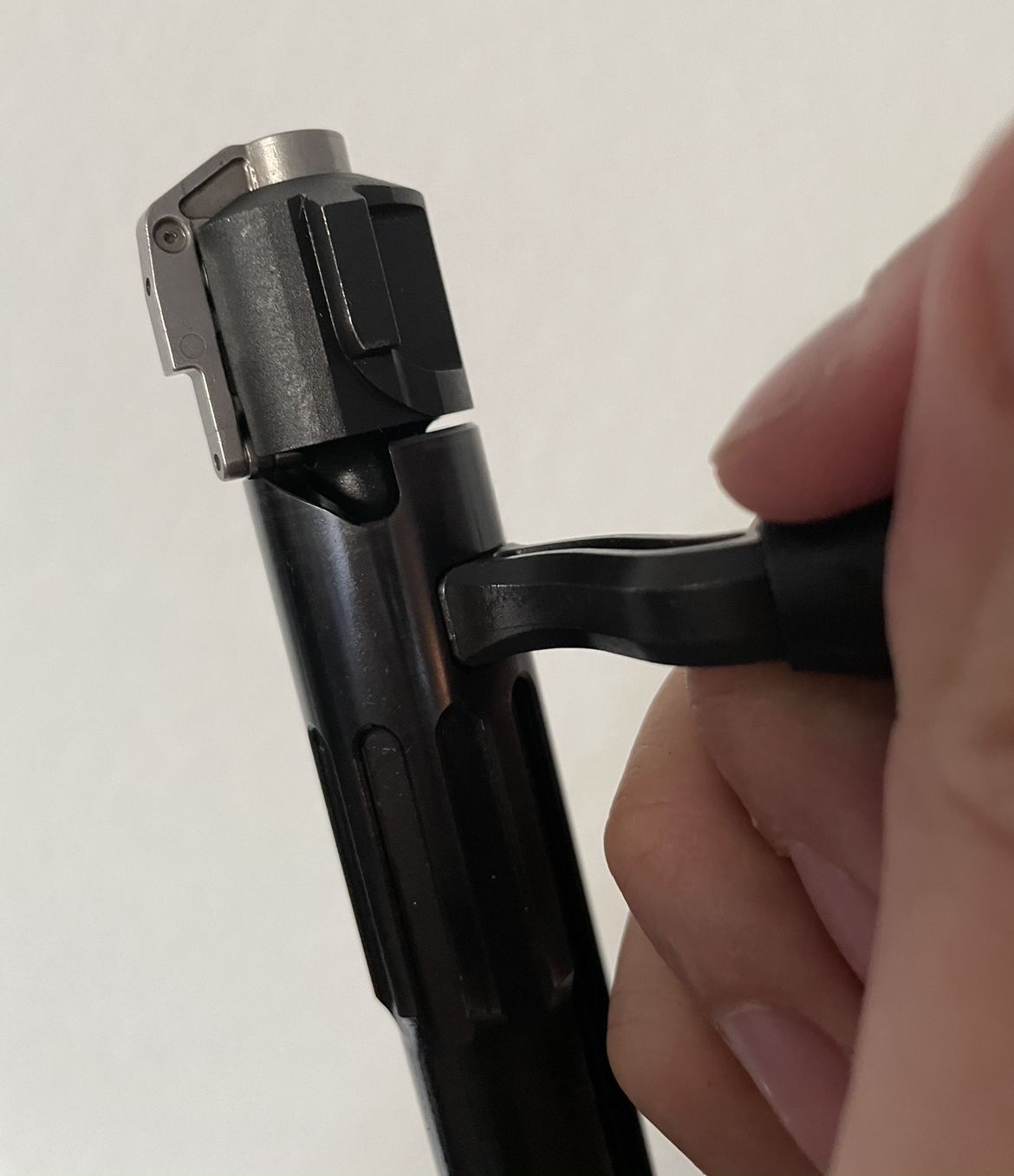

This past week, I was dry-firing it during a conference call, and suddenly something felt "off" with the bolt lift. A bit of inspection showed that the cocking piece (to use the classic term) wasn't traveling fully forward upon each pull of the trigger. And then I found this when I pulled the bolt and attempted to drop the cocking piece by twisting the shroud:
The cocking piece has two steel rollers to minimize friction - one at the its tip, and one roughly in its middle. The roller at the tip has left the building, and the pin that is supposed to retain it catches on the shroud and prevents full forward travel of the cocking piece.
The cocking piece has a small peened section that appears to be intended to capture the roller axle pin. Unfortunately, if the feature fails to do its job, that pin can move, potentially bind the cocking piece, and prevent full firing pin travel.
It appears that the other roller and axle pin are captured during assembly of the striker mechanism and has a lower likelihood of moving after assembly (so long as its peened feature is intact; if that feature fails, the pin could potentially prevent bolt travel).
I gotta say that this is an unsatisfactory condition; we've added four pieces to the assembly to reduce bolt lift effort, and the result is a potential loss of primary function. This might be an American rifle, but its German heritage is evident :cautious: (Meanwhile, every mentor I've ever had in my engineering career is snickering at the fact that I've become the grumpy old guy who complains about shit being too complex.)
Anyways, now that I know more about what's going on in the striker assembly, it's no surprise that someone found a way to foul it up with some fine dirt/dust/cement/whatever and create enough drag to delay the firing process. And if indeed we're complicating that problem with parts not staying where they should, then I think we're witnessing the result of multiple root causes. Someone's gonna get beat over the head during the 8D process (assuming that Sig has one - evidence does not support this hypothesis).
If anyone at Sig is reading this, I'll be happy to show up and lead your guys through a full DFMEA at my normal consulting rate, but only if you promise that next time, you'll do the same before the product is launched ;)

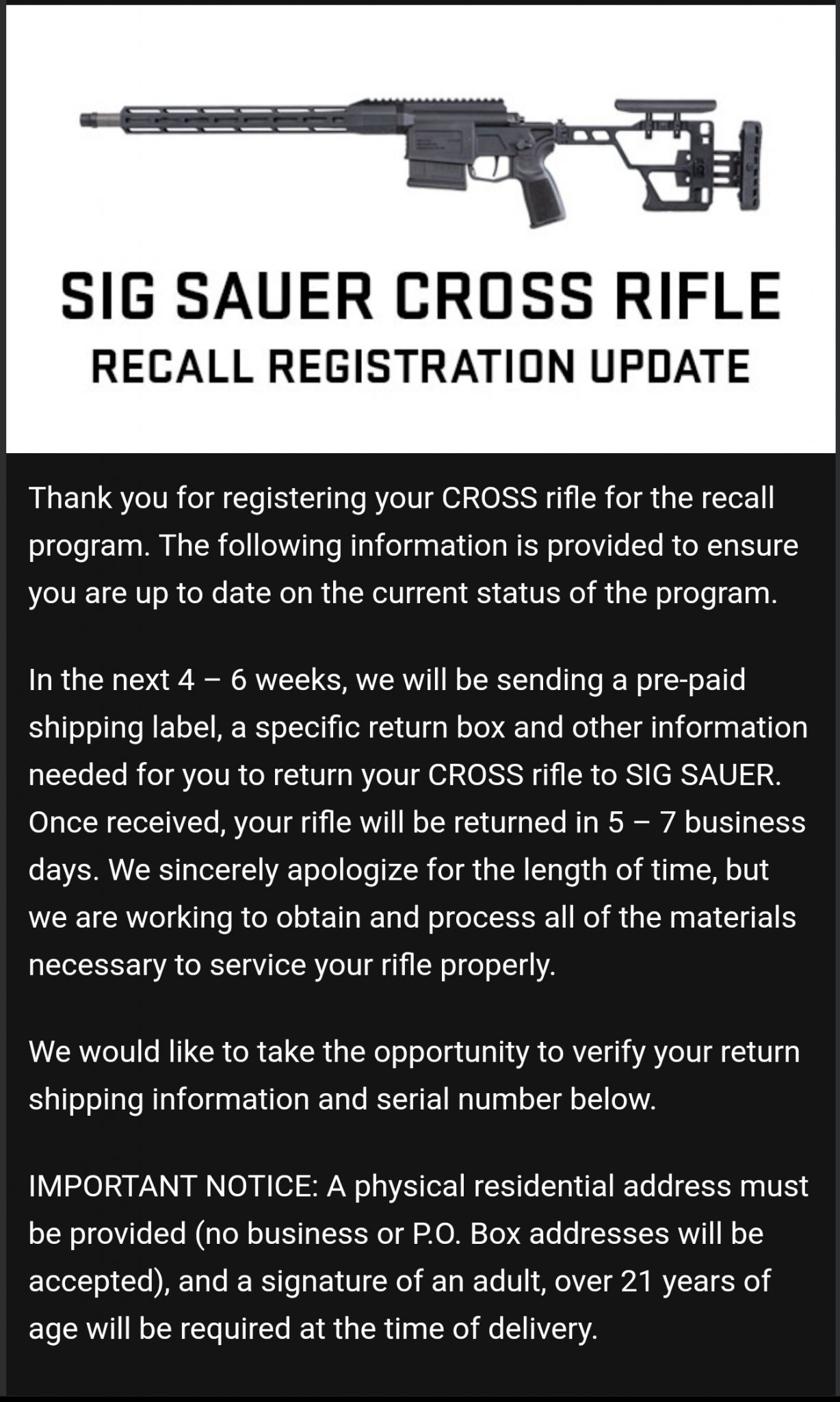

Just received this update asking to verify my information.

The recall wouldn't prevent me from buying one. I've continued to shoot mine. The failure was hangfire/trigger issue. Follow safe firearm practices and you'll be fine until Sig can get them all back and get them fixed.
As a mostly broke grad student its not super confidence inspiring to scrap my pennies together for one only to have it go down on me and become potentially unsafe. But hopefully it all gets sorted out by then.

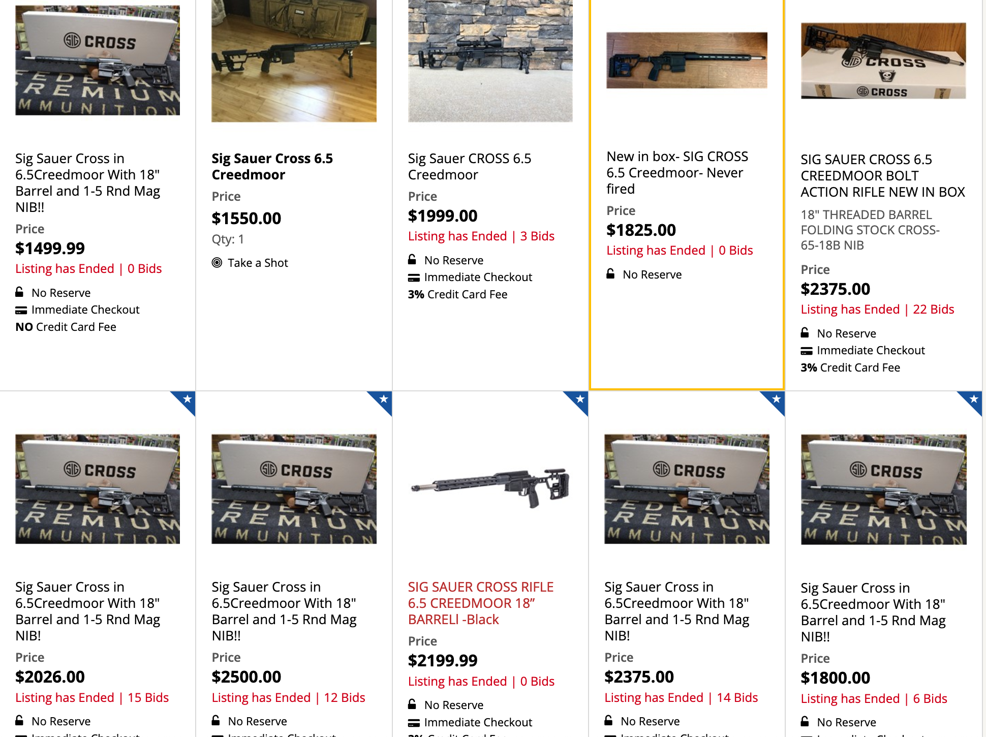

What's up with the Cross's on gun broker selling for $2,000 and $2,500 on gun broker? I mean if that's whats happening I may have to list mine and buy one again when they are re-released. Crazy prices for sure
Haha, I just looked at this today. Was thinking about buying one this week but not at those prices.
Usually this is one of 3 things:
1) Timing, sometimes for whatever reason bidding for a short time goes crazy, Sig MPX's were going for $4k a couple months back, usually when this happens sellers come out of the woodwork trying to cash in. Happens with SCAR's from time to time, right now most people are too busy selling $150 cases of 9mm for $600+ to bother with guns on gunbroker. Right now there's only 1 Sig Cross on gunbroker and that's probably why it's bidding over $2500. With the recall it could be months before new batches hit the market. If I had one I couldn't list it fast enough, if for no other reason than Sig will likely release a Gen 2 later this year with significant updates, just the way Sig does business.
2) Simply Sig fan boys. The same guys that were bidding $1500 for a 320 with an aluminum grip when they came out. Sig's marketing is top notch and there's no shortage of people swallowing it hook line and sinker.
3) It could also be bid manipulators, there's no shortage of people on auction sites having other accounts jack their bidding price up hoping to bait people into high bids. Gunbroker, like most auction places turns a blind eye to it, higher auction prices means more $ for them. If their "in" bidder wins it, they just relist saying there was an issue, or discrepancy in the description that required a new listing.

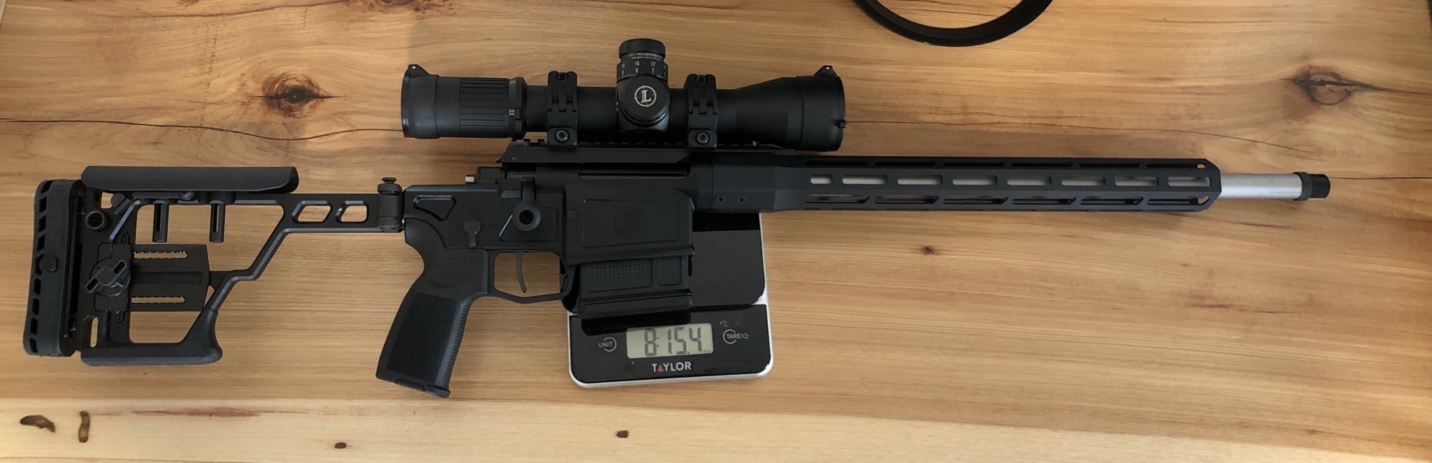

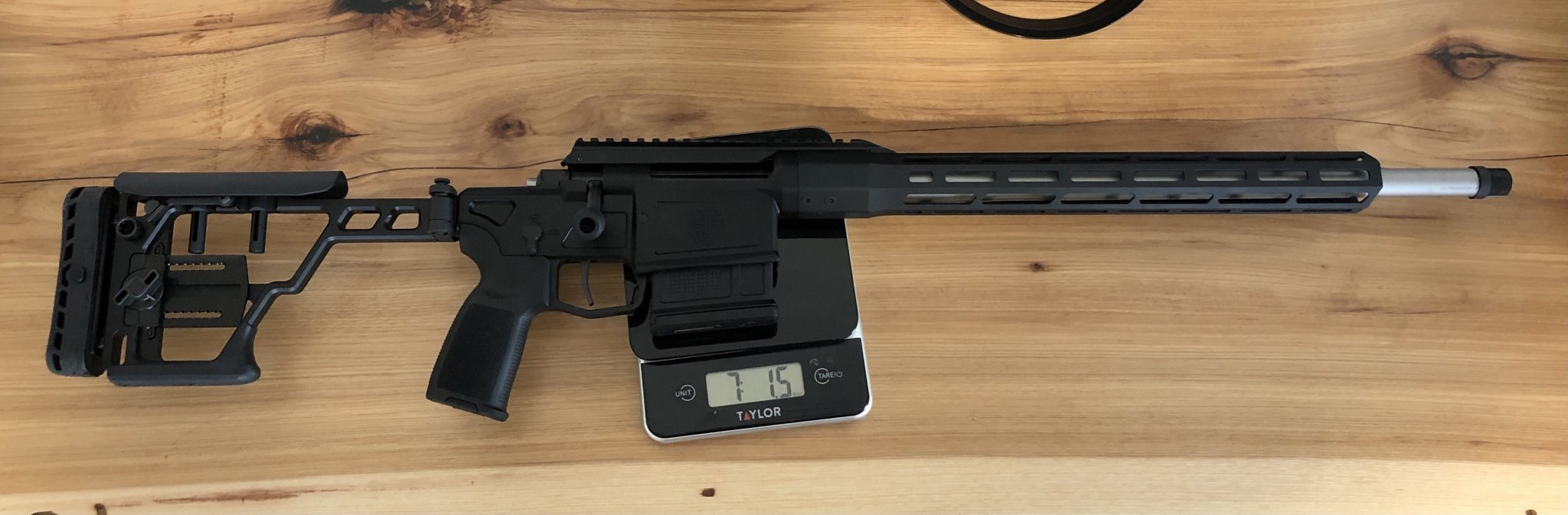

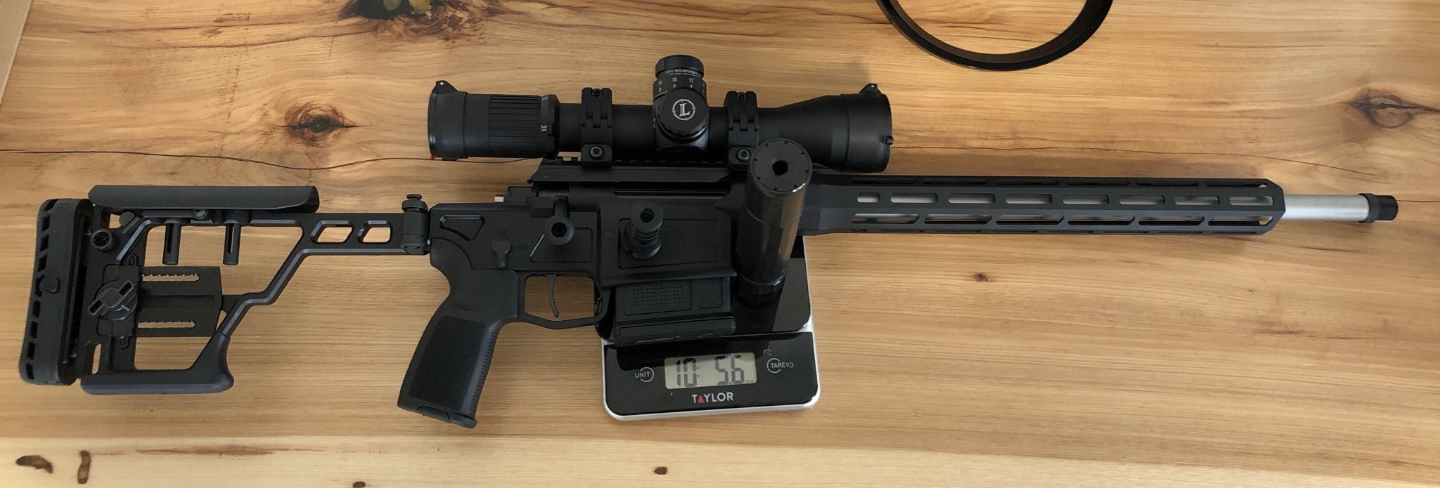

I found a cross in creedmoor at Bass Pro in Round Rock Texas. Apparently it was there for two weeks. I attached some weight pictures for reference. I have ARC low rings on the Leupold Mark 6, but I need slightly higher rings to clear the scope a bit more. Also added a picture of the whole package including my dead air Sandman S. Looks like it will be right at 11lbs by the time I add a bipod. The bolt lift makes me realize how terrible my remington 700 really was. Hope to get out and shoot it this week.

Did the ARC lows clear the scope objective? I have a Mark 6 on the way and am shopping for rings now, but hard to tell what height will work.
@brazz04
It clears, but it's so close that the nub on the magnification ring hit the pic rail when turned, which only allowed the magnification to go to about 12x. I love the mediums, it puts it high enough to use the cheek adjustment as well.

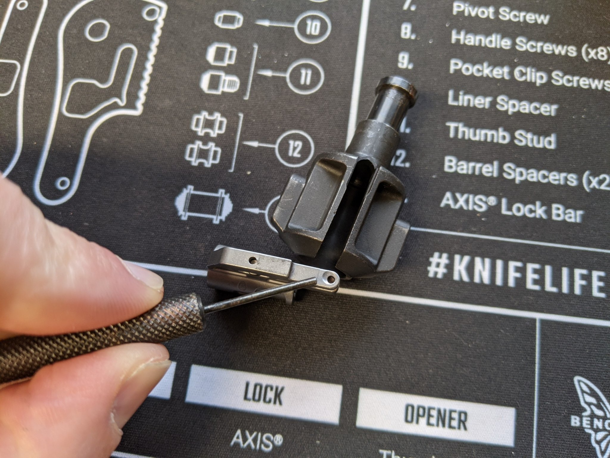

I disassembled the bolt for the first time. I wasn’t sure if I have reassembled it right and there’s a gap between the striker shroud and the bolt assembly. Can someone confirm whether this is right?
It's odd that some are not getting bid on at $1,500, and others are being bid up to $2,500.
I'm convinced GunBroker has "phantom bidders" galore. There's some stuff there that has no business - even now - being bid up so fast. I took a risk once and bid on a rifle at the entry price. Of course it was already bid for. So I bid at the lowest price I found in stock on a website (which happened to be a place 1 hour from me) for the same exact thing and it was already bid for at that almost $1,000 higher price. This was the day of listing. Either there's a bunch of idiots bidding with no strategy on GunBroker or it's rigged. I lean toward the latter for sure.

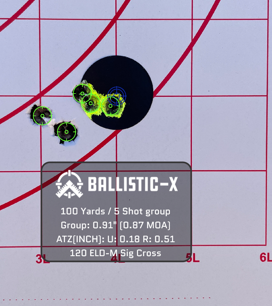

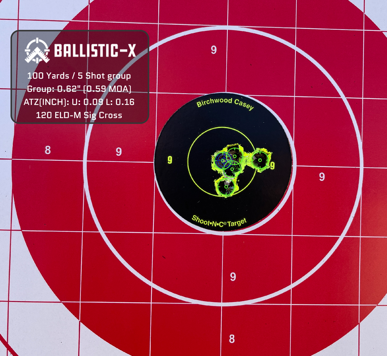

Got out to the range again with my 6.5. Mine seems to really love the 120 ELD-M from Hornady for sure. the top left and top right groups were more for speed than accuracy, still not terrible there though. I took a gamble on the 120's and I'm glad I did. Time to move out to the longer ranges. Also bought one of the Cabela's Covenant 7 scopes in 3-21x because I had points and got it for I think $270. So I threw it on to check it out and that's what was used for these groups. Not sure where it will end up but seems to be a good enough scope.
